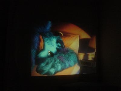

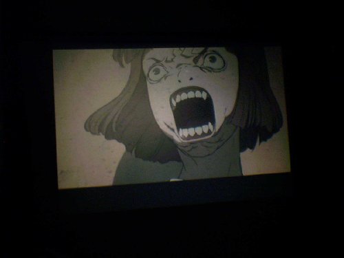

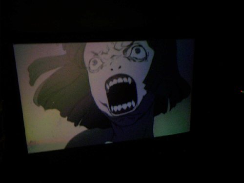

I just got this LCD screen made for Diebold ATM machine off eBay. It comes with svga controller and very easy to take apart. So I spent 10 minutes, took it apart, and put it on a 3M 9550 OHP, and here is what I got:
And this:
one more (my hand wasn't steady enough for 1/4" shutter):
More pictures are on my original post.
If you notice the last picture, you will see the brightness is not enough, even though the ~5 feet wide image was projected onto a Draper projection screen in a windowless conference room. I will replace the 9550 lamp with a 575W HWI in the future. Hope it will improve the brightness.

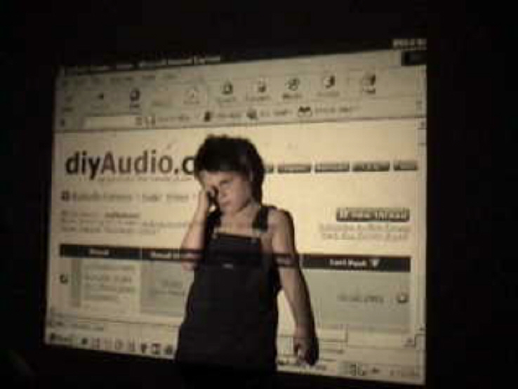

Got a decent picture
Well here is a picture of my current setup, before my MH conversion that is coming up this weekend, hopefully.
Now as with most digital camera pictures, it actually looks a lot better than the picture shows. This picture is showing Serious Sam on the xbox, so it is running at 640x480. The projected image is around 75" from corner to corner
I am using.
Old Apollo OHP that has been retrofit (before I got it) with 1000w Halogen BRH kit.
MegaShow LCD Projection Panel, 100:1 CR, 30ms RT, Up to 800x600 16mil colors.
Cheap 25 dollar VGA Box from ebay to hook up my consoles.
Da-Lite 70" Matte Screen.
