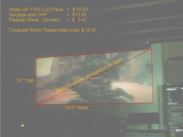

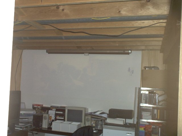

Finally able to get some somewhat descent photos of my projector working. Still don't look as good as in real life of course. The screen is very wavy because I had the fan on and it made a lot of waves in it. I'm using a QA-1800 with a old projector retrofitted with a $1 500watt bulb.
The image is currently 8' wide with no pixelation.

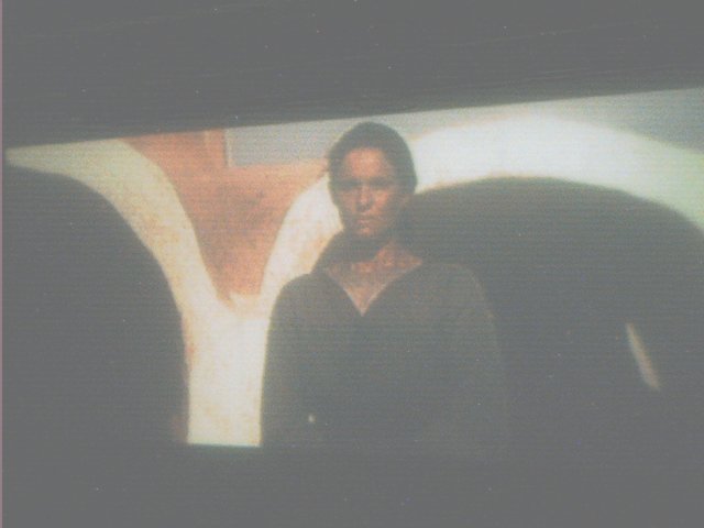

Here my first Resuluts !!!
Setup: Geha 825K OHP with standard 250W Halogen Bulb (the original OHP Bulb) with a InFocus Power View 820 Panel with linedoubler .
Photo´s shot with a Minolta F300 without flash with a littel bit of daylight !

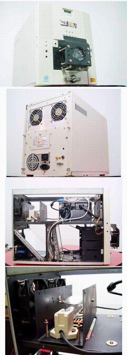

I'm new to this forum. but have read some articles for some months. I upload one project done by my freind for your reference. I wish this could be helpful.🙂
retrofit old PC case
250W metal halide and ballast
back light mirror
IR filter
key stone adjustment with toy wheel
remote cotrol
screen is about 100'

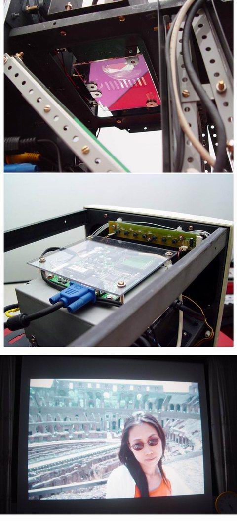

Hoontang, the colors on that projection from that projector are dead on. What kind of LCD is your friend using? What kind of filter is that right after the lamp? Judging from that picture, it looks as accurate as a commercial projector. Let us know the specs, cause it looks great.

Correct me if I'm wrong but it seems that your friend isn't using 15" LCD panel as most of us... It seems much smaller, something like 7" or 8".

Well, it's only speculation but it must be pretty hard to align 2 LCDs panels.
At the bottom, we can see some kind of brass bolt used to adjust the angle of the LCD panel to correct the keystone effect. Clever idea and nice use of mecano toys !

Well, you may be right. I don't want to discuss any more on that but which LCD could he be using ? Dismantled OHP panels ? The controller board seems pretty small too.
Maybe I'm fooled but they don't seem 15" LCD.

well keep in mind he live in asia..a goldmine for electronics there are LOTS of lcds out there that we dont know about...and i think hes using one of them.
ok after thinking about ti i dont think its a 15 incher and i dont see a fresnel lens...this guy is on another level....hes the super saiyan of DIY lol

some info of above project
they bought those parts from a certain company together.
It's kind of package.
LCD(8.4")+remote+control board+all cables
price was $300 total
1. 800x600 natural resolution
2. 1024x800 condensed support(?not sure the term)
3. 250:1 contrast ratio
4. rated A panel (?)
5. S-video, composite support
6. Using AD board(control board) memory chip, smooth picture quality
7. LVDS type, not FPC cable. convenient for DIY, easy to extend.
8. fast responce time (no excact data)
he also used two fresnel lenses on is just behind LCD, 2nd fresnel is diagonal one which can be adjusted by LEGO wheel.(for keystone)
IR filter is just below the bulb.

So the secret is a second fresnel (and not a second LCD 😉)
