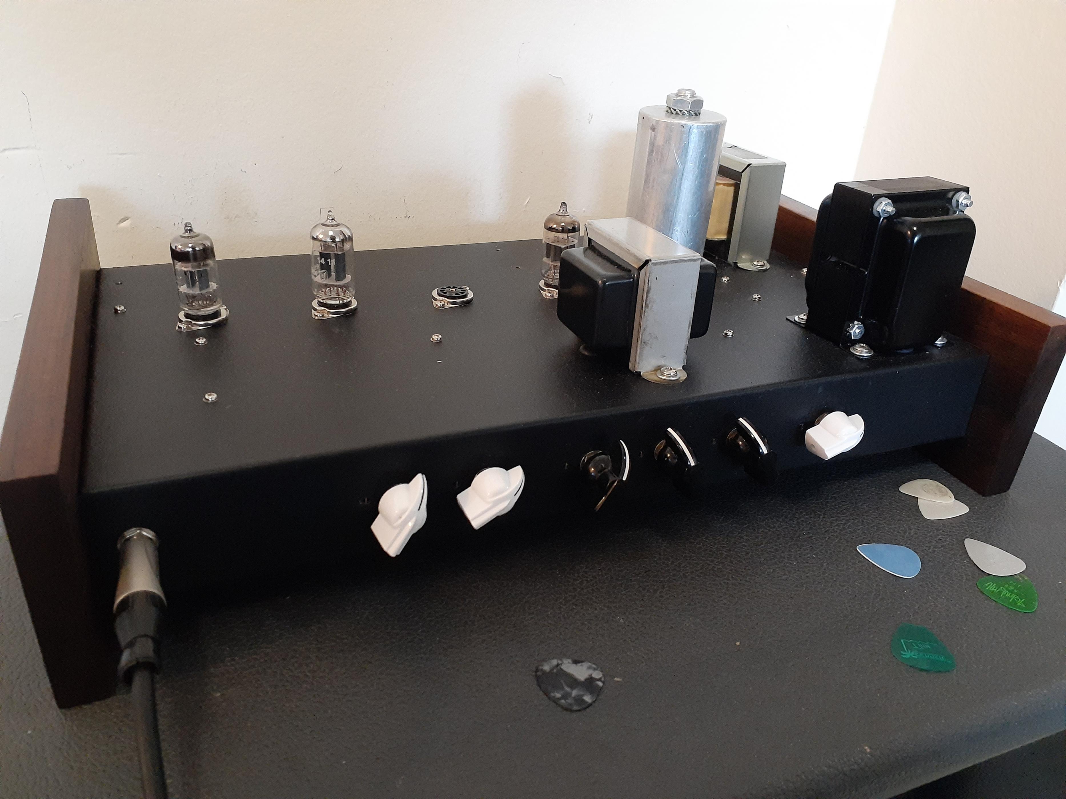

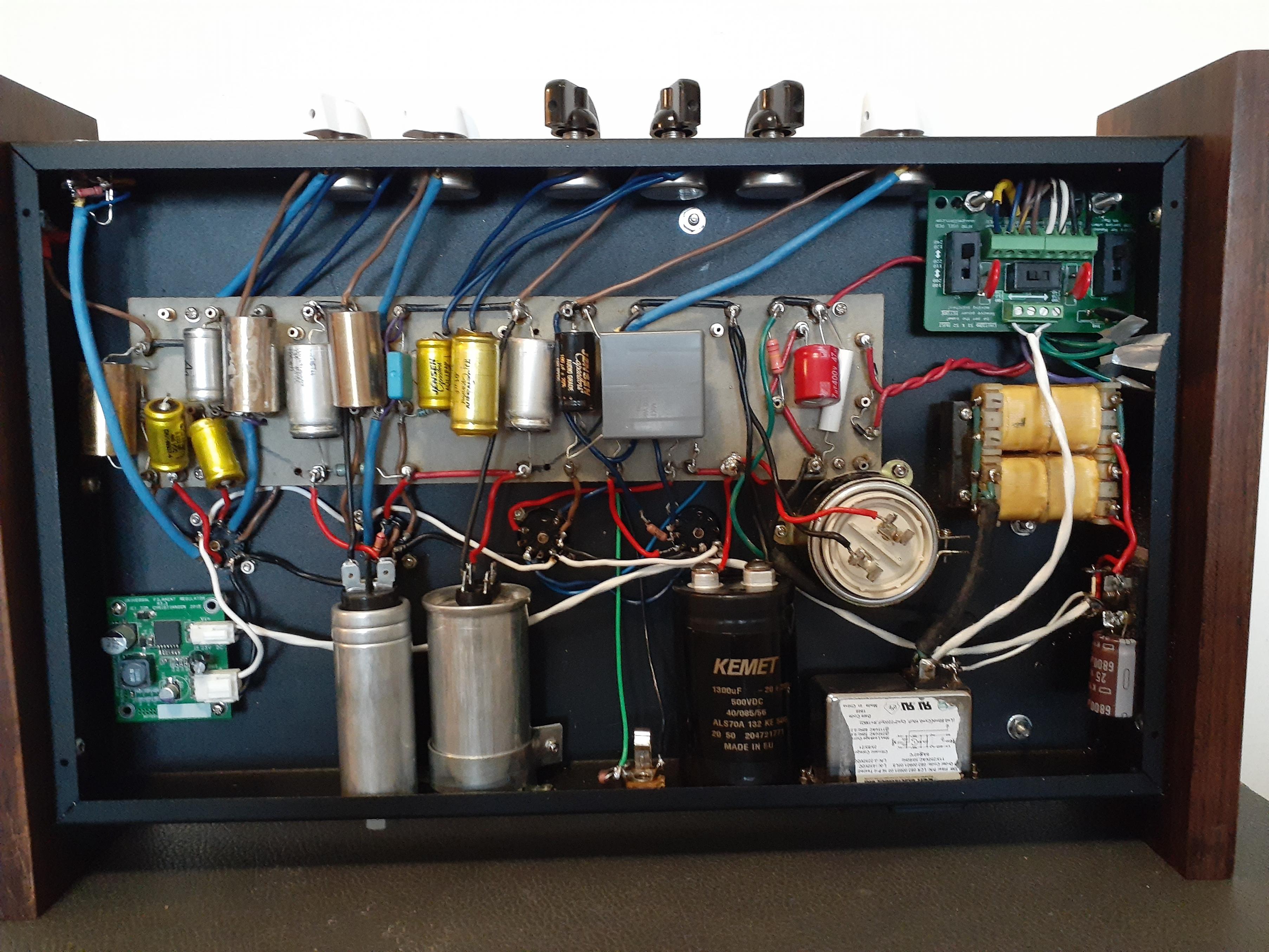

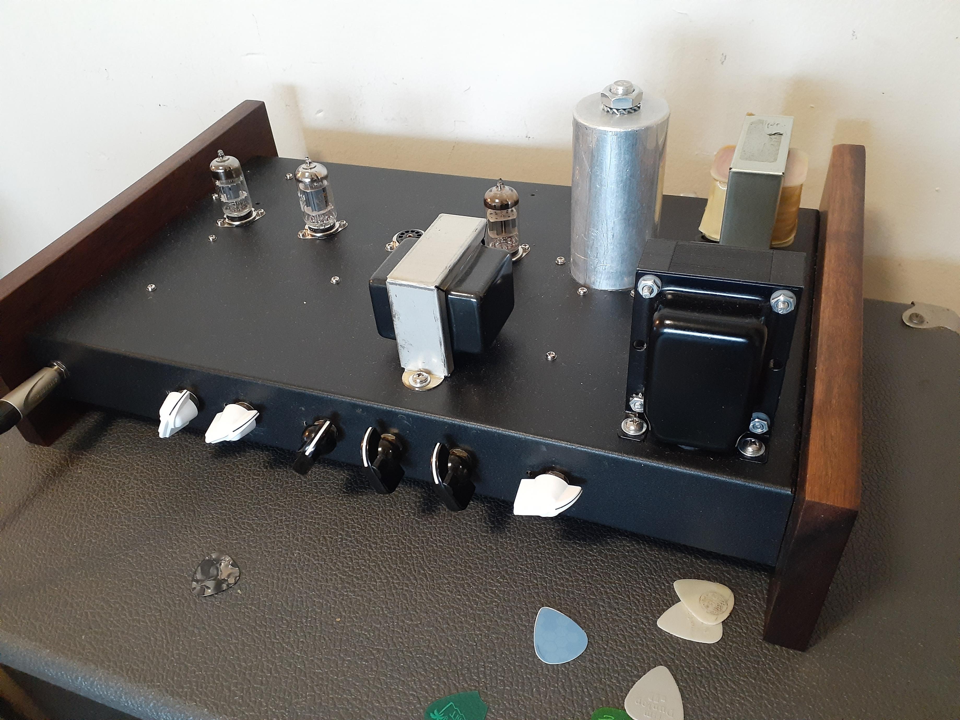

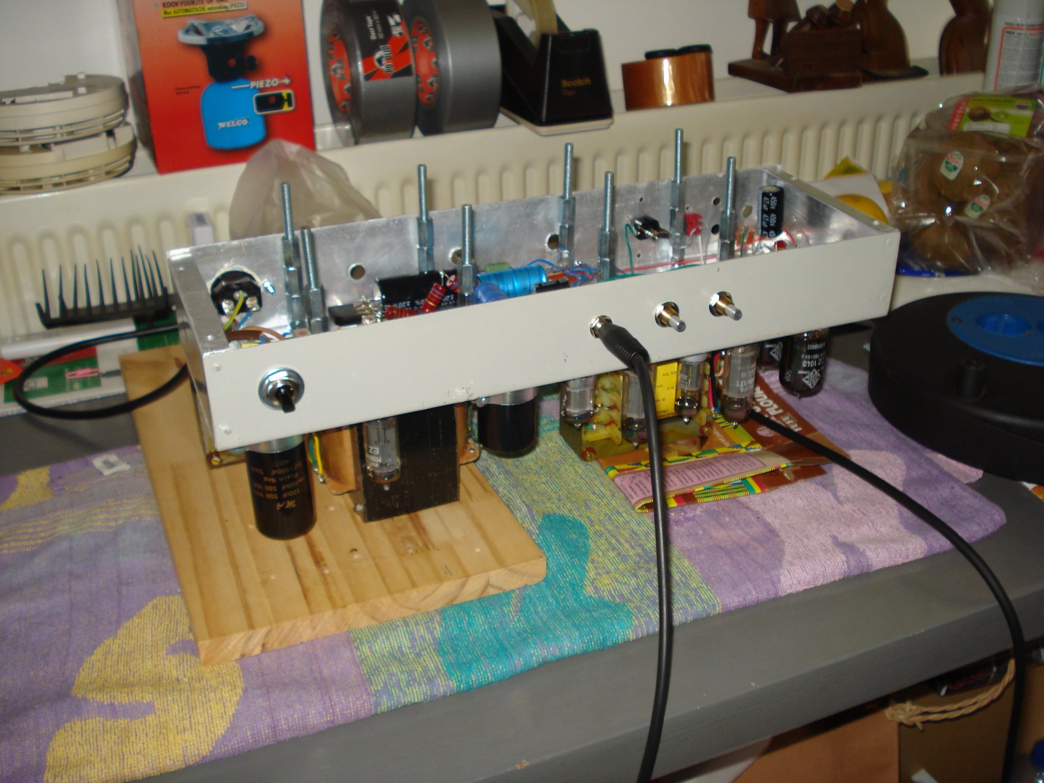

Here's my High Octane. I have the standard EL84 as well as the 6N1P power tube option. I wired up just one triode, so the 6N1P option is 0.5 Watts.
I've used one of Tom's Neurochrome products to put DC on the filaments to keep the noise and hum down and because this is my first point to point scratch build I was a little worried about filament hum.
I replaced the R2 in the power supply with a Hammond 194E 30H choke. The smoothing cap that follows that (47 uF) was replaced with a 1300 uF electrolytic capacitor paralleled with a 80 uF run motor cap.
The next 2 smoothing caps are a 33 uF electrolytic paralleled with a 15 uF run motor cap giving 48 uF.
The OPT is a Transcender 5 watt.
Would you be surprised if I were to tell you that the amp is quiet? 😉
Wonderful clean and a clean distorted, if that makes any sense....

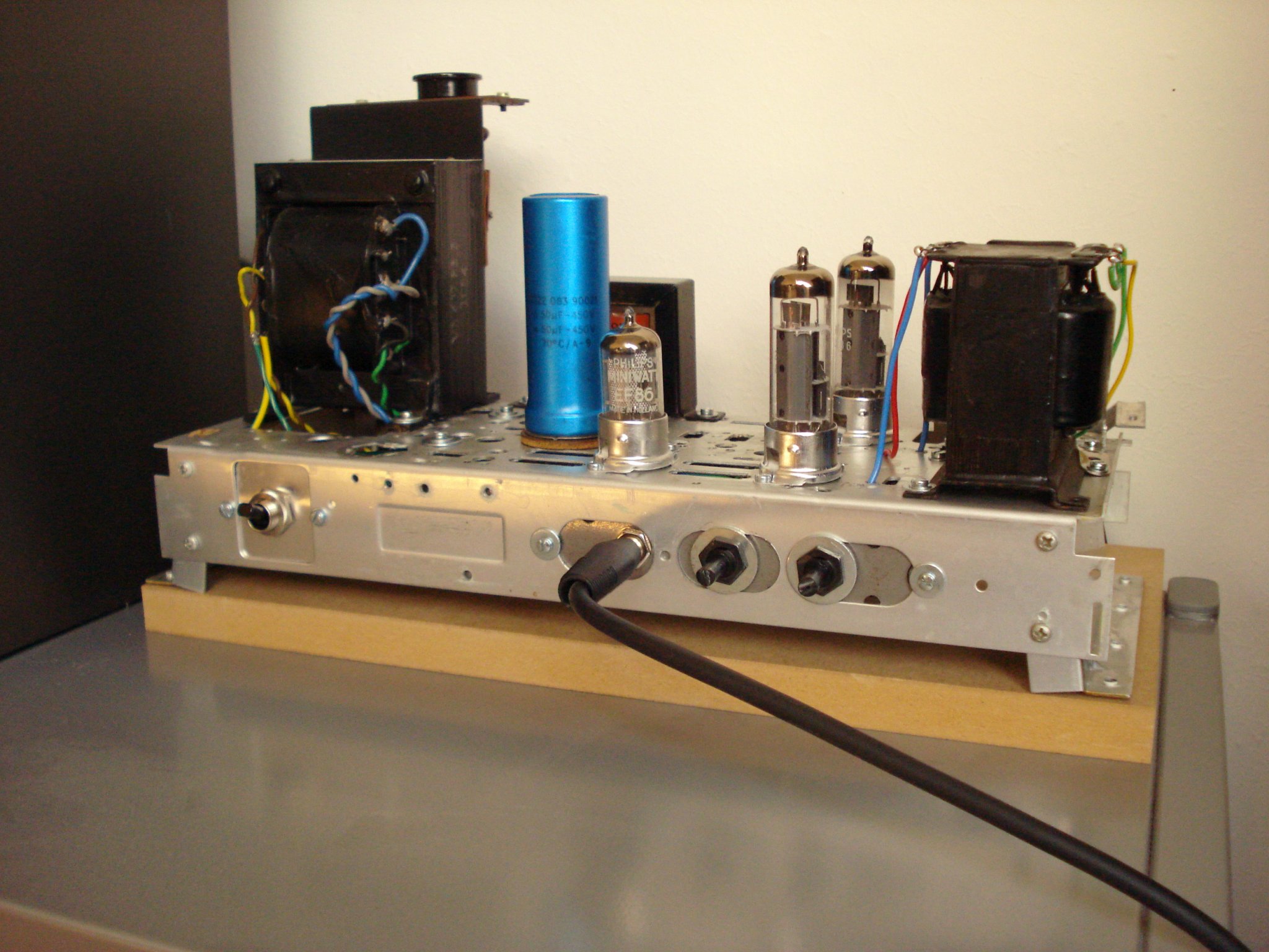

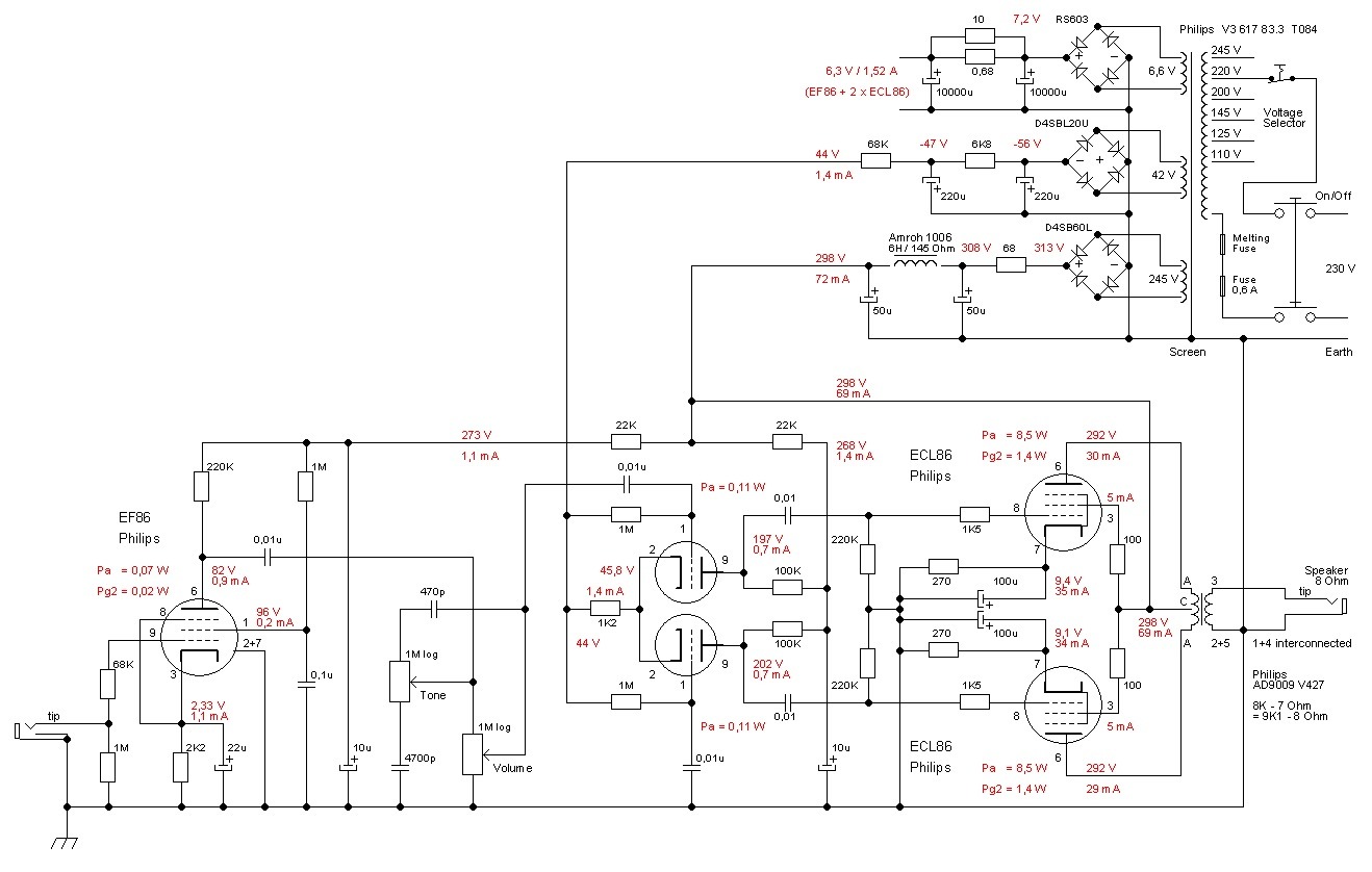

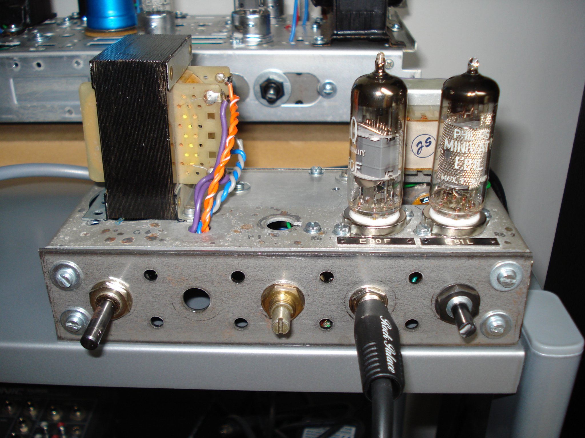

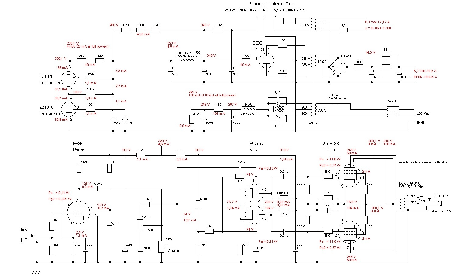

Three of my diy guitar amplifiers (the one with 2 x EL86 pp is electronically finished but still needs some work on its enclosure).

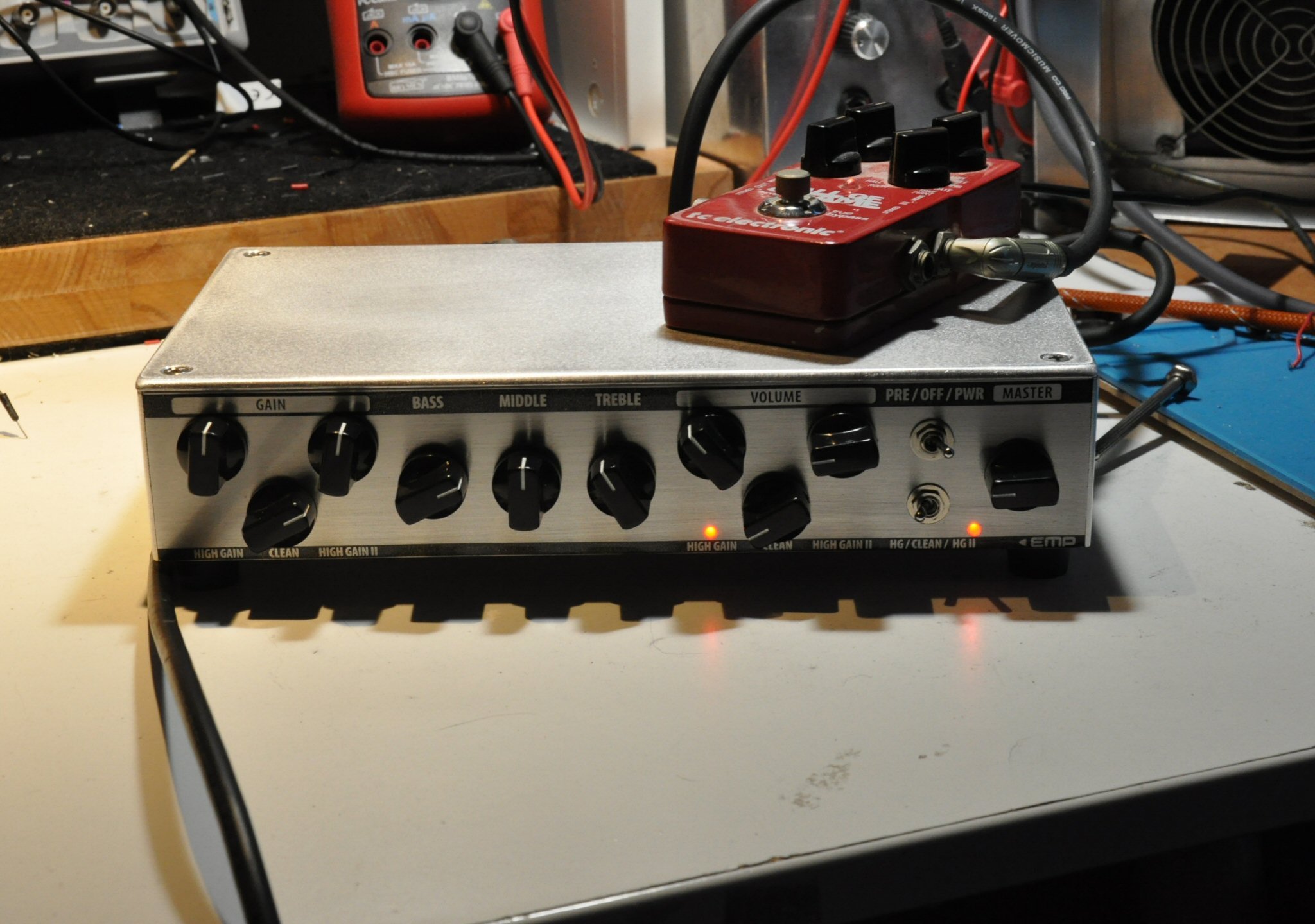

My new three channel high gain amp with D-Class output. The preamp consists of an SS effect loop, two high gain channels with four 12ax7 stages and a partly SS clean channel. The D-Class power amp and the HV booster are standart units from aliexpress with almost no modifications. It is intended for home use.. I run the amp with 14V DC and can get probably up to 8W.

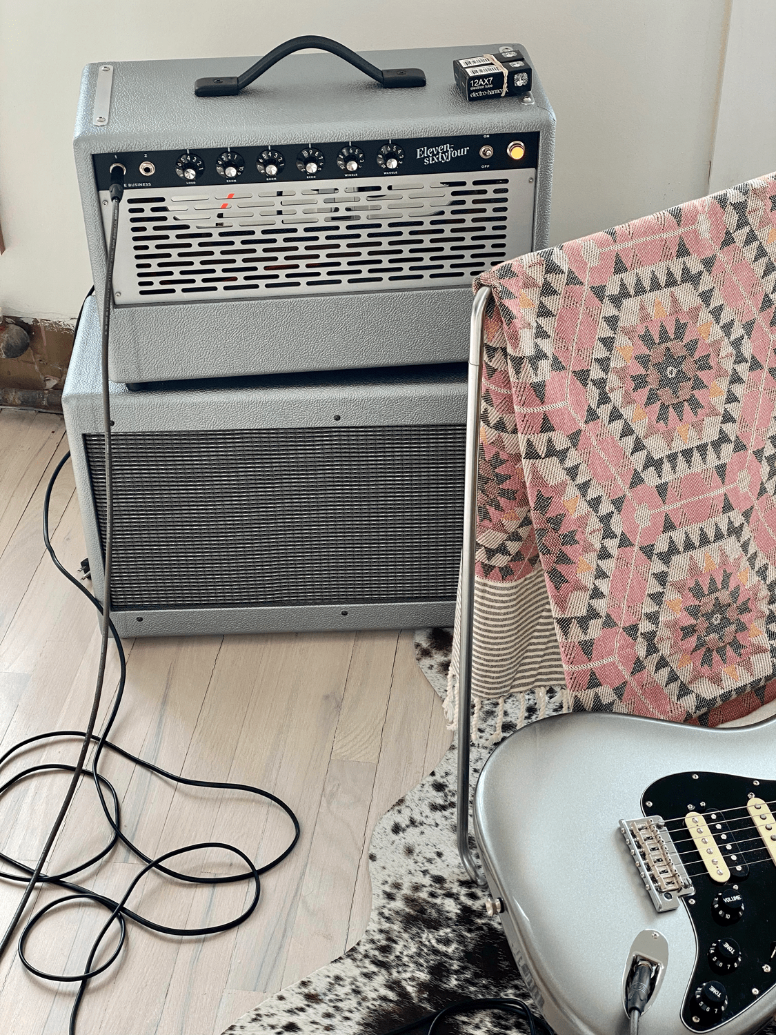

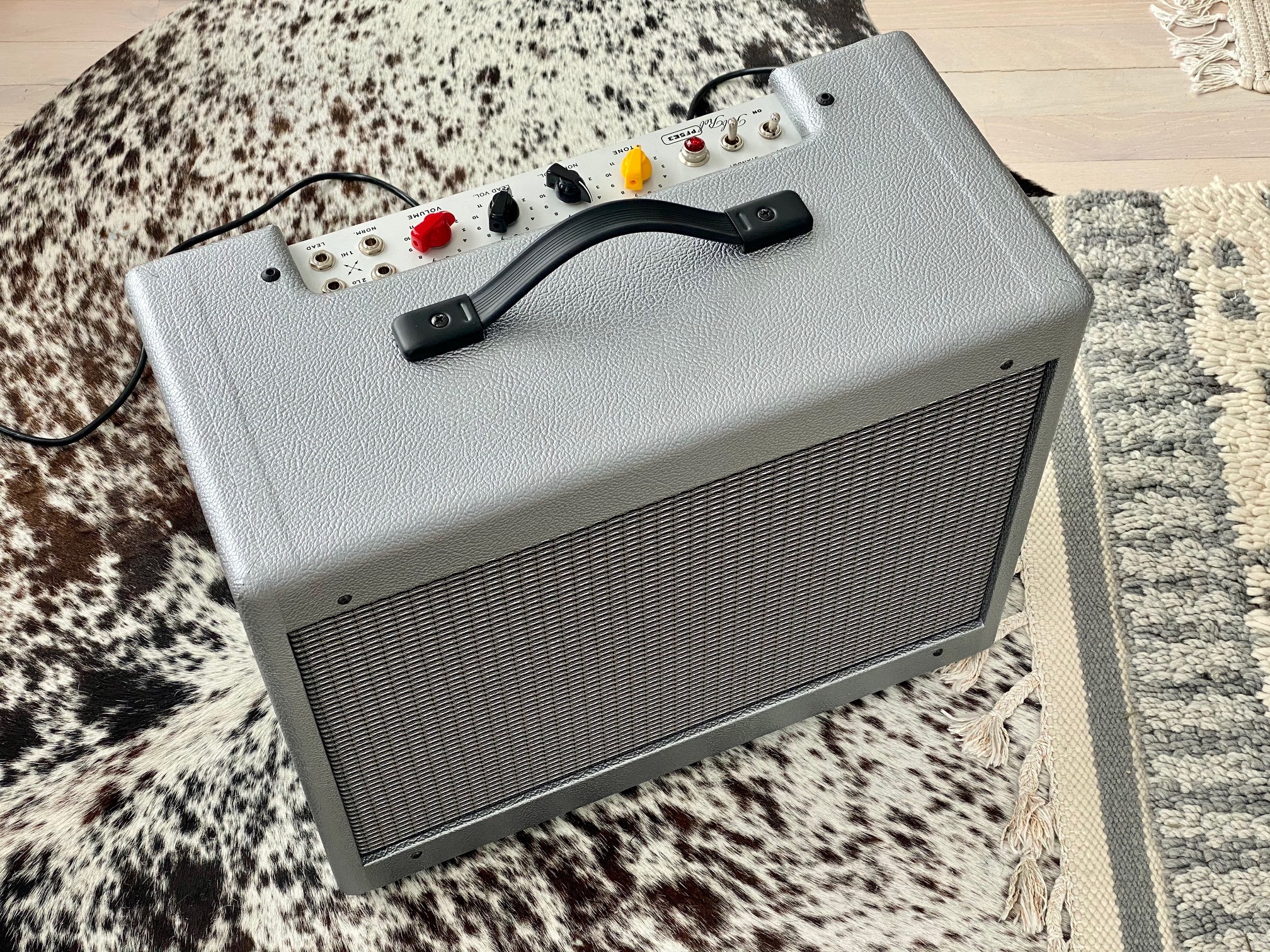

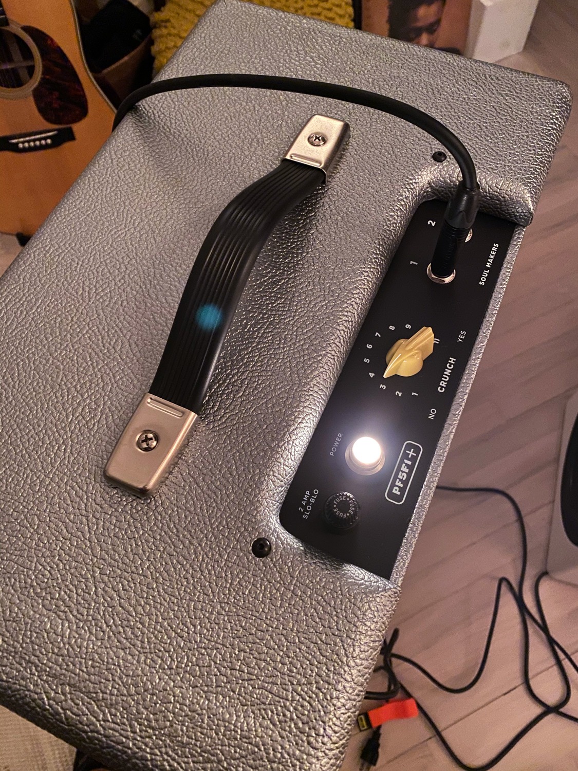

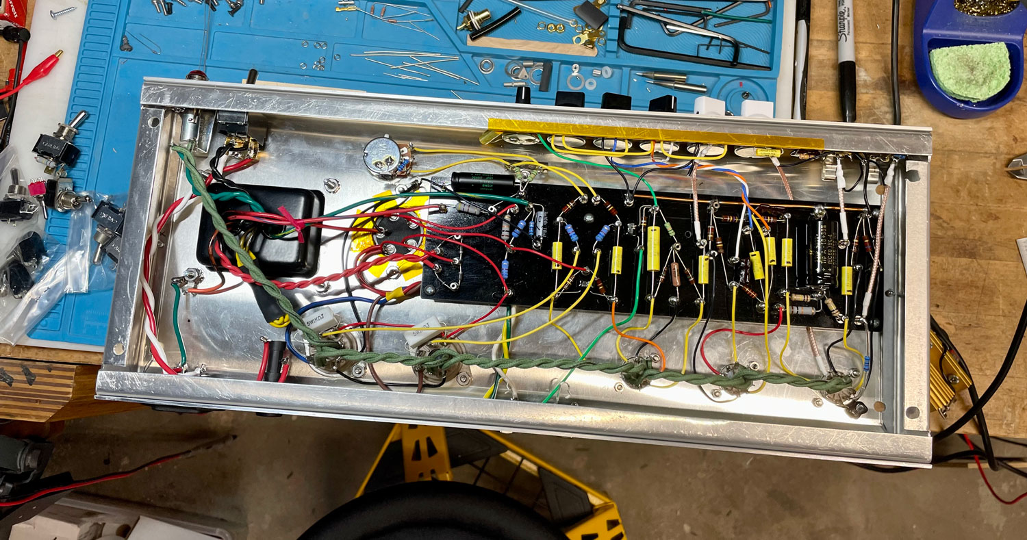

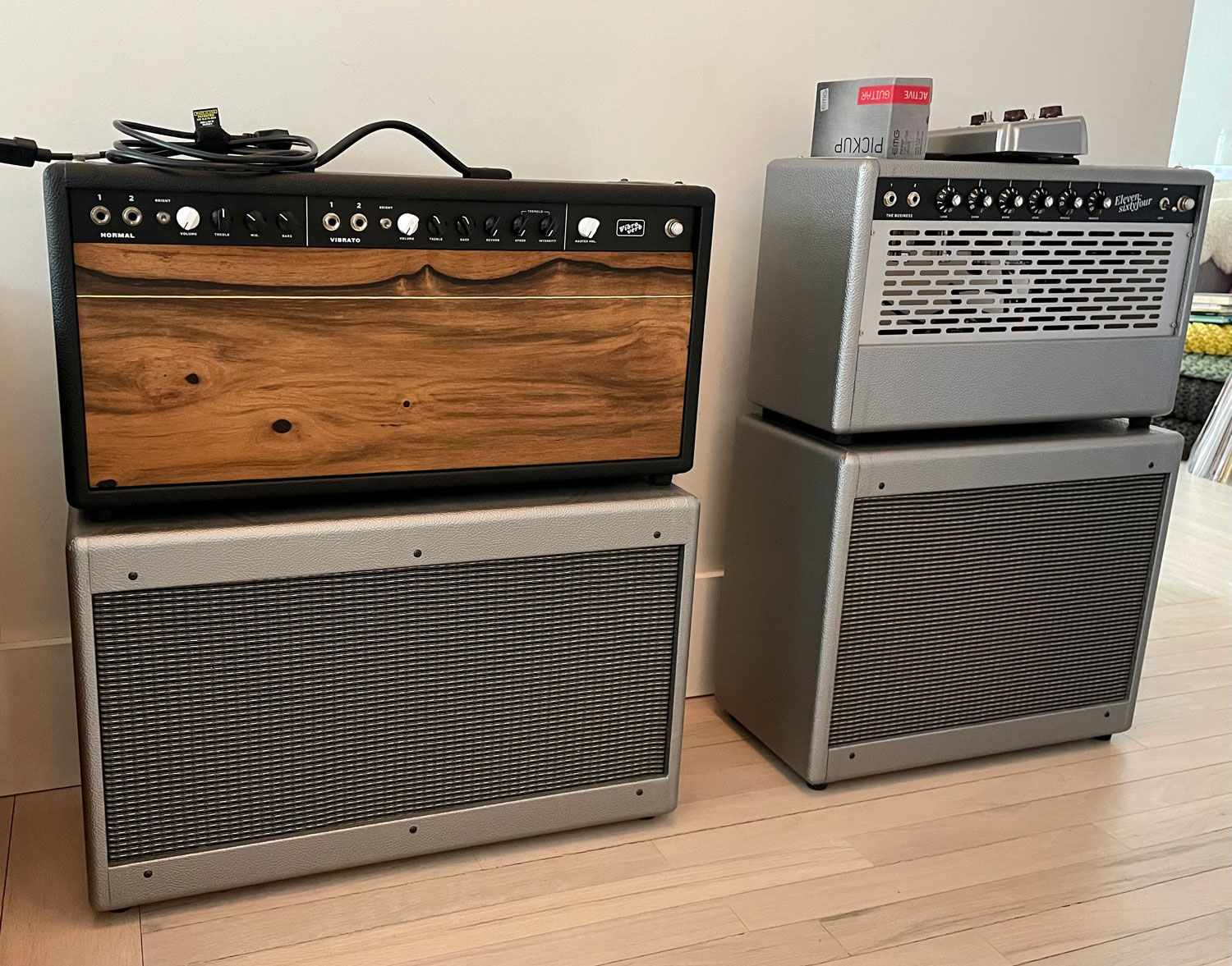

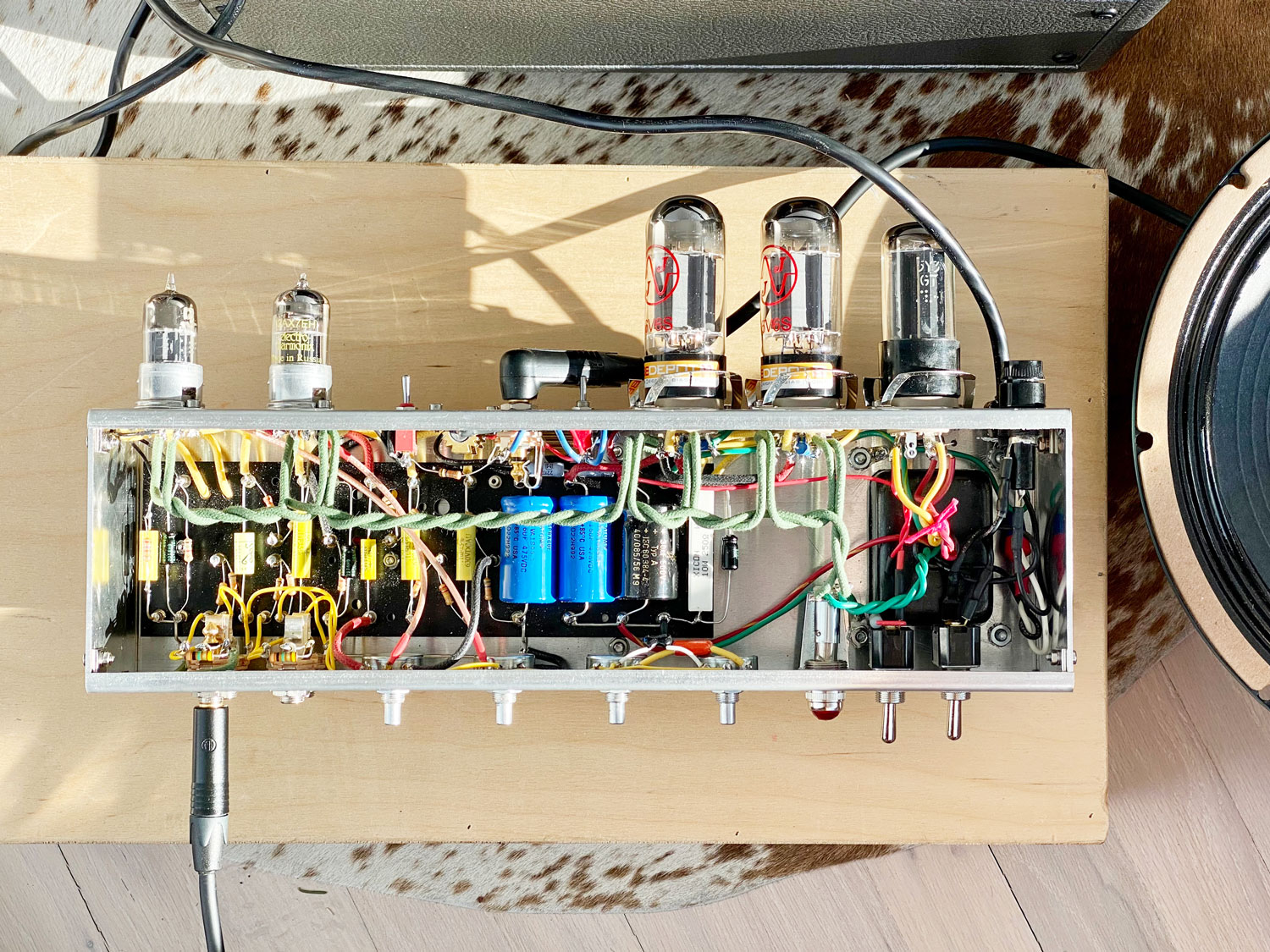

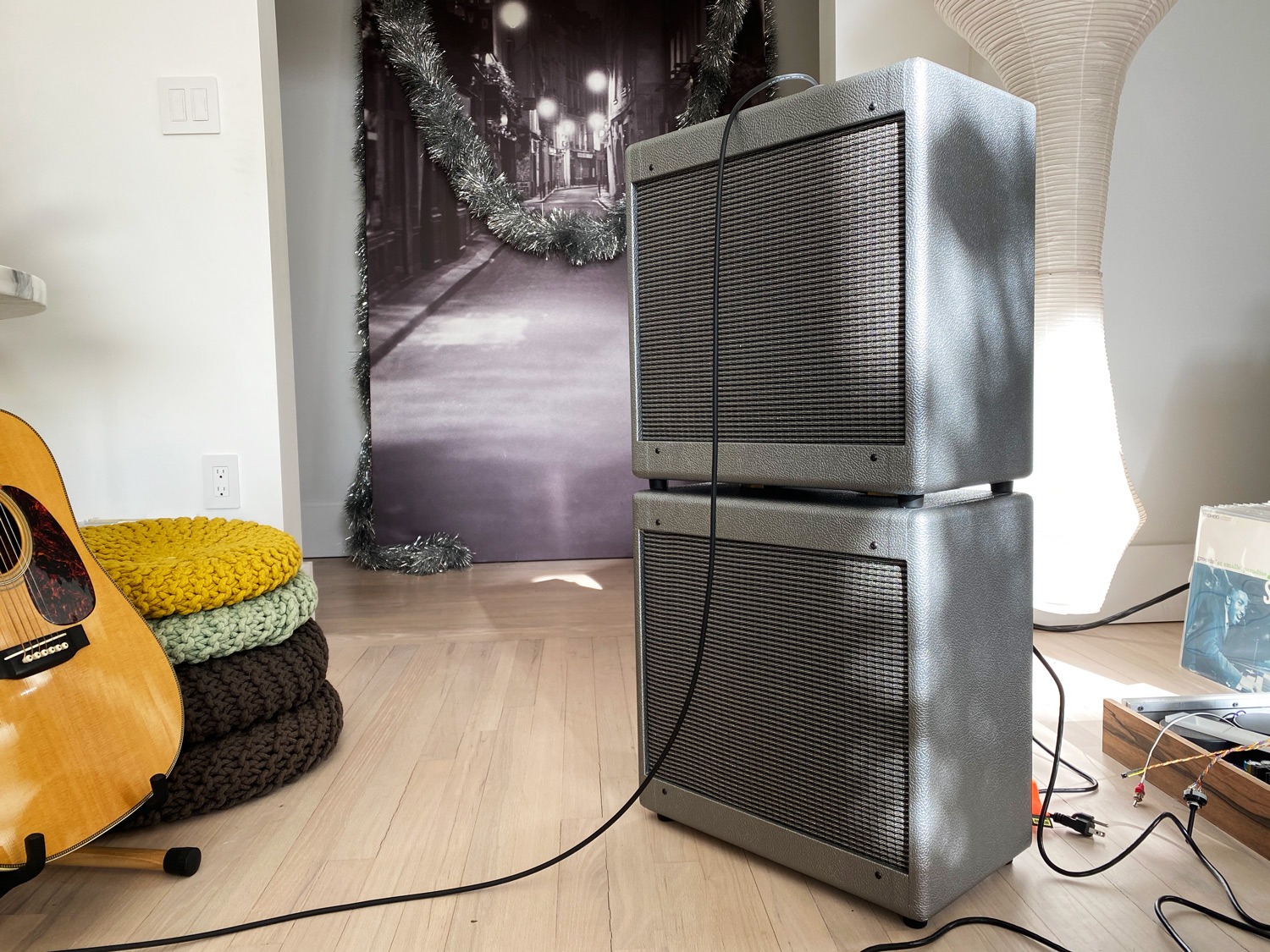

I've been posting all of this stuff over at TDPRI.com, since Rob Robinette has a following—and I've learned a lot from him...But DIYAudio is really my home...for all other non-instrument amp projects.
2x 5F1 Champs (different speakers, one was a gift)
1x 5E3 (build number 3)
1x Princeton Reverb Head, plus 2X10 base cab.
1x Vibroverb Head Amp
All have a fair number of mods, but keep the OG circuit stock.... It's been quite an education!

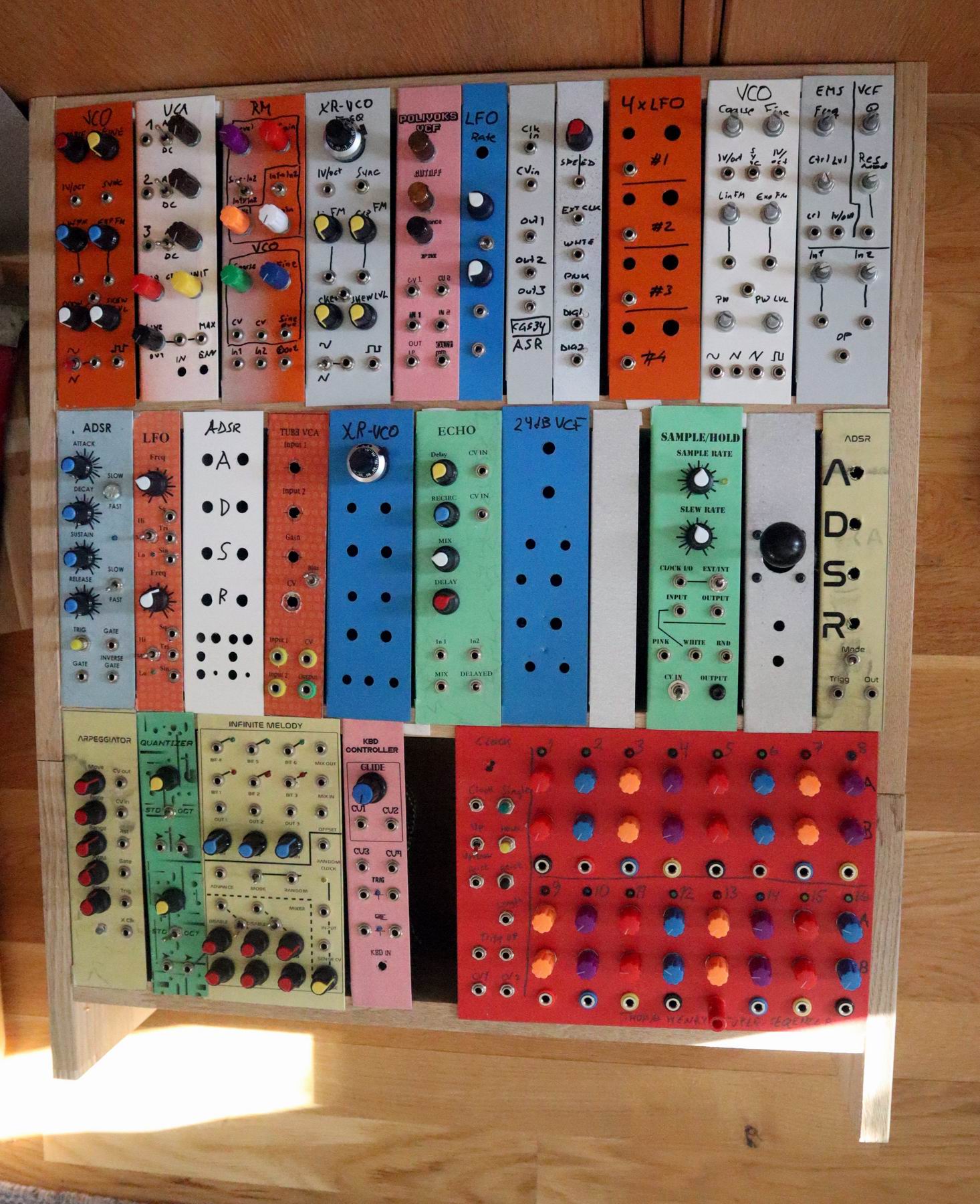

Very nice stuff. I wish I could get myself together and build me a real amp.
Slowly I am at least trying to get something done on my music machine.
Yeah Mark Johnson!
OMG, @soundbrigade THAT IS INCREDIBLE! You should totally build a "real" amp. VERY rewarding—and different from other audio projects (IMO).
A Fender clone, 5E3, is very much on the bucket list, but I cannot start a new project now as a new project automatically halts three or more active projects. The modular synth is a big chunk to chew and swallow and I still haven't solved the question of suppling all modules (+/12V AND +/-15V). Besides I invented my own standard ....

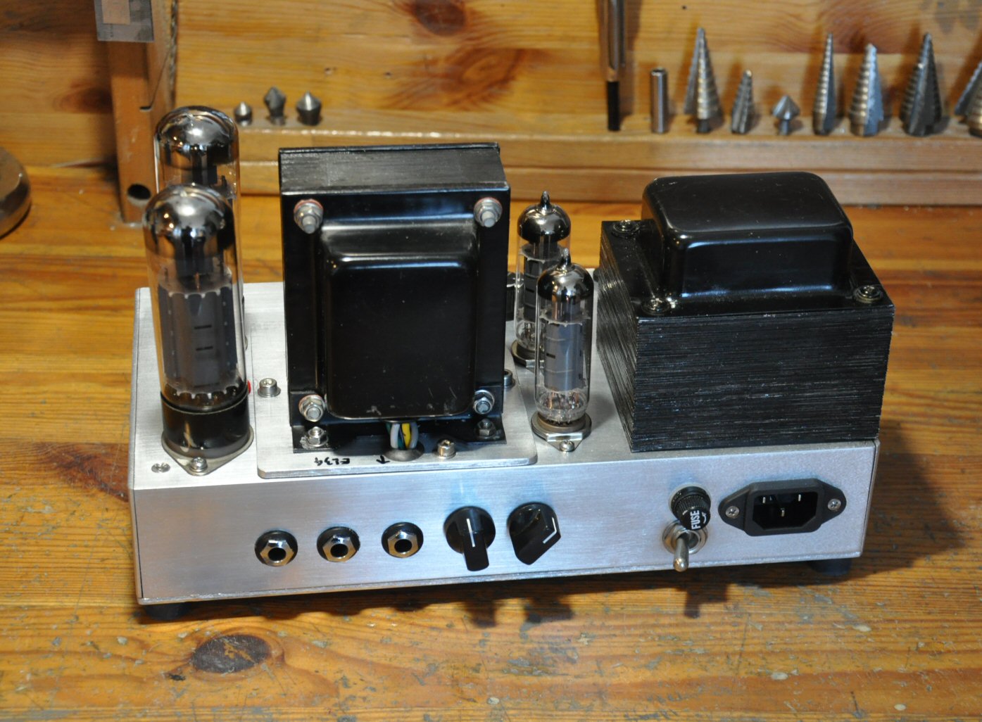

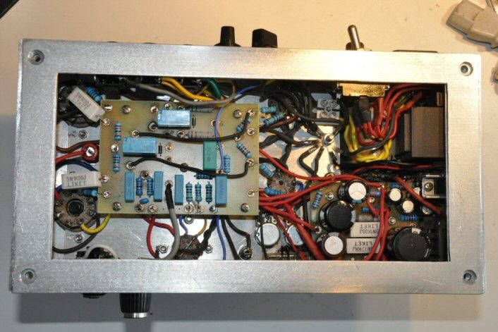

A practical and small push-pull power amp, which can work with most of the power tubes. The power transformer tends to get a bit hot with EL34s, but it will possibly keep up.
After taking the photos I have added a LND150 stage and a second input for using with low level input signals (from buffered FX loops for example). This was really necessary..

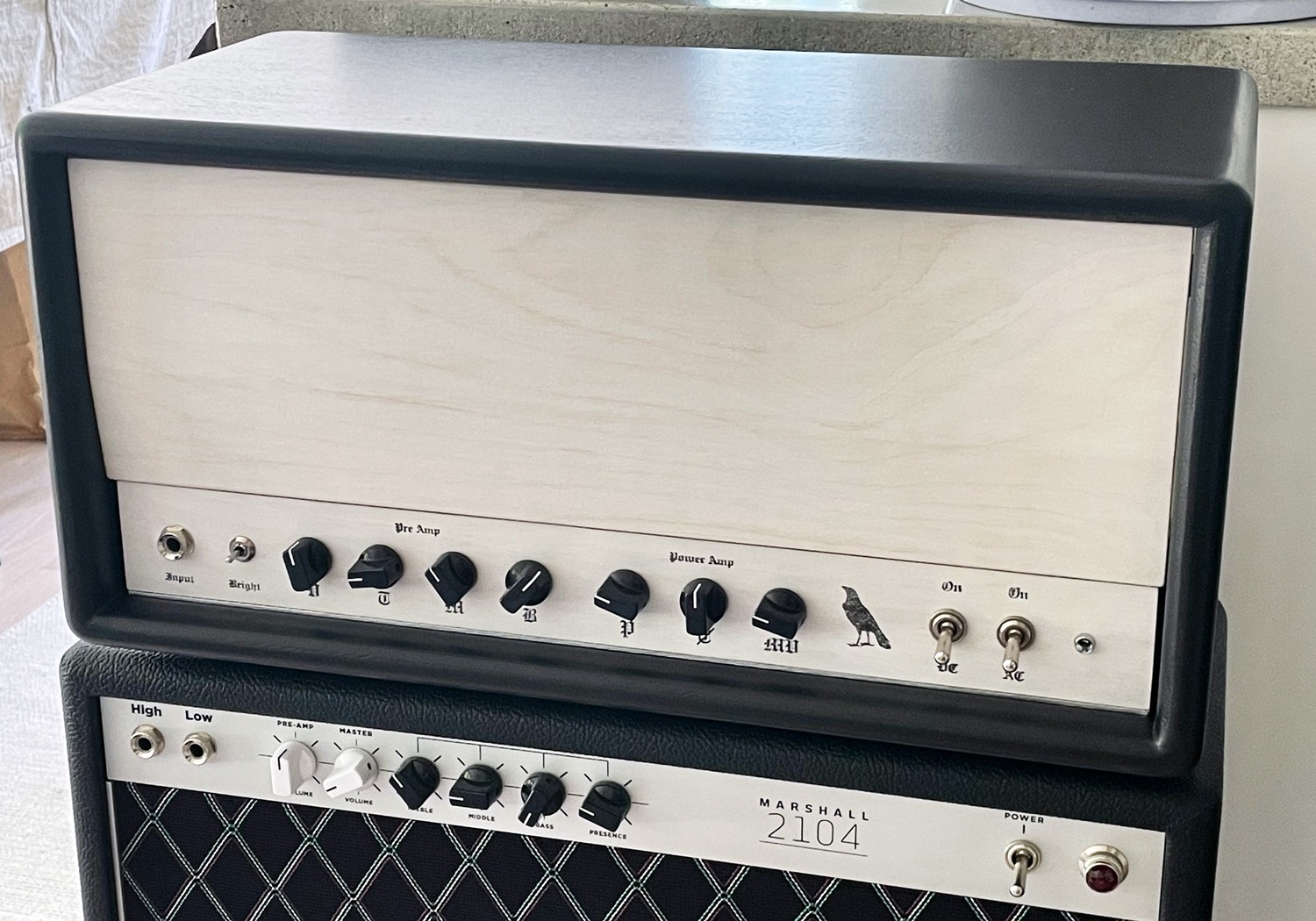

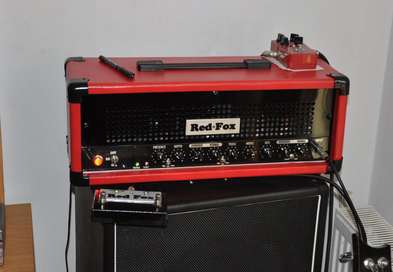

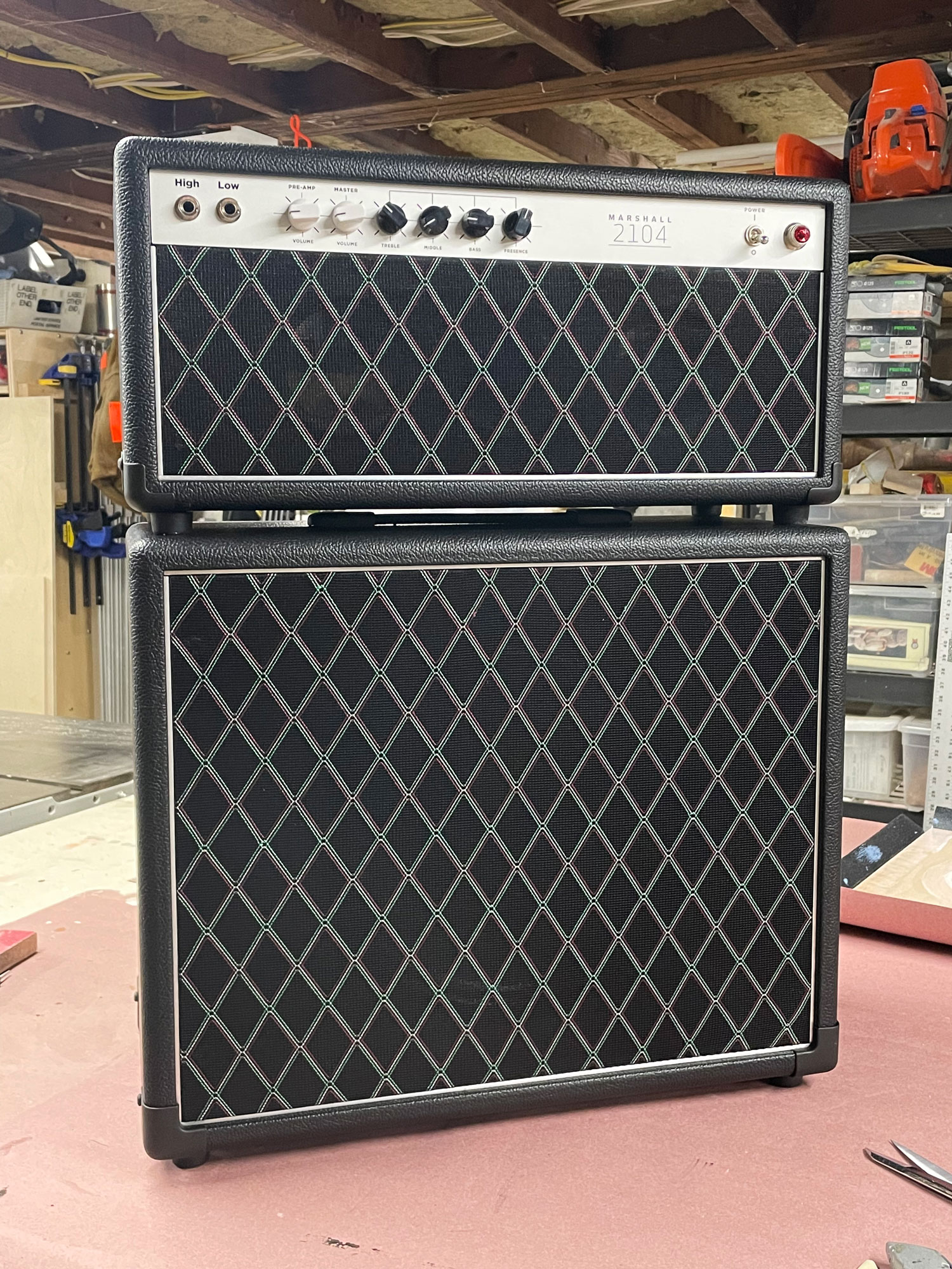

Scratch built Marshall master volume JCM800 (2104) configured to run 6V6 or 6L6 or EL34 (installed) at around 25W.
Incredible amp. Different from all the Fenders so far—love it.
Gorgeous! Supremely well done.
Such a litte cutie.😍A practical and small push-pull power amp, which can work with most of the power tubes. The power transformer tends to get a bit hot with EL34s, but it will possibly keep up.

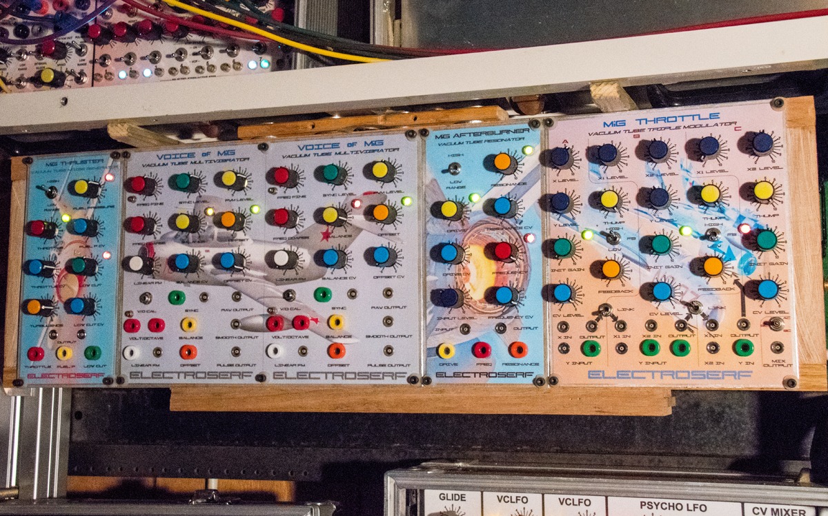

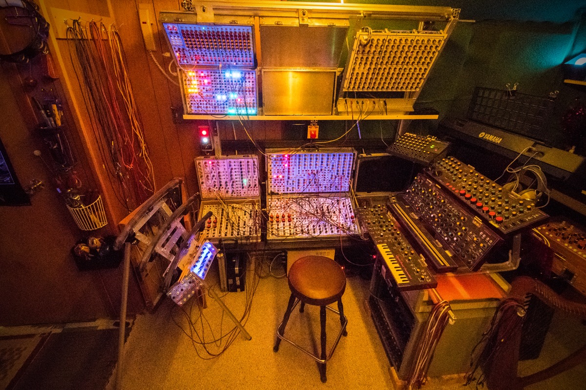

I have been building synthesizers and controllers for years now, here are some of them:
My latest is a set of modules that I designed using 1J24b tubes:

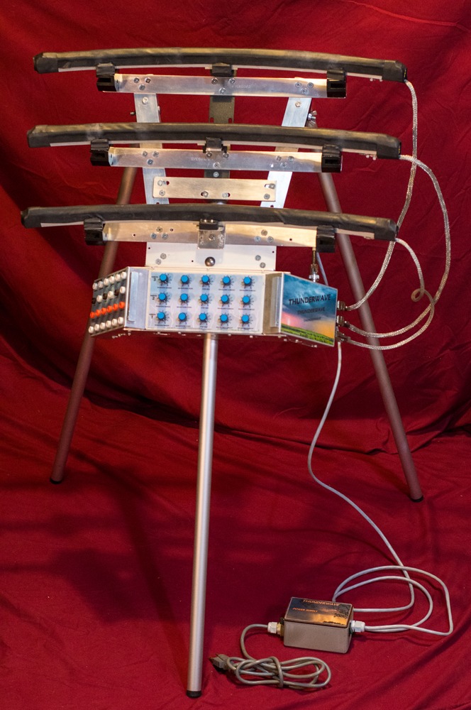

And before that was the ThunderWave ribbon controller:
Lots more on my website and Youtube:

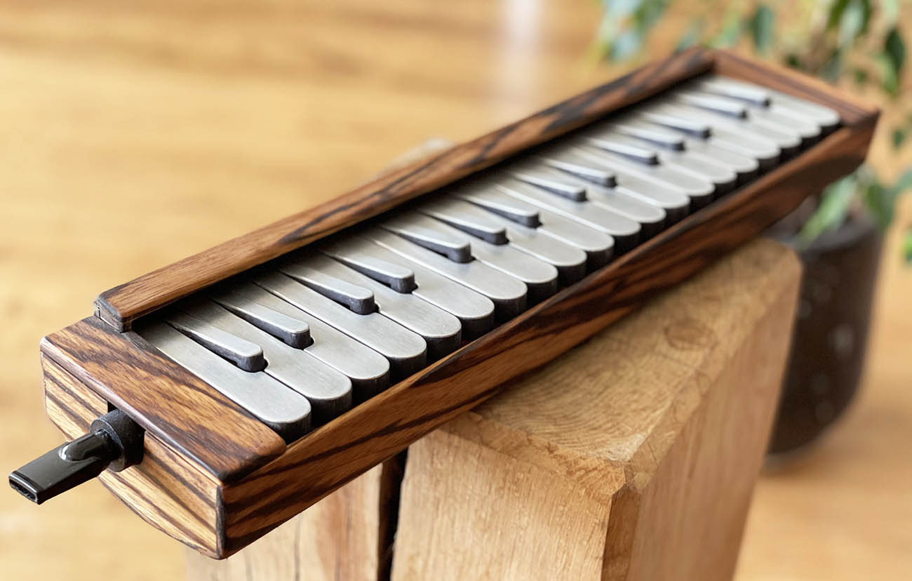

I've been making wooden melodicas, using 3D printing and more traditional methods.
I'm looking into how I can add some pickup mics inside, so I can amplify.
A suitcase amplifier would compliment nicely!
I would love to hear how that sounds. Looks VERY good—what about piezo pickups? Inside someplace.

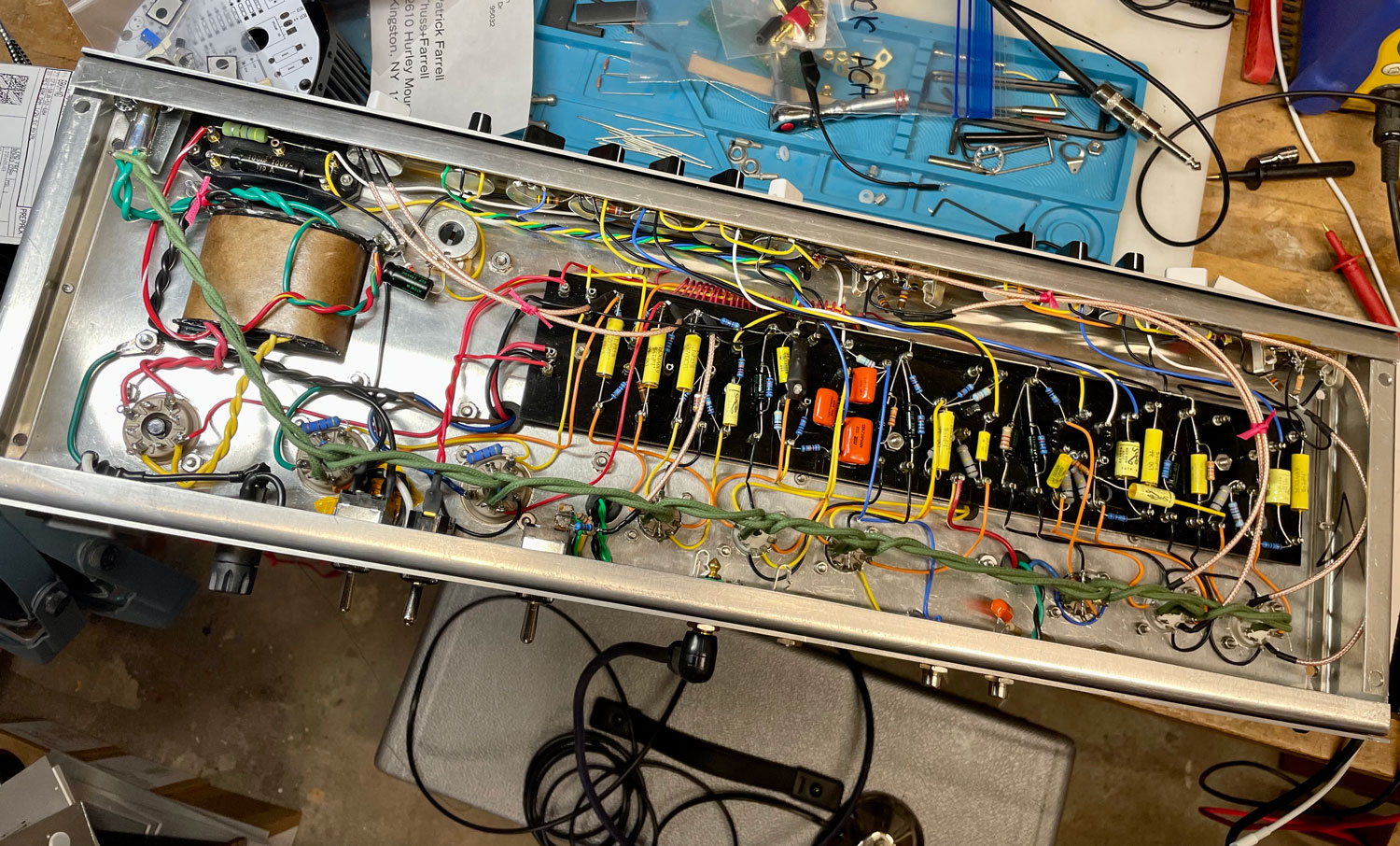

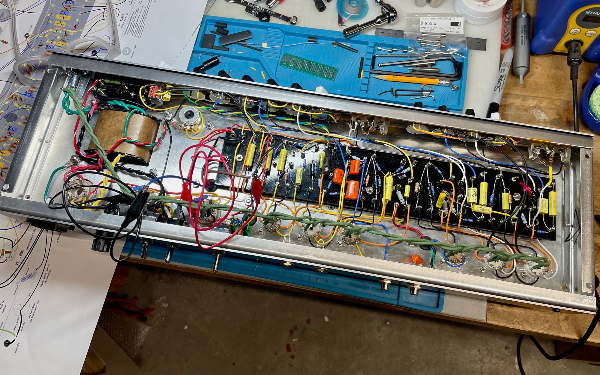

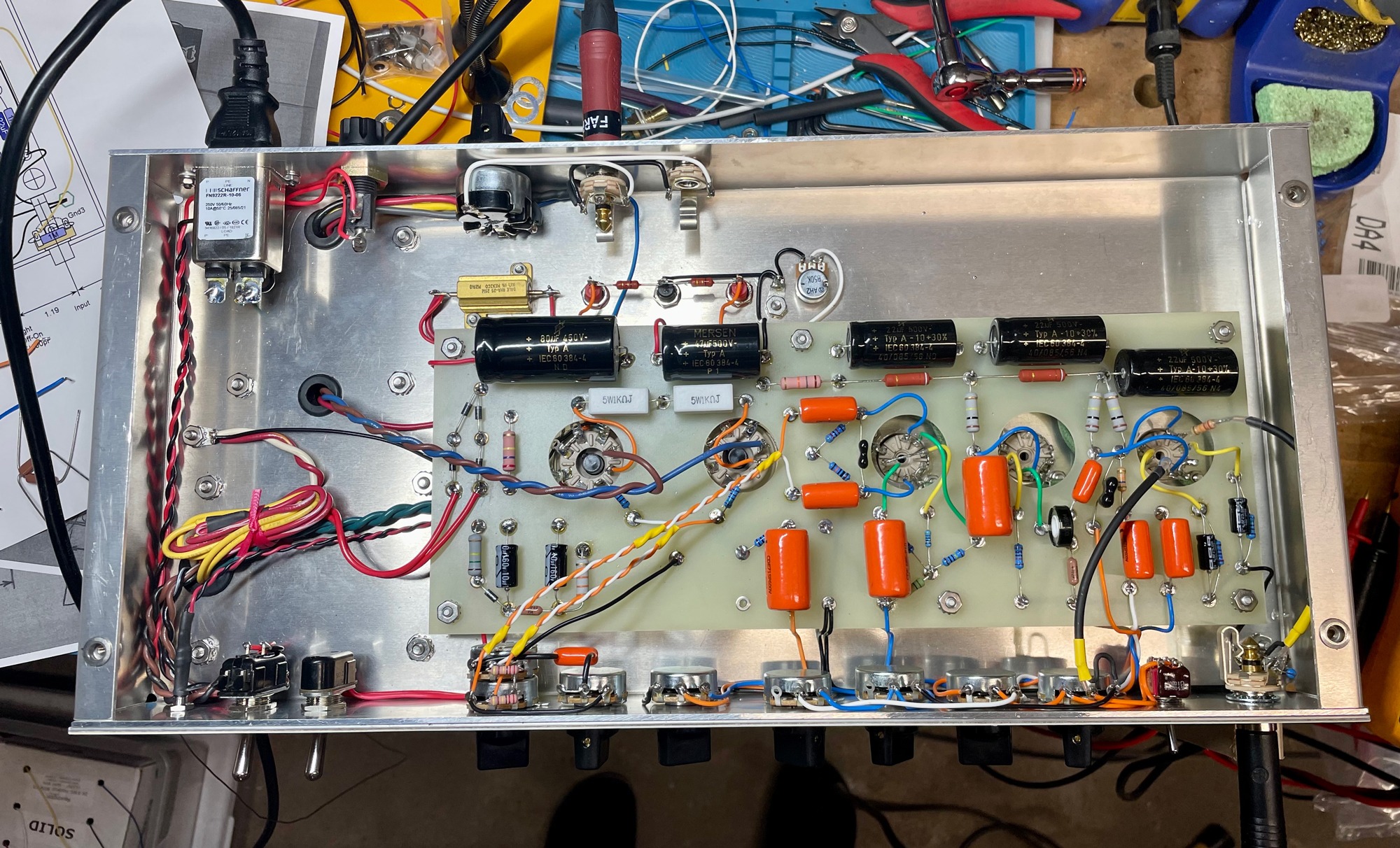

Here's a recent Trainwreck Express guitar amp—no end in sight on building guitar amps! DIY Trainwreck ethos intact, faceplate etc....It's a beast to play.
Looks great! Are you using laser cutting/etching?
