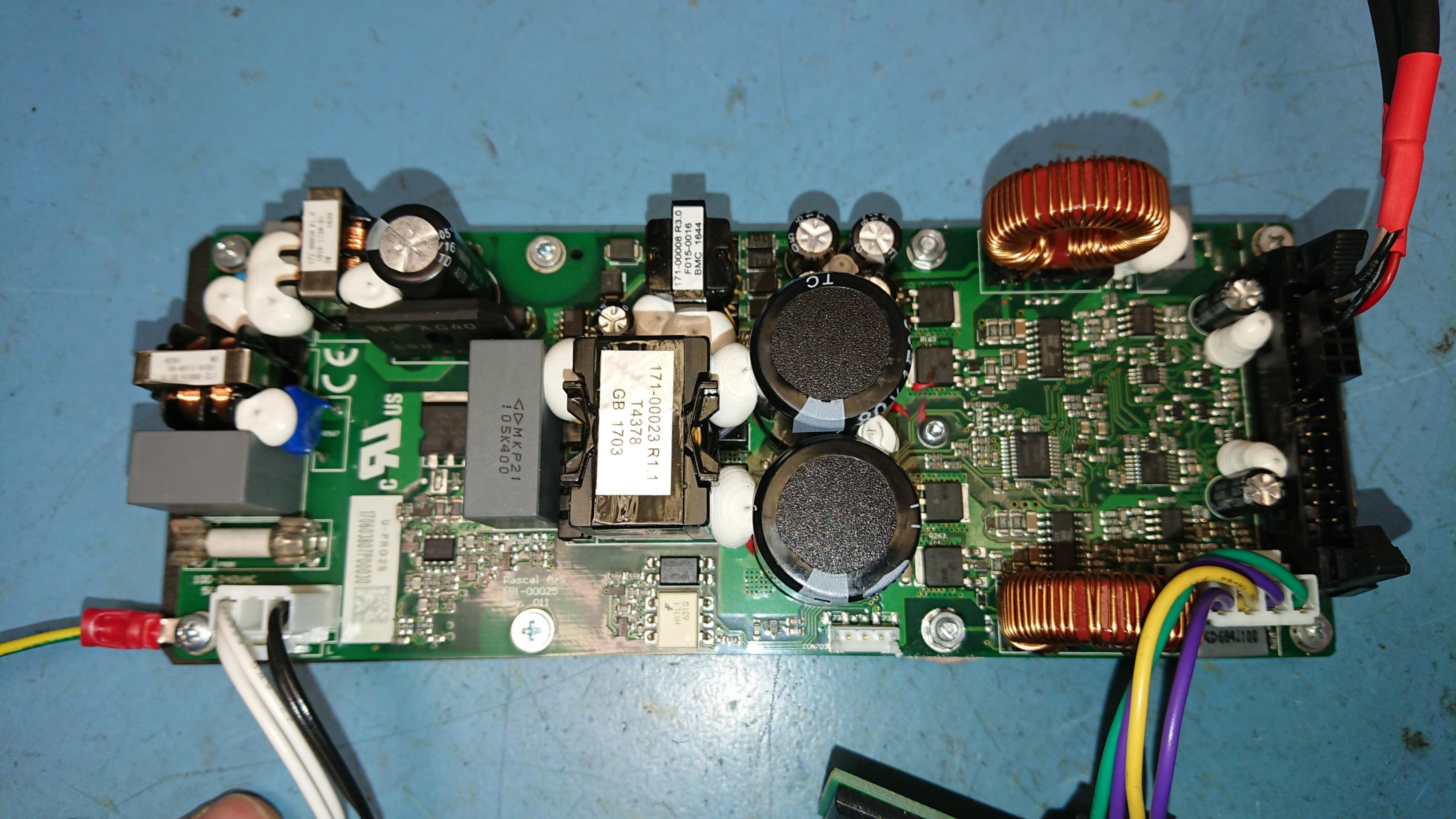

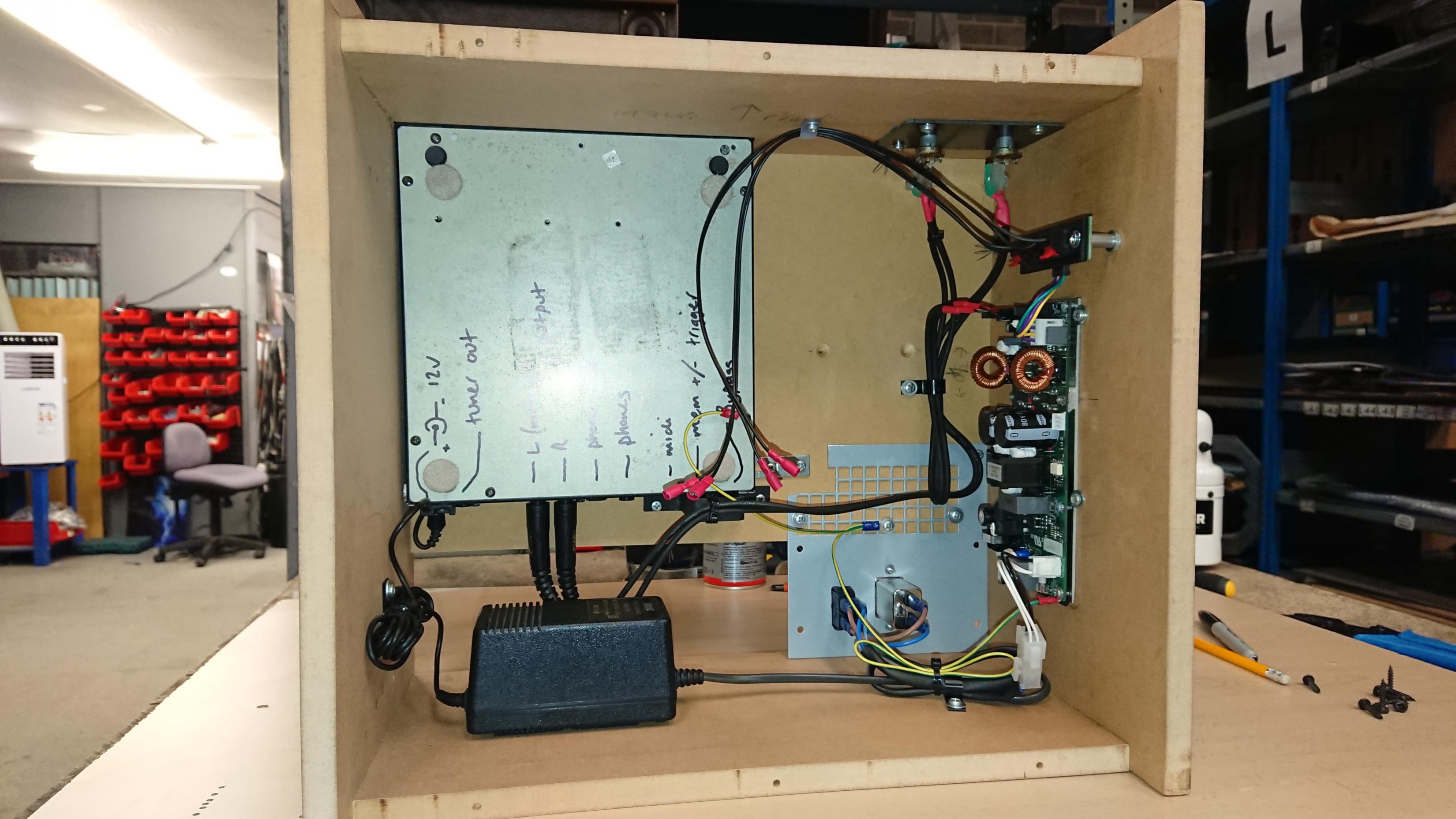

DIY bass amp using ICE 700ASC power module, 3band fixed frequency EQ plus variable high pass filter, one band fully parametric EQ.

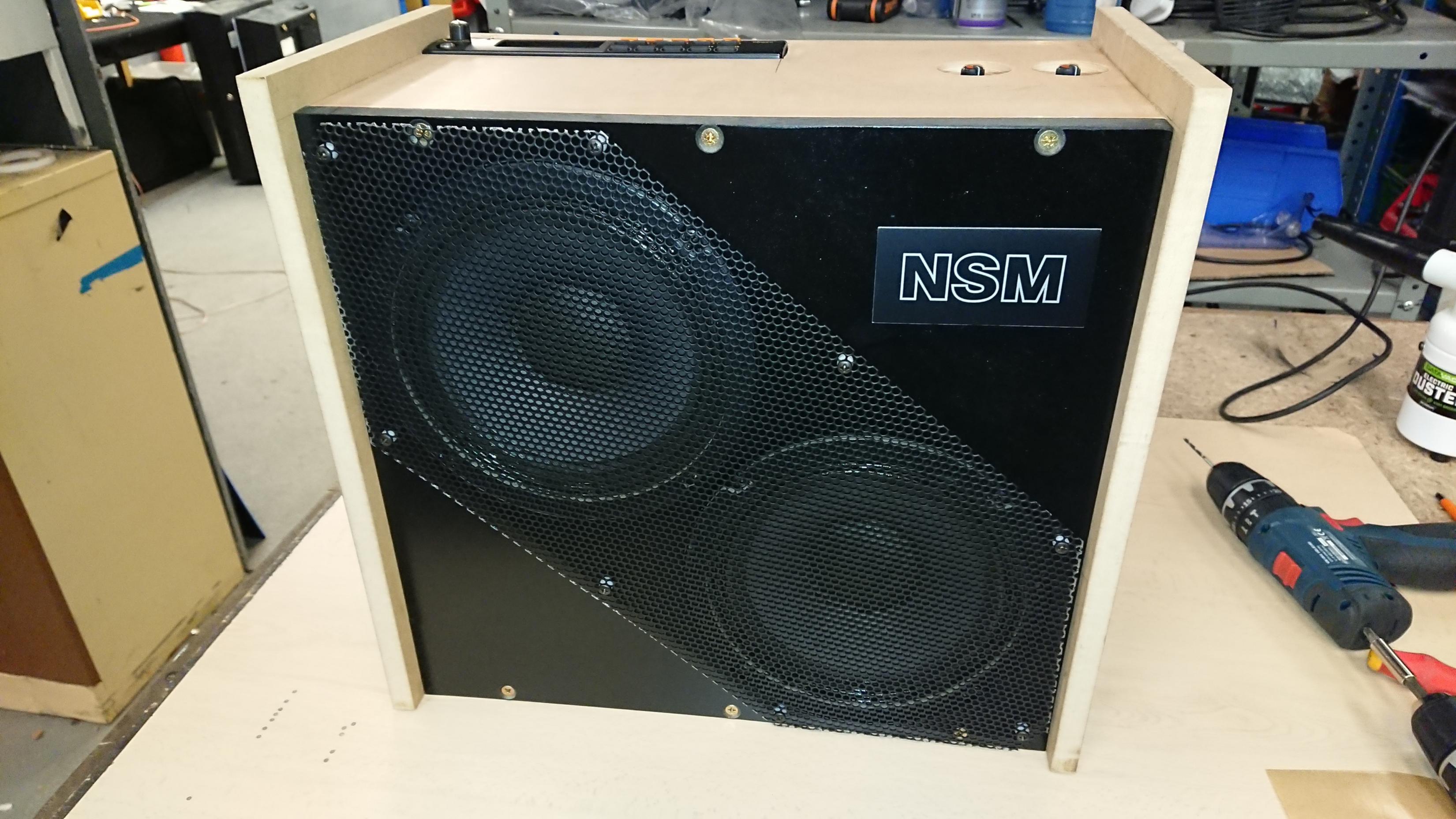

DIY cabs w/ BMS 15N630 woofer, 18Sound 6ND410 mid driver, BMS 4540ND compression driver. Passive 3 way crossover built into top box.

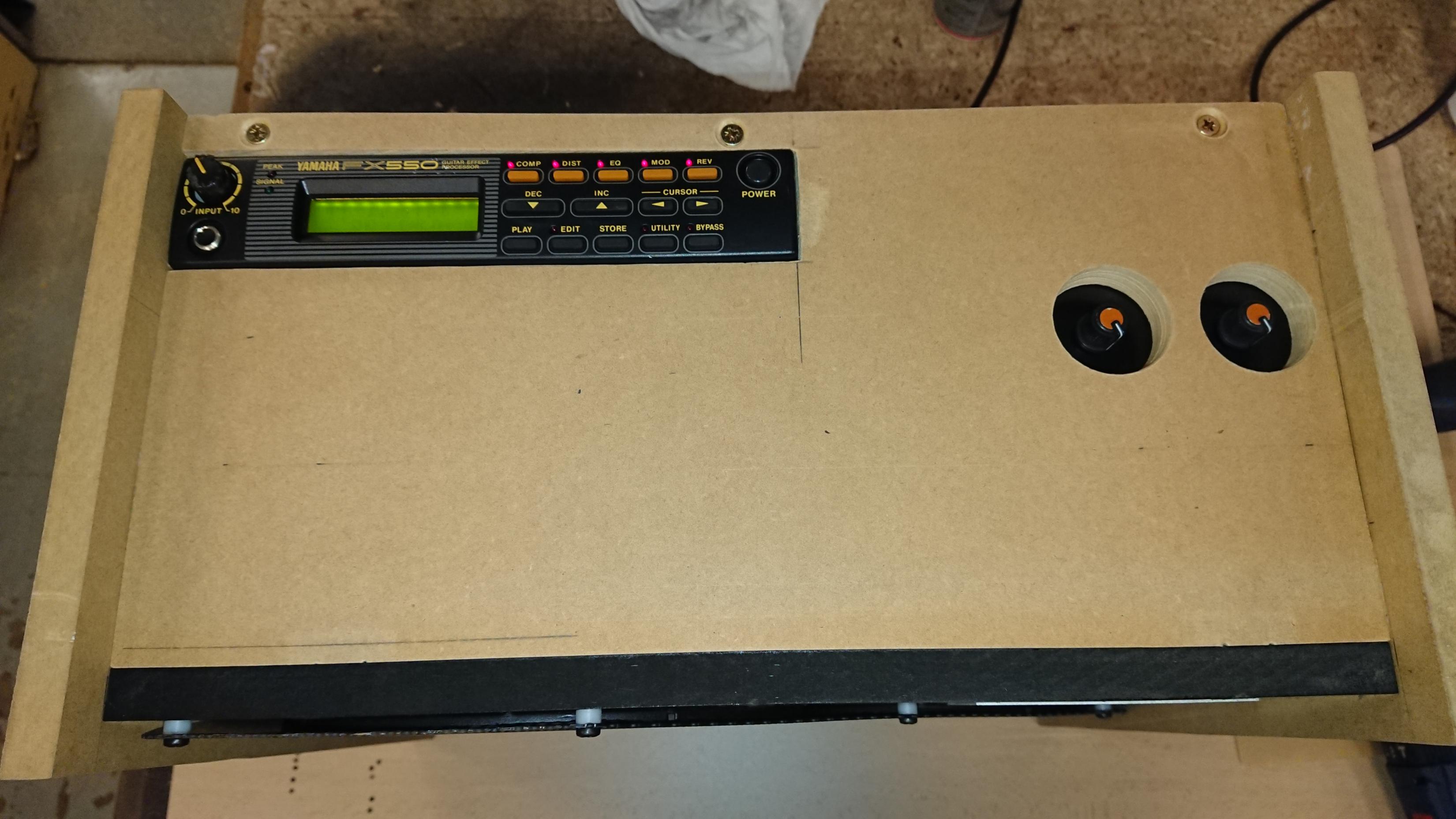

DIY Stereo guitar amp with Yamaha FX and class D stereo amp
Home (work) built cab with x2 Klipsch woofers. In a true Stereo configuration powered by a Pascal U-PRO2S 140wpc digital amplifier and fed from a Yamaha FX550 Pre/fx unit. The idea was to make a portable version of this twin 15" monster [GEAR] My DIY twin 15" guitar / combo amplifier - Hafler T2 preamp, Behringer FX2000 effects, Vintage Carlsbro 300w amplifier. : Guitar Also, here is another (google drive) image from construction showing the back of the cab Shared album - Daniel Shardlow - Google Photos

Dude, That is fkn awesome! I bet that produces 'brown noise'!
There's another matching 115 cab for it, it might get loud! 😎

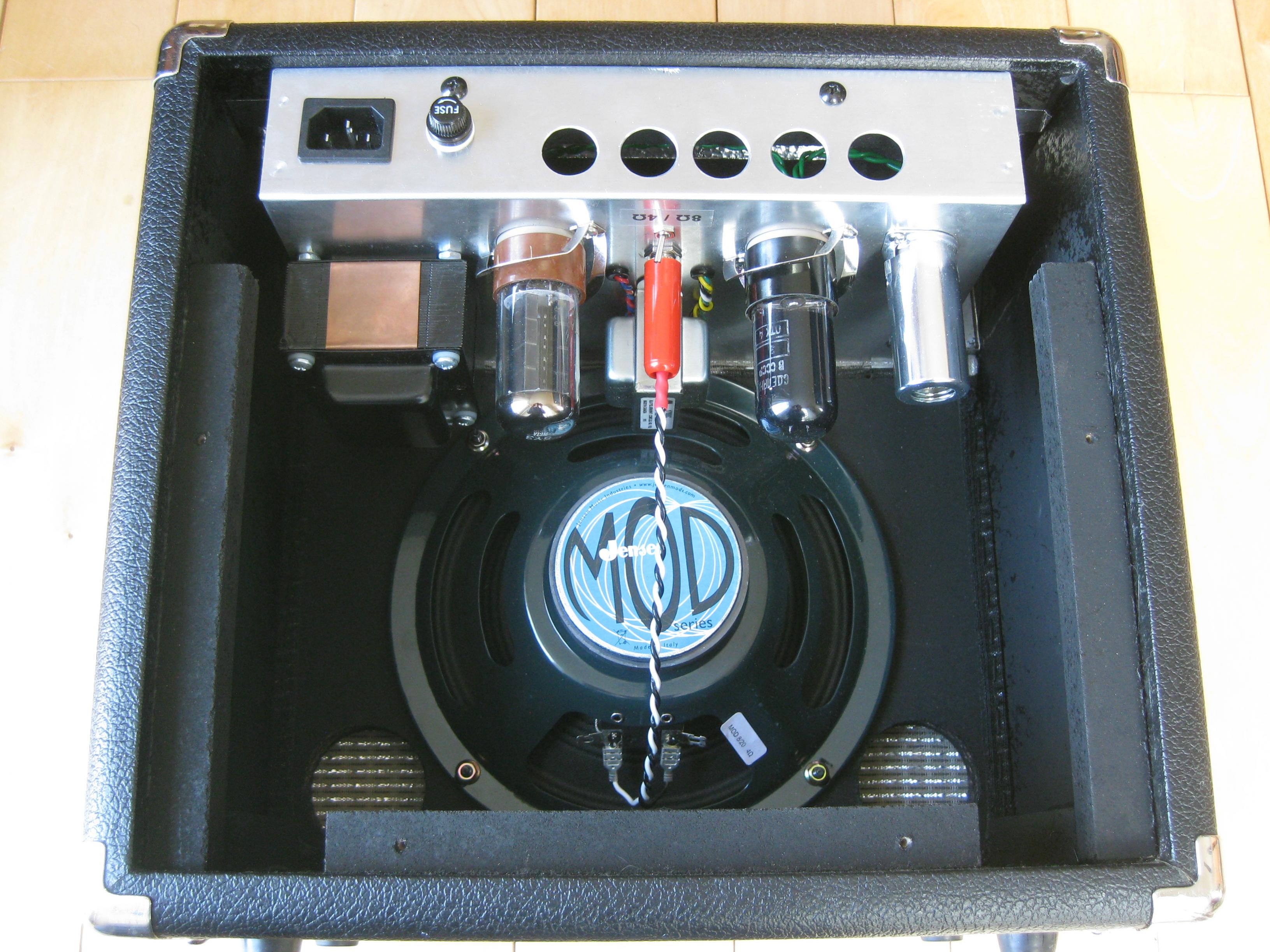

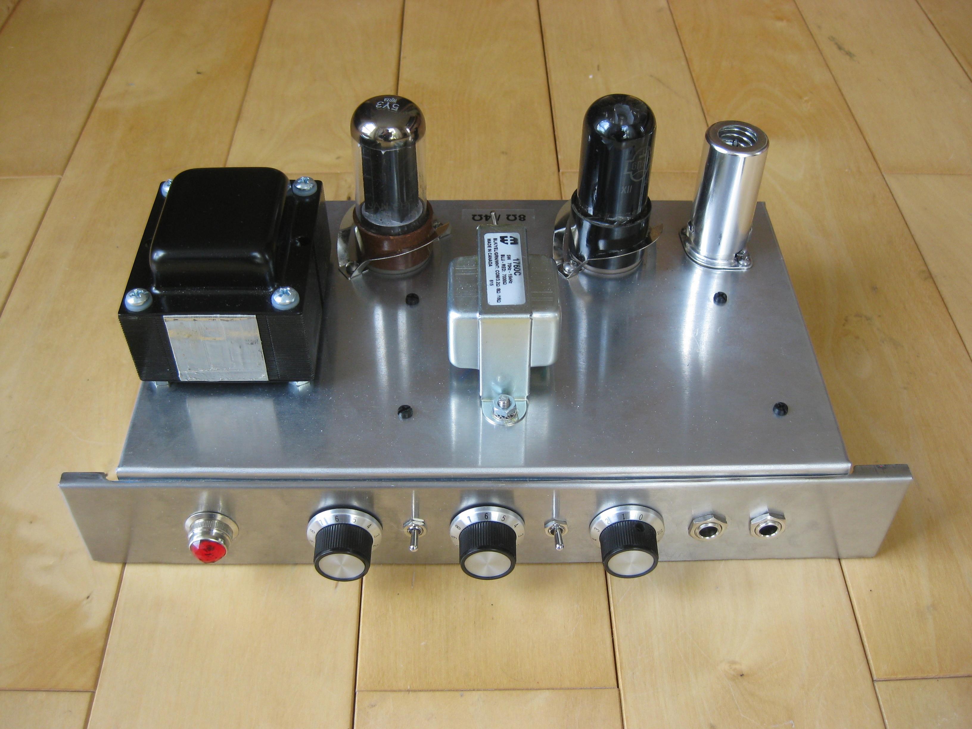

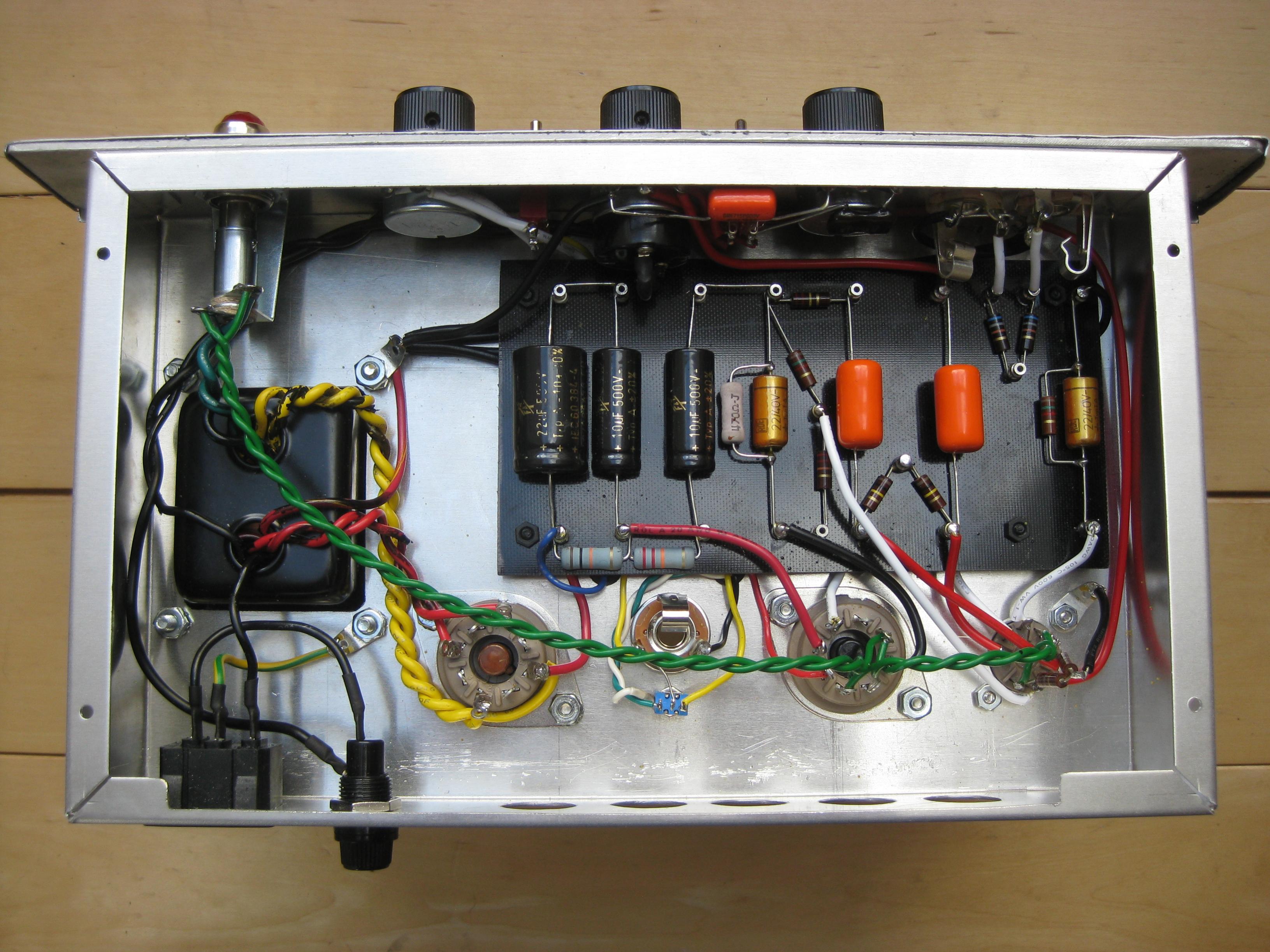

Quickly :
25WRMS output clean tone
8" ME8-100 speaker
All tube
Footswitchable booster
Spring reverb
15.6kg... A mini-anvil !
A+!

That is cute, how does the speaker sound? Not many foam surround speakers used for guitar, in open back cabinets at that.

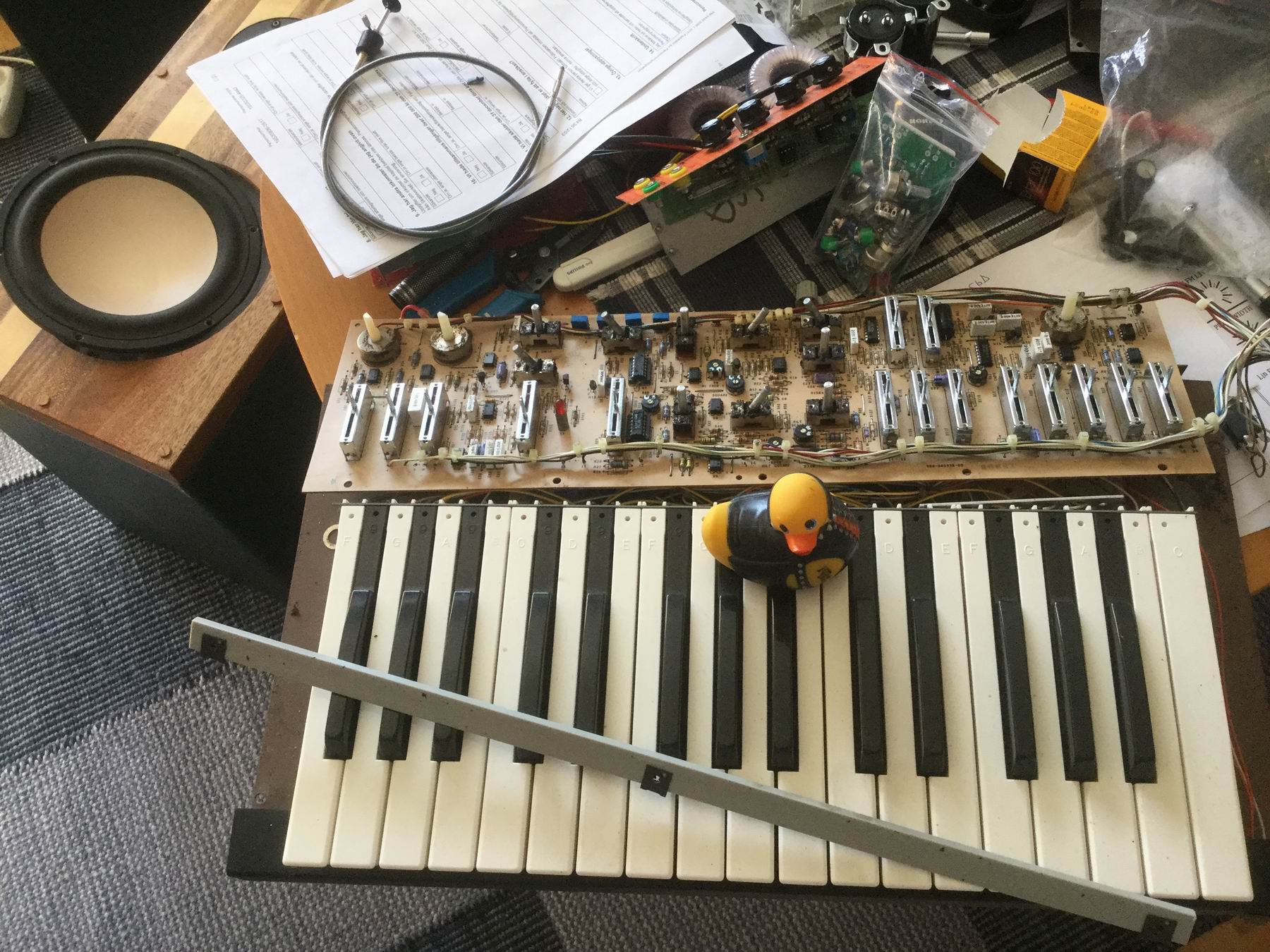

Here's my present projet(s):
Fixing a MOOG MG-1 (got new potentiometers and am looking into "necessary" mods)
Trying to finish a bunch of synth modules (Tube-VCA and Thomas Henry's VCA in the bag)
Adding L-pads to my un-orthodox 2-way speakers (started a year ago

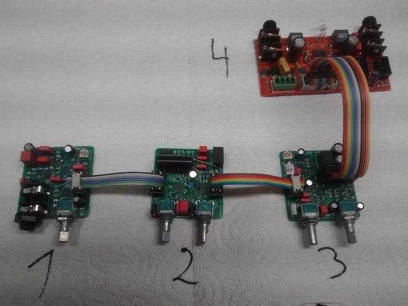

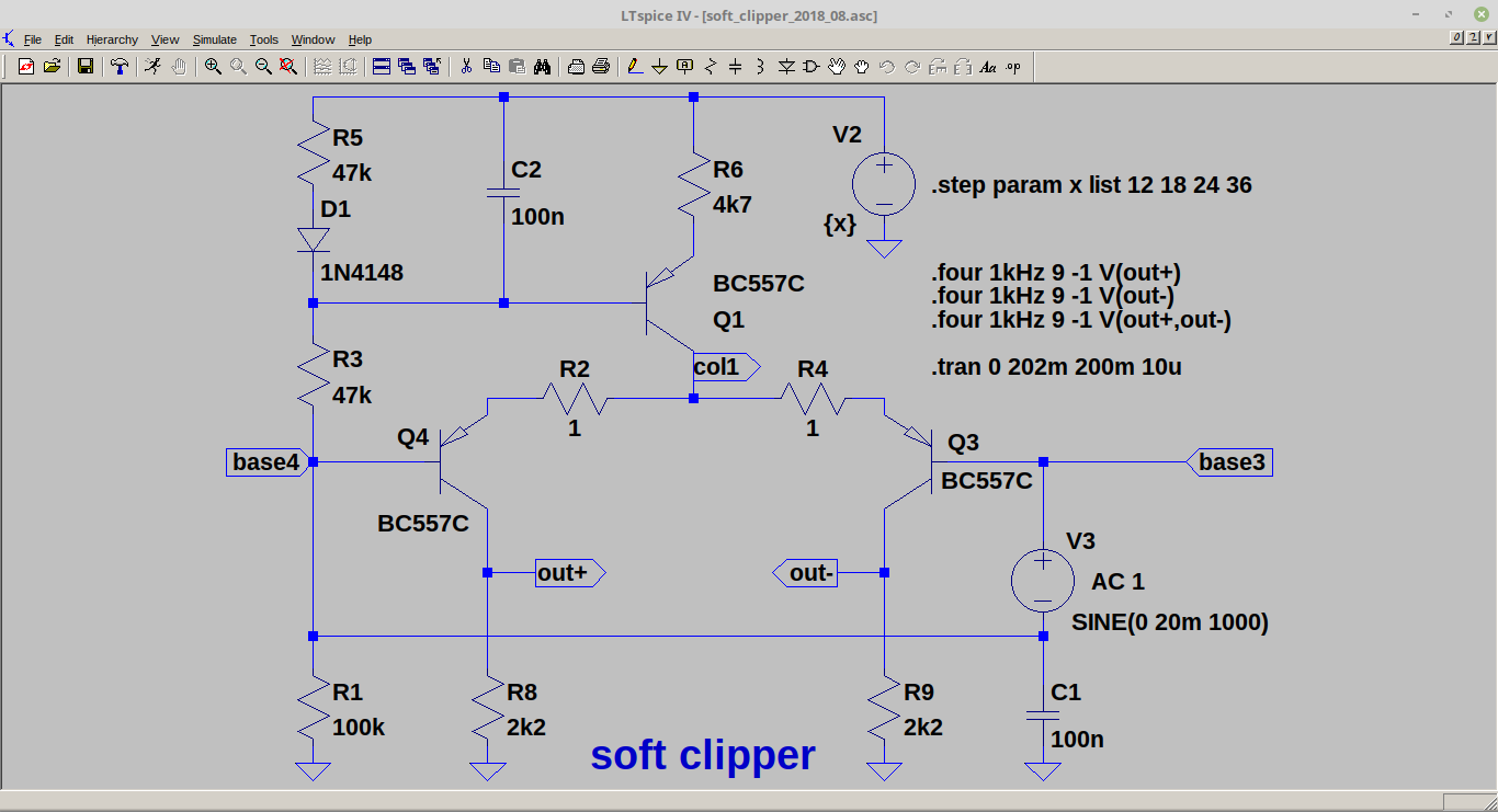

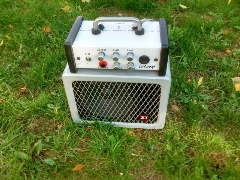

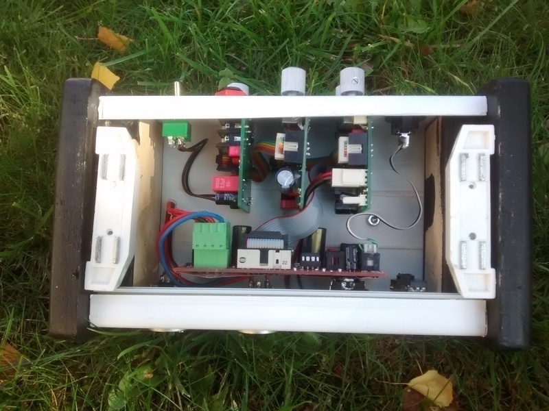

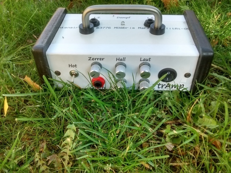

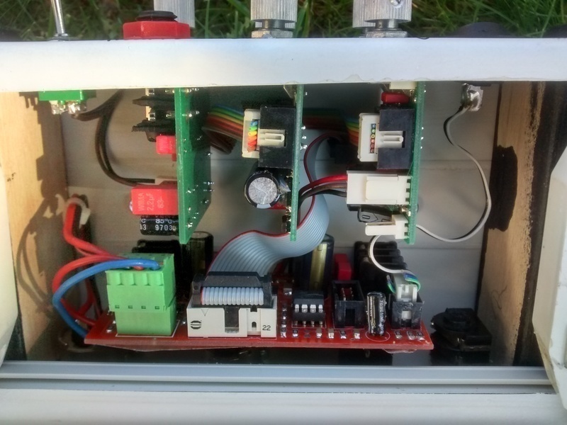

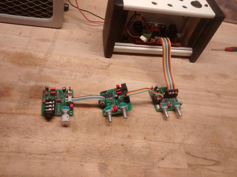

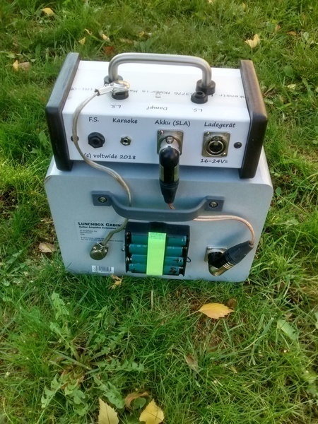

This is my practice amp built from scratch. It provides an input-amp with a normal and hot channel, an electronic reverb/chorus based on FV-1, master channel with 1-knob bass/treble control and soft clipping class-d-amp using TPA3116D2. Powered by 4x18650 LiIon-accus this little beast delivers something around 10Watts into the 4 Ohms Jensen MOD15. No problem to play an entire small club gig without re-charging.
The cabinet is from ZT Lunchbox. I replaced the driver by the above mentioned Jensen.
Perhaps I should mention that once in my life I built a tube guitar amp using 1x EF86 and 1xEL84. That was my first one, in 1967. Since that time I always played on DIY-amps. Without any tubes, for sure!😉

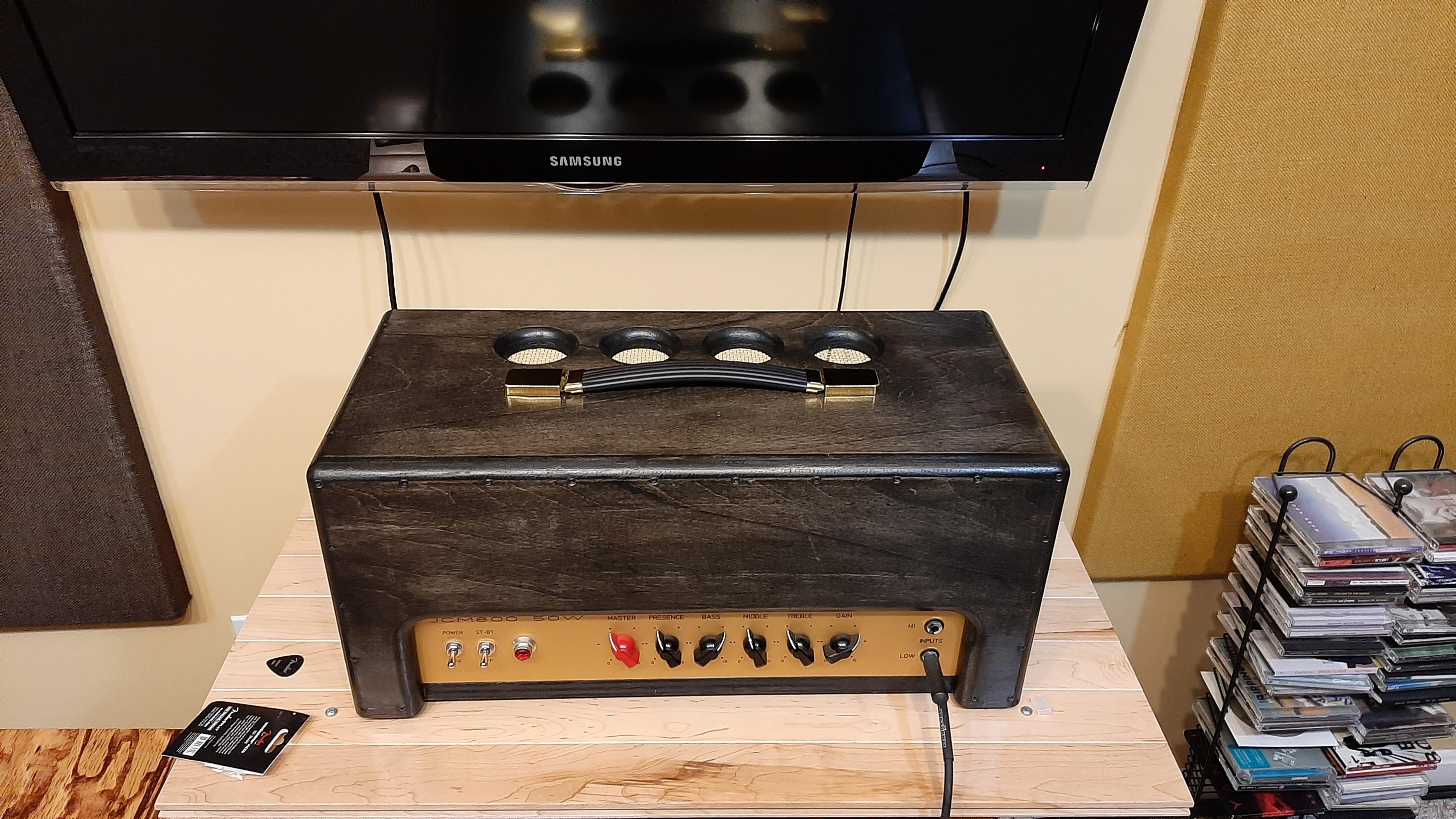

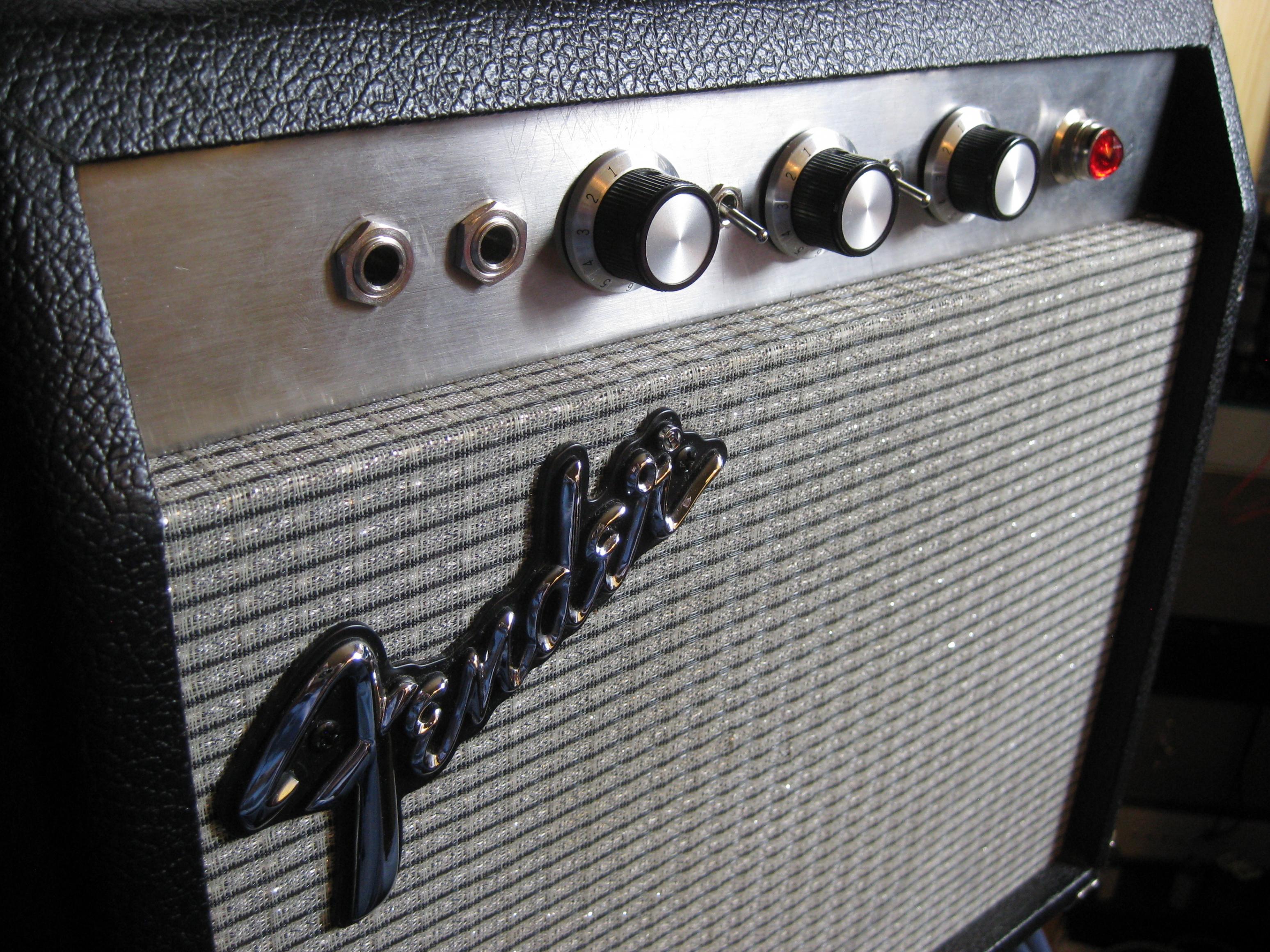

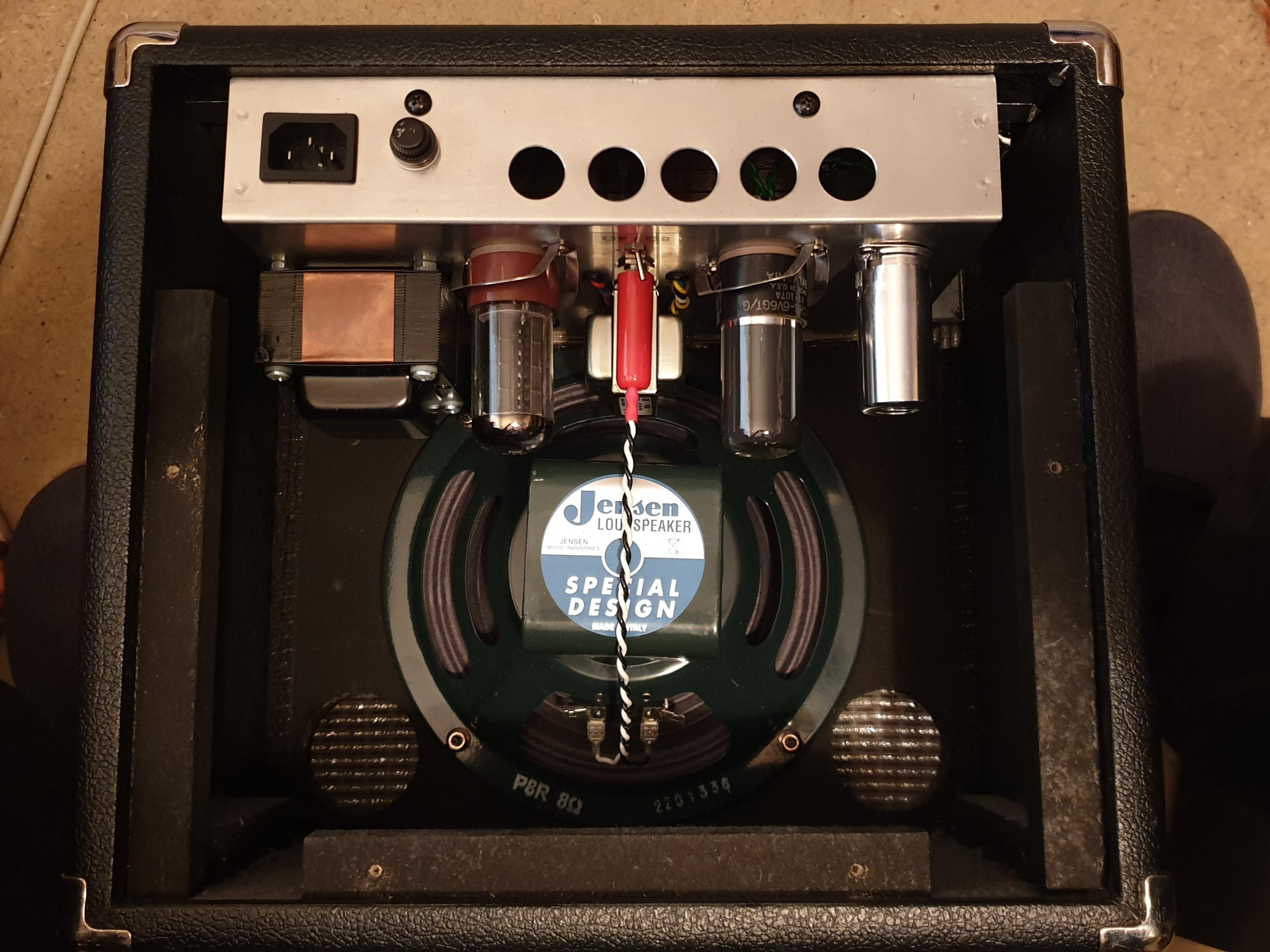

My little Champ..
The enclosure started life as a Frontman 15g which is a 15w solid state amp, all the guts went in the bin and was replaced with a Tweed Champ 5E1/5F1 circuit with a switchable Princeton 5E2/5F2 tone control. Also has a switchable variable feedback control. Iron is all from Hammond, as is the alloy chassis with a brushed stainless steel front panel. Latest change was to upgrade the speaker to a Jensen P8R Alnico magnet. Great sounding little amp...
What are you using for a soft clip circuit? Sounds pretty close to a project I want to do.
