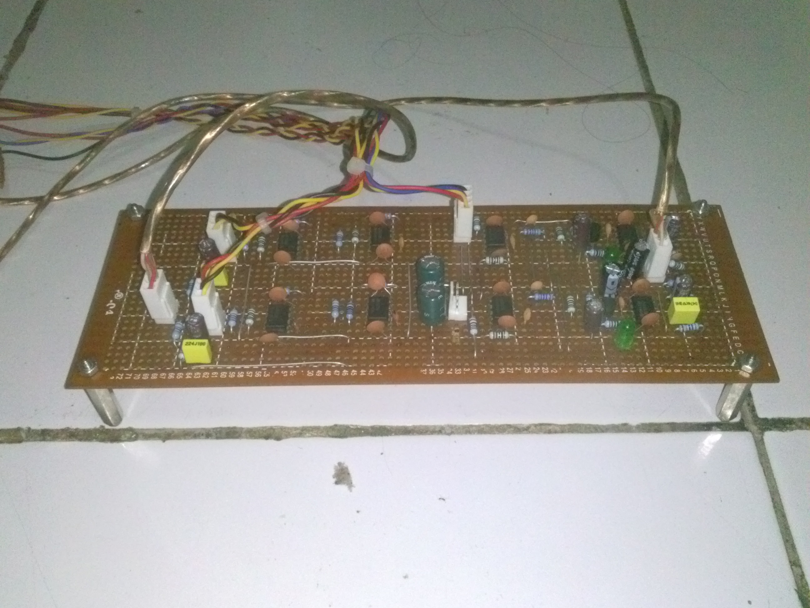

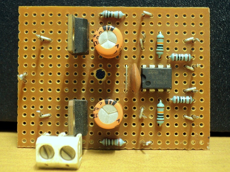

Hey guys. Long time no see...
Here is my direct coupled stereo buffer with on-board +/-15V regulator. Recently built for my VSSA.
my little C-moy(and others) inspired Headphone Amp.
Its working flawless for 3 Years now.
That is a fantastic layout!Its an all out pimeta i understand from the parts.
I love the way you used the sub-board as contacts for the batteries then used another sub board for the cap rails and integrated the buffer into that too.Every millimeter of space has been utilized.I wouldnt dare make such a layout for fear of unstable operation(nay,i cant even think of making one like that and have it even come close to power up)
Its got to be the most beautiful pocket amp ive seen!a little more care with the wiring and you can encase it in acrylic as a work of fine art!
Its 3 years ago that I build it and i don't have the layout at hand. I'm a little bit messy so I don't even know where it is. Same you can see with the wiring...
Its simply an OPA 2134 with BUF634 as buffer and one BUF634 as pseudo ground driver. Im happy that it does not oszillate 🙂
For the first project it looks brilliant !! If it does what it should do its near to perfect.
Somehow I feel a litte bit cheating because most times i use cut out parts of this board.
Its a pitty that i always miss one or two more holes where the arrow is 🙁
If I mount the ICs over the 2 vertical stripes I can use them for power supply.
The card is expensive - for epoxy its nearly 10$ at my area.
Thanks!
I have done small things like rectifier and regulators on strip board, but this was more work in the layout.
I use boards like that at work. They're blue, from RS and called microboard. They are handy for digital work, as you say using the lines under the IC for volts and ground. Easy to bypass supply too. I was going to use 'tripad' board but it needed too many link wires.
Very nice work Fonebones!! 🙂

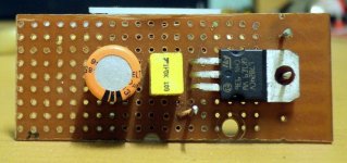

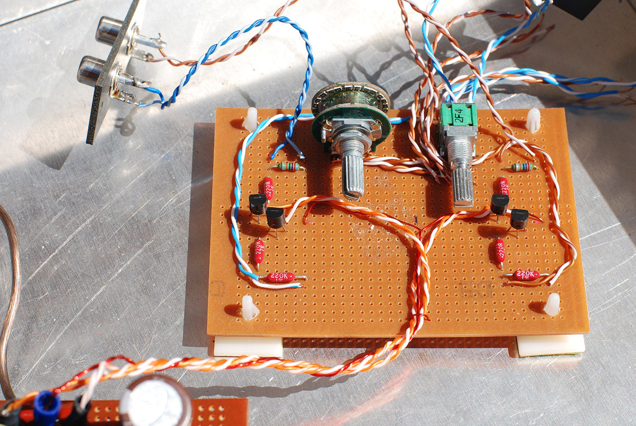

I'm posting my latest veroboard construction. A DC-B1 buffer 🙂 Very happy with it's performance!
Third pic shows it in prototype case (there is more to come) This is just a temporary step to get something functional. The next part may or may not be on verro-board though. The PS is the one I posted earlier in the thread. As you can see I move slowly :snail:
Tony.
