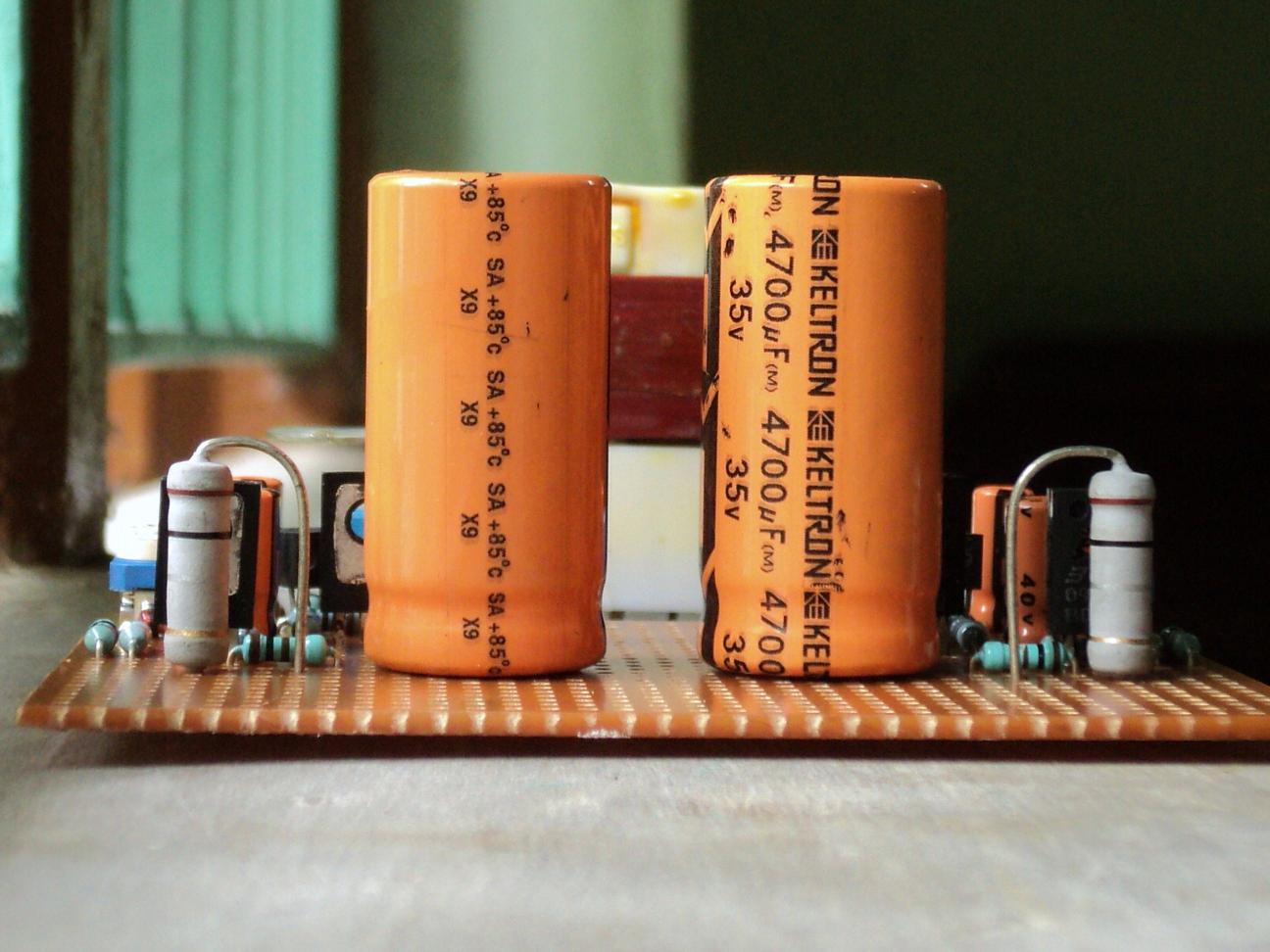

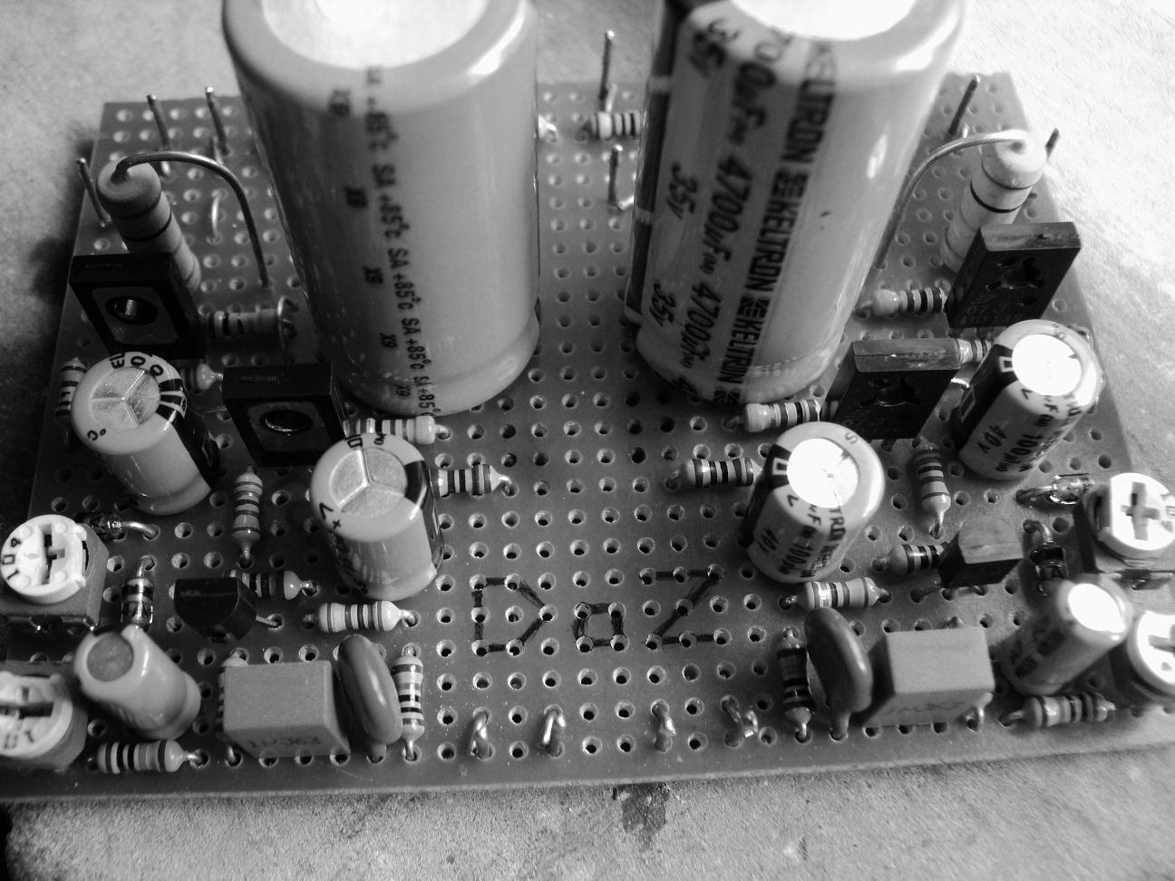

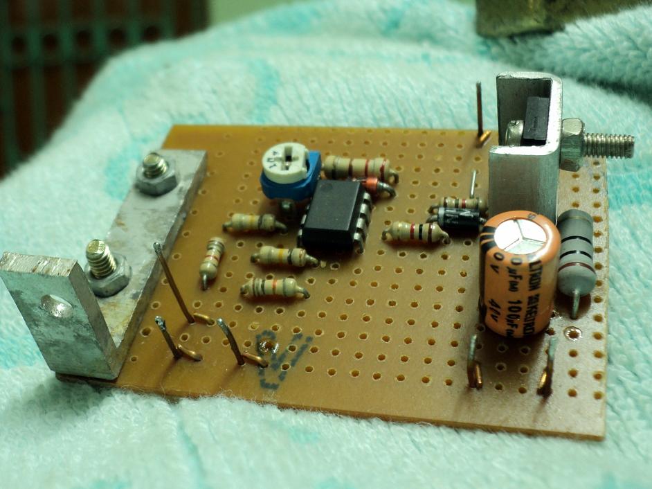

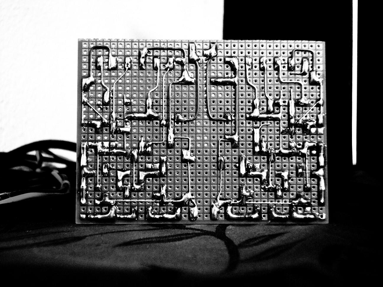

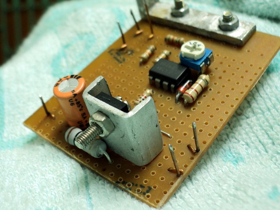

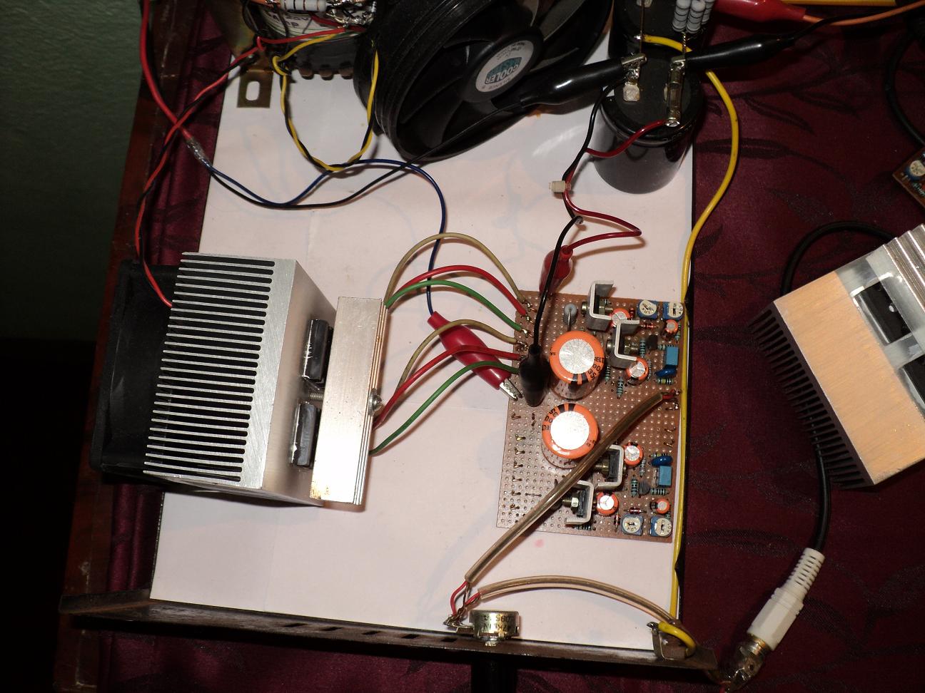

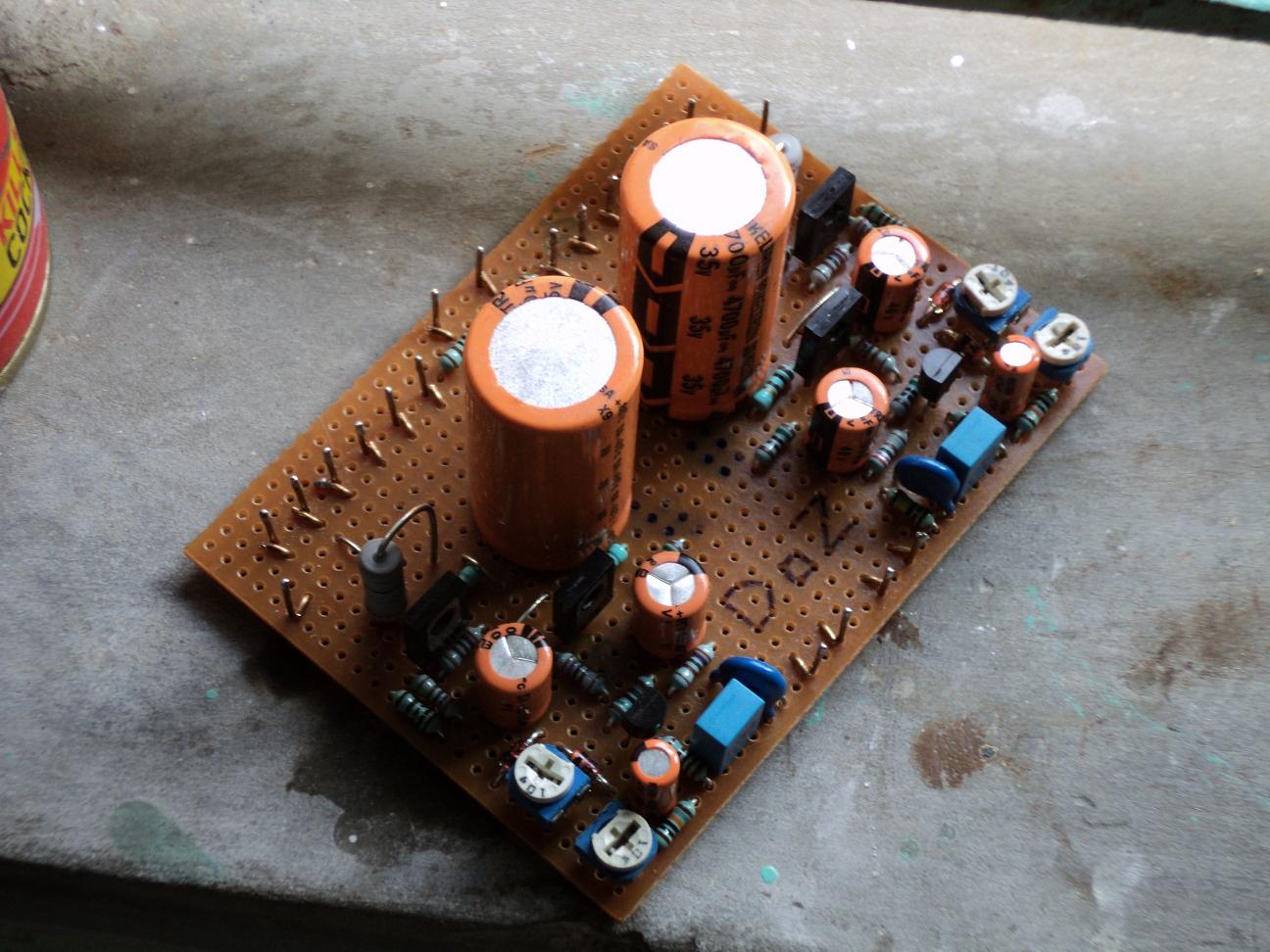

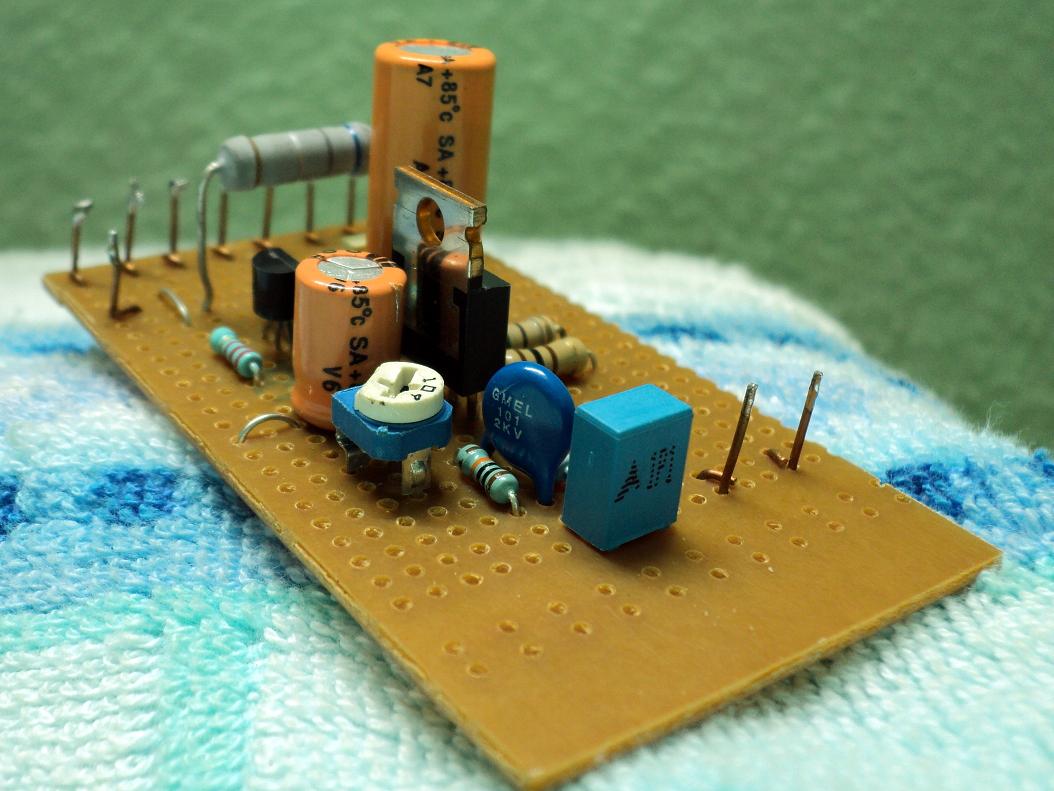

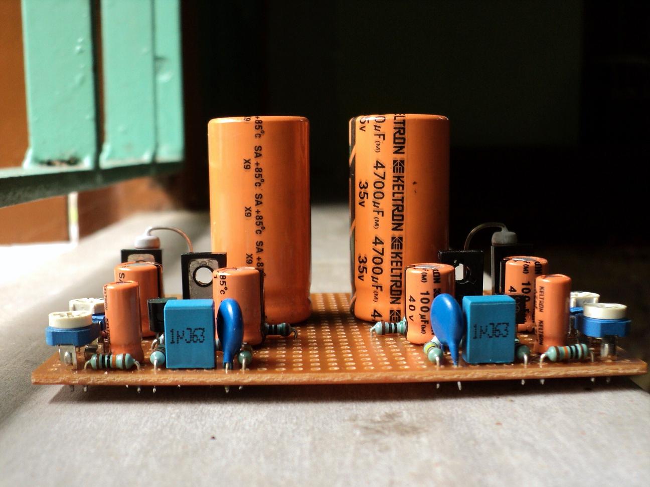

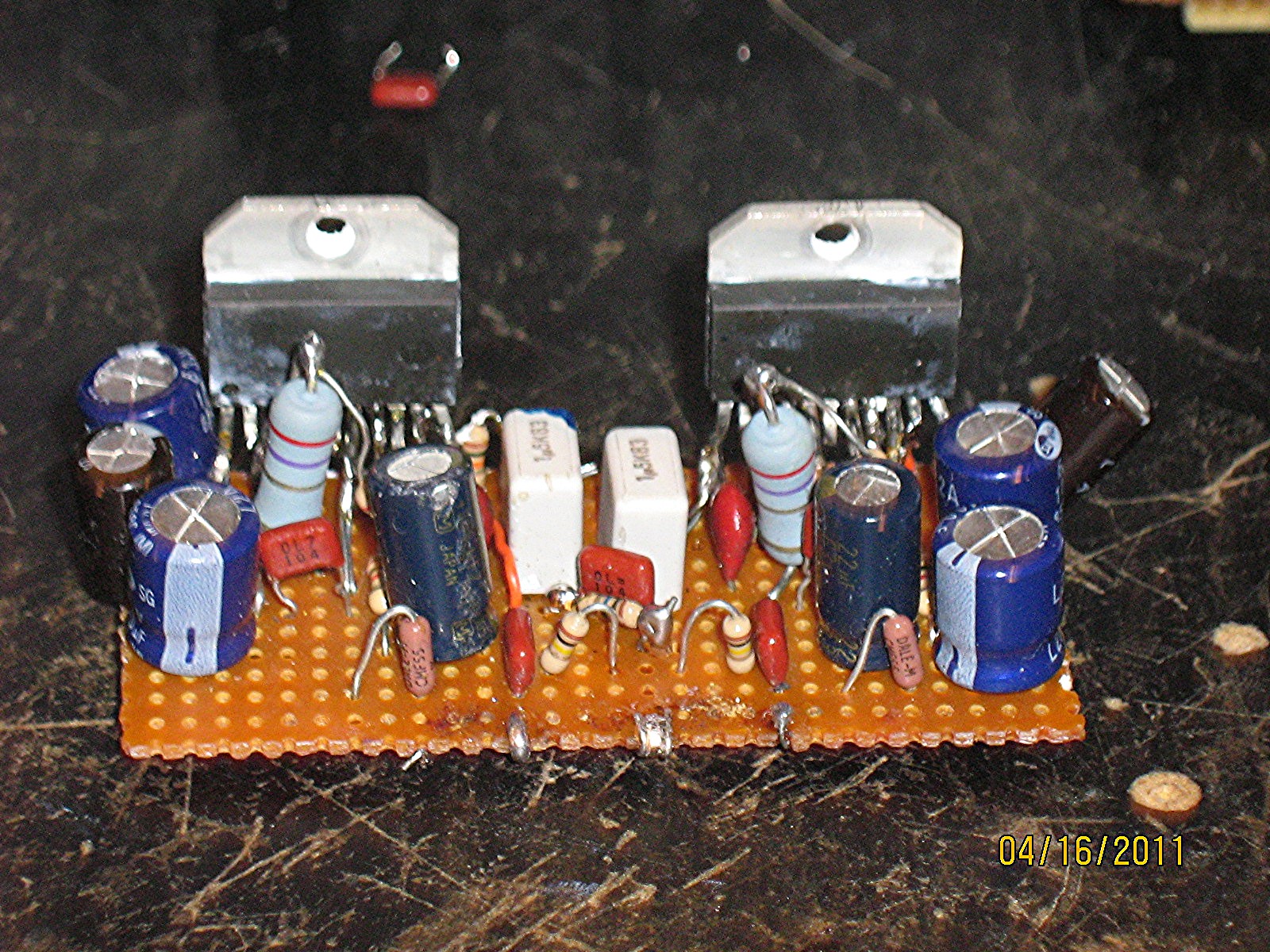

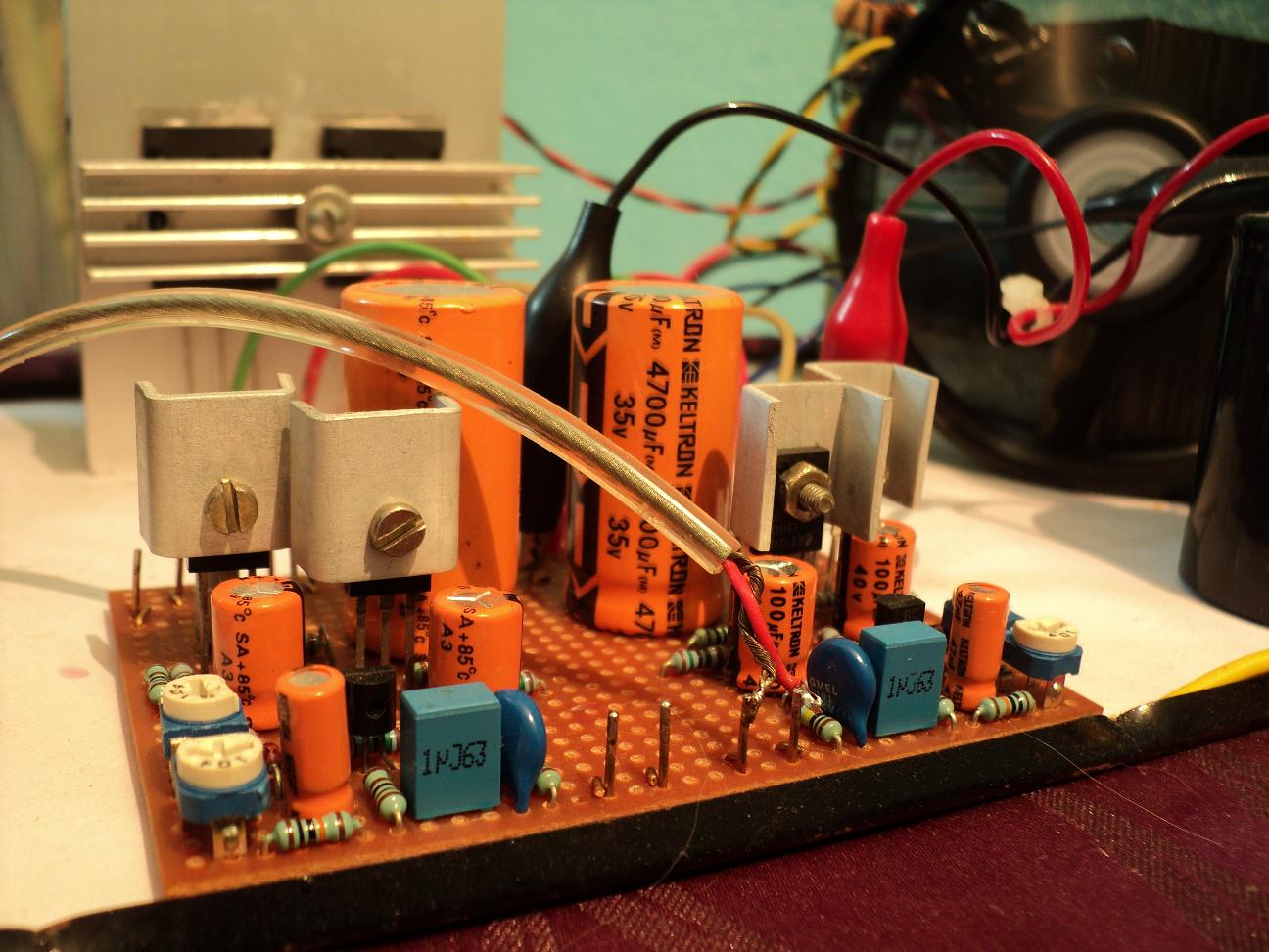

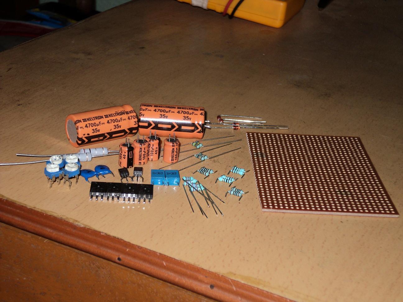

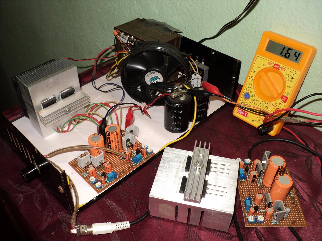

The Perf-Board is my canvas, the soldering iron is my brush, and the components are my paint. I'm an artist and a pirate! Here is evidence of some of my crimes over the last 35 years!

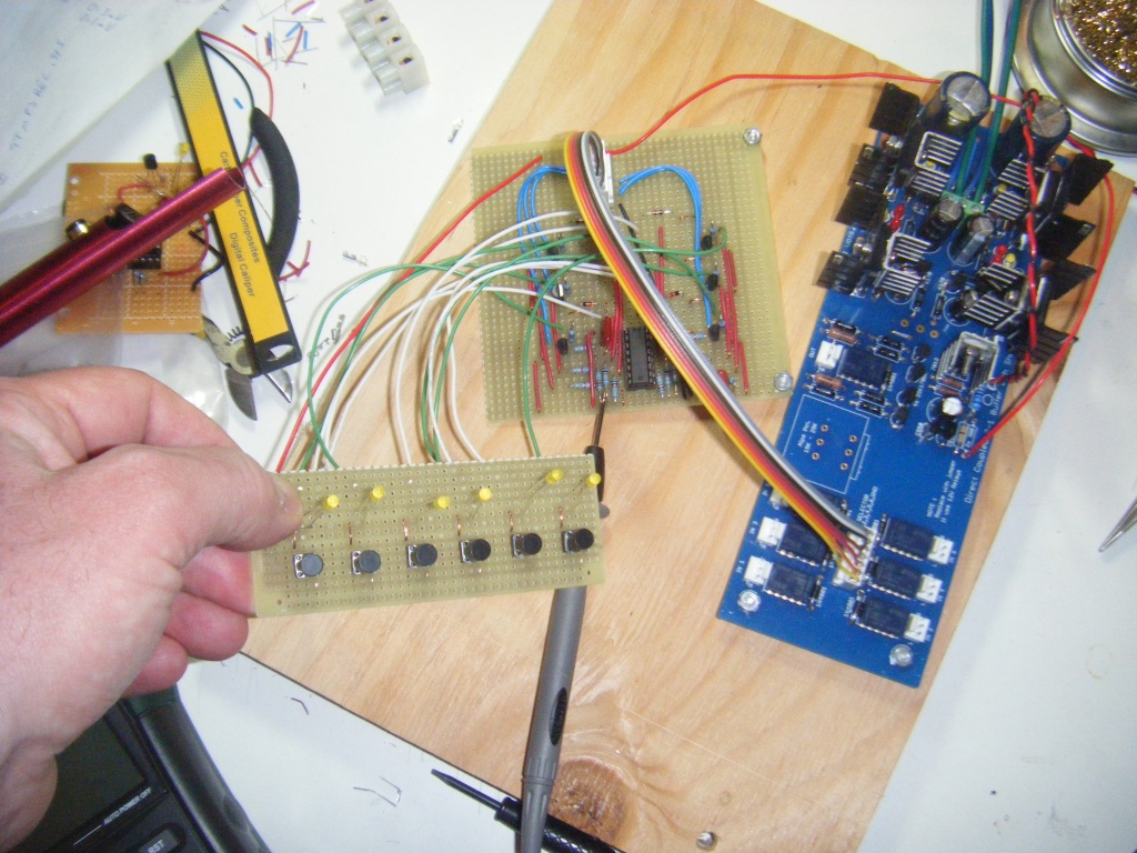

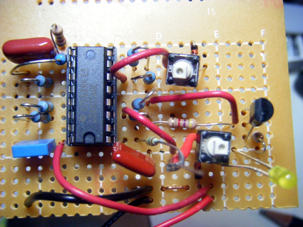

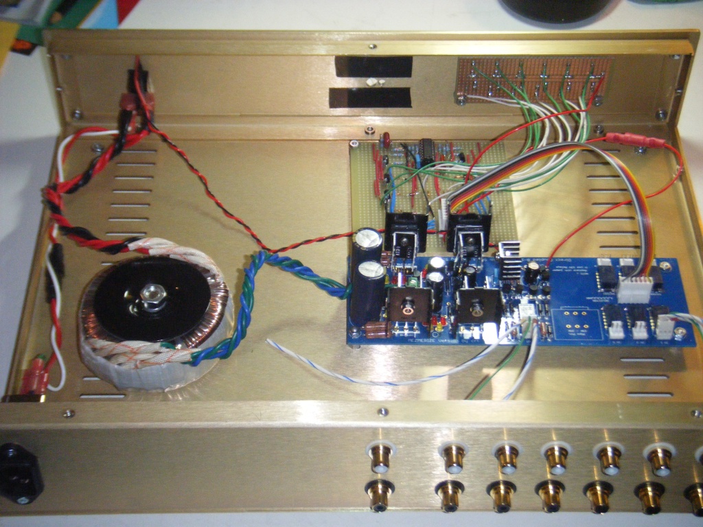

Here's my little recent project. I just wanted a circuit to replace a 6-position rotary switch with some momentary contact tactile switches, and some LED's to show which button was pushed. I wanted to put it all on one board but ran out of space so put it on 2; then I didn't have enough ribbon cable or Molex connectors so had to wire a bit of a rat's nest.
Here is my proof-of-concept prototype:
Here is the final circuit:
Here it is in the case:

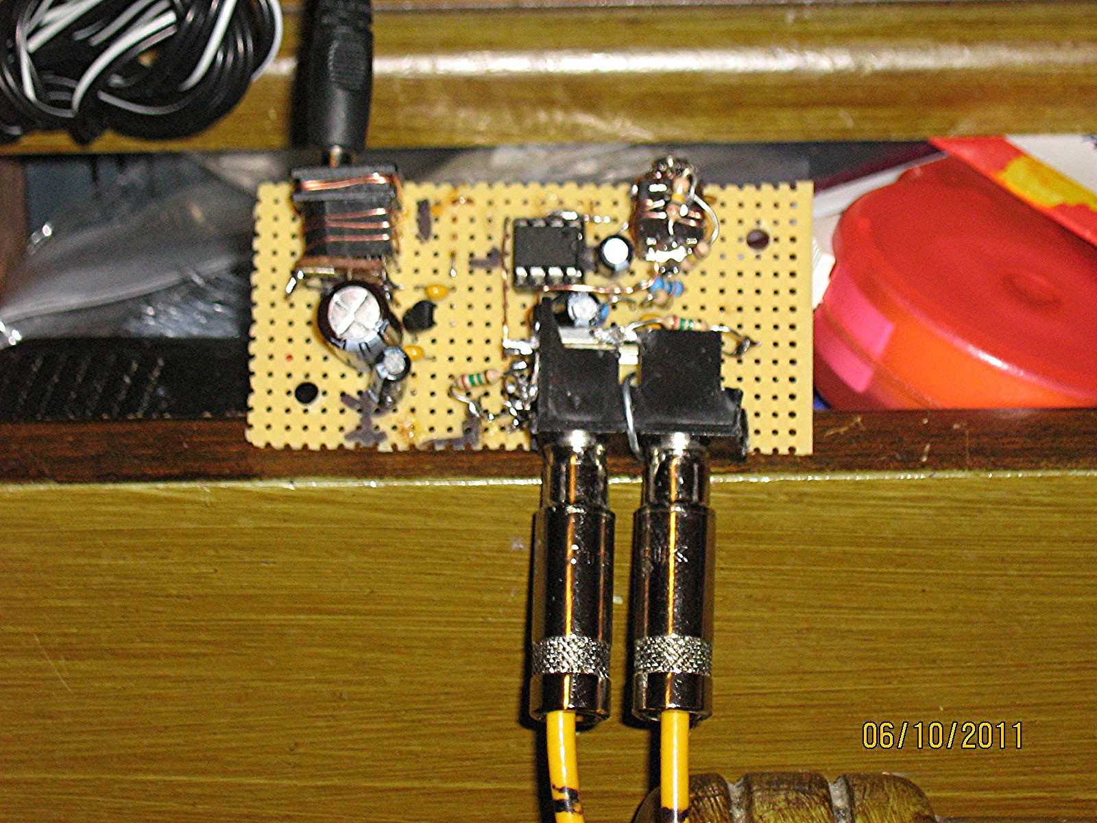

PiezoMatch

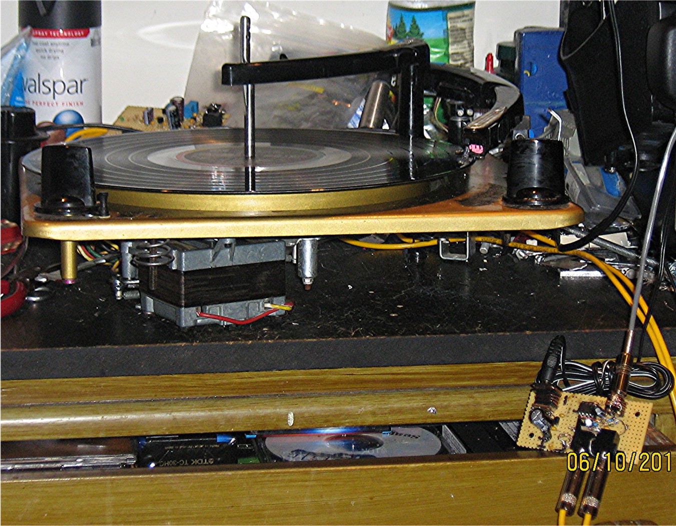

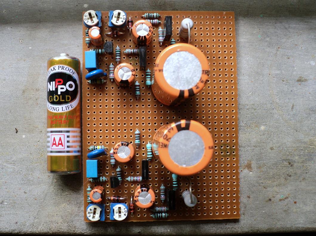

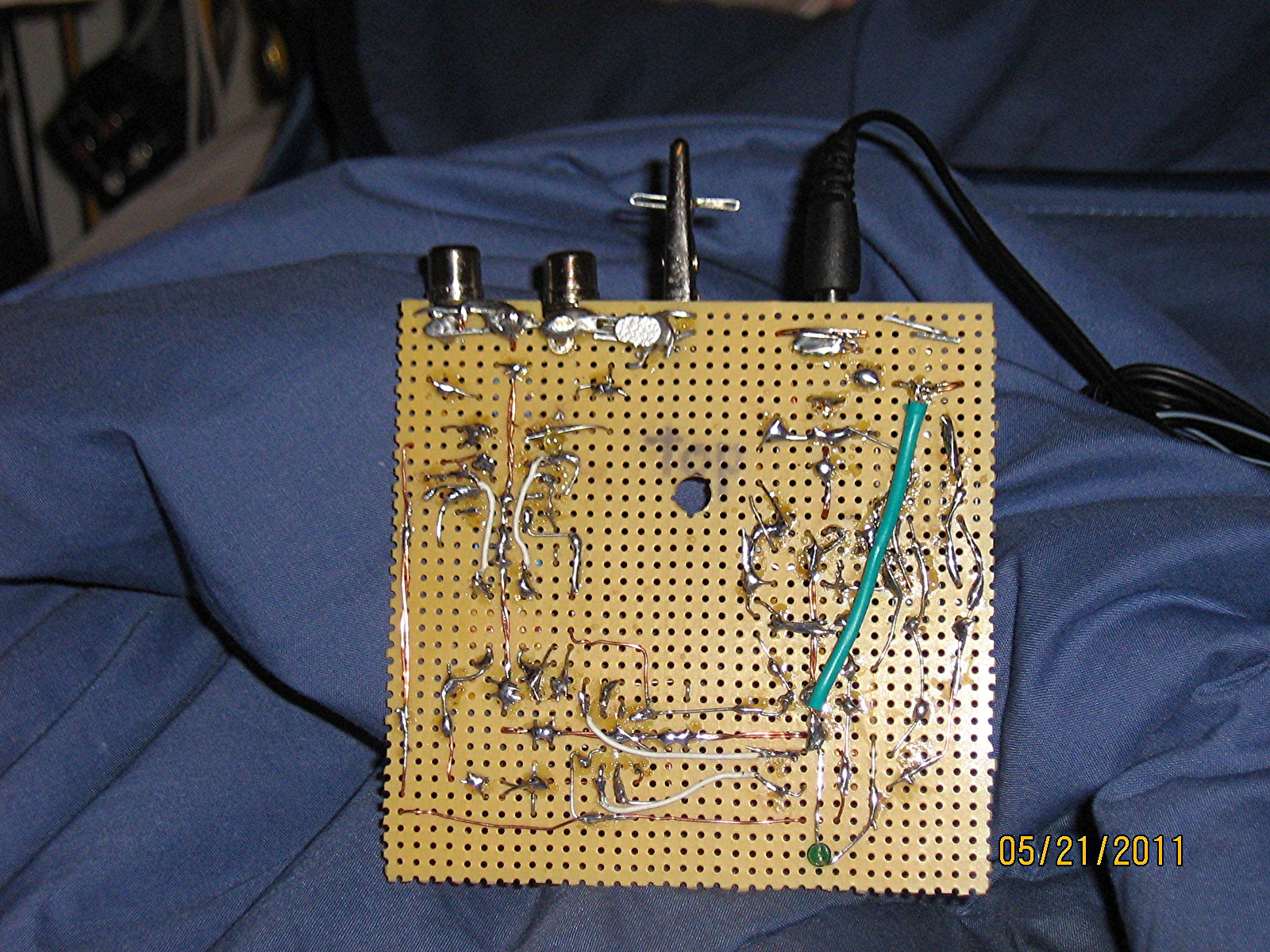

Here's a Piezo Cartridge-to-Line output impedance matcher that I completed a couple days ago. It's configured to load a crystal cartridge with 2.2 megs and drive line inputs down to about 3K or so.
Mom had me empty the electronics out of an old 1958 Magnavox console. The Callero changer is massive in weight and construction. The cart and needle were in very good condition, so I cleaned and lubed her up. The PiezoMatch is extracting unbelievably good sound from that Callero. Must have been one of the few really great piezo cartridges ever made! That Callero should be performing on You Tube in the next few days.

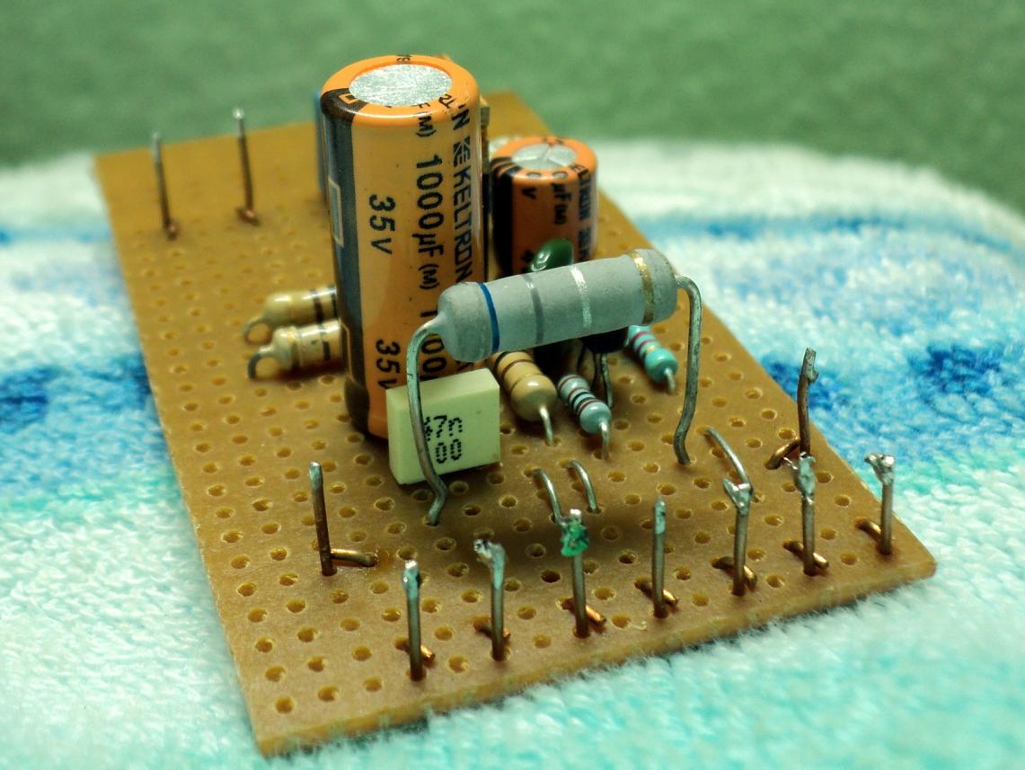

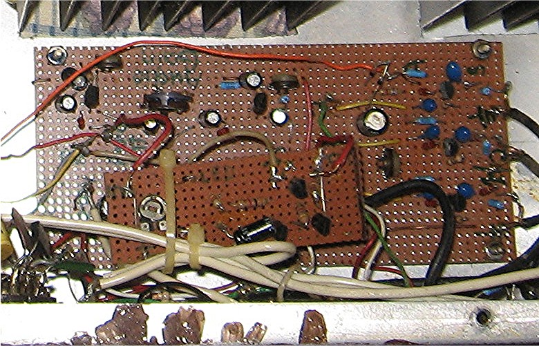

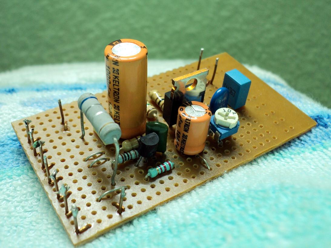

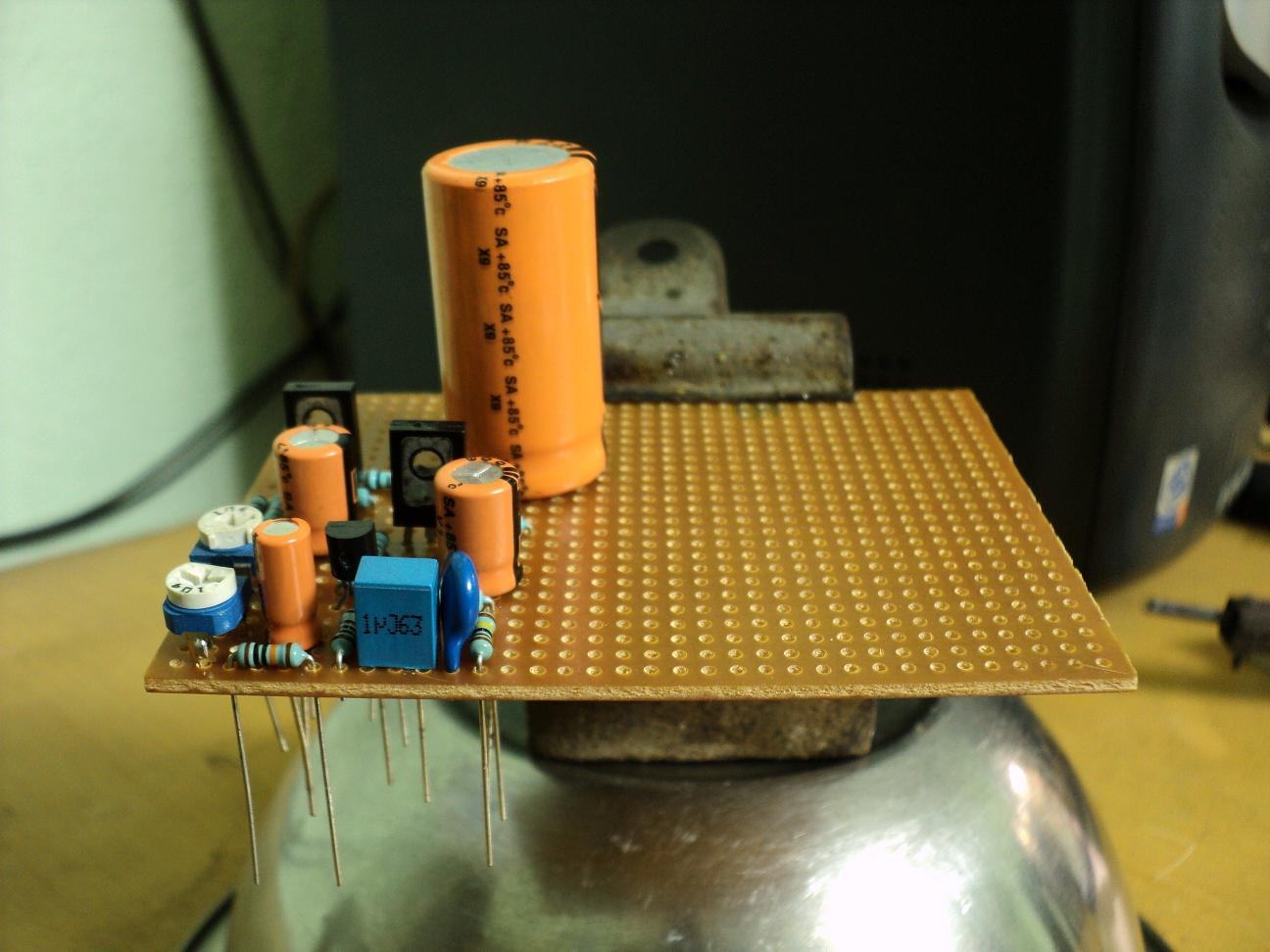

ESP's Thermo-Fan controller. This is a fun project! Especially when you see that you can start the fan by touching the sensing diode! Made for the Subwoofer amp. I didn't use it in my system though. Just used a LARGE heatsink and a fan at low but constant speed.
Link-> Thermo-Fan to keep your amplifier cool

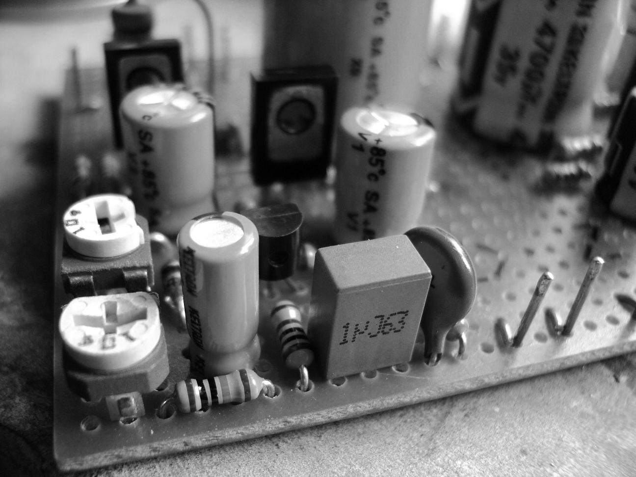

I ofcourse would like to make real PCBs for my projects, but since the proto-types keeps on changing, I have somhow ended up in 10 years of veroboard making.
But hey: some of the first ones are still running great, so I guess it is safe enough.

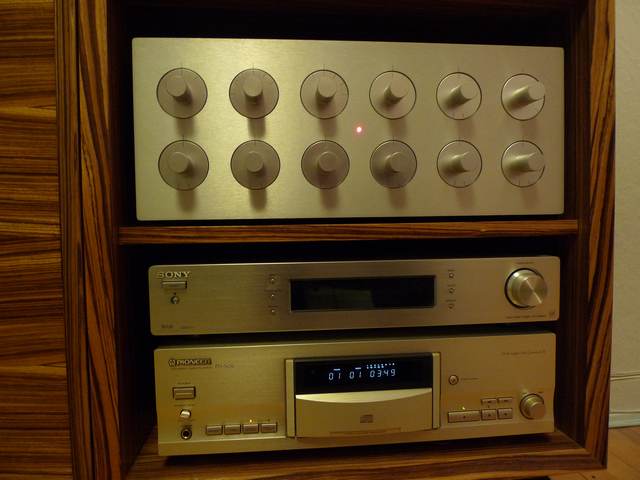

Here is my latest: Cello Audio Palette copy.
Vero-board densely populated for the equalizer-part.
Maybe you know this situation:

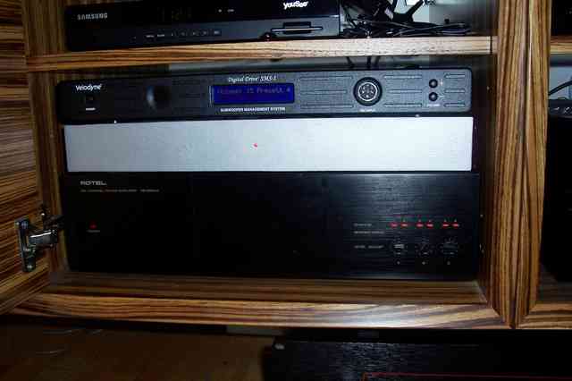

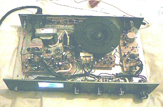

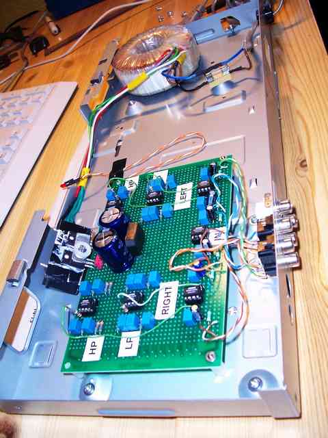

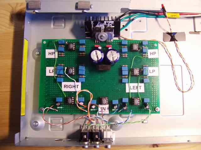

..and my 24dB Linkwitz Riley active crossover with OPA 2134 and 2% capacitors.
In the pictures it is a stereo two-way. It has later been expanded to a stereo three-way. Works and sounds excellent, and is by far the biggest upgrade one can do: Go active! Then you can also benefit from some of all your other DIY amps 😀
(cabinet is an old DVD player)

That looks nice.

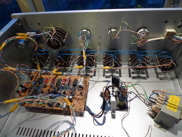

Wow! 10 ICs on a vero? Bravo!
