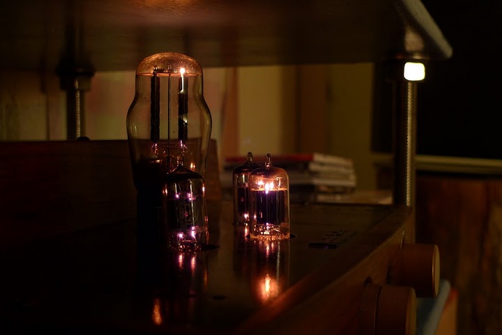

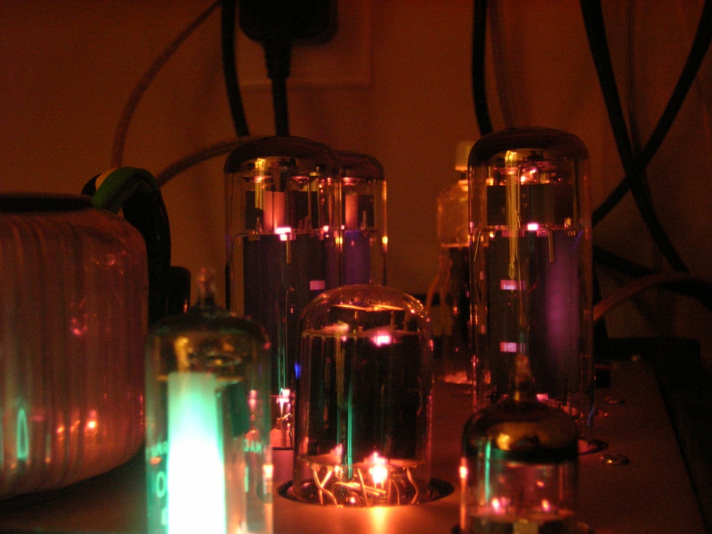

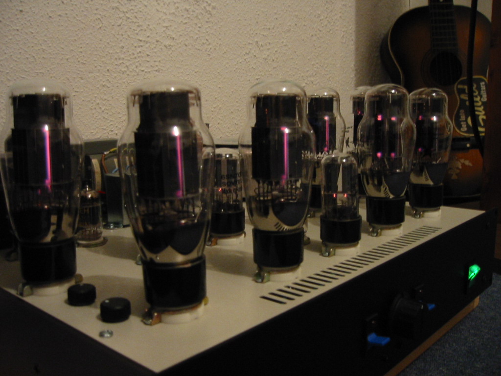

No, 4 stereo amps plus a linestage all using 6HS5 in a single chassis. This was powering a 4 way active speaker system
Thomas
OTL?
Thomas

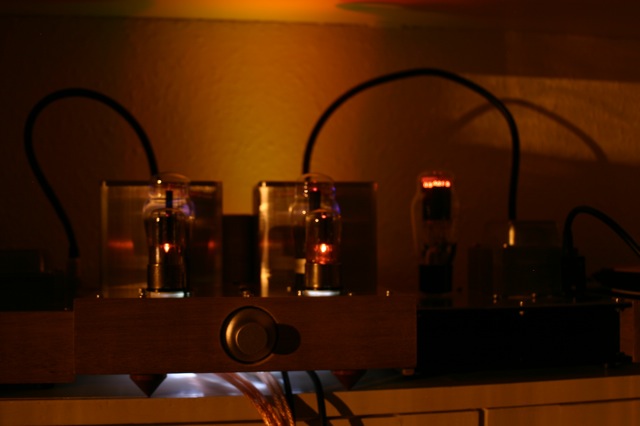

What bias point are you running the 6HS5 at (B+, current, and possible grid voltage) I have worked with this tube and its relatives before and plan to revisit it again soon. I was looking at 500 to 600 volts with G1 positive for the entire audio cycle. Oscillation and instability due to a clip lead layout with poor grounding brought a halt to those experiments.
Hi!
So far I only used it in Class A1. I have built various amps with B+ in the range 1.1 - 1.3kV. Grid bias in the range -3 to -4V, 25-30mA. These can be run hard at the limit of plate dissipation and even a bit beyond.
I did SE and PSE with up to 4 of them in parallel.
I also used it in phonostages, with B+ up to 2kV, then at reduced current, around 5-10mA.
I have only done brief experiments with Class A2. Will revisit that gain in the future.
Best regards ... Thomas

Thanks for the info. Some people have used them for BTL OTL electrostatic drivers at voltages up to 2 KV. I am looking for something to make plenty of power in P-P with reasonably priced transformers. The transformer requirement linits the plate voltage.
Hi!
The Lundahl LL2735B which I convinced them to make for SE amps with the 801A, also works nicely with the 6HS5. It can handle the voltages easily.
I have used the Lundahl LL9202 for PSE versions
Best regards
Thomas

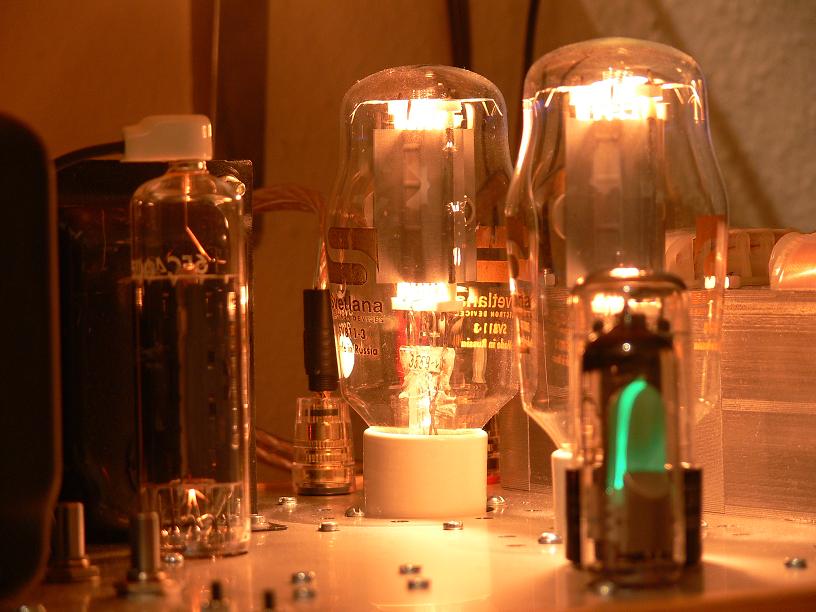

A demo preamp I had for a few weeks

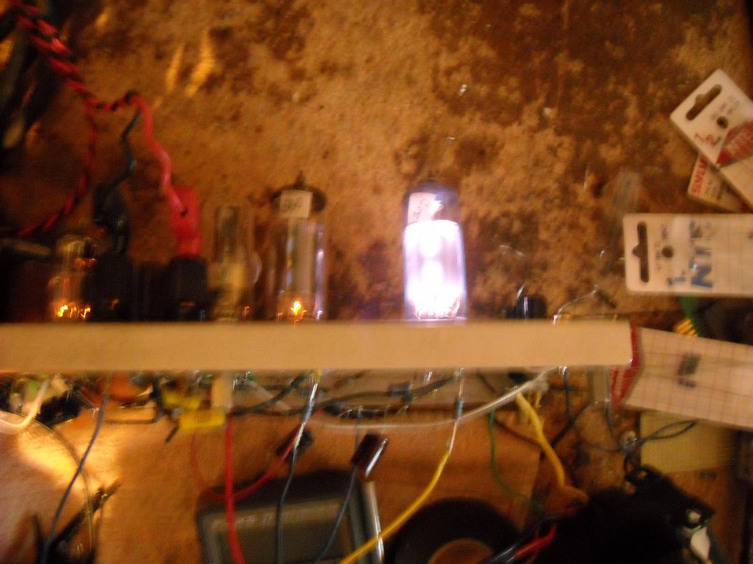

OK, this isn't mine but it sure glows. LOL.
Oh, description says:
A three phase, six anode mercury arc rectifier, formerly used at a 600V DC traction substation of the Athens-Piraeus railway.
Mercury arc rectifiers were the thing a couple of generations ago for polyphase rectifiers until silicon grew up to be big and strong.The ones in the picture are small, and you'd normally find them in a closet somewhere powering an elevator or escalator, with a fan for cooling. GE made some steel-cased water-cooled models that were room-sized (a large room).
