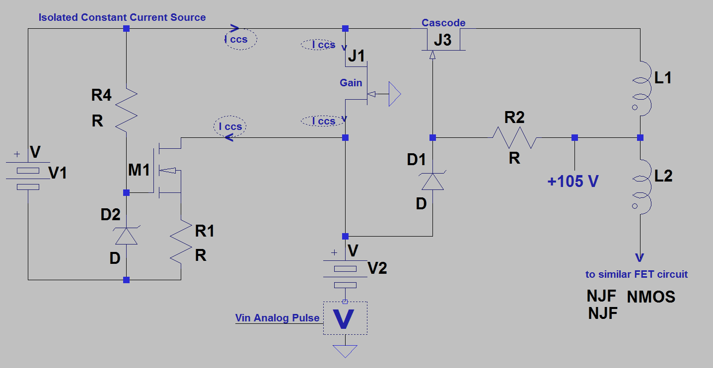

Hello Mr. Pass. Thanks for your post. I now have a possibly [identical] application for this great patent in circuits of my so-called Class aP cascoded amplifiers.
The attached schematic is a partial for a push-pull transformer-coupled amp which uses a high voltage PSU. It is expected to meet the teaching and/or objectives of the patent
1. The left of the view shows a high impedance constant current source based on an N-Mosfet, and its isolated PSU shown as a battery. The constant current from this source [ Iccs] circulates solely in the Drain-Source channel of the Gain N-JFET.
2. The Gain N-JFET operates in the common gate configuration. Its source is biased to a positive voltage [another battery], and is driven by a negative-going analog pulse.
3. The Gain N-JFET is cascoded with a second N-JFET. The cascode N-J-FET is enabled to pass a much smaller current than [I css] so as to keep its idle power dissipation to a low extent.
4. The voltage at the source of the cascoding N-JFET is made to be ~equal to that of the floating PSU of the CCS.
5. The value of the battery voltage at the source of the Gain J-FET is adjusted so as open its drain-source channel to circulate [I css] plus the small idle current from the cascode N-JFET.
A negative-going analog pulse opens further the drain-source channel of the Gain J-FET. It pulls the voltage at the source towards ground. The new lower resistance of the Gain J-FET forces the Cascode N-JFET to open up and increase its conduction; because the voltage at its source lead was also enabled to move closer to ground. The operation of the high impedance current source is unaffected by this dynamic operation. It continues to do its thing.
Best
Anton
