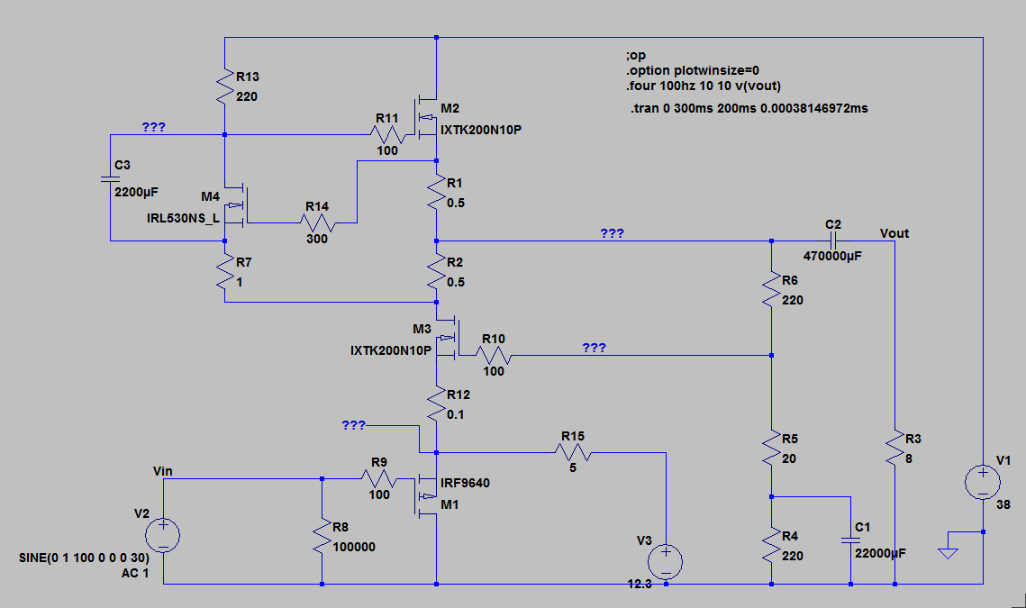

I have more questions about your amp having built one as per your suggestions. Mostly the same although used NP CS with 4N37 instead of battery and IXFK120N20P instead of the 140's as not available at Mouser when I tried to order. The specs looked close enough to me to substitute. Used 470 instead or 220 and input impedence looks about 1300 which is not an easy load but should be manageable for dac's and pre-amps. The amp seems dull and lifeless and using PCF does not make much difference. I also used NP capacitance multiplier and am running about 1.7 amps. I like the concept and want to keep developing it but may move to a transformer instead of the p-Fet. Have you simulated or measured the internal resistance and olg of the amp. It seems to me that the internal resistance and hence the DF is a very important parameter when applying PCF. The F6 with PCF I mentioned in another thread is the best amp I have ever heard and I would like to get the Zen concept to work. Any suggestions would be appreciated.
Did you use an IXFK120N20P instead of an IXTH140P05T (140's)?
The IXFK120N20P is a N channel device. The IXTH140P05T is a P channel device.
I guess the IXFK120N20P should work well for M2 and M3. M1 should be a P channel device. This would explain your lacklustre results.

Do you use a low value resistor below the voltage-reference in the Mu-follower (R15 10 ohm in my schematic above)?
Without it I experience a slight cold harshness and a somewhat lackluster sound quality. It seems to effect hf-stability in simulations and I guess this applies to real life amplifiers to.
I don't know if this is applicable for your amp though.
Johannes
I have made a few changes to the amp and seems a lot better. I use NP 4N37 CS and not sure if the 10 ohm is necessary with that version. Also use the cap multiplier of the original Zen 9 which does let a bit of power supply noise through but only when my head is almost in the speakers. I had made a mistake with R16 and was at input not after R17 although my feedback was to the R16 R5 junction. I suspect this compromised the sound as well. I modified the PCF as per post 756 by lqhaum in the F7 thread using his formulae. Assumed an internal impedance of .5 ohms which may be a bit low. B of 11 and set a clg of 6.6 Rsen of .5 and Rout of .08 resulted in R17 of 4.7k with Rin of 20k and Rfbp of 10.9k. This results in a Z in of 11.755k which is an easy load. This is supposed to make the amp Rload independent. The sound is clean and much faster with good transients but have only tried on an 8 ohm Lowther. I'll try it on my friend's Trios Avantegarde which are a 16 ohm load and also on a 4 ohm load when I get a chance. I reduced R5 to 82 ohms as well. Hopefully you can follow all this. I assume an olg somewhat the same as NP's 50 watt amp of around 80 less 20 or so for lower transconductance devices and less current. My amp runs about 1.7 amps and is quite hot despite plenty of heats inks. Sorry for the long post and hope you can follow what I have done. Will also compare with my F6 with PCF from the other thread which is an amazing amp when I get the chance. Your contribution is greatly appreciated.

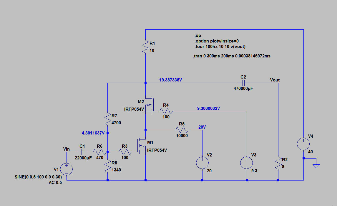

I made a simple cascoded Zen amp as an example, to show the effect of injecting extra current into the bottom device in a cascode. This will help linearize the device and increase gain, without adding much heat.
The voltagesource V2 and the resistor R5 feeds this extra current into the bottom device.
I will show this effect with R5 = 10 k and R5 = 10 ohm.

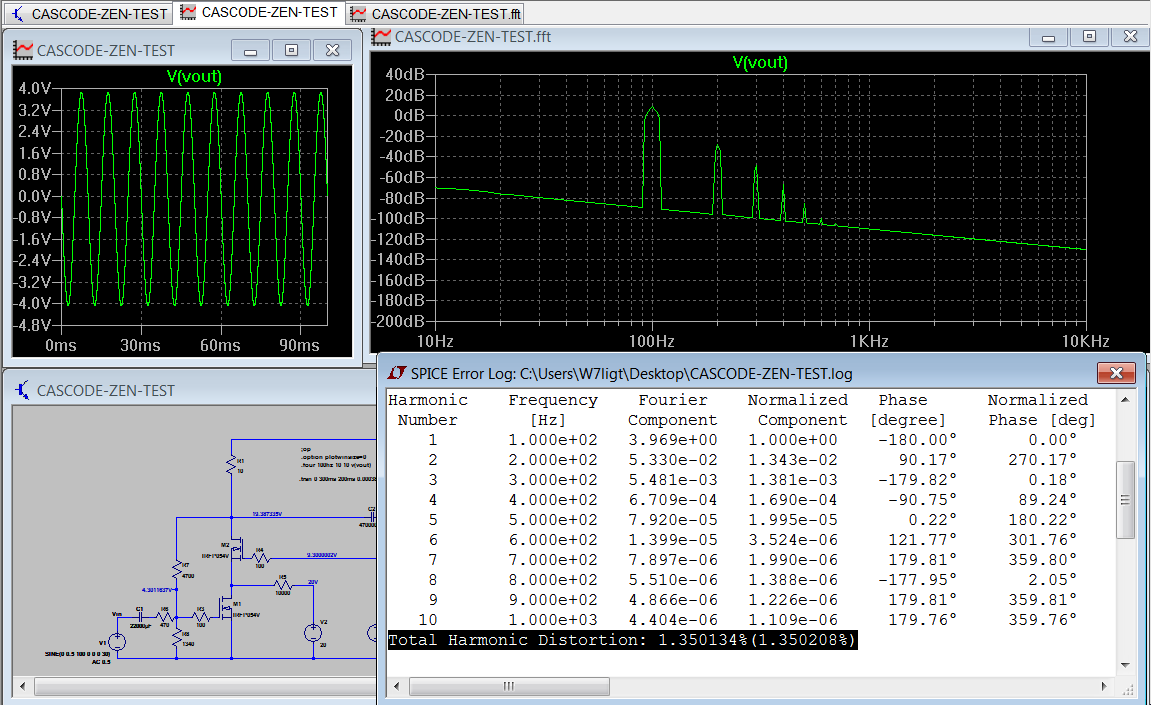

Top simulation is with a 10kohm resistor (R5 = 10000 ohm). There is only a small negligible 1,5 mA extra current.
The second simulation is with 1,5 ampere extra current being feed into the bottom fet in the cascode Zen amp. R5 = 10 ohm.
With 1.5 ampere extra the gain increases by a small amount despite the global negative feedback setting the total gain of the amp.
The distortion drops by a little more the half. 1,35% THD to 0,61% THD. I know this is not exact and absolute numbers, but I regard the substantial lowering of distortion to be indicative of the change in gain and the linearizion if the bottom mosfet with more current - that I will expect from this modification. It might have 2,0% THD in the first example and then I would expect something close to 1,0% THD in the second example. A most welcome performance boost.

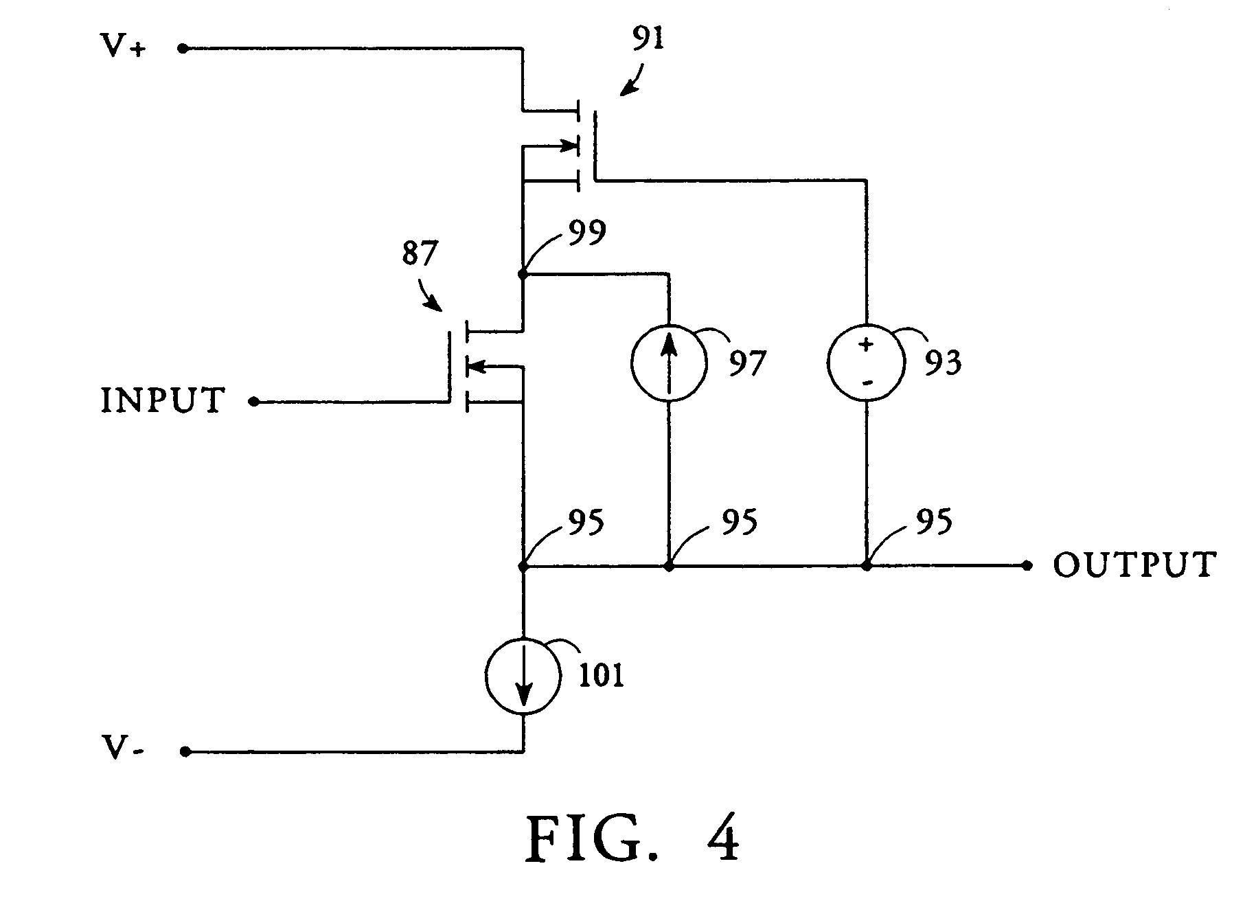

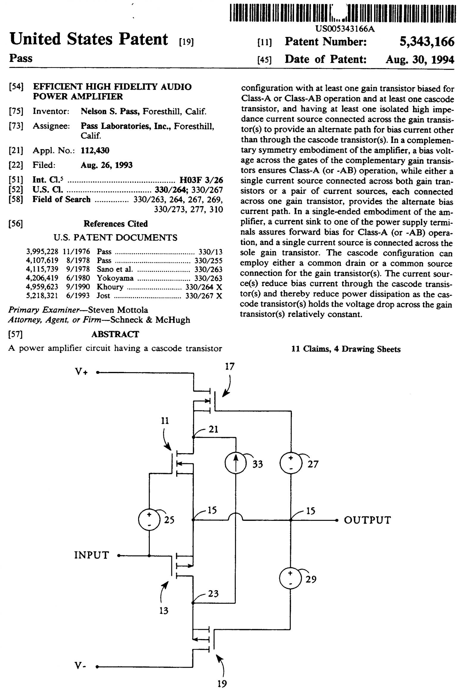

Pa is having patent on something like that
We all have learned so much from him.
It is not a new technology though. It has been used in RF (mostly transmitters) since the late 30ies. It is a great way to increase the available gain without a large increase in number of devices or power-usage or heat.
If you want to get real fancy you can start modulating this extra current to effect the transfer-curves of the cascode circuit...
