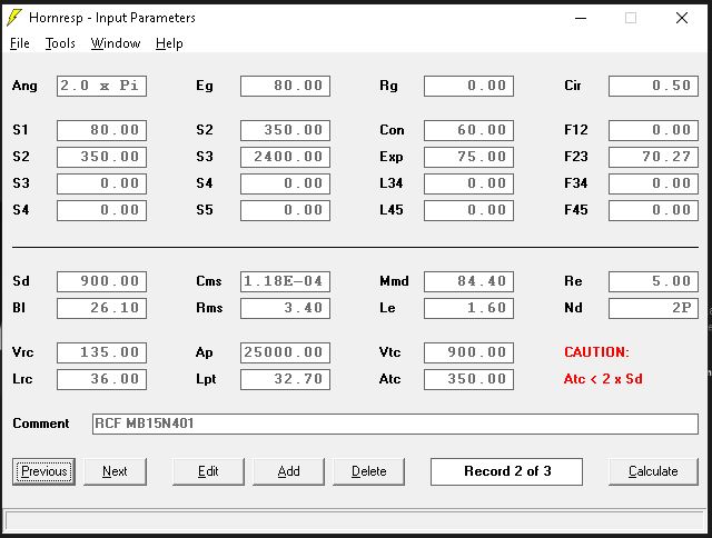

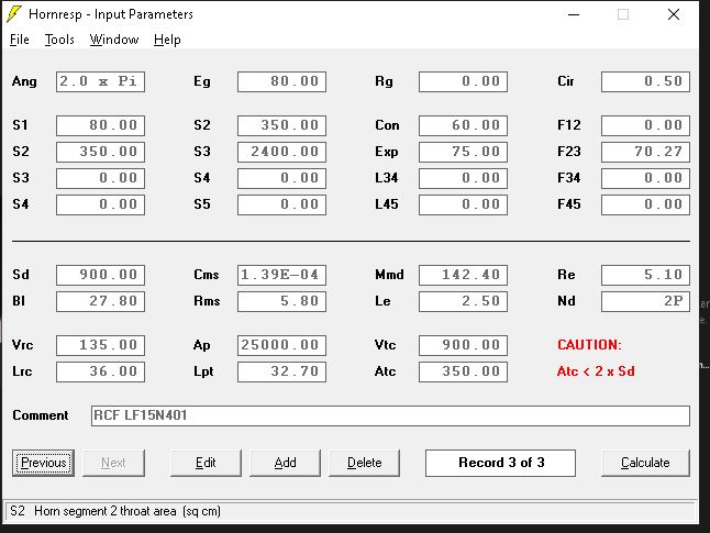

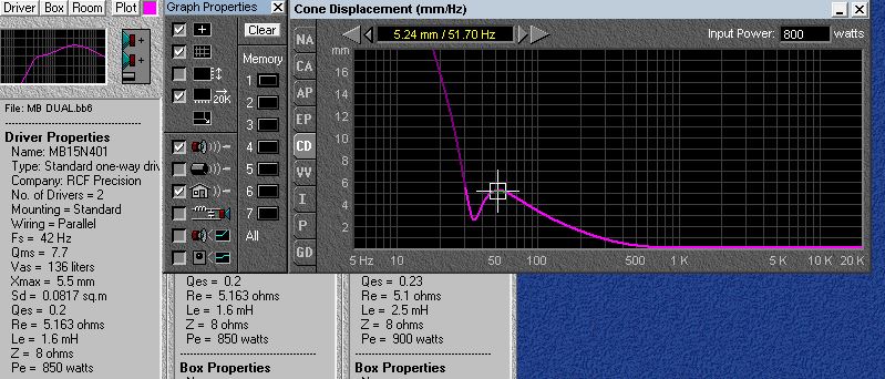

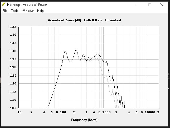

So it gives me similar sims as BassBox Pro, except than the frequencies starts wayyyyy later (at 90Hz if I don't mistake) than 40Hz, where I'm already at 122db on BassBoxPro
It's the first time I'm using it so I may have done a mistakes, any help to correct me or that's seems alright ?
RCF LF15N401

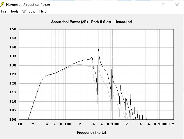

sim, in black the MB15N401, in grey the LF15N401

RCF LF15N401

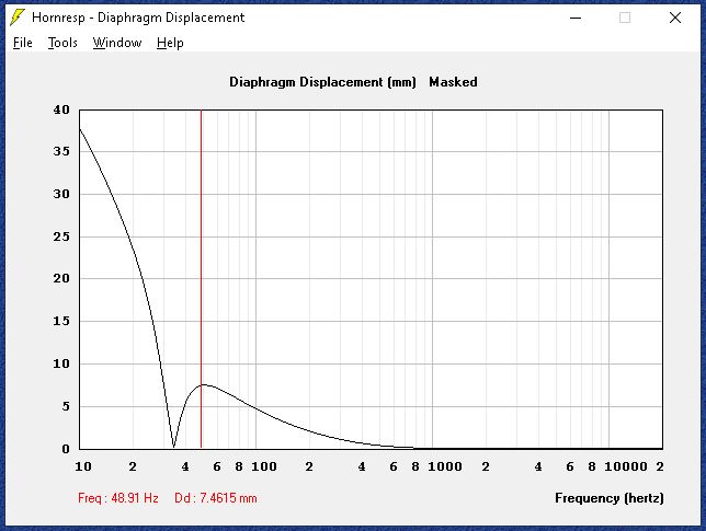

that's right, tools > output > Combined right ? (not "port" neither "horn")

Use the Input Wizard accessed from under the Help menu to generate a representative example of a bass reflex loudspeaker, and then edit the input parameter values to match your actual design.
Also made a mistake with the port surface
Ap = 25000 cm2 did seem rather large 🙂.
suparub - I didn't understand your hornresp input above with the choked throat (80 sq.cm.) front horn and long vent
here's a plain reflex - hope I got the vent area right for two 119mm diameter round vents

In fact, I had checked "NO" when it proposed me "Do you want to mask direct radiator vented-box enclosure resonances". Is this the right thing to do to press YES, if so I find the same as you freddi. Thanks again Boss 🙂
