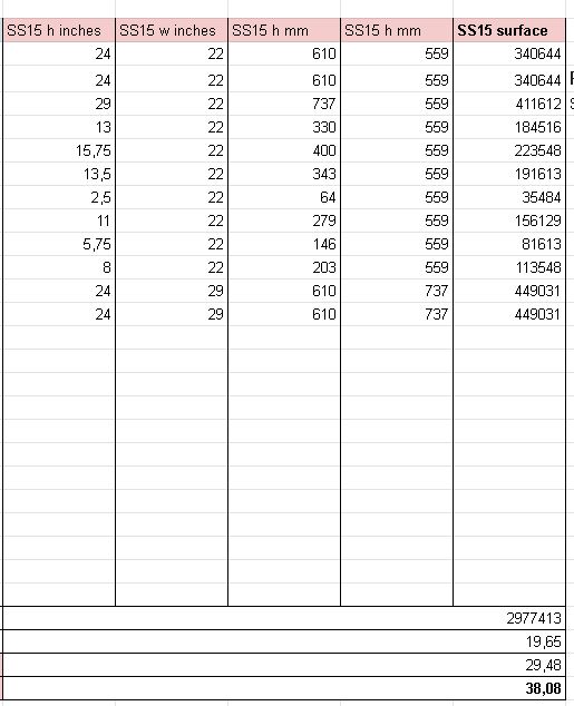

and 38Kg (driver included) for the SS15, not bad but 10Kg more than the THAM15. Any quick way how could I compare the performances of the lf15n401 on the SS15 vs the THAM15 ?

Hi again guys, so as the weight is a critical limiter in my case, and having compared the enclosure weights of my actual ported one and the Tapped Horn ones, I'm debating if I should upgrade to a TP or just improve the design of the vented one.
Weights :
Actual : 10Kg
THAM15 : 30Kg (the lightest TP and already very heavy for me).
So on, does anyone would recommend a simple design (not forcelly TH) that would be ligther "woodwize" with this driver ? As it's a Neodium magnet it's supposed to perform well in smaller cabinets. I'm open to anything (among ported designs).

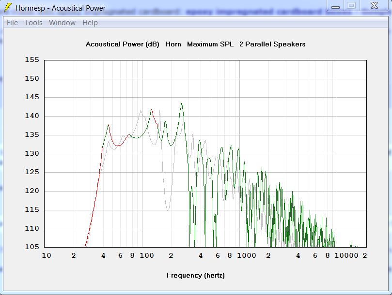

By the way, kind of a newbie question : will there be a big DB / max SPL / Audio difference if I build 2 x THAM15 (wired in //) vs 1 x ROAR15 ? Im studding the options between sound power and weight 🙂
Green-red line is two THAM with 1800 watts each compared to one single ROAR15 with 1800 watts (grey line).
Heroes !! Ok the choice is almost made ^^ now looking into dimensions

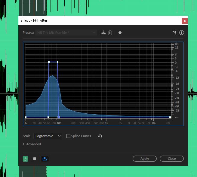

I just can't realize yet if the perceived "sound power" / SPL difference between 60Hz and 100Hz will be noticable / worst it. I know that +10DB double the perceived sound so 6DB should be +50% difference in this range. The use if for outdoor open air fields.
Edit : ok now I realize 😉

(I'm old, ignorant, decrepit and useless so more a "zero" 😱) With two drivers, and given power, two THAM15 should have less heating and less thermal compression than one driver in ROAR15 plus less cone excursion above tuning.
IF one had the means and space then two ROAR15 would be very cool.
Here's Two THAM15 vs Two ROAR15. The little THAM15 does pretty well for so small a cabinet

I guess that graph is the energy distribution in normal modern music.
It really shows why a great mid bass is so important for music reproduction.
