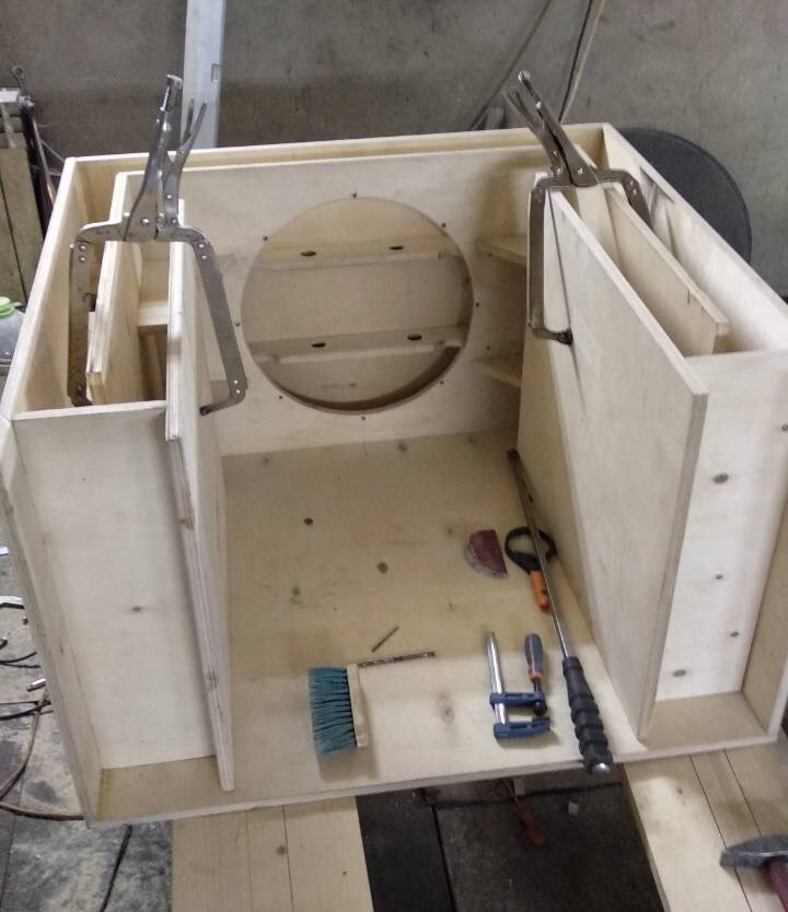

Here is a picture of the ported enclosures I have built for the record

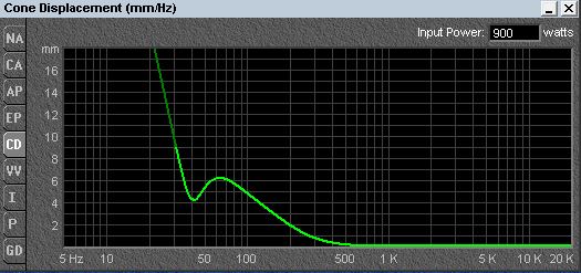

power handling within the 9mm xmax is around 72 volts - that's a nice woofer

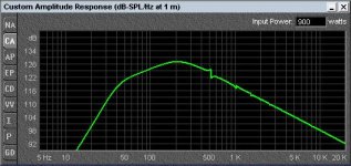

Here's how that tapped horn should look vs an 85 liter reflex tuned to 36Hz

The biggest compromise with the SS15 size tapped horn is the lowest notes are slightly lacking, but that said they deliver astounding levels compared to the same driver in a reflex cabinet. Note in the sim above they beat the reflex from 40hz up.

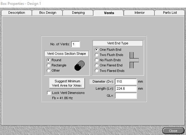

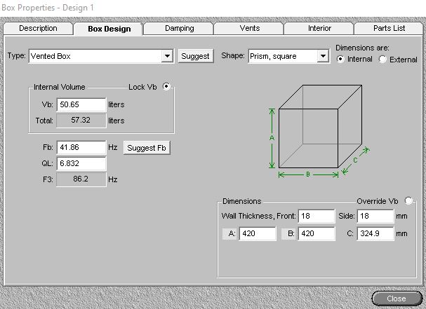

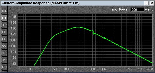

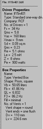

- @freddi, thank you so much for your advanced technical analysis already ! I'm warping my head around it and I'm now telling myself that it may be simpler and lighter to just build a bigger vented box with a proper volume / wood port (instead of the PVC I'm using and that is rattling at high volume).
I'm attaching here the design of this enclosure I have built thanks to BassBox pro. Even if a DB difference would be noticeable with the TH type, do you think it would be worst-it to improve this vented one to really get the best of the RCF driver ? Any tips for that ?
Also, I have a limitation of weight and size so I need to find a good balance between enclosure efficiency, enclosure size and enclosure weight.

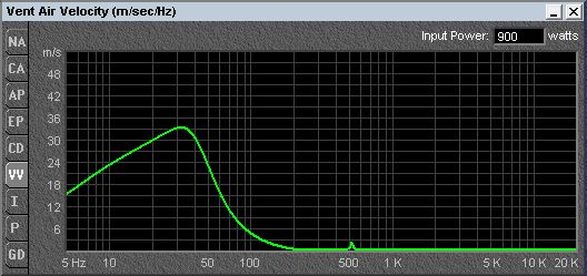

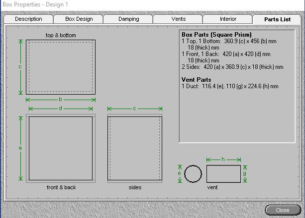

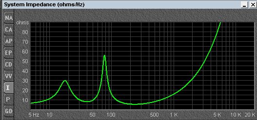

Attached in this post the screenshots of the vented enclosure.

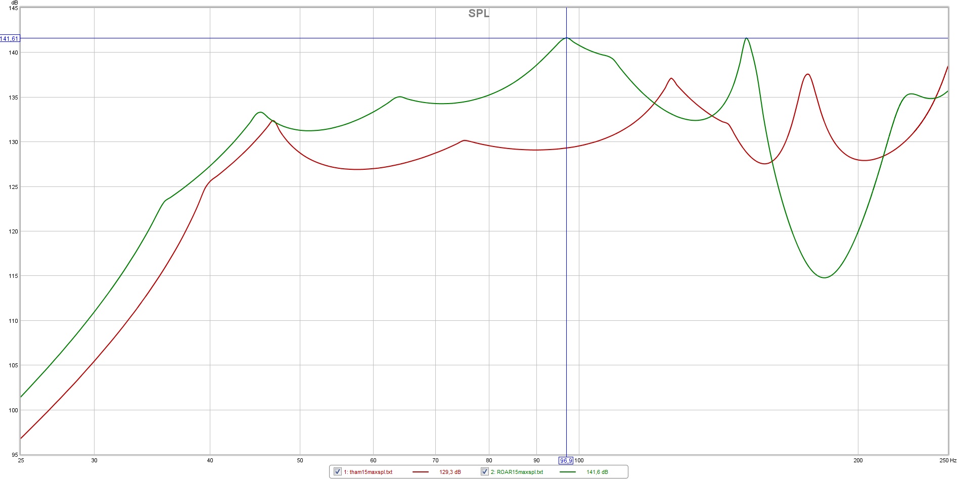

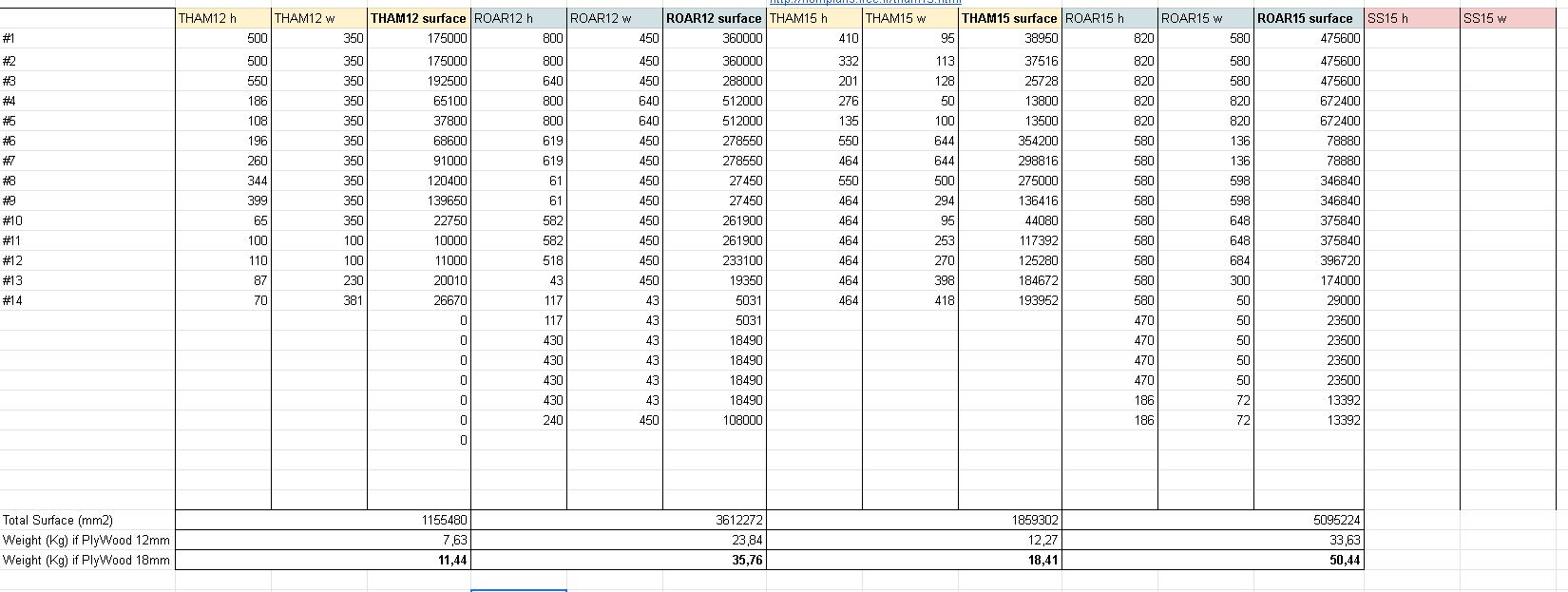

Hi Circlomanen, very interesting design ! The only downside is that it would add more weight but no pain no gain Does it fits any drivers ? I would think about adapting it to my other 12" midbass drivers with Neodyum magnet : MB12N351 ( https://service.rcf.it/c/document_l...22-200b-48e3-8fde-ccba0805410f&groupId=216492 )
It is best suited to high Bl, Low Qts drivers like the RCF 15N401 or B&C 15DS115.
I would guess that your MB12N351 is very suitable for the ROAR12 design:
Martinsson's Blog - ROAR12
Since the ROAR series is a split path design with a plane loading of the driver into the front resonator chamber it is very nice to the driver at high power levels. No warping or uneven loading that can lead to the voice coil scraping against the pole piece or similar.
A single ROAR12 could hold its own against two B&C 18TBX100 in bass reflex boxes in a direct comparison, in every aspect except the last 10 - 15 Hz below 40 Hz. It had much more punch and a higher definition and sounded overall much better.

The SS15 is tuned higher than 40 Hz, compared to the vented design, so it's not really a true comparison. The vented alignment will reach lower with less distortion, and may be a better fit if you play music that goes down that low. And also, no, SS15-type folds typically don't really make good tables, particularly for turntables .
Roger that, thank again dear community. I'm exploring now the different design and will compare the wood weight vs enclosure efficiency.

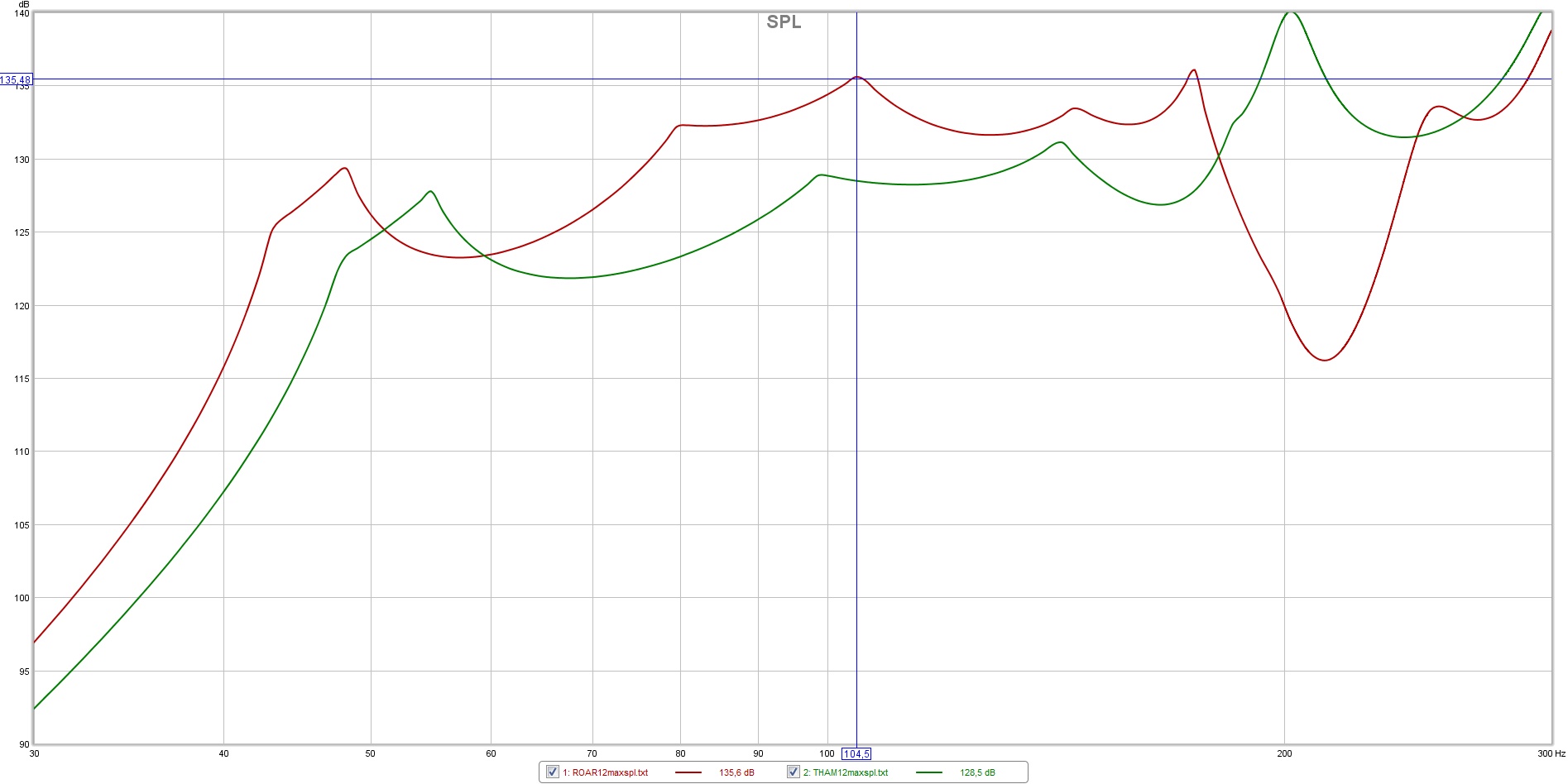

Greatness ! Circlomanen, in a similar fashion, how could I quickly compare the 2 designs for the midbass MB12N351 drivers on a THAM12 vs ROAR12 ? I have WinISD and just got Hornresp if it can help.
