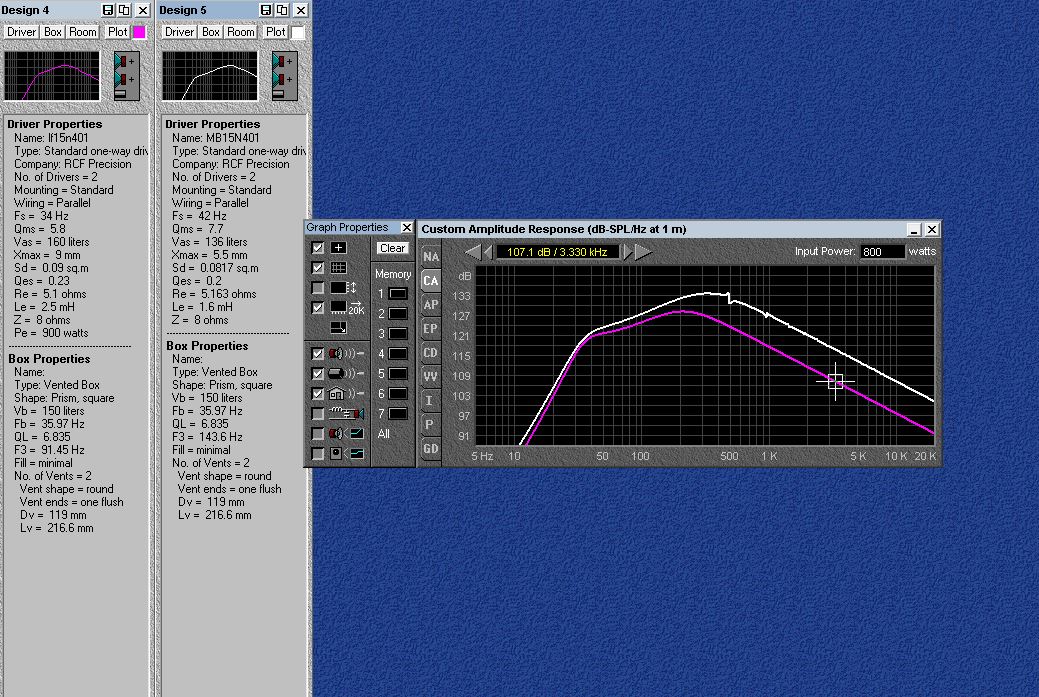

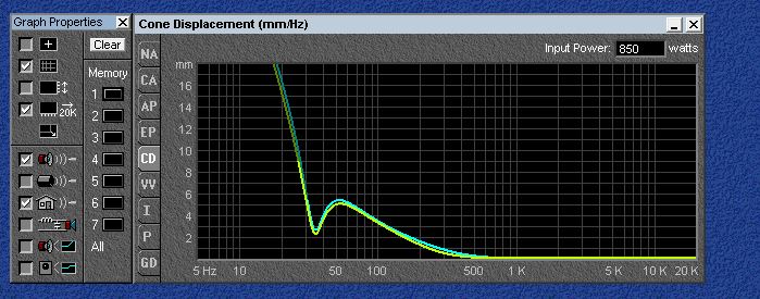

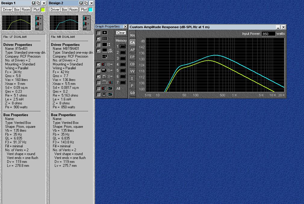

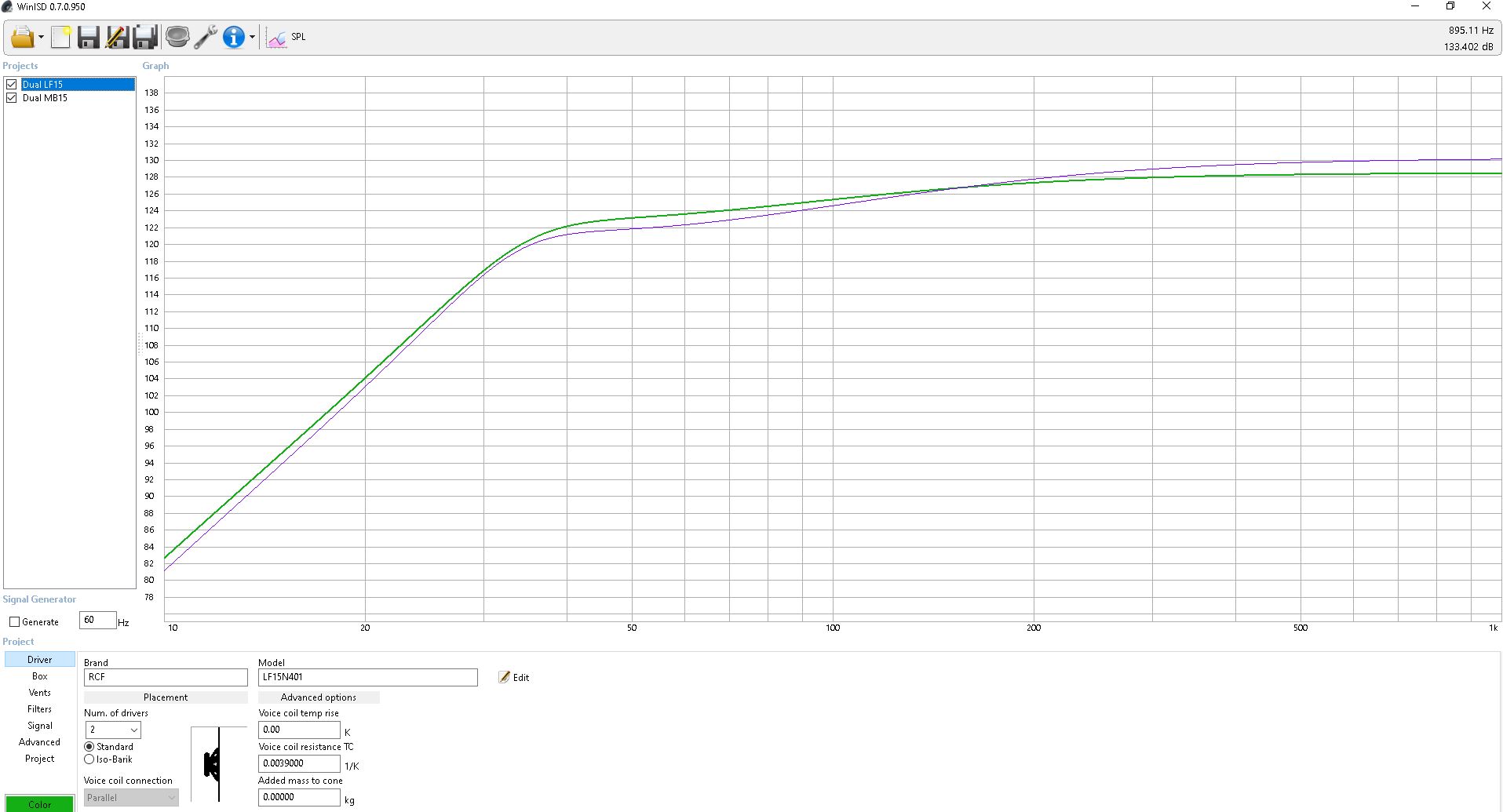

Problem is Im getting 2 different sims when I design the enclosure on BassBoxPro and WinISD
freddi maybe you can help me this ? I wanna send 800W and don't know if I should listen to BassBox (and go with the MB15N401) or WinISD (and go with LF15N401 as the difference between the 2 drivers is not significant)

Compare output levels at Xmax- comparing woofers and midrange drivers without considering the linear output won't give you much useful information.I wanna send 800W and don't know if I should listen to BassBox (and go with the MB15N401) or WinISD (and go with LF15N401 as the difference between the 2 drivers is not significant)
