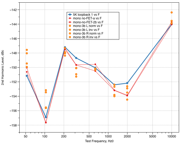

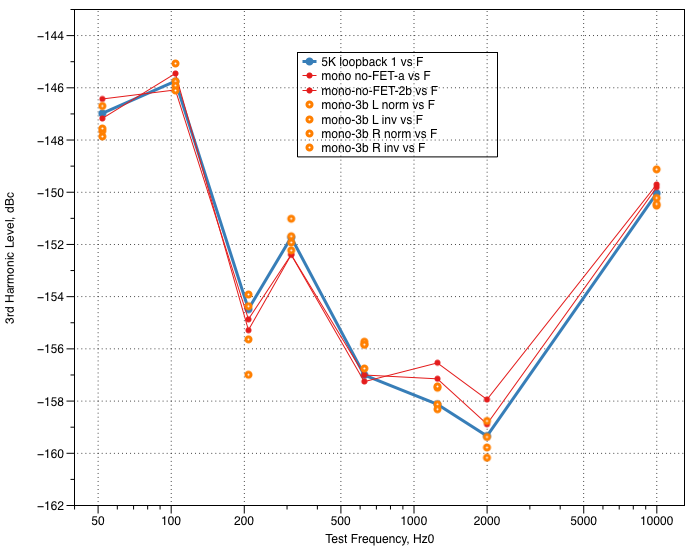

I have a FET switch board in the next room that scrapes the residual of an APx-555, basically, -150dBc second harmonic and a little less third harmonic. Not that many op amps are that good. It can be done!

At what voltage and at what load and what frequency?I have a FET switch board in the next room that scrapes the residual of an APx-555, basically, -150dBc second harmonic and a little less third harmonic. Not that many op amps are that good. It can be done!
I tested at several frequencies using a synchronous average of 128 512K point FFTs. Since the APx residual is not a constant, I find it's most useful to compare the circuit to the analyzer residual and see how it deviates. Depending on the phase of a harmonic, extra distortion from the device under test can add to or subtract from the analyzer residual, so the goal is to see how closely the D.U.T. matches up to the residual.
The two graphs are of the second harmonic and the third harmonic. This circuit produces mainly second harmonic as a result of component variations, with third harmonic mostly from the buffer amplifier. Fourth and higher harmonics are very low, and basically the APx residual - neither the 797 or the FET switches seem to produce fourth or higher order harmonics.
The drive level is +6dBV, and the tests were taken at 8 frequencies from 50Hz to 10kHz, chosen to line up with the FFT bin frequencies of the 192kHz FFT. The circuit was loaded into the 200kΩ load of the APx analyzer to focus on FET switch distortions, and not problems with the AD797. The blue trace line is a loopback test of the APx driving a 5KΩ load, the same as the input impedance of this circuit. The two red traces are measurements of the switching circuit amplifiers only (AD797 with an ADA4522-2 dual servo in a Superbal arrangement), with jumpers replacing the switching FETs. The four orange-yellow dots at each frequency are the FFT averages of four examples of the complete switching circuit. Four tests were done so I could get an idea of how random component tolerances affect the performance.
In general, the distortion measurements are within a dB or two of the residual, with the FETs causing primarily 2nd harmonic distortion. Of course, with distortion levels this low, we're mainly looking at the test set residual, but still, these tests are repeatable, and one can still see how the circuit deviates (or not) from the analyzer residual, and then infer that the actual circuit distortion is at least of the same magnitude as the residual, if not lower. One can never have too clean of an analyzer LOL!
