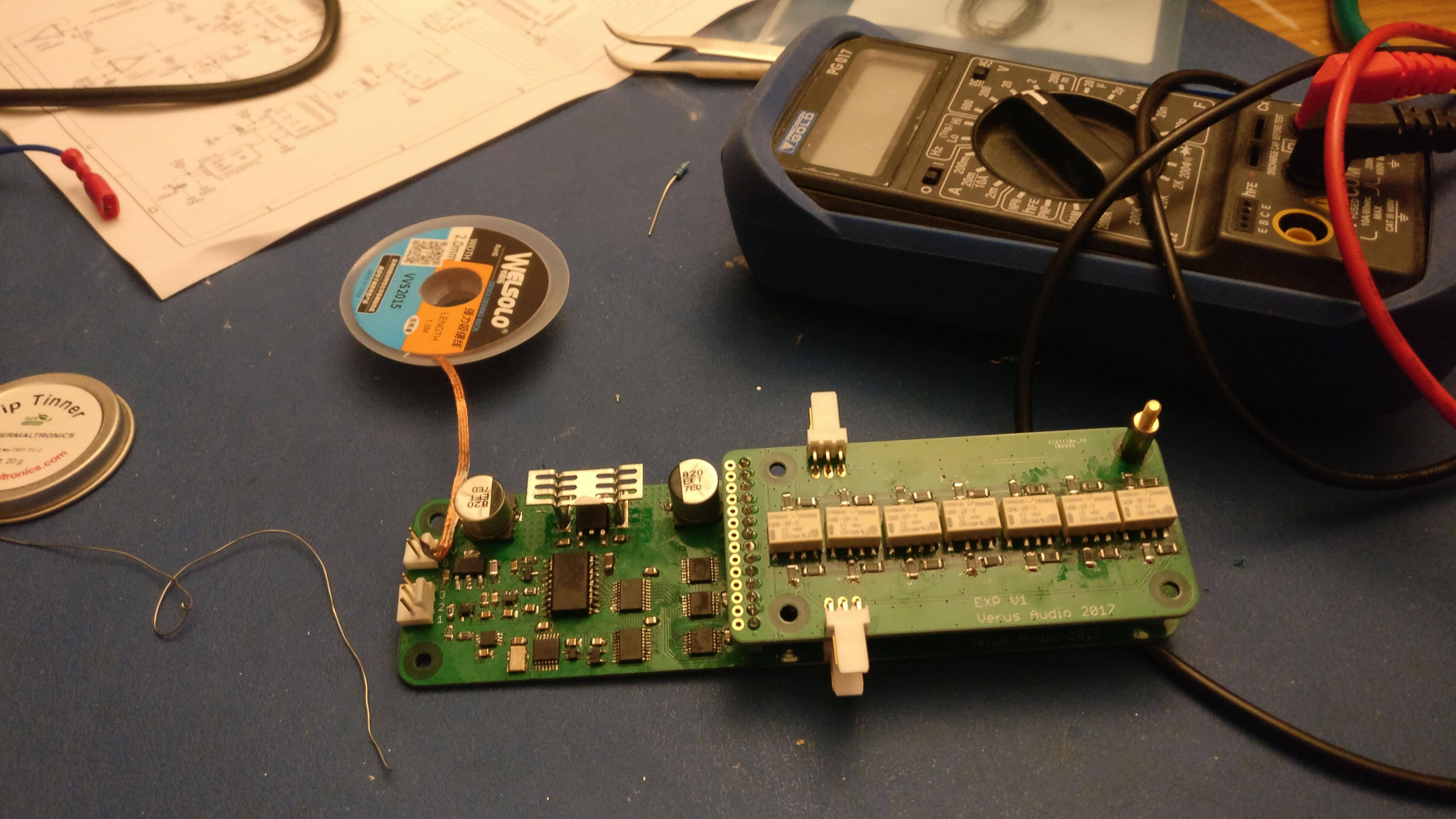

Well I've built it, it powers up and the relays appear to click at about the right rate as I turn the pot. So far so good! That was the most nerve-racking build I've ever done, lots of cleaning up of solder bridges and straining over my magnifier! But I don't seem to have ruined any of the components, which I have to admit surprised me a little. But I did learn a lot along the way and it's a lovely and compact design. Really looking forward to testing some audio through it now.
And here's a photo
Just finished, on the workbench and complete with expansion board. Now to install it into my Modulus-86 amp :)

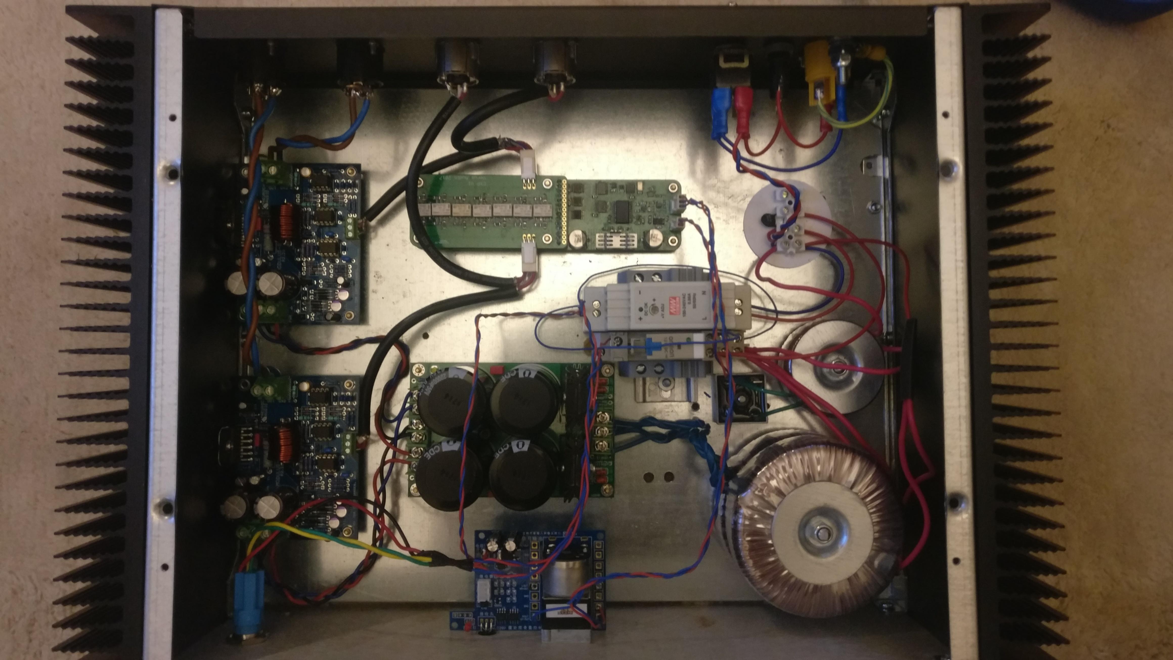

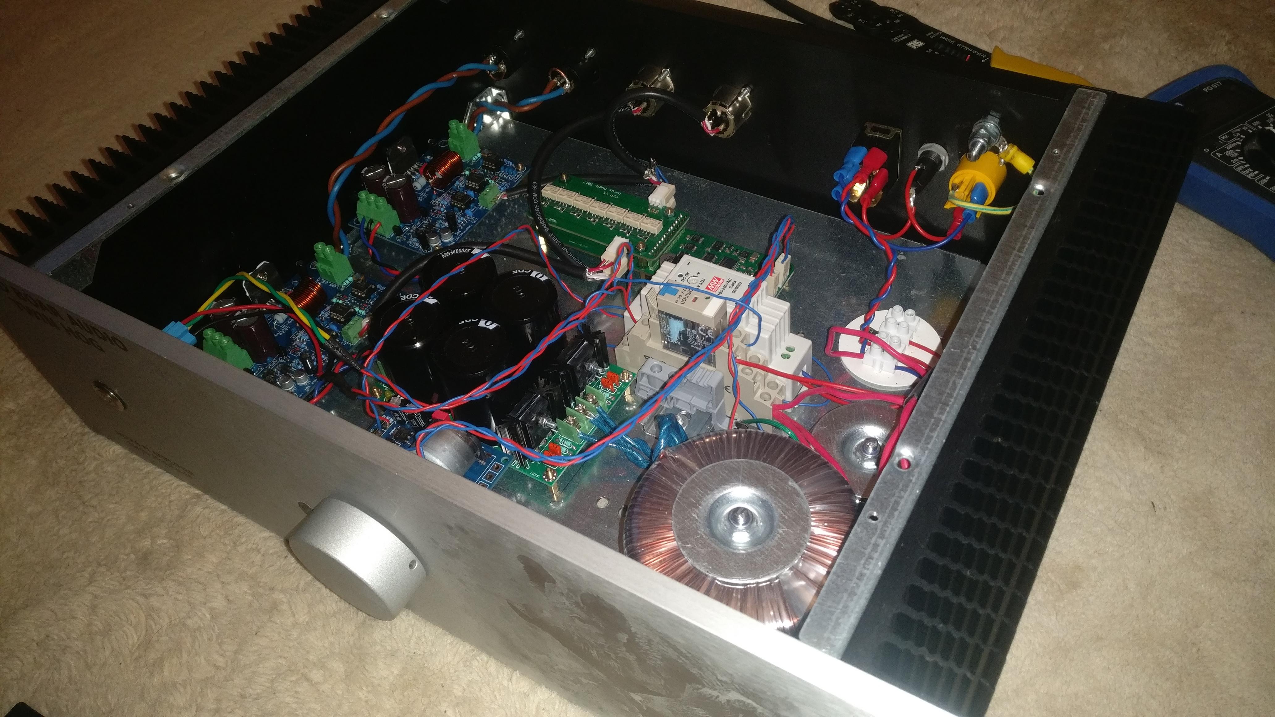

I've had a chance to listen to it for a while now. A photo of my setup is attached. The relay attenuator is controlled by an Alps linear 100k pot attached to a no-name Chinese remote control board, and the signal gets fed from XLR inputs via the relay attenuator (plus extender board) to 2 of Tom Christiansen's Modulus-86 boards, with output through 2 speakon connectors.
It's exactly what a relay attenuator should be: totally transparent, I can't make out any noise added to the signal, and the 0.1% matched resistors make for a very well preserved stereo field. I haven't heard a pop yet!

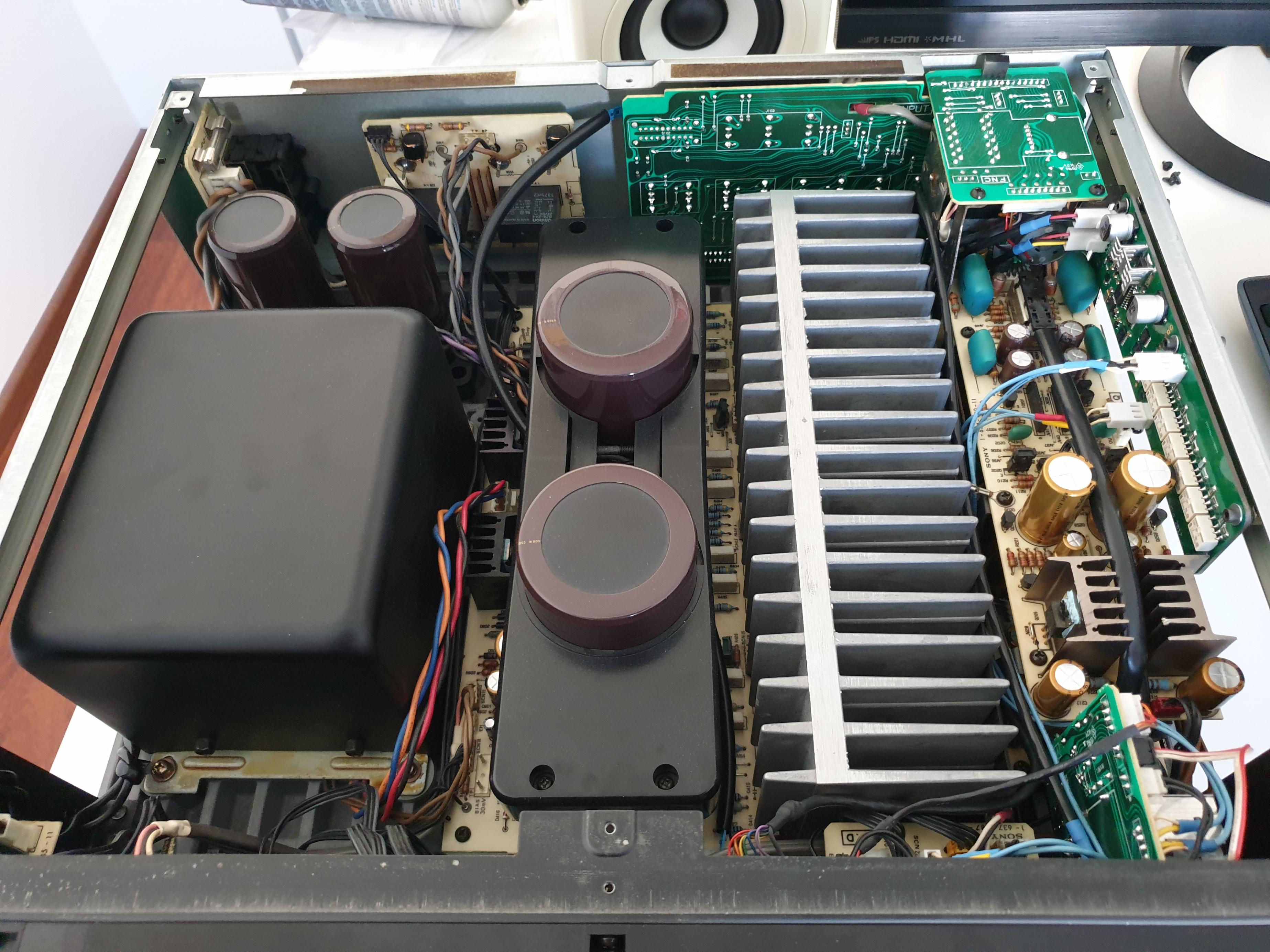

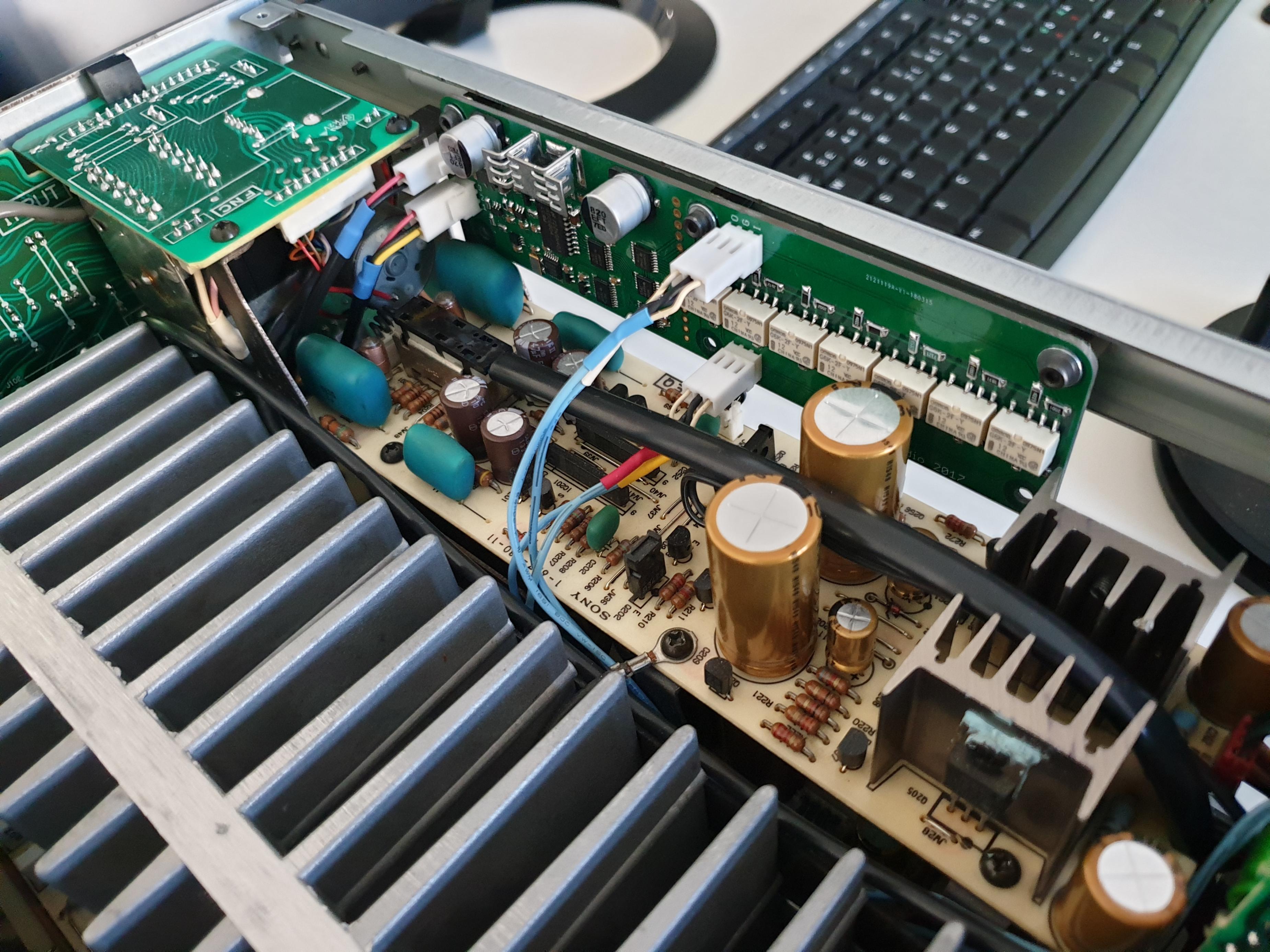

Just wanted to share a couple of pics showing your design saving my cherished Sony TA-F333ESL with a dodgy volume pot.
