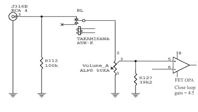

I do not know, do you have a schematic I can see? Without a schematic it is hard for me too know how much and what you might have to change.
But in general, from the output on this relay attenuator you need a resistance of 10K to GND. Otherwise the step size, depending on volume setting, will vary too much and not be exactly 0.6dB as intended.
Hope this simplified schematic is suffice...
If R127(39K2) is the only thing that is connected to GND from the potentiometer output/+ Input on OPA then you would have to change R127 to 10K.
But it will work with 39K2, your step size just wont be 100% 0.6dB at all volume settings. It wont affect the channel balance, that stays the same no matter the resistor you use.
I use the wrong resistor value myself, 21K5, beacause I am using the attenuator with an older headphone amplfier I designed and it just doesn't bother me enough that it makes me want to change the resistor to 10K. 😱
However, my new headphone amplifier is designed with this attenuator in mind and when it is done sometime later this year all will be well. 😎
So to make it short, the optimal thing would be to change R127 to 10K but if you don't you most likely wont notice any difference anyway.

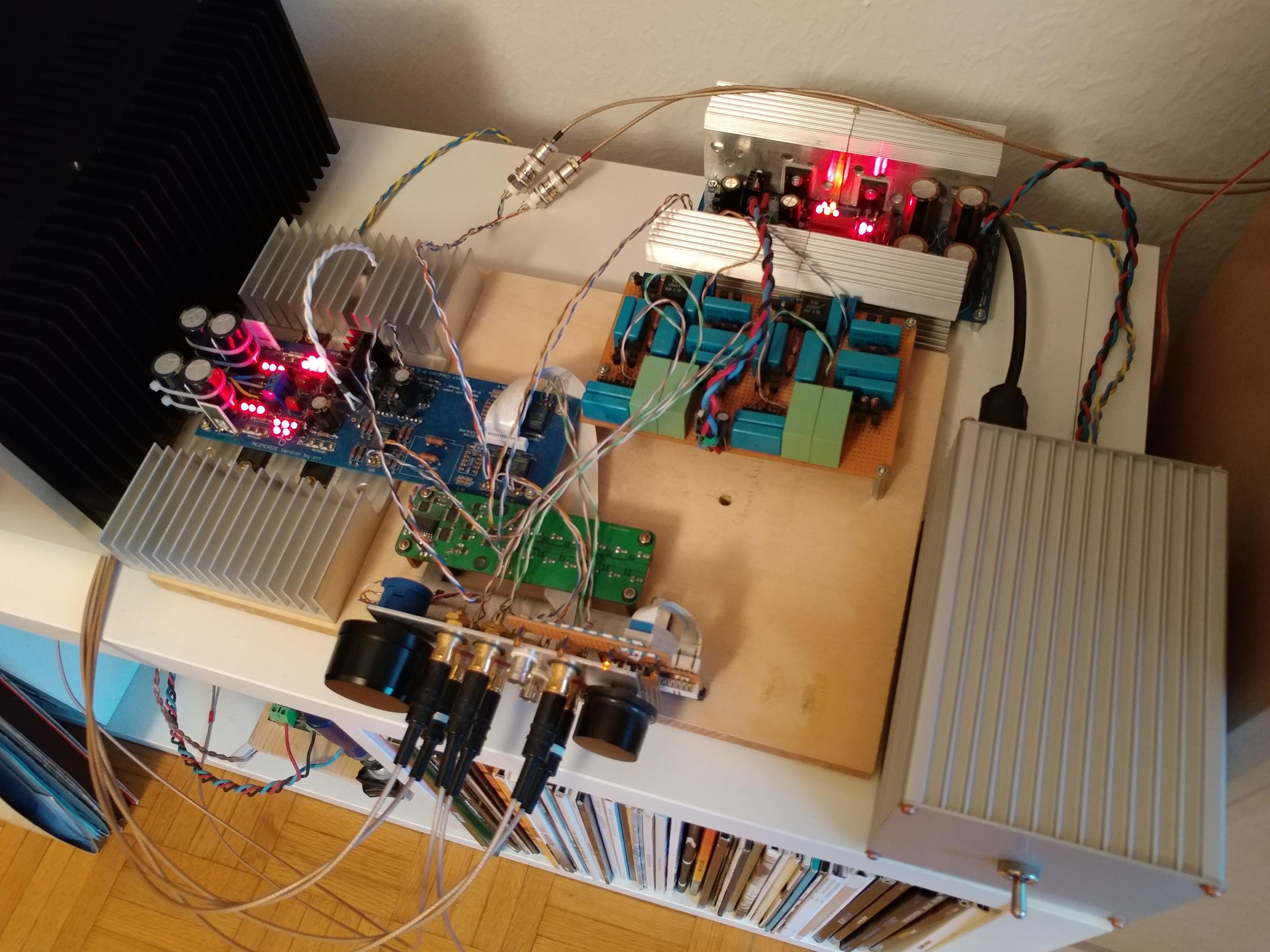

I'm already using a high-ish impedance potential divider (buffered) at the output of the high pass to match the drivers' sensitivity. The V1 attenuator is currently at the input of the line level crossover. Moving the volume control to the output of the xover (4 "channels", LP and HP in stereo) should provide better SNR for the whole pre chain.
I'll think about it some more and will eventually place an order.
In the meantime, here's the V1 in action:

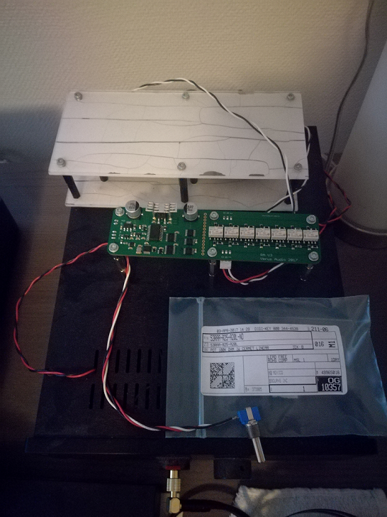

Here is V3 😀 :
