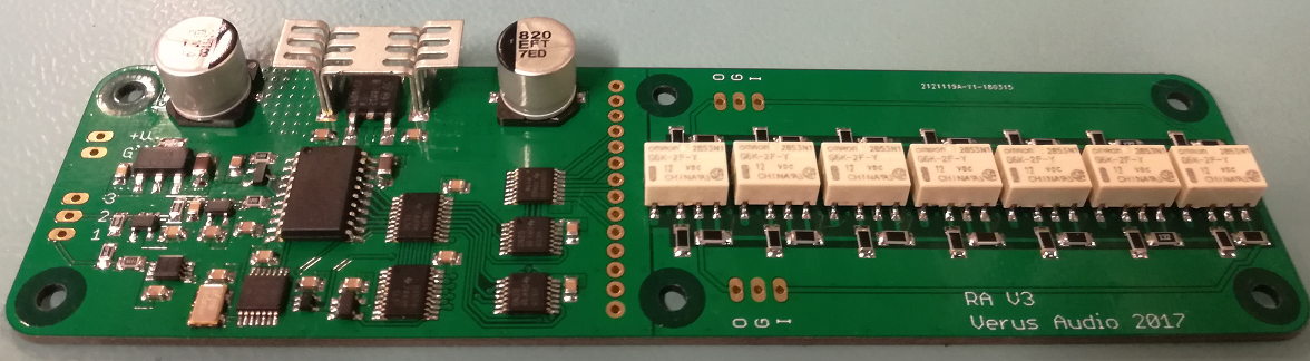

A little less than a year after I relased V2 of my attenuator, V3 is finally done and tested and it works absolutely perfect.
Description :
Fully HW-based pop and click free relay attenuator.
All done with some clever use of digital logic and accurate timing.
127 x 0.6dB steps for an attenuation range of 0 to -76.2dB.
High quality Omron G6K relays, high quality low noise, low distortion 0.1% Panasonic 1206 ERA Thin Film resistors.
Perfect channel balance, from max to min attenuation.
The attenuator needs a 10K termination resistor to maintain a 10K total attenuator impedance.
Use a 100K Linear potentiometer to adjust the ADC input voltage.
150mm x 40mm 4 Layer ENIG PCB.
Changes from V2 :
1. A few Bugfixes : No board level modifications are needed on V3. Q1 is now a Mosfet instead of a BJT.
2. Improvements : The board is now uisng an external on-board clock source instead of the built in oscillator in ADC0804. The built in oscillator circuit just isn't good enough.
3. Simplification : The detent function that stabilizes the circuit by using the LSB has been made simpler but it still works as intended.
4. Expandability : Stackable expander board(s), there is now an extra output header that can be used to stack additional boards on top of the main attenuator board.

Excellent!
Do you have expander boards available?
I am sorry to inform you that I have no expander boards.
They are not a high priority since I have a feeling that there is limited interest in those.
But I will se what happens, if it turns out that there is a decent interest in them I might make them available anyway.
If we need to make the expander boards ourselves, will you make the Gerbers/BOMs/other documents freely available?
Very nice project made with Eagle. Congratulations!
I had previously thought of a potentiometer with ADC. How do you prevent the 1-bit jitter?
U6/R32/R33 prevents 1-bit jitter.

I'm just thinking about the V3. The V3 uses 128 steps. Wouldn't 64 steps be enough? 128 has twice as many relay clicks. Does anyone have experience with 64 relay volume controls.
You could just leave out K1/R15/R16 and replace R1/R2 with 0 Ohm resistors(or wirelinks) and then recalculate the step size so you would get 64 steps with each step being 1dB. Then you would have -63dB attenuation(Step 64 is 0dB attenuation so maximum attenuation would be -63dB).
Thanks for the advise! I meant, is it possible that there is too much audible jump with 64?
Another question: You said that the osc.-frequency was to bad in v2 compared to v3 now. Why? Does the accuracy matter so much?
It depends. If you increase the step size you will get bigger jumps between volume steps. However, around 1dB should be good enough for most people, many commercial attenuators use 1dB step size so I think it would be good enough.
On V1 and V2 I used the built in RC oscillator function of the ADC0804 and whilte the frequency is fairly stable, the initial frequency can vary a lot with the voltage threshold variations of the Schmitt Trigger built into the ADC0804.
Using an external oscillator is just much more predictable and you will get the same frequency everytime across several boards.
