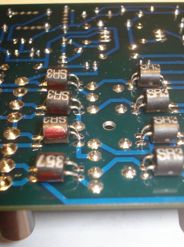

Hi Choky,
let me also know if your pcb-kit set will be available.

well - pcbs are made for balanced ; it's easy to make unbalanced - omitting 4 LDRs ( then just two pairs are needed , not two quartets) , and installing few shorties 😉
regarding buffers - then you need just sets of parts for two channels , not four as for balanced
PSUs stays the same

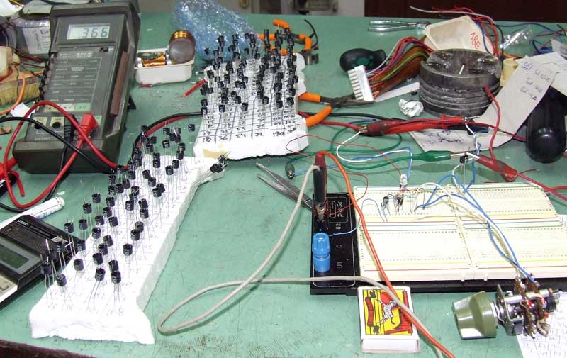

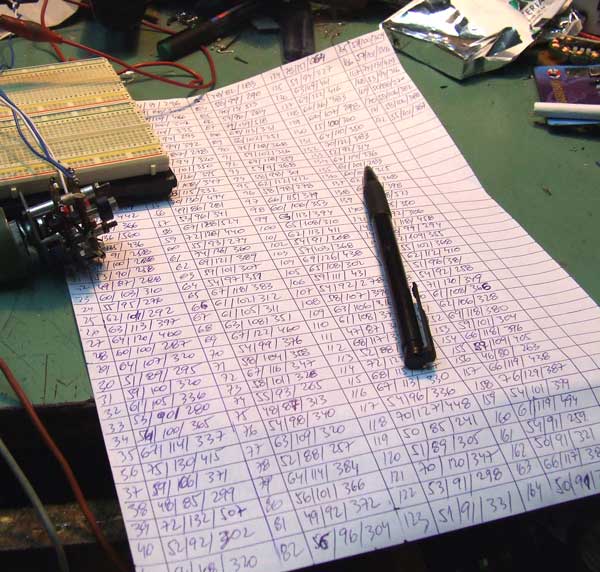

Guido - I really can't answer to that ; I had quantity of 172 pcs , and in start of matching procedure values ( in 3 different current points ) they were everywhere .......
on end of measuring procedure , and after sorting in Excell , just one was way out of range ; another one was ( logically ) odd ; all other ones were used for quartets , and I made just 6 or 7 pairs .
...so it's only matter of finding some pals to share LDRs with...

fun of matching :
172 pcs
344 times straighten pins
172 times push in
344 times put clip on pin
516 times change switch position
516 look at DVM
516 times write down value
344 times pull clip
172 pull out 😉
