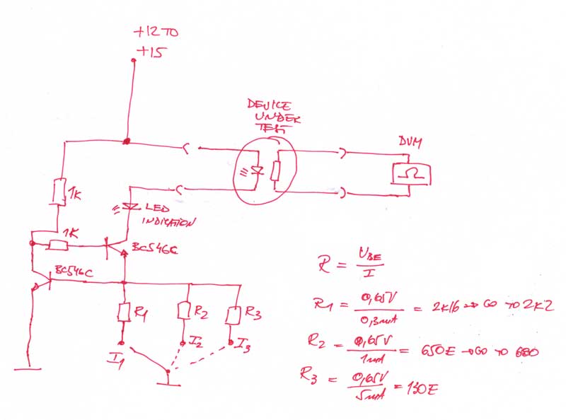

tms0425 said:Can you describe quick matching procedure/parameters in case I want to get a bucket full of the bulbs myself to play with? How close do they need to be? They show a "sorted" version tested at 1ma, but I imagine it's $$$
I tested/measured resistance of them (resistor part of LDR) in 3 different current points (current through LED part of LDR) ;
say that most convenient points for these bulbs are ....
0,3mA ; 1mA ; 5mA .
that last one - in fact - anything between 5 and 17mA
tip - when you measure all of them , just lined on styrofoam table ( as on some pic up in thread ) , where every one have own No. written by the legs - write down all values in excell ( No. , and all three resistances ) ....... than just sort them in excell file by value of greatest resistance/smallest current through LED part .
I'll post tomorrow exact schematic ( plain two bjt CCS ) with exact values for current setting resistors .
edit:
here is sketch .
Ahhhh, so simple, yet very tedious....
So with 172 devices, you measured and sorted in excel at the 3 currents, grouped to count off by quads (and a few for pairs), so yield is still nearly 100% (other than odd one or two)? In other words the ones within each group of 4 were close enough to each other to work out. No need to worry about absolute values. Nice.
tms0425 said:Ahhhh, so simple, yet very tedious....
you got it 😉
just to repeat most important - they're sorted by smallest current/greatest resistance value ;
exactly as you understood - they're all useful , and funny - it's so easy to get mostly quartets .

you must measure all of them in one session .
then leave everything for few days , to relax back , sitting apparatus , and brain
... and then go through the process again with the close ones for better matching - very sensitive to temperature.
