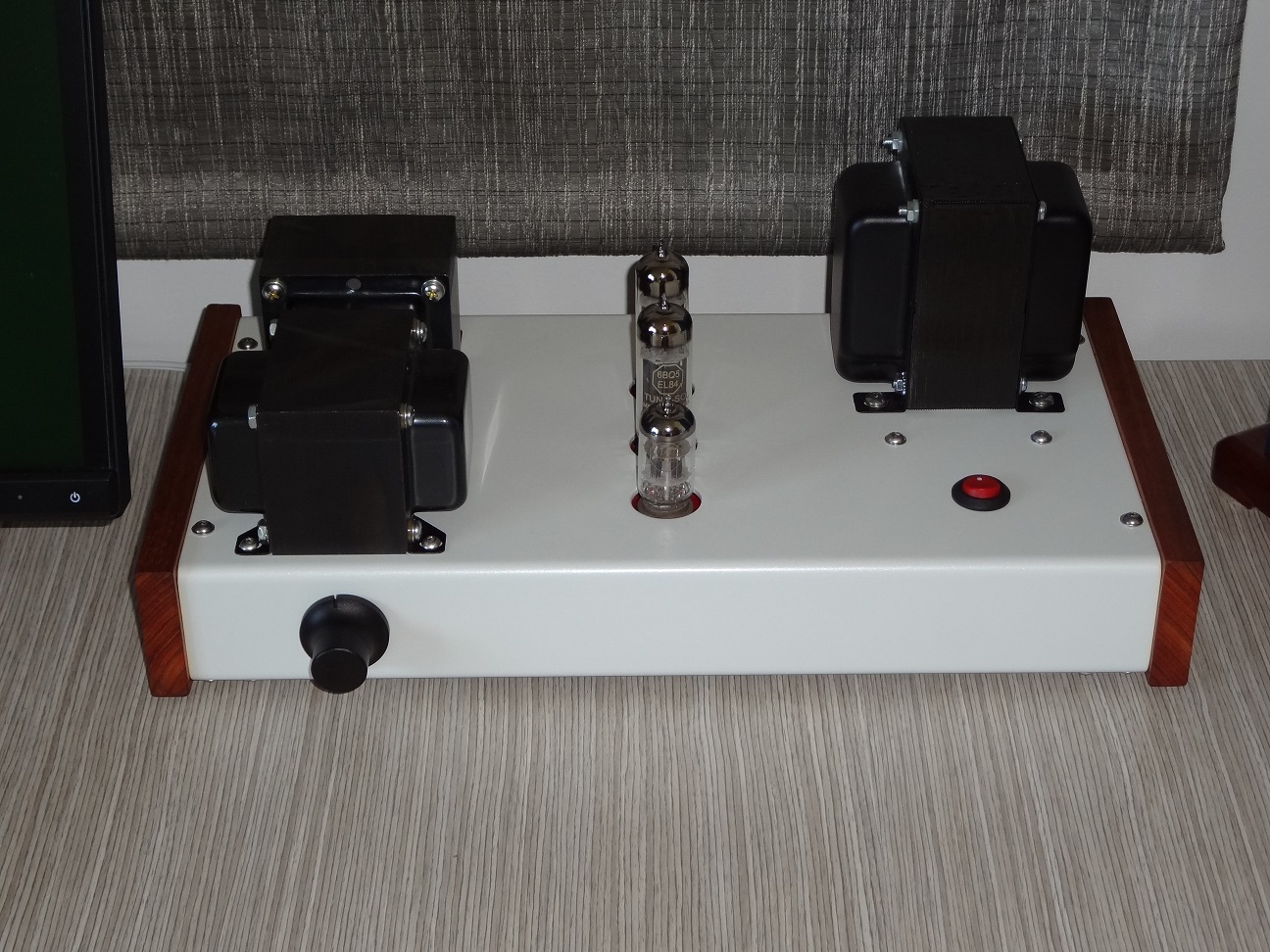

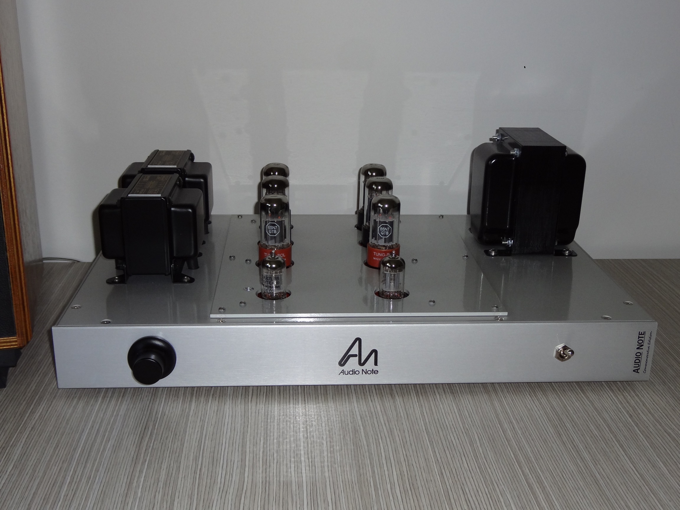

Those were all Tung Sol. Since that amplifier I had two other ones and they went, a third one is in use and a fourth one is contemplated.
I regretted selling the cream EL84 SE one to fund a third one - a clone of an Audio Note PP amplifier (no cost spared) that was ultimately not satisfying.
The one I am using is a SE EL84 with 5670 as driver. I'm embarking on another SE EL84 build with SRPP drive and the EL84 in UL with CFB in order to have even more flexibility in output impedance.
Hopefully the OPT won't give me grief: too much leakage inductance and if too much it might become a nice oscillator (although it depends on how much CFB there is and the power tube. Would not think about using anything else except for the EL84 and the EL34.)
Cabling is important: too long or too close to other cables (especially if they are flopping around and get too close to some tubes' input but do not underestimate the length of the wires to the OPT, especially with UL) and you might introduce unwanted coupling. I am using what Philips taught me rather than listening to what someone on the internet says (and which is why he is on my ignore list with his critism and knowing it better - NOT! ) YMMV.

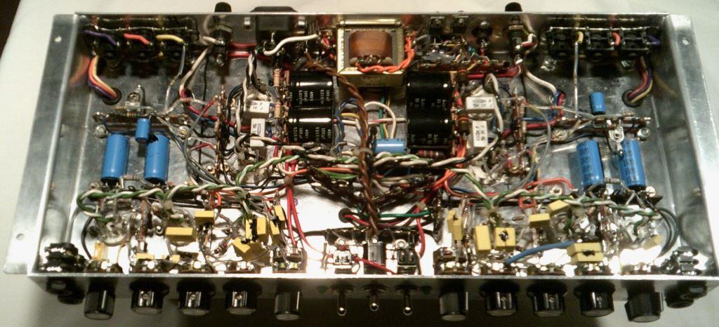

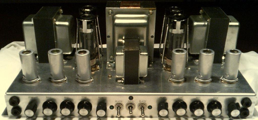

A couple photos of an all valve stereo guitar amp I finished early 2015.
It is all point to point with terminal strips located as necessary. Lots of hours. Scratch build with bare chassis to start. No hum, buzz or hiss. Star ground scheme - glad I did. Excellent sound. Sharing in this thread on point to point.

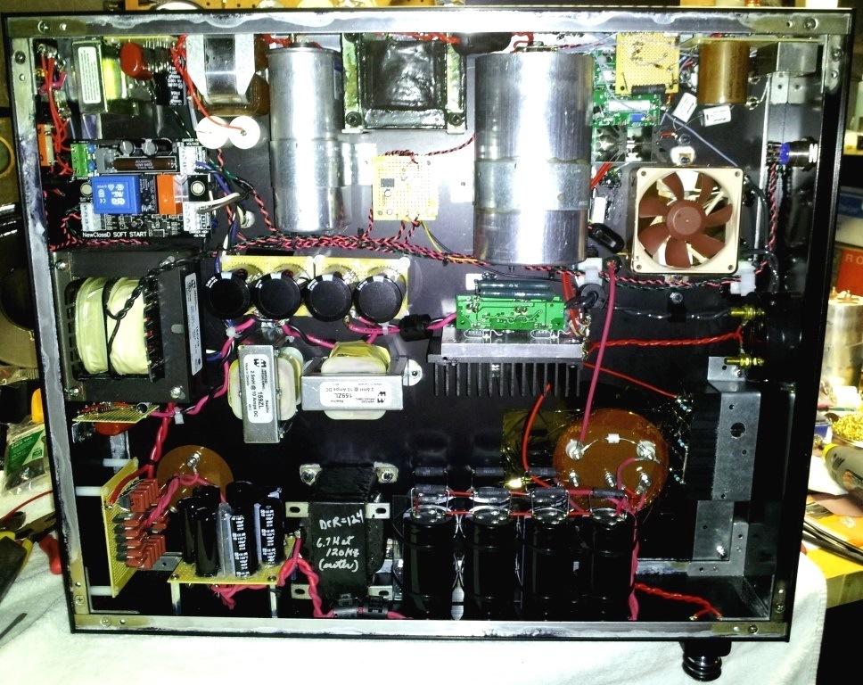

Underside and top view of one of my point-to-point wired 833C mono amps. Some PCBs sprinkled in for dedicated circuits like the soft start (really needed at 2300V B+) and the 10V, 10A filament supplies.
Space, corona dope and careful construction has kept it safely sounding great for 6 years now.
