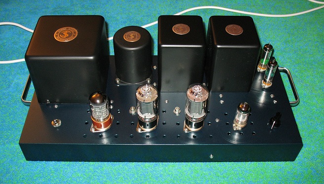

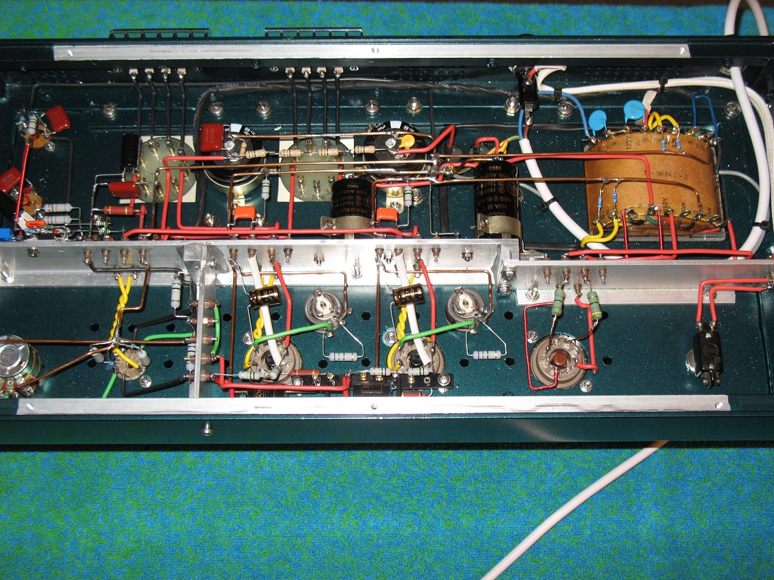

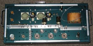

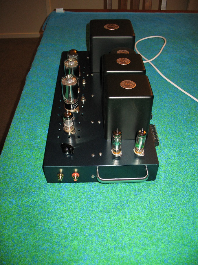

Point to point I made over 10 years ago. 6L6GC SE, tube rectifier, OA2 voltage regulation, ECC81 driver.
AmadeusMozart,
Great layout, great planning, and lovely wiring!
What were the output tube types?
I hope you are still using that as one of your most listened to amplifiers.
I only put 1 handle on my amplifiers; your 2 handles are more symmetrical.

Absolutely not. There were two major faults been done:AmadeusMozart,
-never bend a wire rectangular and never use solid conductors for internal wiring.
Because it damages the structure of the wire and it reduces the diameter, too. You put the cable under stress by bending and stretching.
-Never use solder wire only as a glue. This has been done here all the time.
Because solder is a very bad conductor and with all those bad soldering joints, the result will be a poor performance compared to a better soldered unit.
Solder is only to fix the joint, which has been made by twisting a wire around a terminal. Thats the way to do it right.
One can see, not many have good knowledge and experience in building gear, even when it looks at a first glance to be made with a good practise.
In fact its not, its a good example of how it shouldn't been done.
But if you don't want to go for perfection, nevermind the bollocks. Looks pretty good in fact.

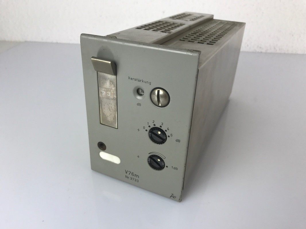

This picture is interesting. What is this for amplifier(?) ?
And ... "those tube stone ages" ? Absolutely not ! Alive and kicking!!
Its TAB V76M.Mess- und Anpassungsverstarker, Ampl/Mixer Tonographie
Semi Rigid coax Does have a minimum turning radius; but that is to keep the impedance a constant 50 Ohms all along the coax.
Waveguide also has a minimum turning radius, for the same reason (many waveguides are 200 Ohms, even though there is no center conductor).
Waveguide is the transition between coax and Free Space (Free Space is 377 Ohms if I remember correctly).
Of course, when I measured 500GHz on the world class spectrum analyzer we had, we did not have access to anything but straight waveguide.
And the harmonic of the almost 18GHz local oscillator was either the 28th or 29th harmonic to mix with the 500GHz to bring it down to the 3.5GHz or 10 GHz IF.
I doubt that the additional inductance by a sharp right angle on his wires will affect the response at audio frequencies.
And unless you have a conservatively large wire size, there will not be too much additional resistance due to the right angle. Perhaps a small wire that is running a few amps of filament current might be a problem.
On the other hand, if you bend a wire multiple times, or if you twist a wire multiple times, it may become work hardened.
And that IS a problem.
The most perfect square wave response I have ever seen from a tube amplifier was a co-worker's beautifully built push pull amp, and it had lots of wires with right angle turns, for both signal and power.
I think we are still at the outer layers of the onion.
With my 75 year old eyes, and my computer monitor, I was not able to see the solder job, and unwrapped wires that was only 'glue like'.
Sorry.

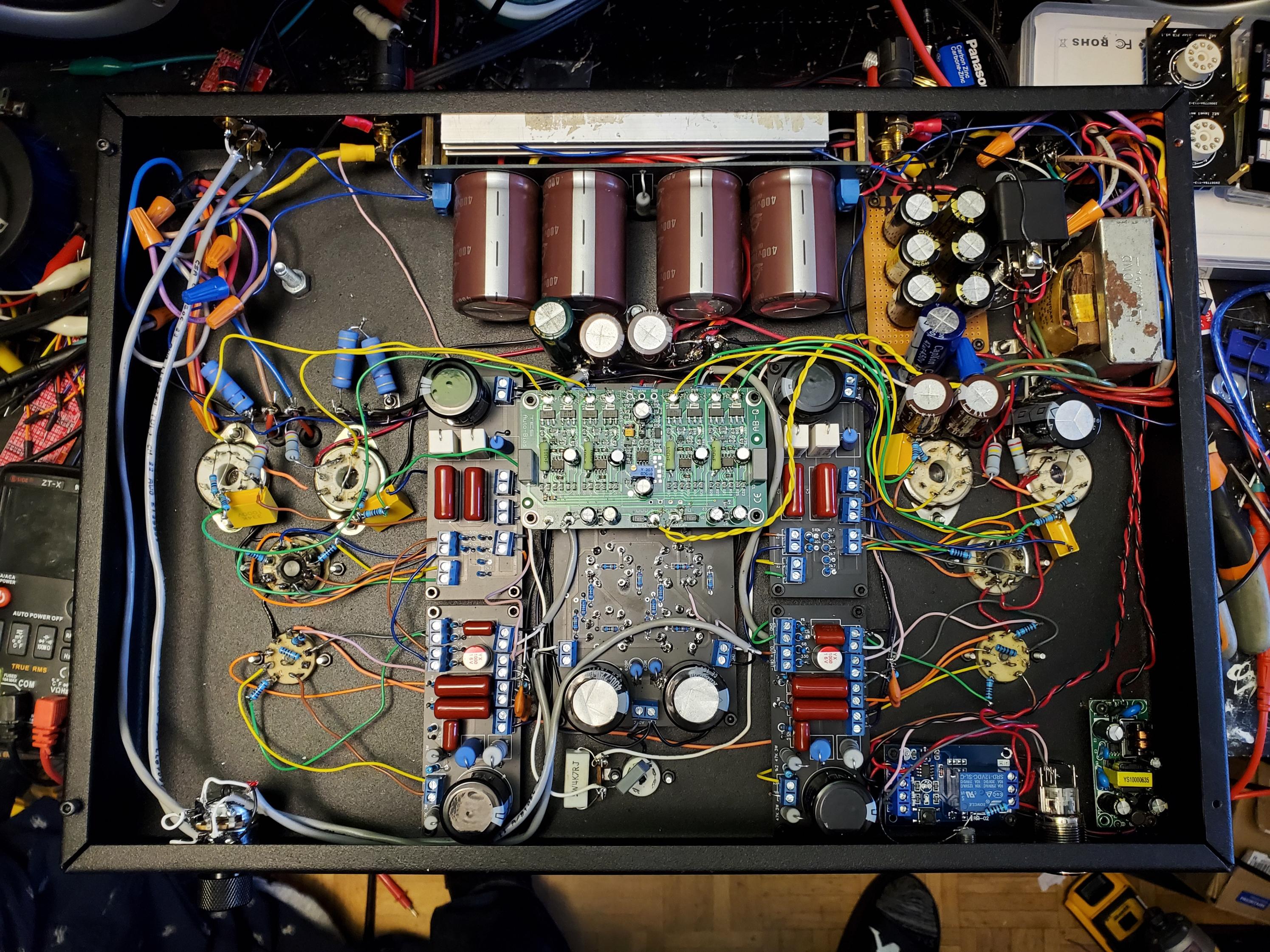

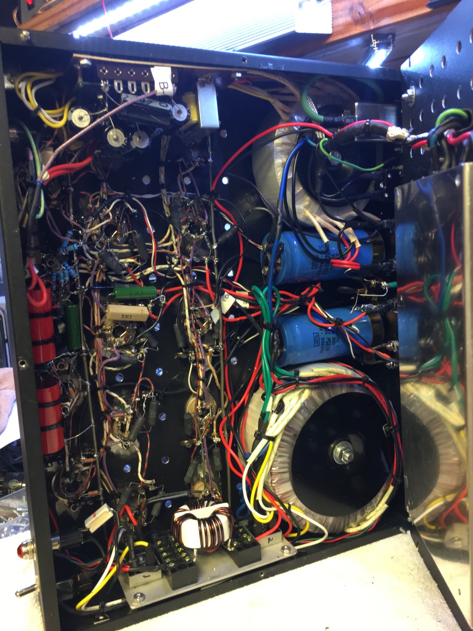

Agreed. Here is a hybrid point to point and circuit board amp I just built using colour coded wiring. The yellow caps demonstrate my laziness - they are 0.33u in series with the 1u on the circuit board. It was easier to tack them on than to take out the boards and replace the caps on them.
