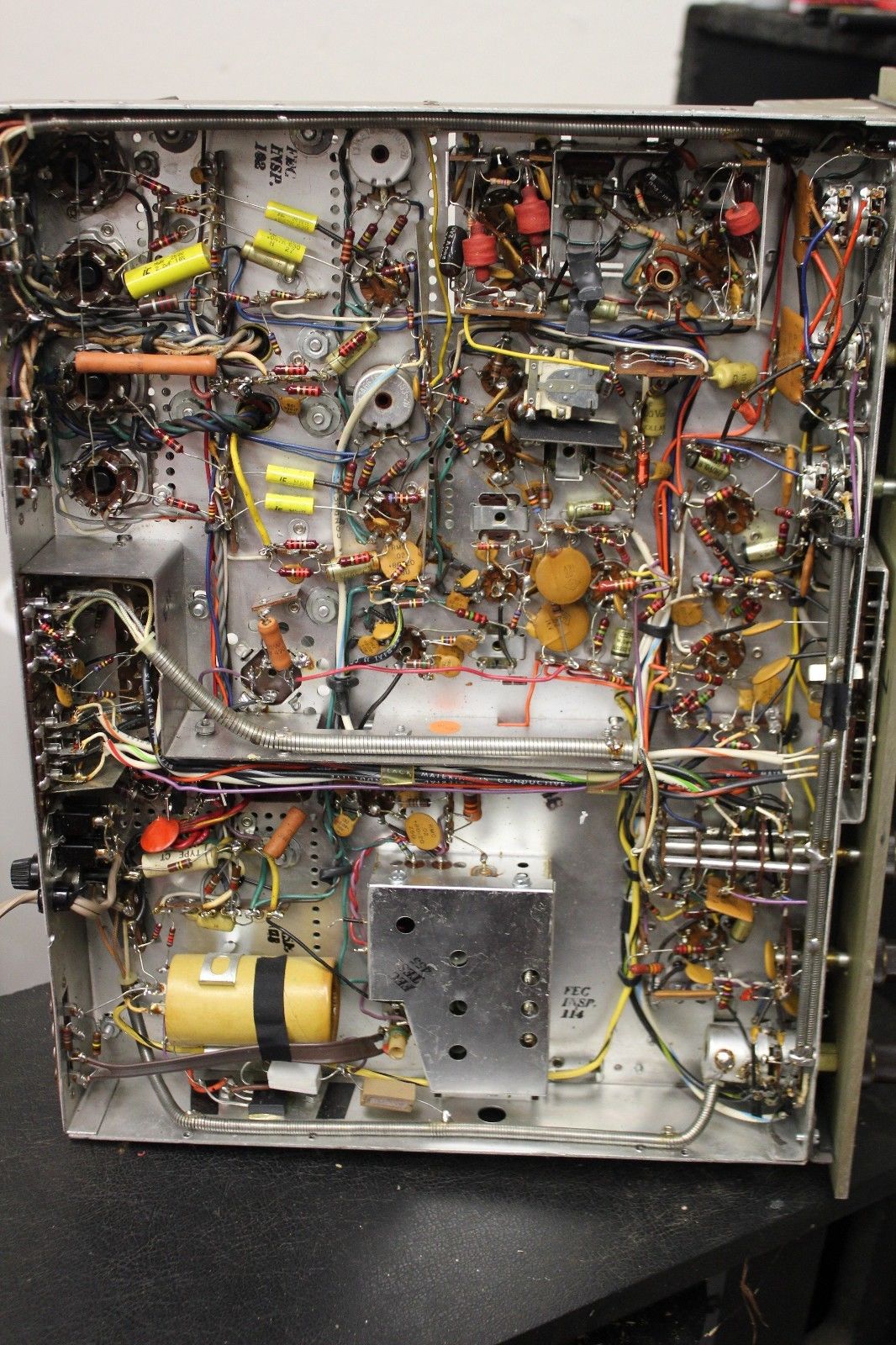

This could make for a great Xmas quiz: name the amp from the chassis view, and for a bonus point, which component is missing?

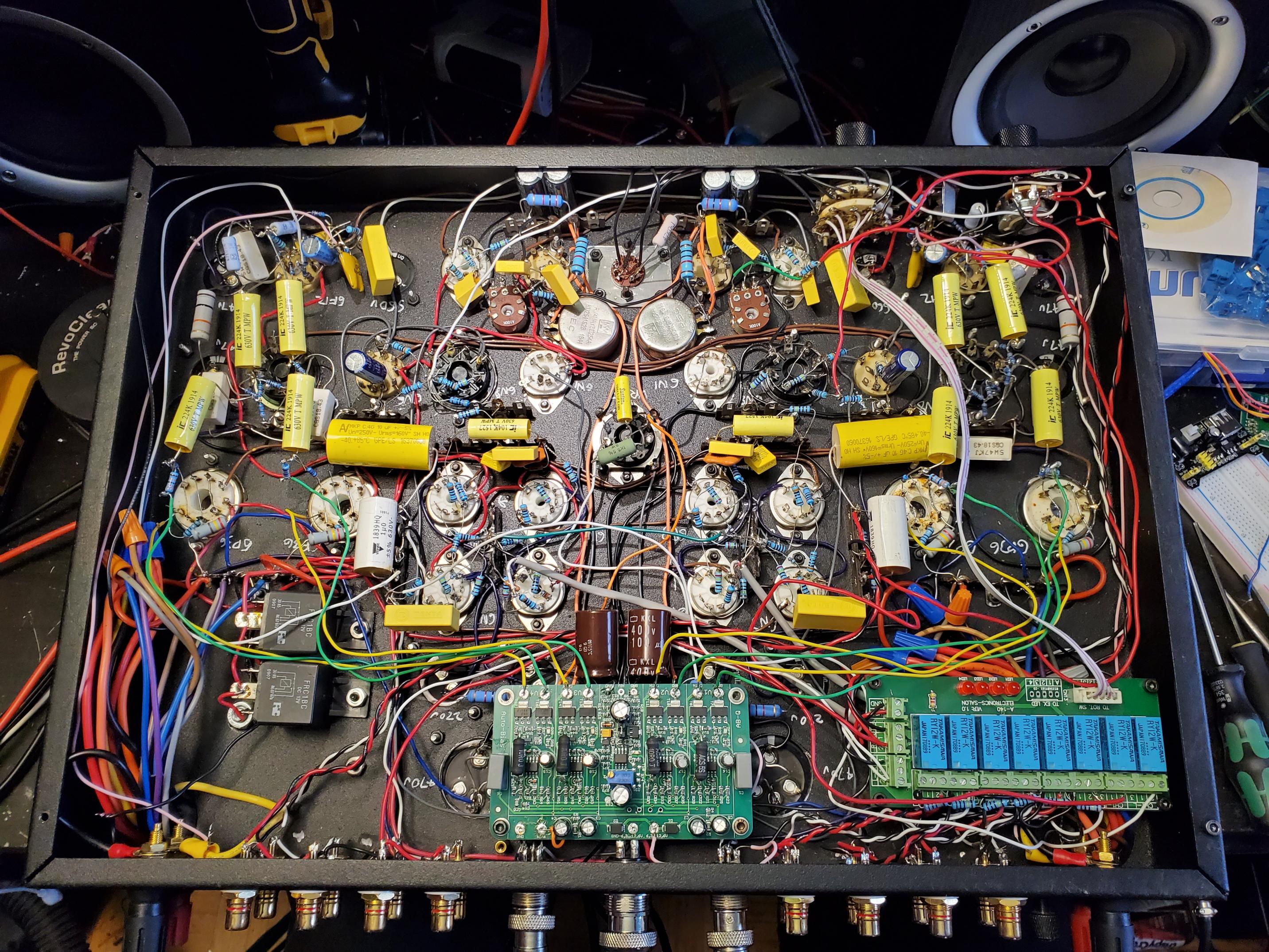

I don't get the idea why people build this style tube amps. Those, with added SMD computer PCB, could be bought in a trillion different versions on the asian marketplaces. They all look the same inside. PCB based tube amps with computer technology inside. Very cheap and readymade. No hassle with DIY necessary.They also produced progressively more complex designs... My last build also looked nice before I finished it. 😀

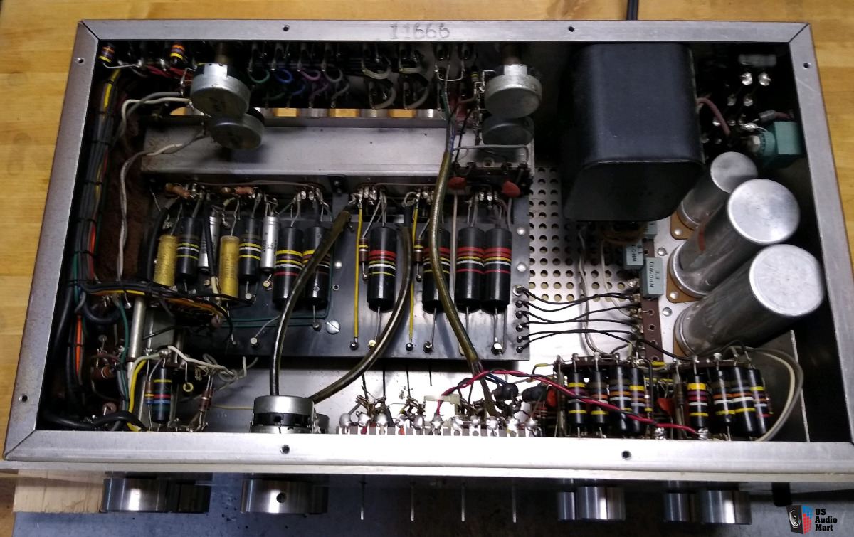

I use those IC caps... Did you recap or did Fisher also use them?
I bought this amp like this, cap already replace by the owner.
I did a full restauration using a restauration kit from a guy named "Metalbone" . (No affiliation with the guy)
This is what you get:
1. Bias Power Supply (bridge, electrolytic and film capacitors and resistor)
2. Power/Power Supply (current limiter, film capacitors [can caps not included] and diodes)
3. Amplifier Section (electrolytic and film capacitors and resistors. The full kit includes Sonicap Generaltion II coupling capacitors)
4. FM Signal Path (electrolytic and film capacitors)
5. Multiplex Section (electrolytic and film capacitors)
6. Heat shrink tubing
7. 1 full copy of the service manual (including schematic)
8. A 14-16-page detailed description (with photos) of how this kit was installed on another Fisher Receiver.
9. A reverse tube layout diagram for easy chassis to schematic reference
10. 1 additional copy of schematic for marking up (multiple pages)
So I ended up replacing those yellow cap anyway. Good kit. I also replace the Volume pot which is the ON/OFF switch at the same time.

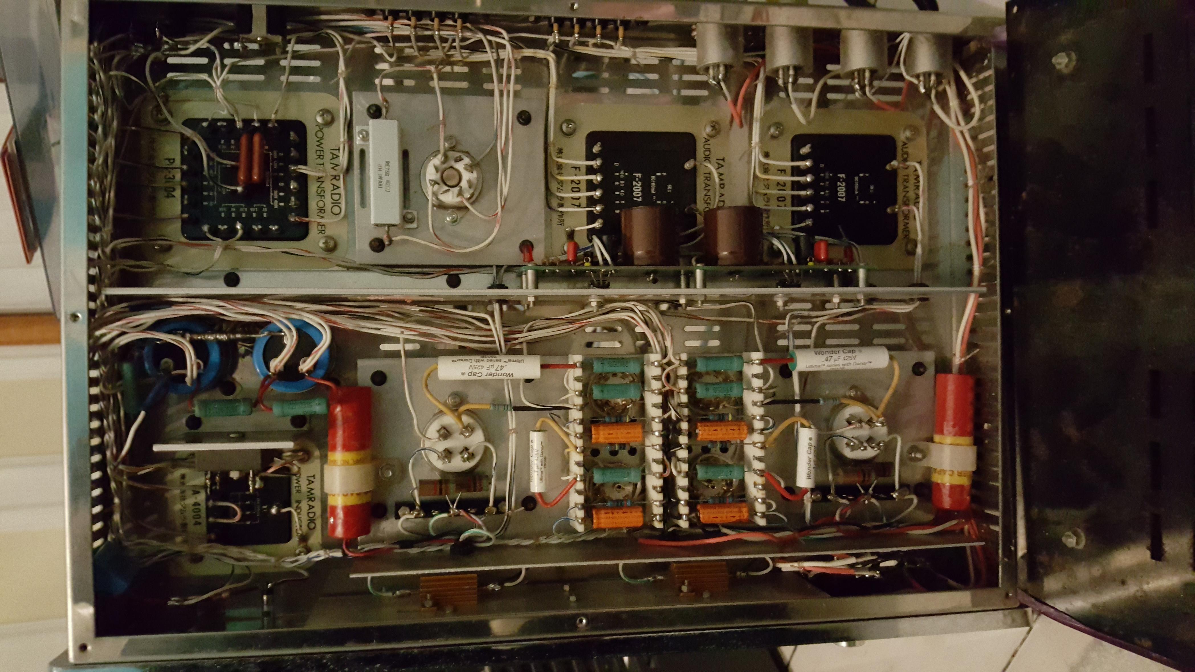

I built this as a test of the boards. I designed the VA/PI, preamp (actively loaded triodes) and driver boards... No computers though. This is an all analog design, even the AB-Q module which I didn't design. It's from Pavel at Audioamp.eu I will offer these boards for sale soon.

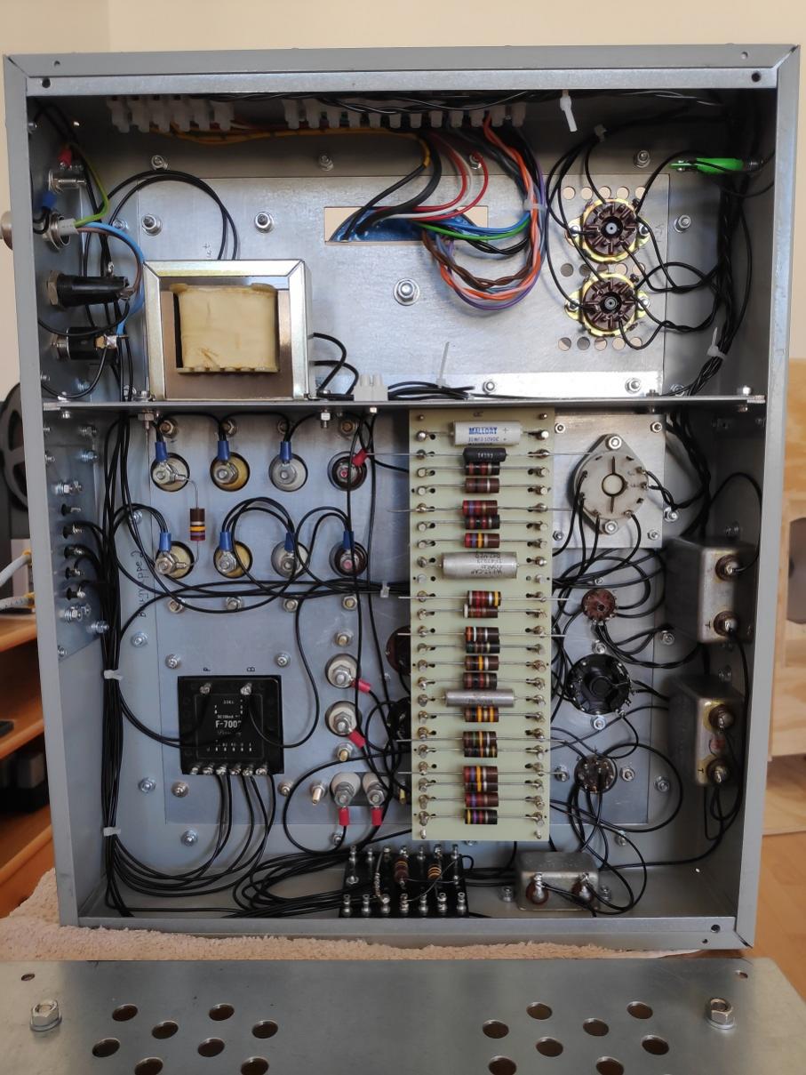

This is effectively the same amp (with added RIAA and 6E2 meters) but without the circuit boards... Just look at the left and right sides.
Very clean, but somehow I still prefer this 🙂
I refuse to take your comment as a seriously one (despite your attached "smiley") when I am looking at this picture.
It is: CHAOS for me........
is not "point to point" but "spaghetti" wiring.
Completely serious actually. At least if I was the one that wired it 🙂
