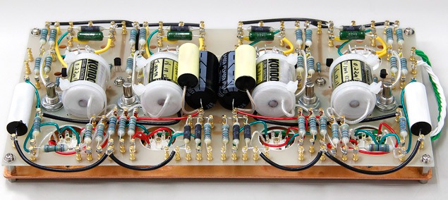

I'm surprised nobody mentioned the late Kondo-San so far: a true work of art that has its place in the MOMA, if you ask me,

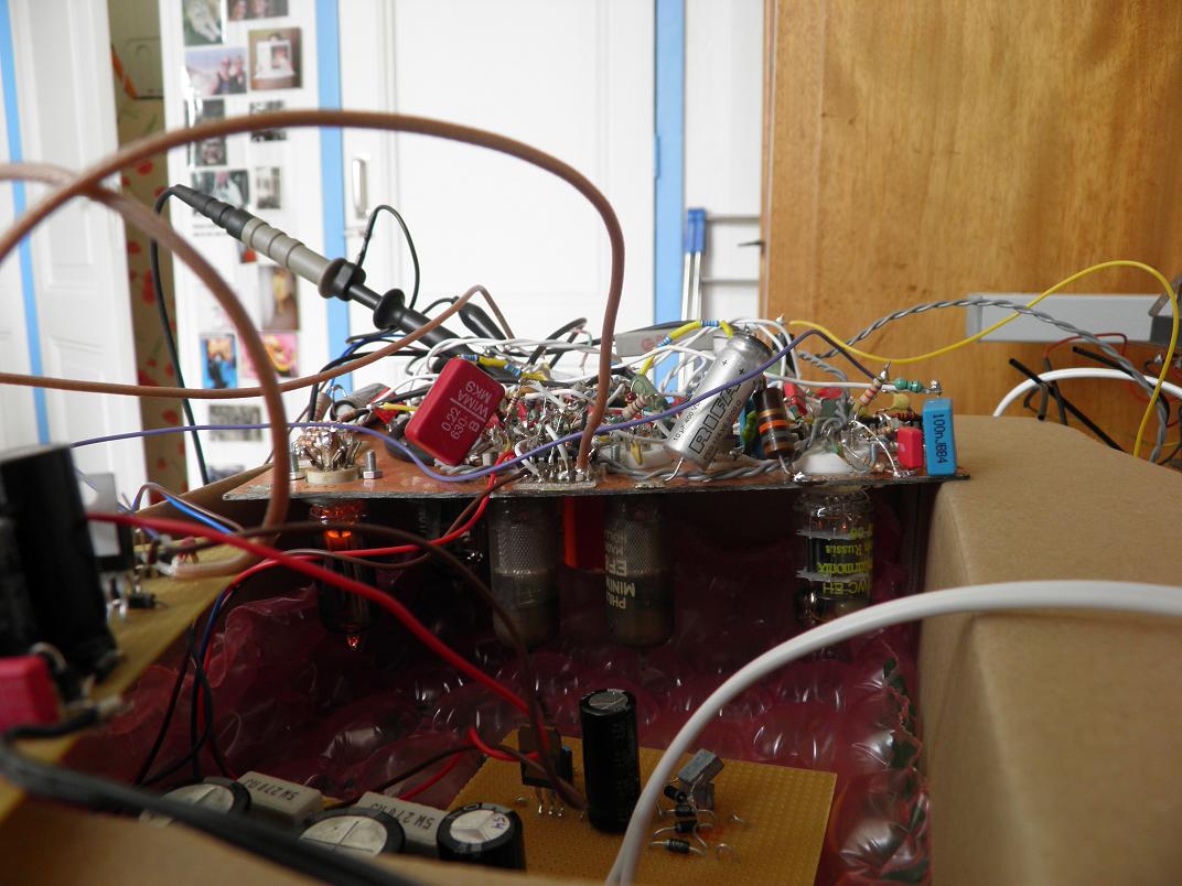

Prototype of my valve DAC, the final design is on a four-layer board:

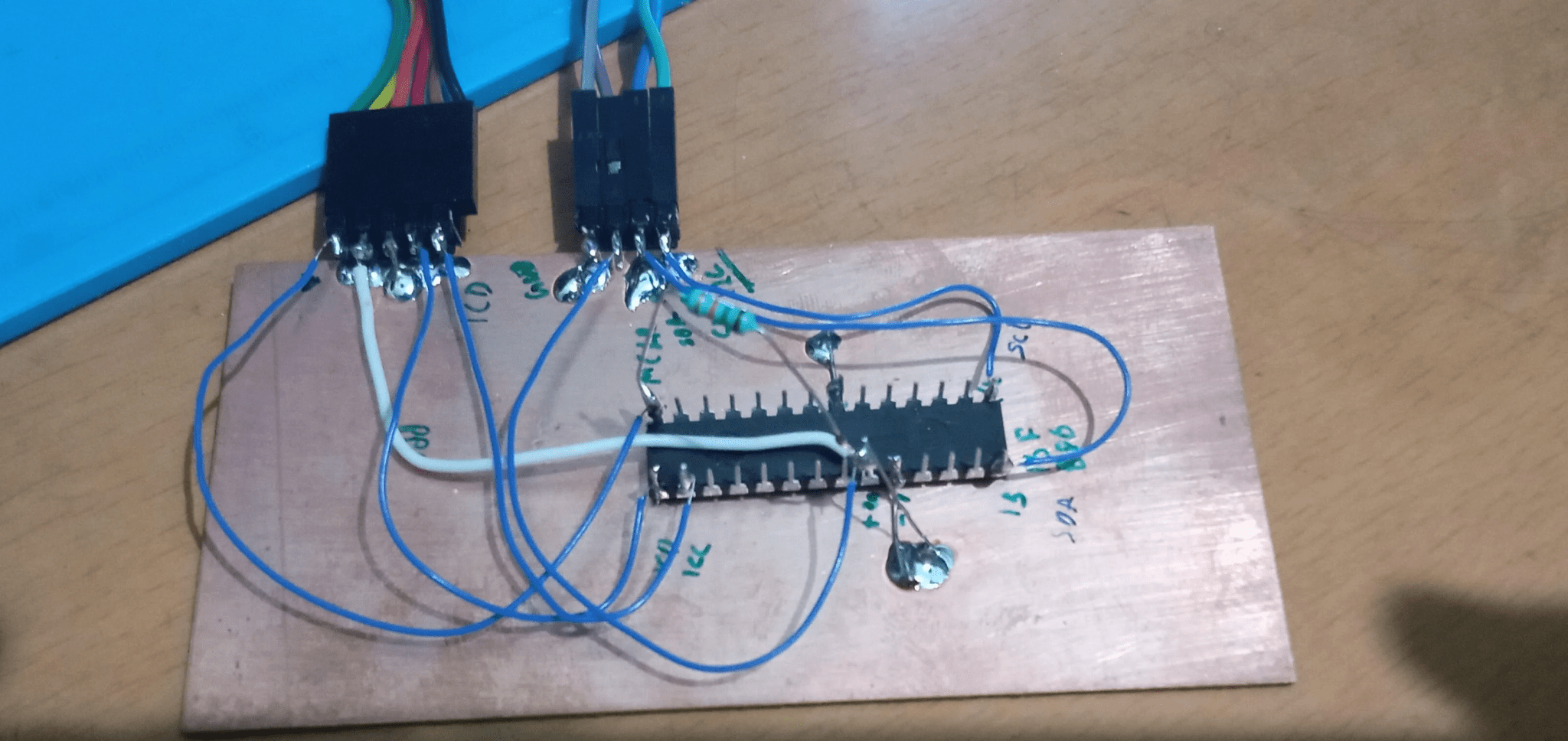

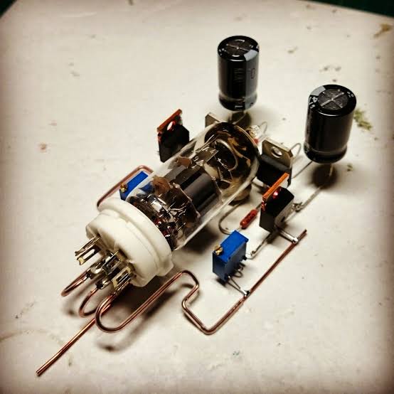

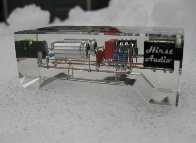

I suppose it comes from free form circuits not enclosed that resembles some dead bug. Some examples attached, but you can google the term deadbug circuits or free form circuits.What does the term "deadbug" mean in this context?

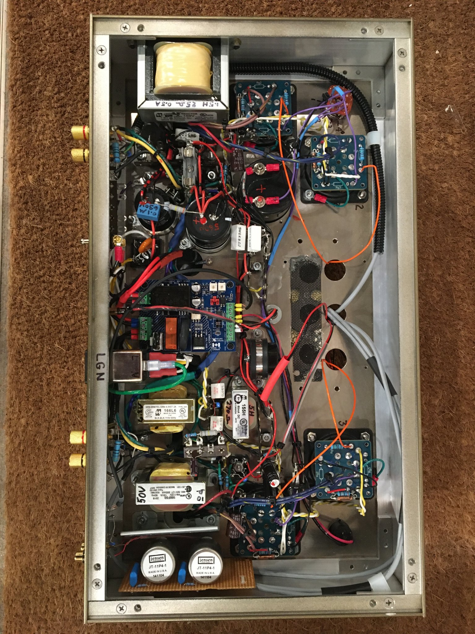

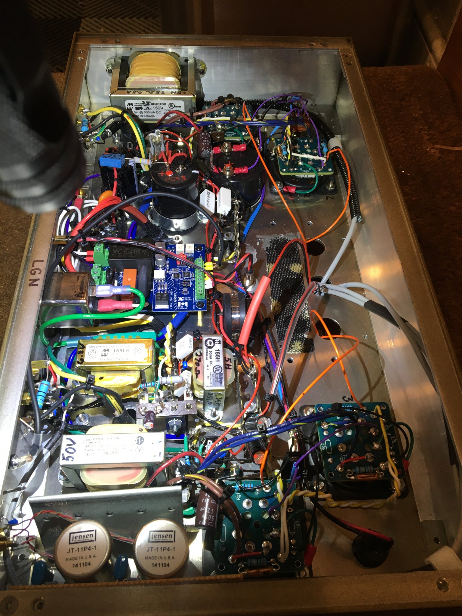

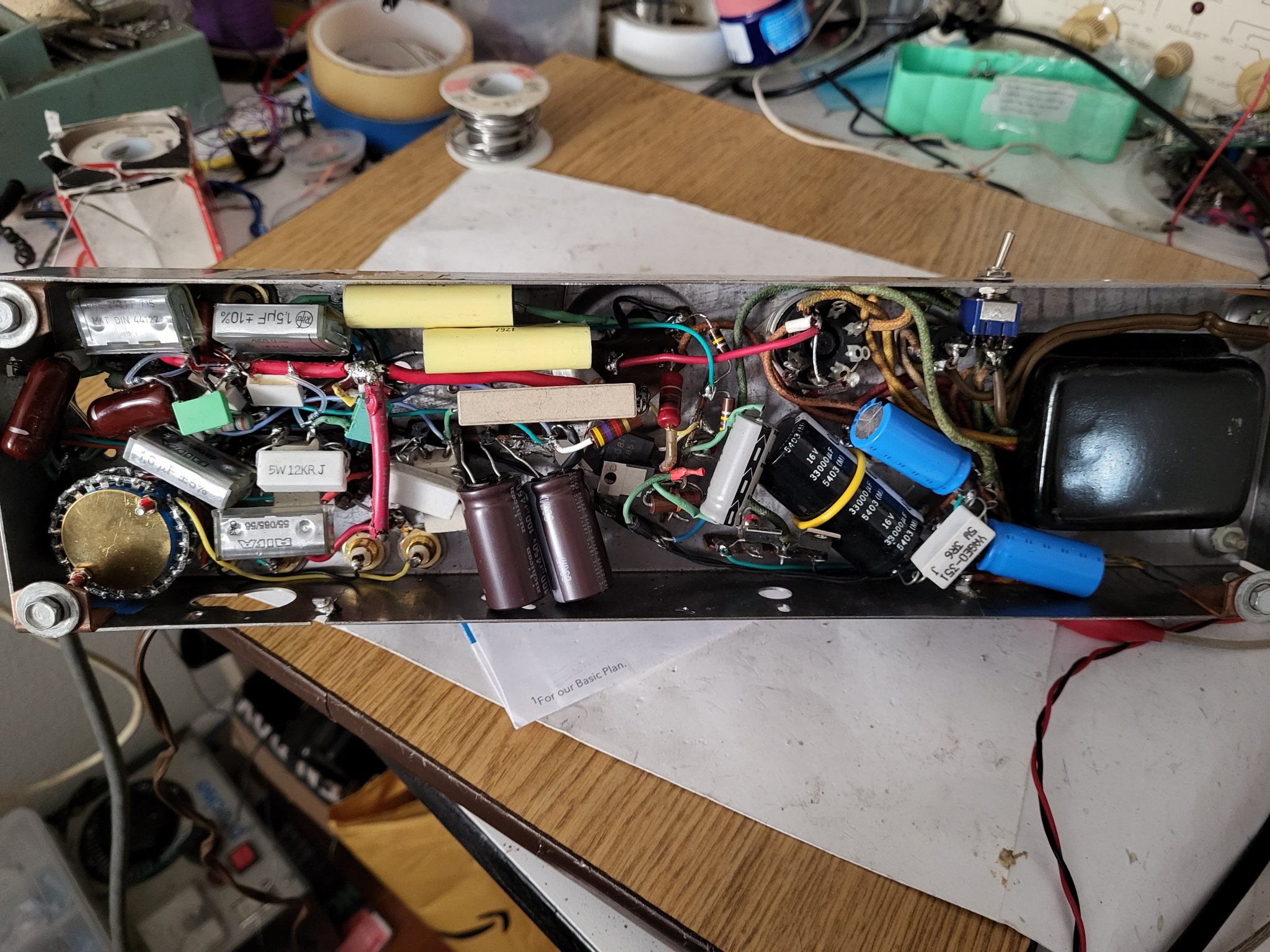

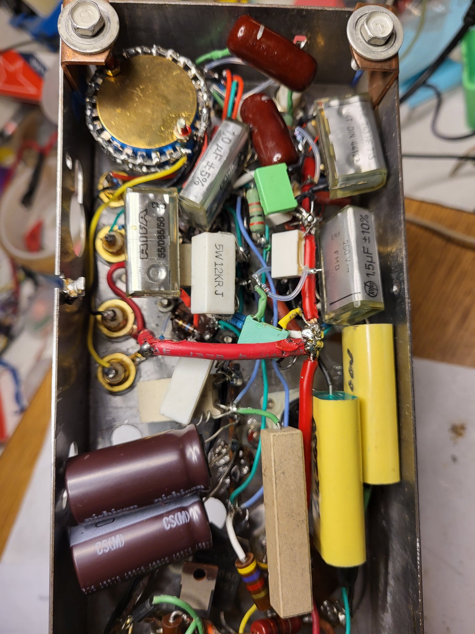

Well, I found a chassis and decided to wire-up a bunch of parts lying about the workbench. That took quite awhile....more than quite awhile. Those darn parts were actually all over the garage. 🙄
I decided I had enough fun wiring-up bits, but few wires were still hanging out. Luckily the chassis had a few open holes for them to go into...so that looks tidy at last! 🤓
Now what to do with that blank open area in the middle? 🤔
Maybe it can be modified into a tube power amp? O.K., but it will be my first tube project, so we will see what happens... 😵

Fits like a jigsaw. Out of interest, how did you plan this? Trial and error, or computer drawing/pencil and paper?Well, I found a chassis and decided to wire-up a bunch of parts lying about the workbench. ...
Hopefully the "jigsaw" will add up to a complete "picture", when completed...🤓
The short version, 😴 , is that I mock-up the physical part locations and build the whole assembly slowly in my mind's eye. Parts can be moved around, swapped, viewed at different angles, etc.
As one builds, sometimes a brief sketch helps...installing extra terminal strips helps...in a pinch, going up from the deck with a terminal on a bracket helps.
The chassis fabricator did require drawings. Seems they could not read my mind... 😉 They did some holes, I did some holes.
The hard part is considering the consequences of each part placement in terms of the dozens of constraints like heat, magnetic fields, electrical fields, service, de-bugging, noise, and especially the ground return nets. Unfortunately, this does not result in one of those super-neat production chassis of yore.
It is a prototype in a somewhat nicer-than-prototype chassis. Judy wanted a tube amp for her birthday 😳 She calls it a "toobie" 🙄.

When it is completed, it can be shown in the tube photo section. ( If I make it, the 500VDC makes me nervous...ZAP!)

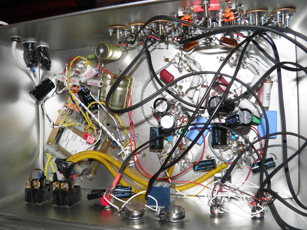

Admit it: you had help from nanobots!6aq5 line stage pre-amp with phono.

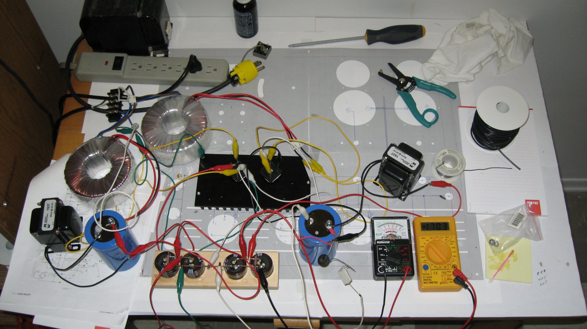

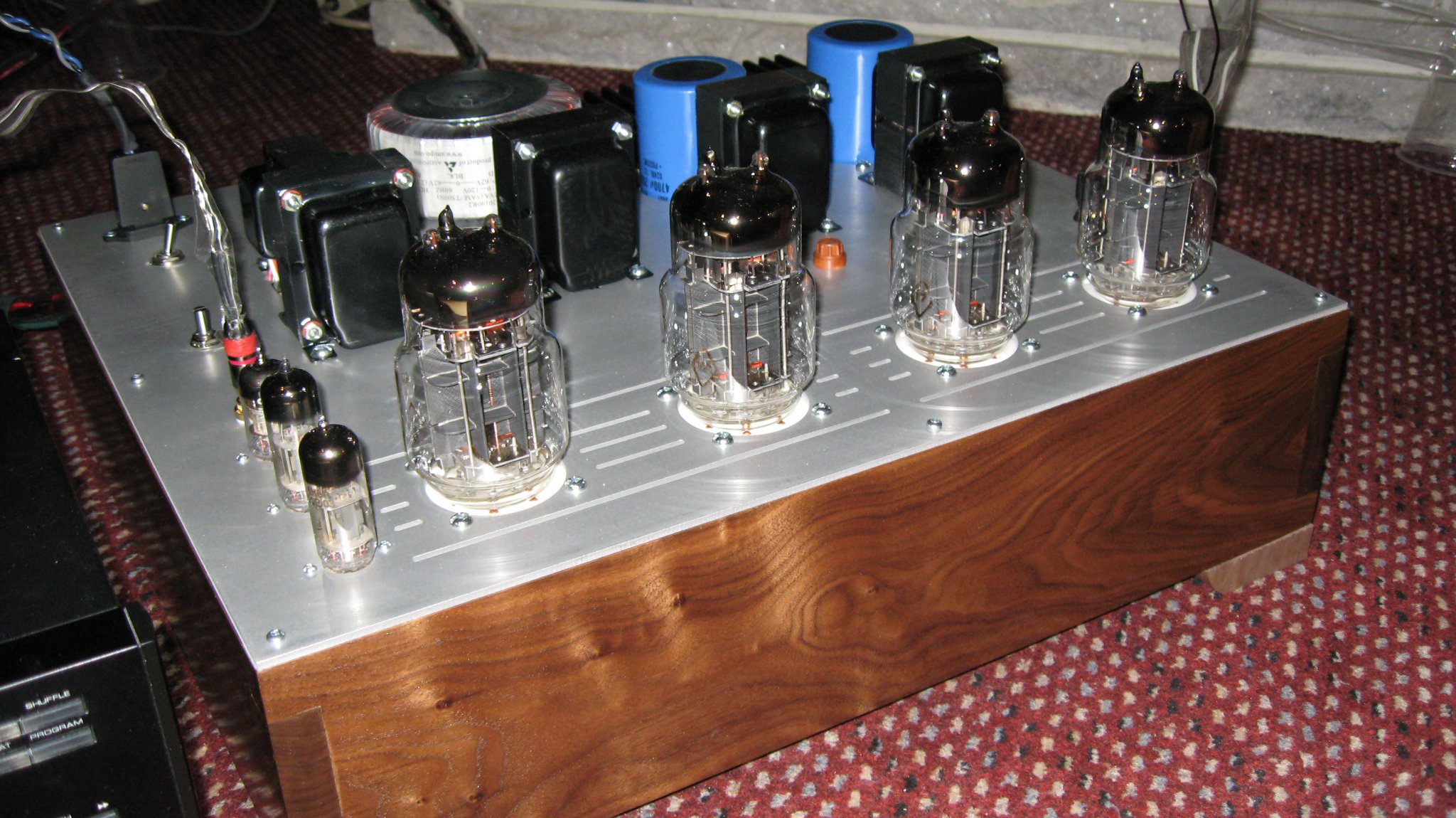

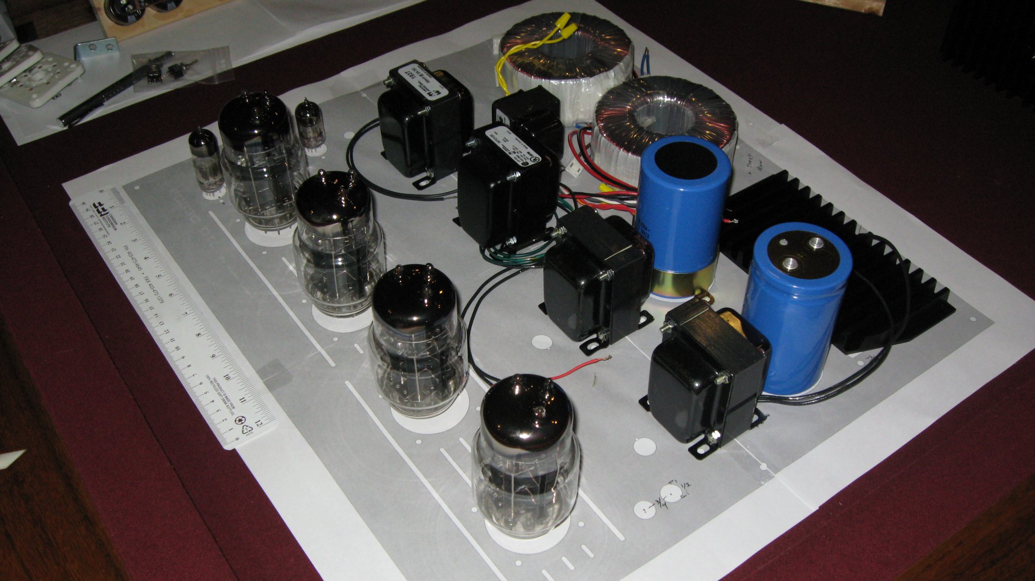

I used CAD to lay out the chassis. Then checked that all the parts fit on a printout. It was relatively easy to sketch out the wiring connections on the printout. When it was set, the CAD file drove a waterjet to cut the holes. After that assembly was pretty easy.

A well executed process, with a beautiful result! 👍I used CAD to lay out the chassis...etc.

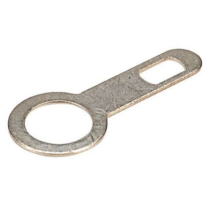

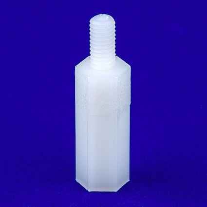

I use M3 hexagonal nylon spacers everywhere with solder tags on top, so I can anchor wires anywhere I want to. Makes a bit of a mess of the top plate but if you countersink the screws it's less obvious.
