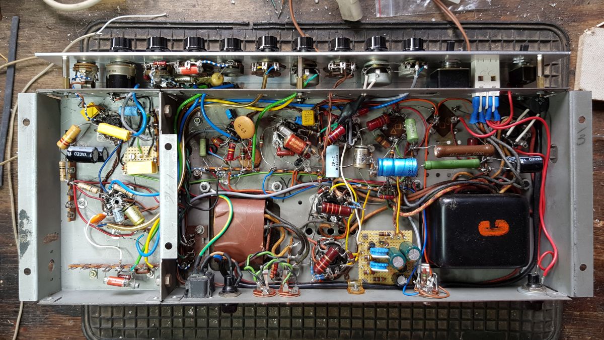

This is my crows' nest style of point to point wiring of a guitar amplifier built into a Hammond AO-64/68 chassis, using the iron of the same K-100 organ:
Admittedly, there are two perfboards, too: One holding a relay for treble boost, the other one populated with a voltage tripler, the LTP phase inverter cascode CCS and the output tubes' bias adjustment trimpots.

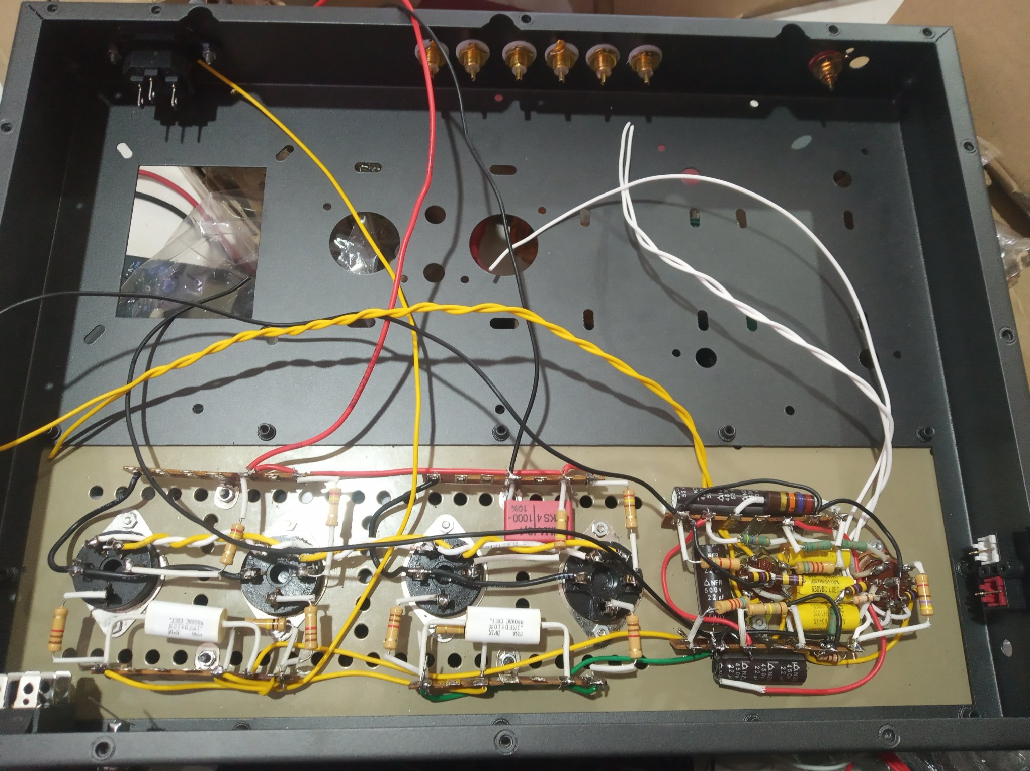

I have built 2 point to point amps so far. Both times I created them first using the physical layout drawing in DIY Layout Creator. This helps with locating bulky items and checking how many tags per tag strip. In the real world there is a 3D element, but access to components and pins is important, i think.
DIYLC is a bit fernickety with bending leads on components, but is free and support my wishes.
Any other approaches or tools?

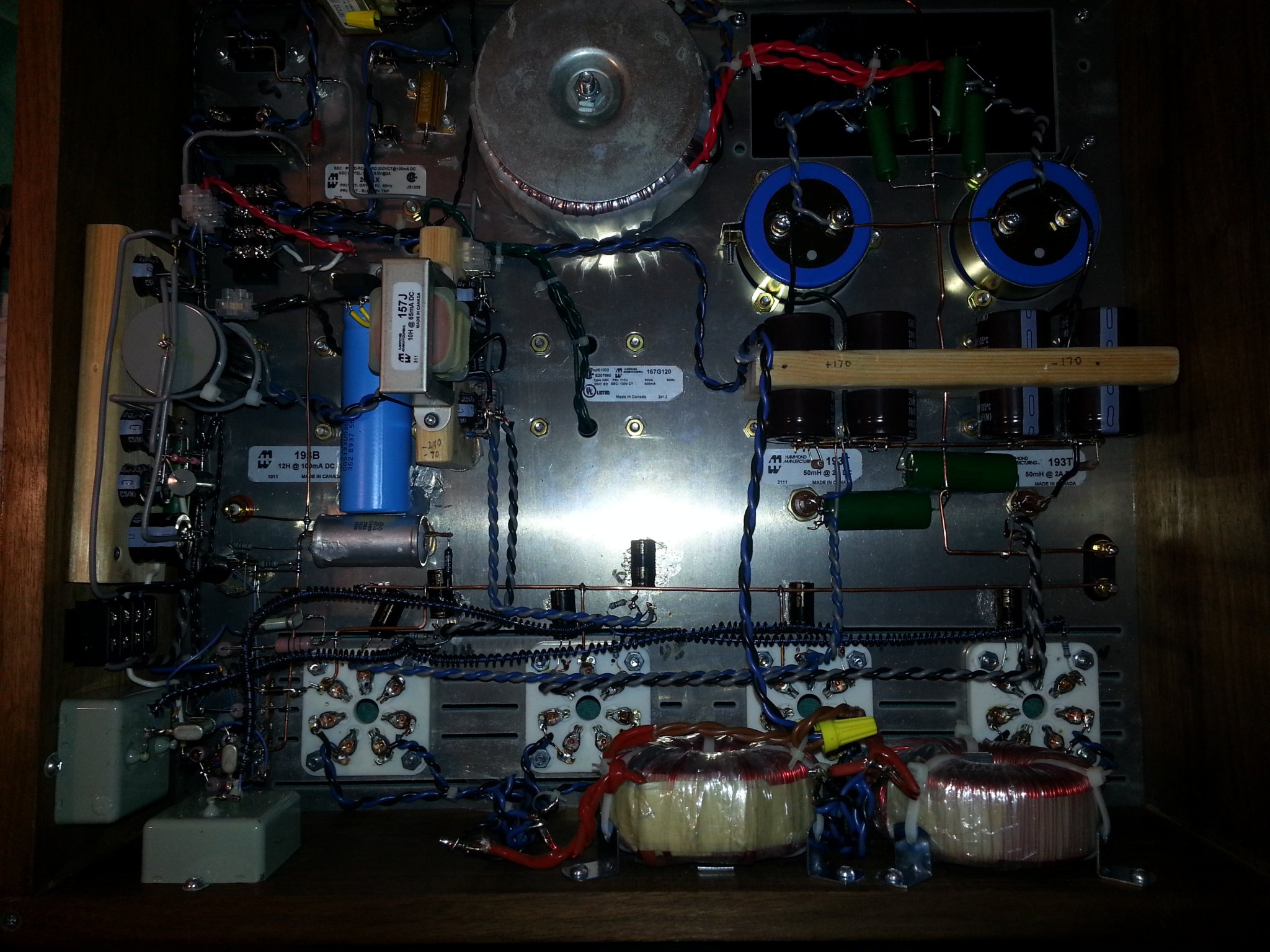

Here are some pictures of Shindo power amps from hifido!
Man that's nice and neat, but if I did this, the chassis would need to be huge!

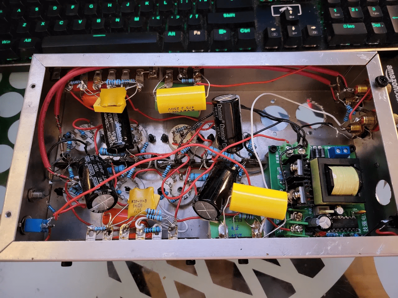

Here's a phono amp I built point to point. Uses a 12V brick to power it.
The PCB I made of this is larger than this chassis!
