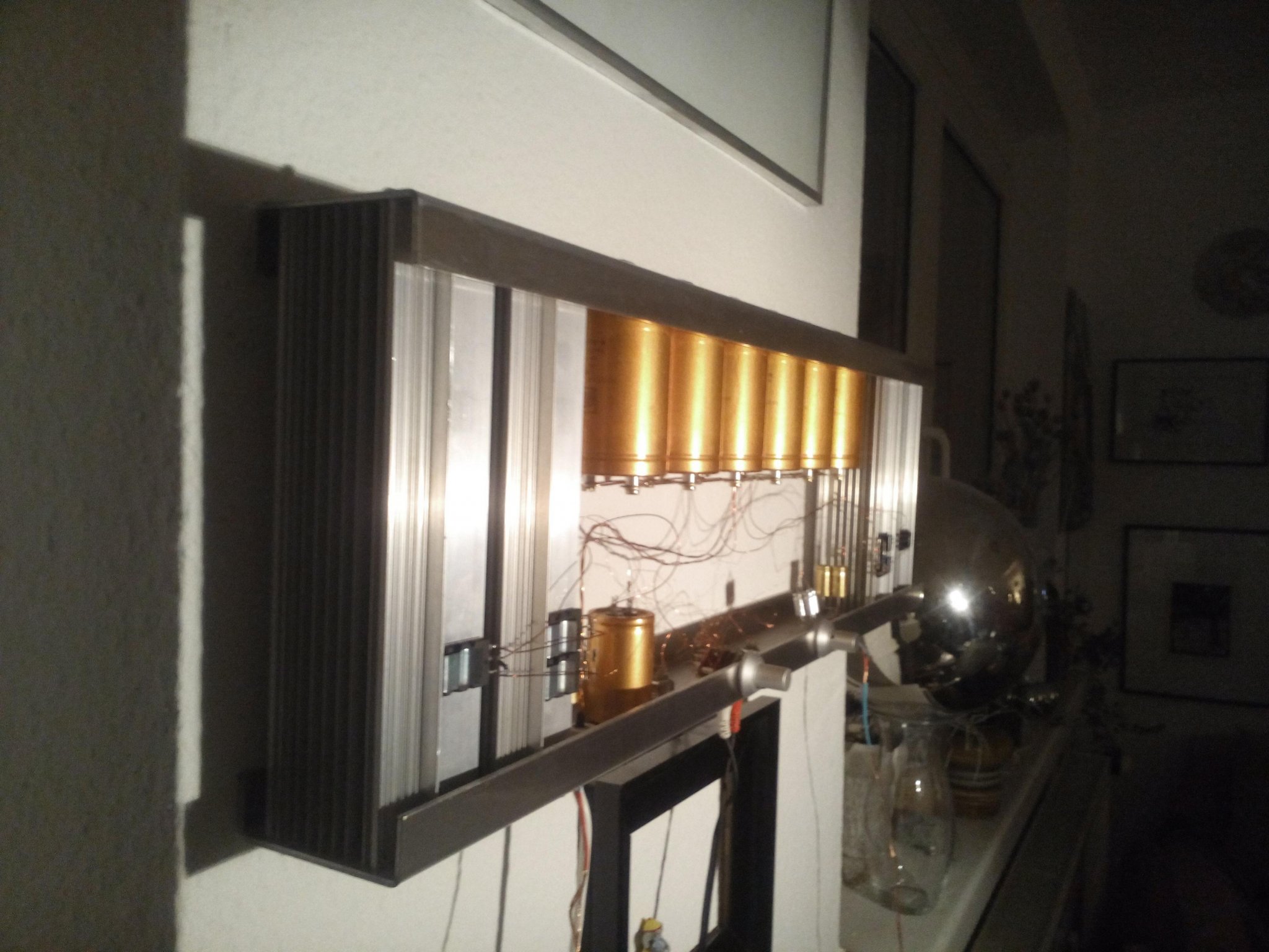

Point to point wiring

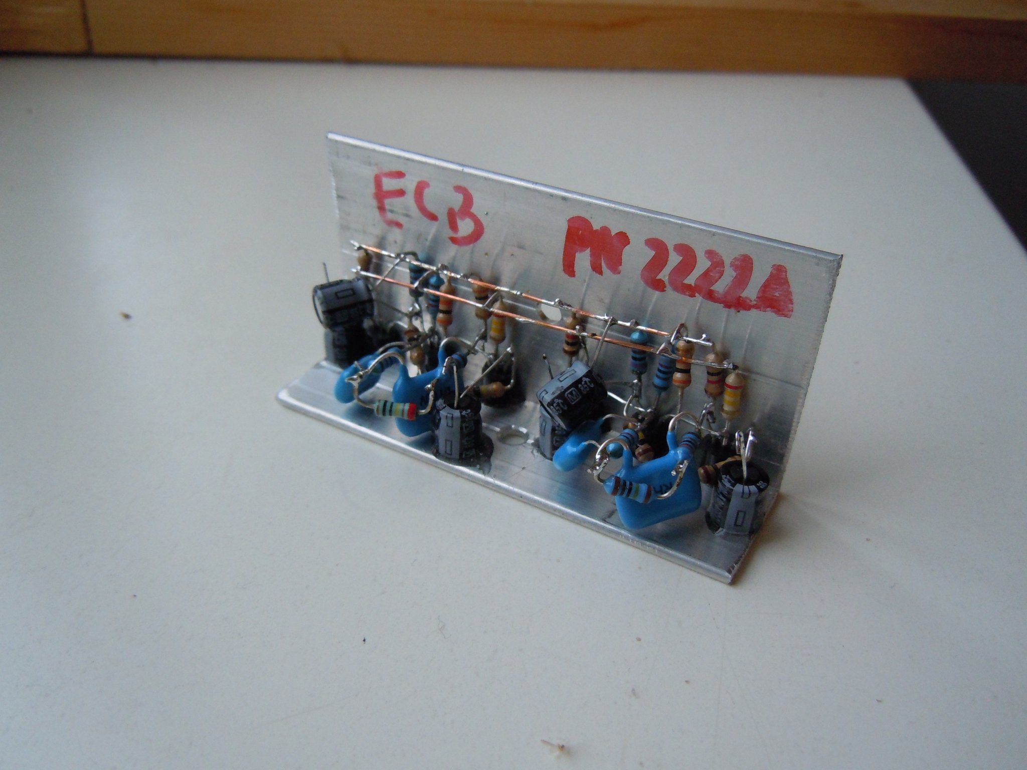

Not beautifully photographed, but also sounds good;-)
Reactions: myleftear
Do not end all parts in one fat solder point. Do use solder tags to fix one part and use this as feeder: set the solder points as close as possible at the "real" parts; we do hear every millimeter and every unnecessary diameter of wire, lead, tag...
For ground use a wire and set the solders joints side by side without bold overlapping solder pads.
All parts have parasitic C, parasitic L, and parasitic R, no matter how large or how insignificant the parasitic is, relative to the part's intended/specified value.
Some parasitics are at the outer layer of the Onion, and others are at the core of the Onion.
Peel the outer layers off of the Onion before attacking the inner layers.
Just my opinion.

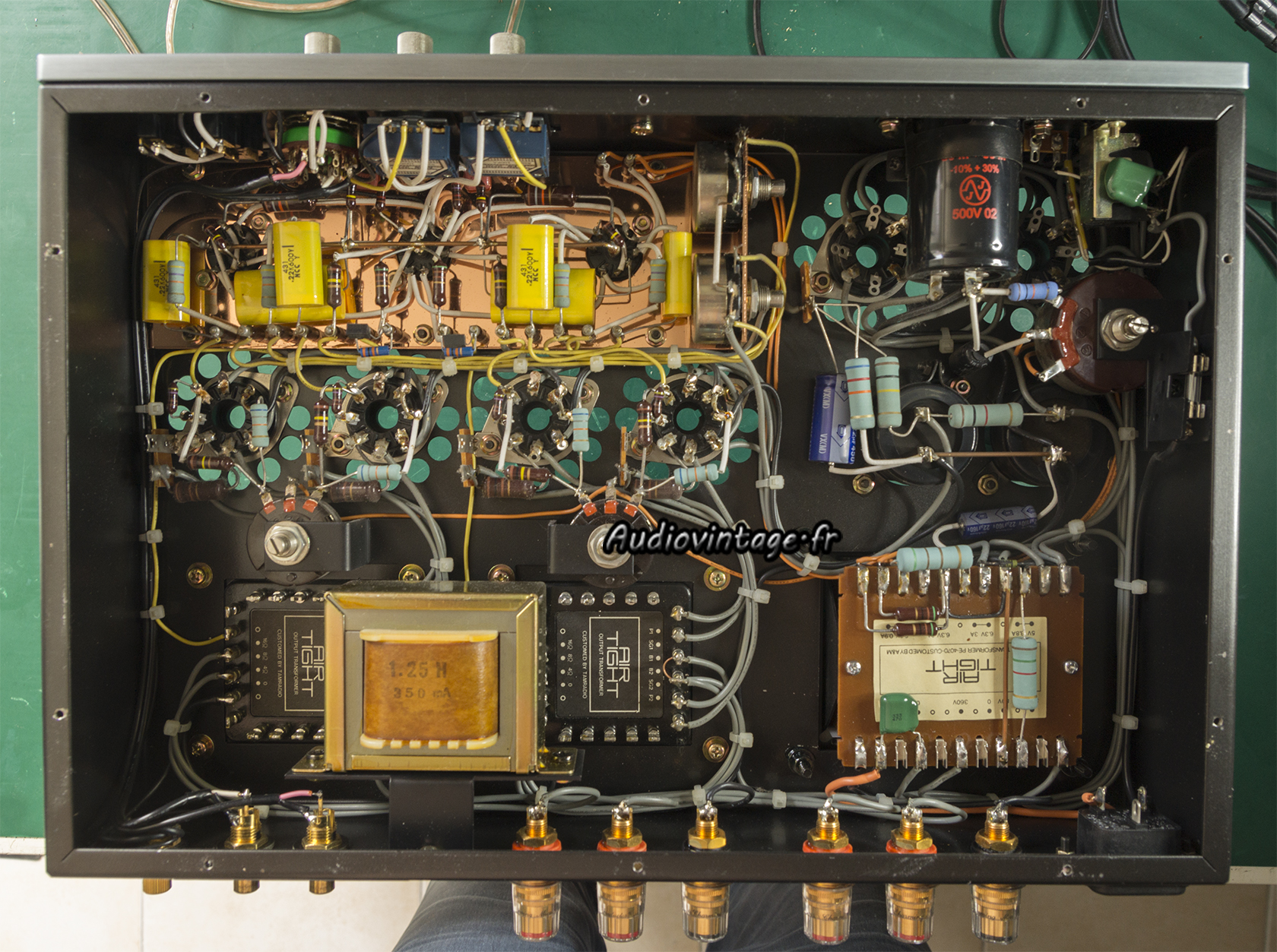

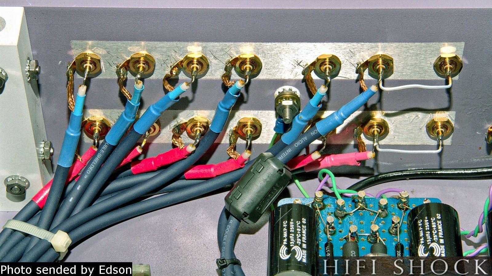

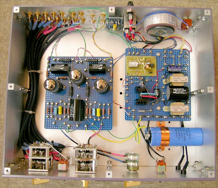

The best example: never use these screwed solder lugs. This gives away a lot of cleanliness, resolution and homogeneity. And with RCA, use only ONE channel to connect the ground. When using both channels, you have sound worsening larger cross-cuts, more undefined transitions, small hum loops, so not One circuit, and more.
Also, it looks like all the grounds are connected to this cabinet. Should it be so, then it is simply botched - and the result sonic garbage)-;
Sorry)-;
