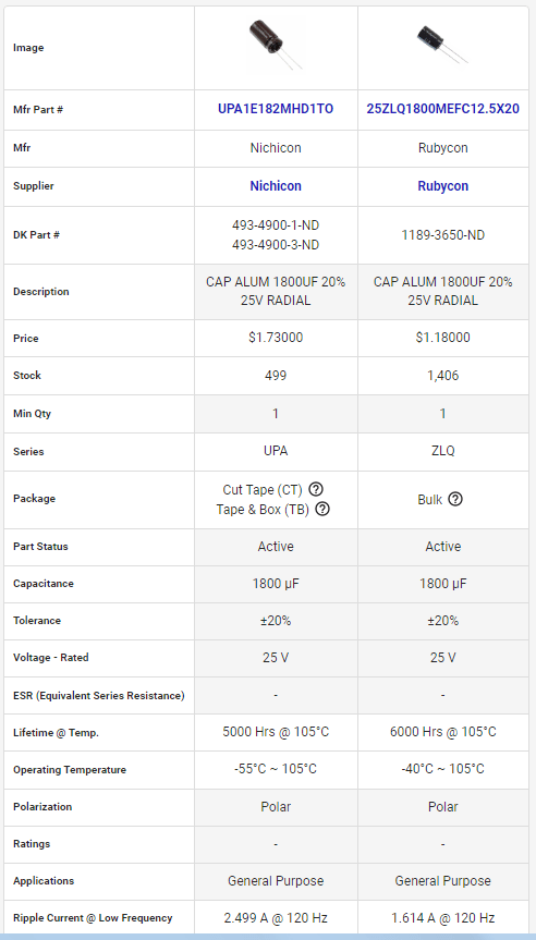

1. Check post#1 of this thread to learn the physical size of the inductor which the PCB is designed for. Lead spacing and body diameter. Check whether your proposed replacement inductor has the same lead spacing and the same (or smaller) body diameter.
2. Use the comparison feature of DigiKey's website to get a side by side table of the specifications of the original, and the proposed replacement, inductor. Check to see whether the replacement is as good or better in every case. Here's an example, using DigiKey's site to compare two capacitors.
_

Hi all, in trying to find replacement caps for Marks awesome little filter I've been on what I hope is a learning curve.
I'm starting from absolute zero knowledge so please bear that in mind.
Please let me know if I'm on the right track albeit at a very basic level.
A basic smps despite on board rectification will still output DC with ripple (noise) caused by the switching mechanism, passing some ac or both? The filter uses inductors and caps to smooth out the ripple.
ESR is the resistance of DC current so the lower the number the better, as a side shoot lower ESR also reduces power loss from internal heating and extends the life of the capacitor.
The high no for ripple is the caps ability to withstand ripple currents before excessive internal heating occurs?
When looking at data sheets ESR appears to not be mentioned but impedance is. when looking at the sheet we can use impedance as an estimate of ESR for the given frequency as at lower frequencies they are pretty much the same only diverging at higher freq.

It's a DC power supply. We want pure, zero Hertz, DC on the output. We don't want any other frequencies. They are all undesirable, they are all "noise", and we want to remove them.
In power supply filters, ESR/impedance is undesirable because it gets in the way, preventing the capacitors from shunting high frequencies (noise!) to ground. Low ESR is good, it means more noise gets sent to ground and less noise gets sent to the your audio equipment at the filter output. High ESR is bad, it means more noise gets sent to your gear.
After measuring a lot of capacitors for ESR, I've concluded that large values of ripple current rating usually go hand-in-hand with tiny values of measured ESR. Which is nice because there are a lot of electrolytic capacitors whose datasheets do include ripple current rating, but don't include ESR. Therefore: When ESR data is scarce, sort by ripple current rating. Find the in-stock capacitor with the highest rated ripple current. Compare that ripple current against the ripple current rating of a Panasonic FOX ROMEO ("FR") capacitor of the same physical size, same voltage rating, same capacitance. [the Panasonic FR is probably not in stock because people like me bought all of them.] If the in-stock cap you found, has a higher ripple current rating than the comparable Panasonic FOX ROMEO, use that cap and be happy.
Some datasheets prefer to use the word "impedance" rather than "ESR", but for the purpose of choosing capacitors for this particular PCB {and no other}, you can assume the two words mean approximately the same identical concept.
If the in-stock cap you found does have an impedance rating or an ESR rating, and if that rating is lower than the comparable Panasonic FOX ROMEO, use it and be happy. Be sure to compare numbers in the same column of the table; sometimes they tabulate at more than one frequency. So compare apples to apples by staying in the same column and comparing at the same frequency.
Summary: find electrolytic capacitors that are better than Panasonic FOX ROMEO electrolytic capacitors. "Better" means either lower ESR/lower impedance, or else higher ripple current rating. Perhaps both! If no such capacitors are in stock, pick the best one that is in stock, and realize that your filter performance won't be as good. Later, when better capacitors become available in-stock again, you can remove the low performers and replace them with high performers.

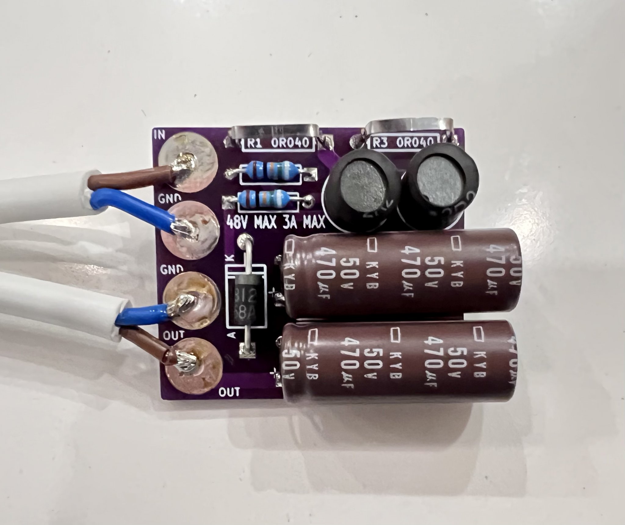

So after weeks of finding components, cables, pcbs, box etc I finally made the filter.
Cracked open the wall wart to replace the cable only to find its only a step down transformer. Its bloody 12v ac
If only I had actually looked at the day rear panel
:headbash:
To rub salt in the wound the power supply caps I ordered are too big so basically a few lessons learnt

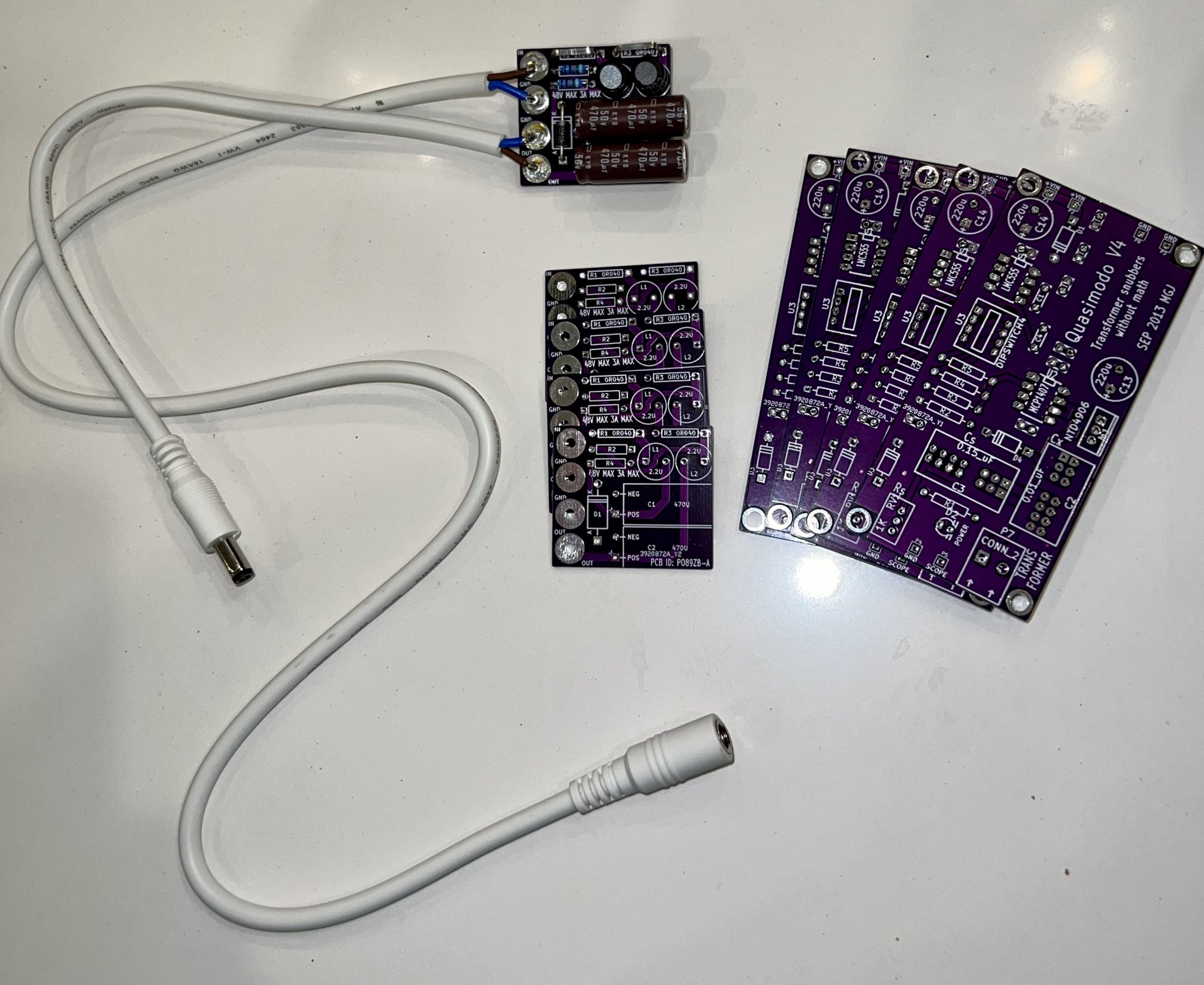

So, pcb ordering was successful and while I was at it I ordered Quasimodo boards also. I have officially built my first diyAudio project! Great first project to work through ordering boards and parts from Mouser/Digikey, not to mention have to use the filter to find substitution parts. This was the first thing I had soldered since playing with RC cars 30 years ago. With all the tips, tricks, instructions, and excellent solder from the diyAudio store it was a piece of cake. Didn’t quite read close enough ordering the DC extension cord, ordered a 2.1x5.5 instead of 2.5x5.5. Went back to look last night and Mark had said, couldn’t find any heavier gauge 2.5x5.5mm extension cables. So ordered a new jack mount for the ACA mini build this week in 2.1x5.5, the Meanwell 2.5x5.5 female makes good enough contact on the 2.1x5.5mm. I do have a non-Altoid case for it, but that will be revealed when the ACA mini is completed.
Now to go back through the thread and see if I can measure the improvements with the oscilloscope. Thanks Mark for the project, and I think it should remain out of stock at the store to force Noobs to jump in and order our own boards.

Of course you can measure it with a scope (and are unlikely to be disapointed)... and / or you could just listen to it, to find out if you hear any improvements and if so which ones 🙂
It is so easy to plug it in and out to listen to the difference...
Have fun and well done
