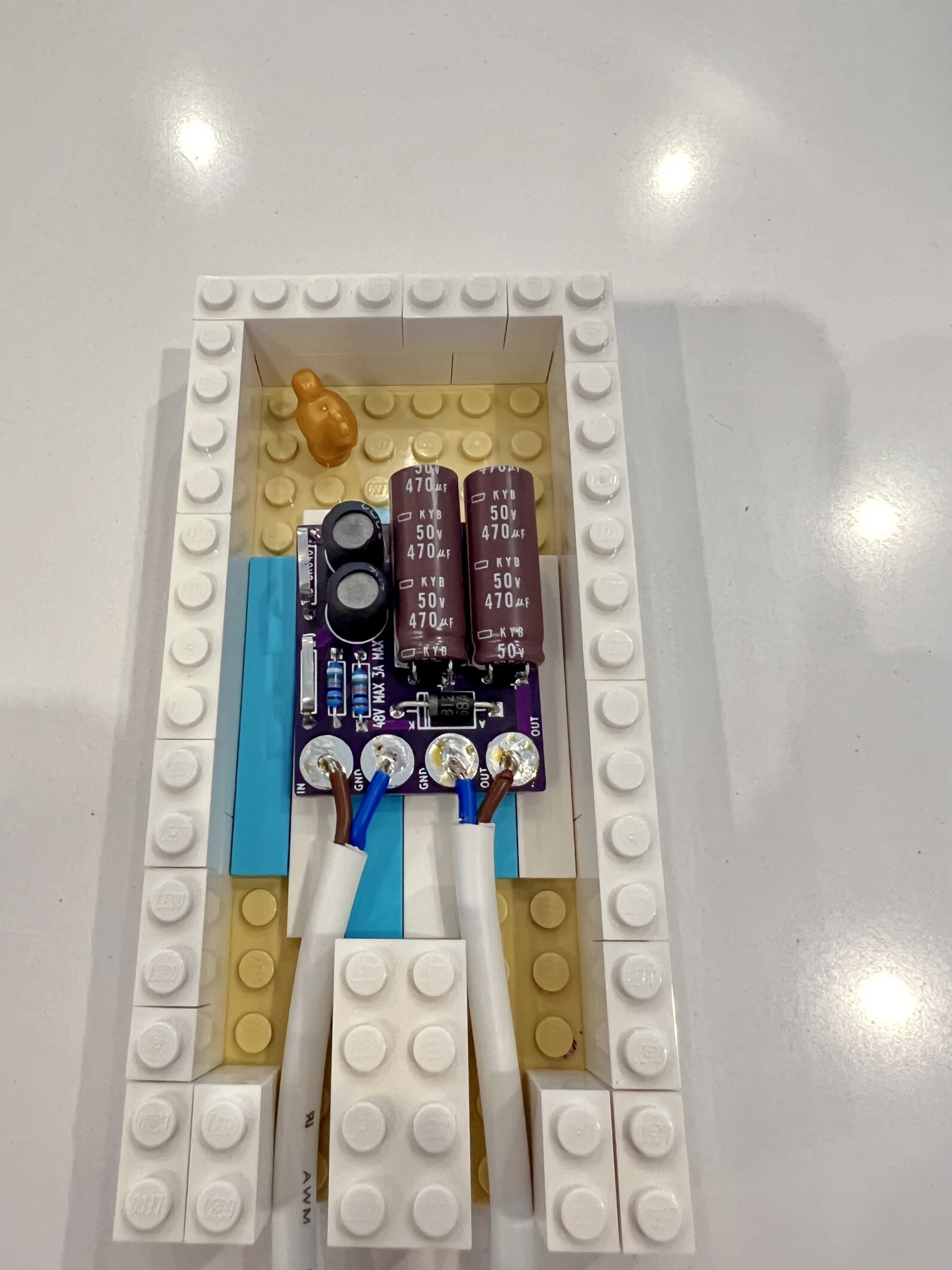

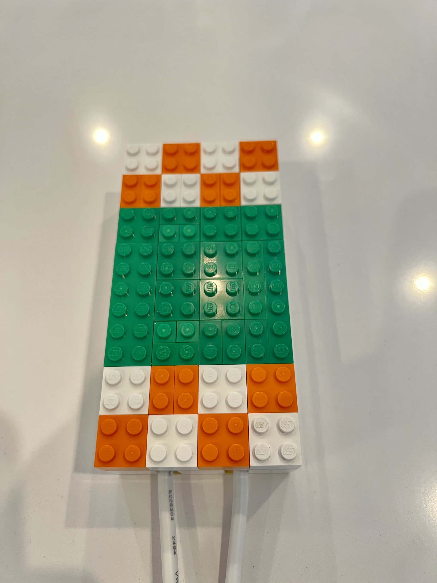

SMPS finally in its new case with help from my daughter. We all know the secret sauce of the Pass amp boards is a blue LED (or green for ZM boards), but according to my daughter the SMPS needs a golden chicken to oversee function.
Talk about thinking outside of the "same old, same old" box and putting into a innovative box. Congratulations to you and your daughter! Wonderful inspiration! I am inspired....

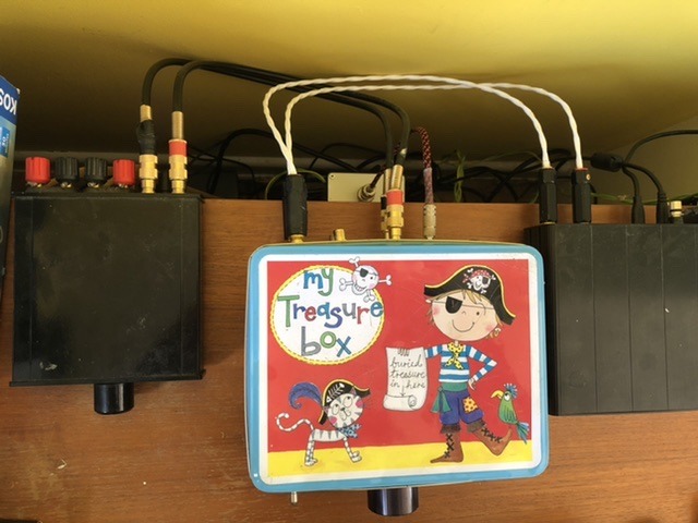

If you are interested, here is the rest with its ACA mini.Talk about thinking outside of the "same old, same old" box and putting into a innovative box. Congratulations to you and your daughter! Wonderful inspiration! I am
https://www.diyaudio.com/community/threads/diy-aca-mini.379037/page-36#post-6972636
Oh yeah!If you are interested, here is the rest with its ACA mini.
That is ******* awesome! I wish I'd thought of that!SMPS finally in its new case with help from my daughter. We all know the secret sauce of the Pass amp boards is a blue LED (or green for ZM boards), but according to my daughter the SMPS needs a golden chicken to oversee function.

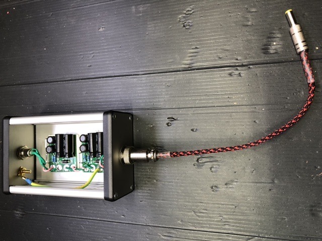

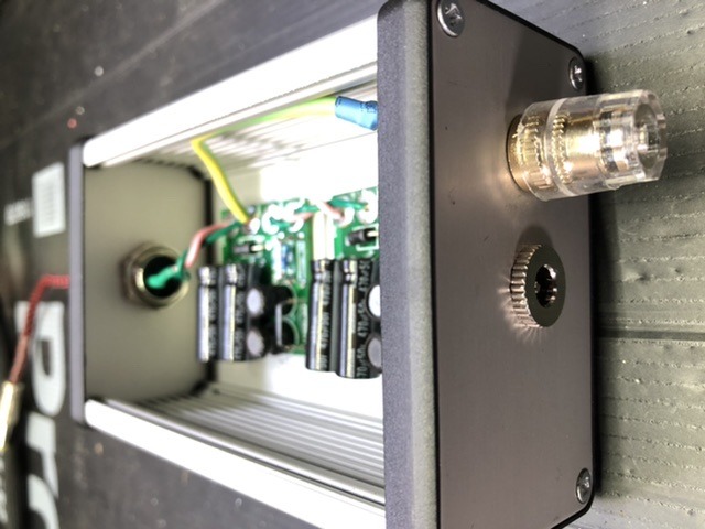

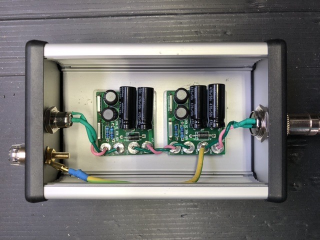

I made a thing. Thanks to Mark and everyone else involved who gives so generously.
And here it is in service.
Cool build!I made a thing. Thanks to Mark and everyone else involved who gives so generously.
View attachment 1042827View attachment 1042828View attachment 1042832

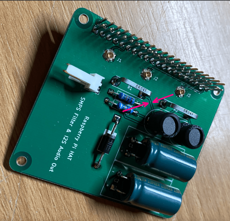

Hi @carsten.witt , I just noticed a feature of your PCB. There's a fairly narrow copper track on the top layer, connecting to 0.04 ohm resistor "R1". Have you checked one of the (free online PCB calculators) to make sure your PCB tracks can safely handle the amount of DC current flowing in your application?

@Mark Johnson ,Hi @carsten.witt , I just noticed a feature of your PCB. There's a fairly narrow copper track on the top layer, connecting to 0.04 ohm resistor "R1". Have you checked one of the (free online PCB calculators) to make sure your PCB tracks can safely handle the amount of DC current flowing in your application?
many thanks for pointing this out!
I didn't make before a calculation but now I see that the track are really to thin. In this case should it max 0A5 (1 OZ) .
A RPi 4B need max 0A8 + SSD max 0A8 ..... :-( I will make a new layout with thicker tracks and a new board.
