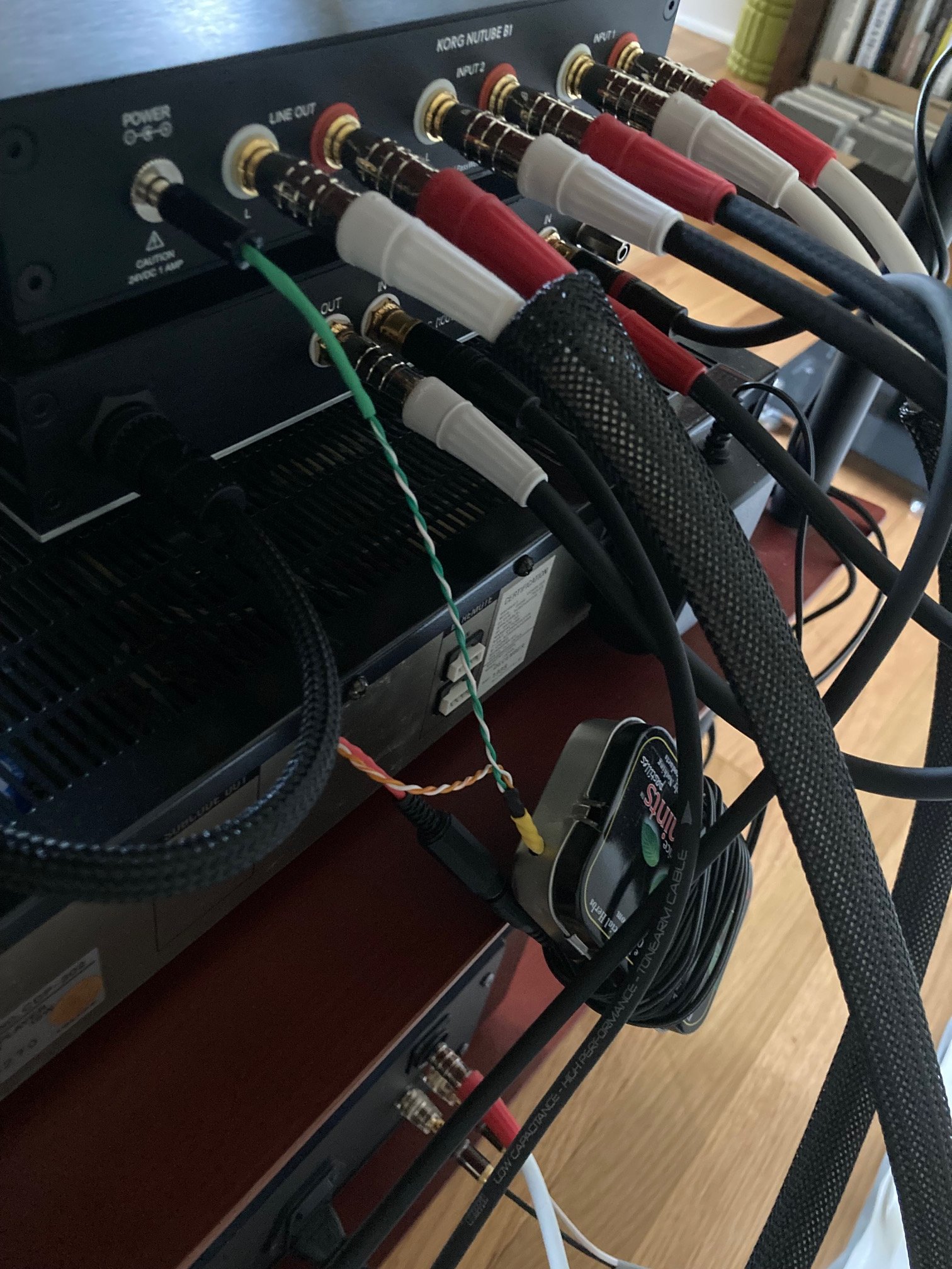

I use one in a mint tin between a Triad wall wart plugged into the back of a Sony CD player and my B1 buffer (which is in a B1 Korg case). I think it improves things.

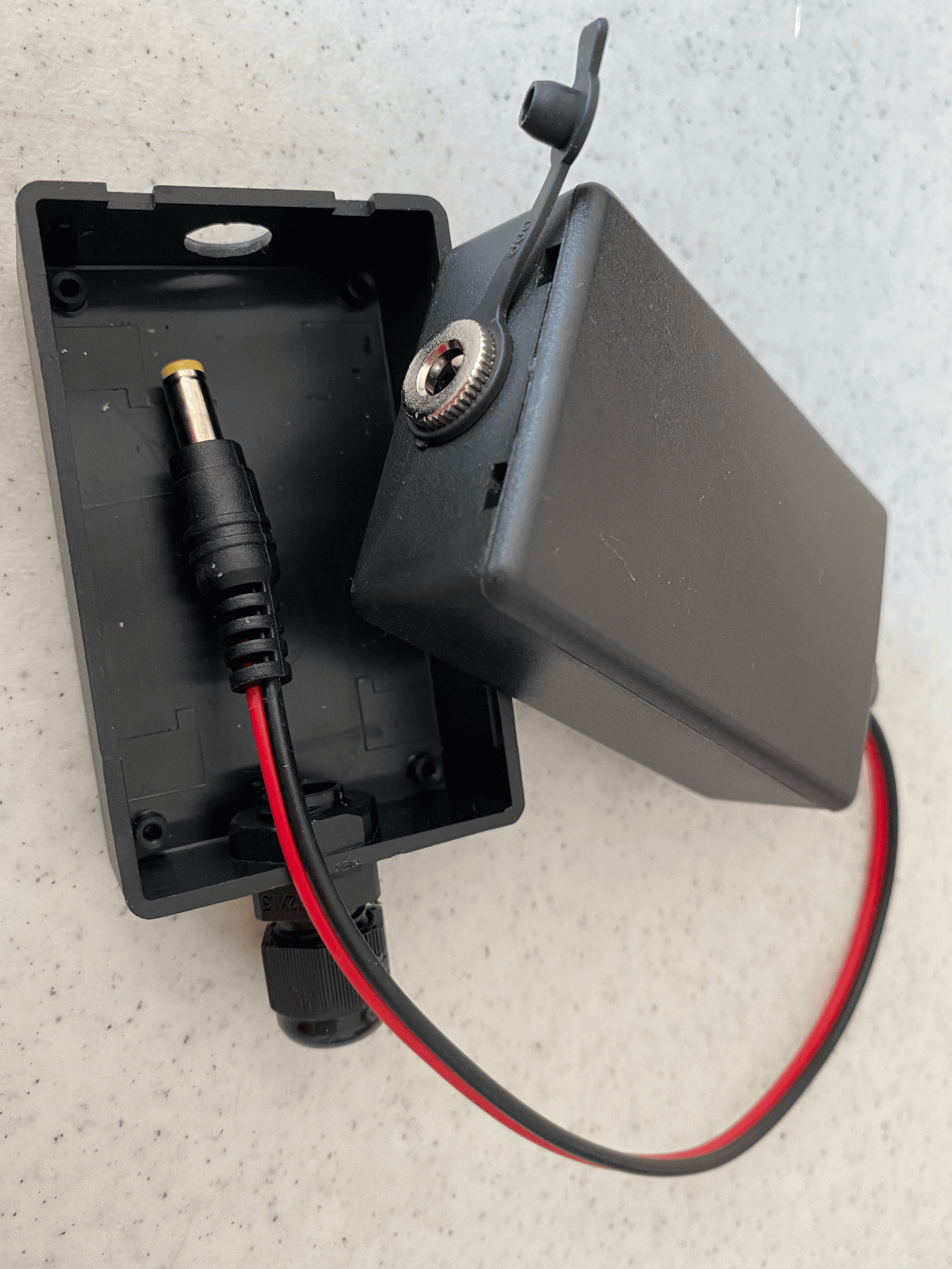

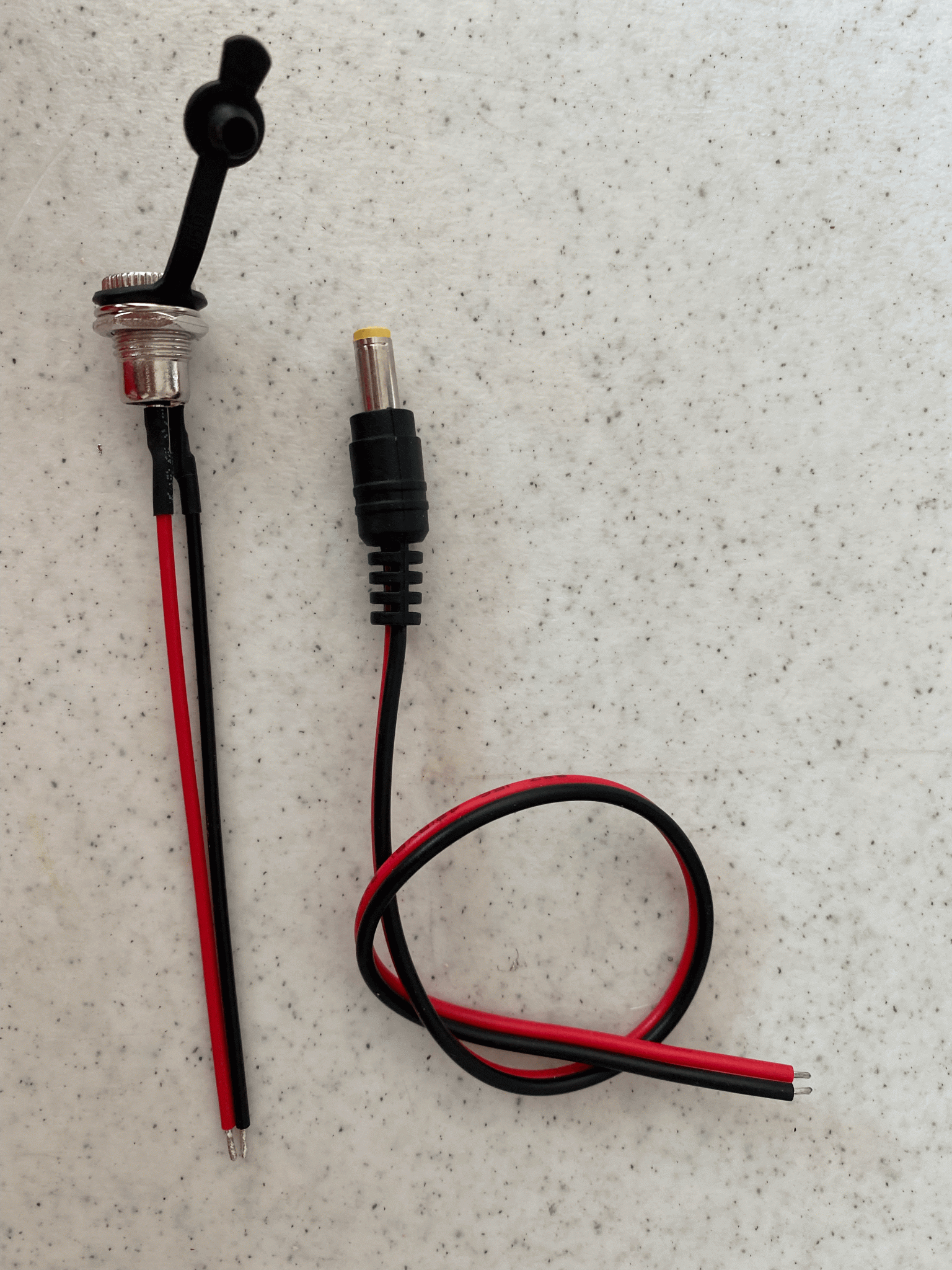

I did not re-read all 47 pages of this thread before posting but I don't remember a post exactly like the following. That may be because the solution I present below is pretty obvious to most of you. A while back, I ordered 3 P089ZB boards from the store and populated them with parts. I then pondered how to use them. On a number of completed projects I could have inserted the boards inside the case. That's a safe and easy way to use Mark's incredible filter. It occurred to me that I would have to order a lot of boards to stuff them in all the completed projects that use an external SMPS. In some projects there is no space for the filter. I would usually only use one or two filters at a time. I looked around for a pre-made box that could be plugged and unplugged and moved between devices easily but couldn't find anything that looked right. I have no access to metal and wood working equipment so I ended up buying pre-made parts from Amazon that did the job. I did a search on Amazon and took the first part that looked like it would work; there may be better alternatives. I didn't not optimize for cost. Each completed box would cost about $4.25each in quantities of 20.
https://www.amazon.com/Socket-Threa...ie=UTF8&reviewerType=all_reviews&pageNumber=2
https://www.amazon.com/gp/product/B07F462RYR/ref=ppx_yo_dt_b_asin_title_o08_s00?ie=UTF8&psc=1
https://www.amazon.com/gp/product/B08K8J45L5/ref=ppx_yo_dt_b_asin_title_o08_s00?ie=UTF8&psc=1
I am not an engineer. Safety is a concern that you will have to judge for yourself. The box works fine for me in my application which to date has been a max SMPS rated 48V at 3A. The electrical parts received a 4.7/5.0 rating by purchasers on Amazon. The female plug is wired with 18ga wire and is rated by the supplier for 9A with no max voltage specified. The male plug leads are 20ga rated for 5A by the seller. One reviewer claims the male wire is 0.020" (25ga) and the female is 0.032" (21ga). Another reviewer commented that the male plug wire heats up at 10A. If you think anything about this box is unsafe please let me know. The box could be constructed with self-wired plugs and lower ga wire, however, the P089ZB is rated for no more than 48V/3A.
Construction was simple as befits my skills. I drilled 4 holes corresponding to the mounting holes on the board in the bottom of the plastic boxes. Holes for the male leads and female plugs were drilled on opposite ends of the box. A locking strain relief was inserted in one end for the male pigtail plug; the female plug on the other end is secured with a nut. The boards were secured in the box with nylon screws, 6m standoffs and a nut. The leads were cut to length, trimmed and soldered to the boards from the top side. I suppose some would add ferrites to the cables but I didn't.

Wow! Thanks for a tremendously helpful set of links and photos, @Audiobear !! Builders now have another excellent option to consider, when planning their SMPS filter deployment.
I have just edited post #1 of this thread, and installed a link to your super useful message. New builders and new readers of this thread, can learn from your fantastic example. Muchas Gracias and Vielen Dank!
If anyone wants to nominate additional DIY builds of PO89ZB to be also mentioned prominently in post #1, please sing out! (Ideally, posts in this thread with photos). Don't be bashful about nominating your own build+photos either. If they're great then new builders ought to see them.
