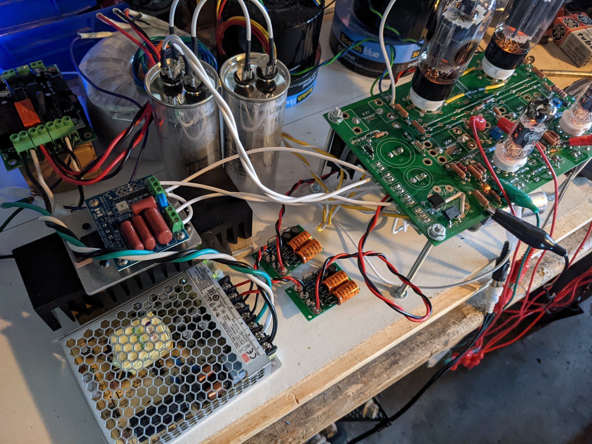

I have been working on a BETA build of Tubelab's UNSET design and wanted to try out using a SMPS for the tube heater supplies. Doing the normal internet research on using a SMPS to power tube heaters yields much of the same discussions around the evils of using a SMPS for audio devices as with solid state amps so I thought I would try 2 of these neat little filters between the Meanwell LRS-100-12 I am using and the tube heaters. The driver tubes take 12V at 600mA and the output tubes take 12V at 2.5A. I have one PO89ZB between the SMPS and driver tubes and one between the SMPS and output tubes. Setup like this I see a 0.2V difference between the output of the 2 filters with the driver tubes getting 12.7V and the output tubes getting 12.5V. The voltages are well within spec for the tubes and everything is functioning well plus the amp is sounding good. All fun stuff!
One other note after that photo was taken I was feeling a little paranoid about having a PSU capable of 8.5A feeding 2 devices rated for a max of 3A each even though the load is less, so I put a 3A slow blow fuse on the input side of each PO89ZB.

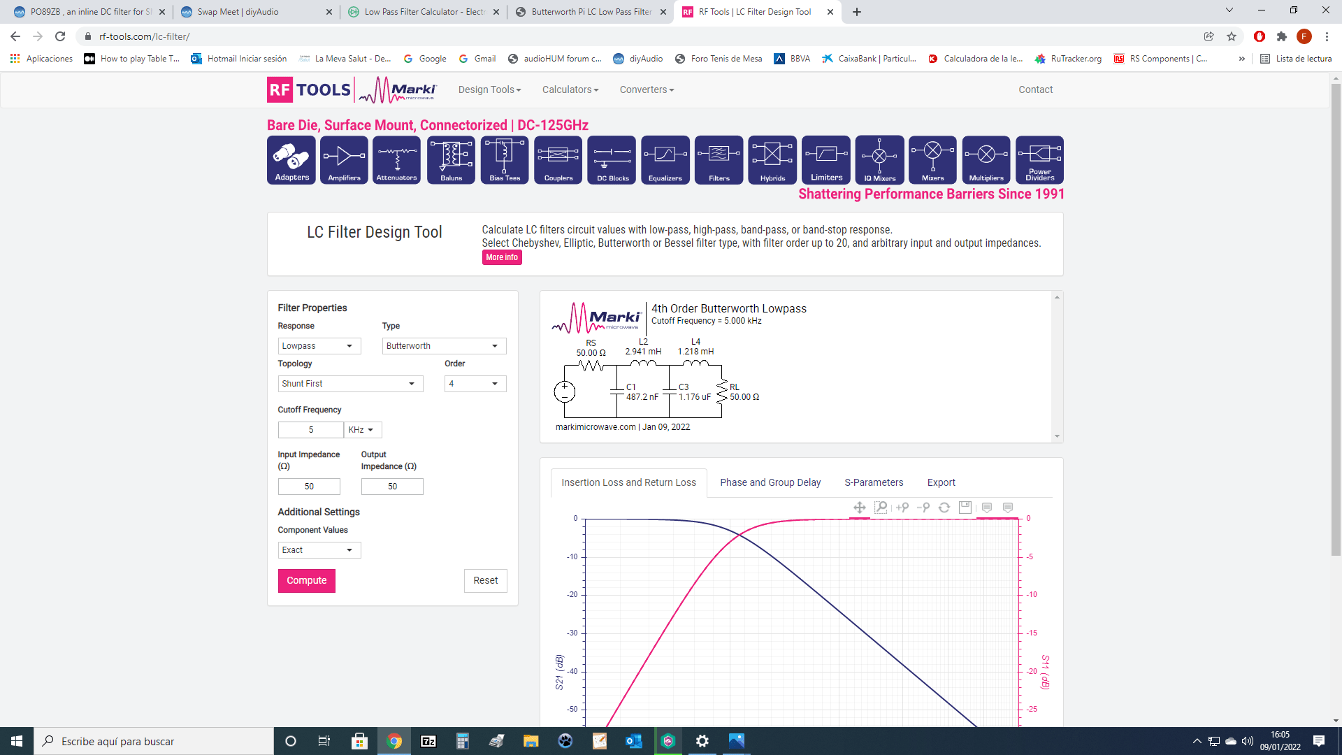

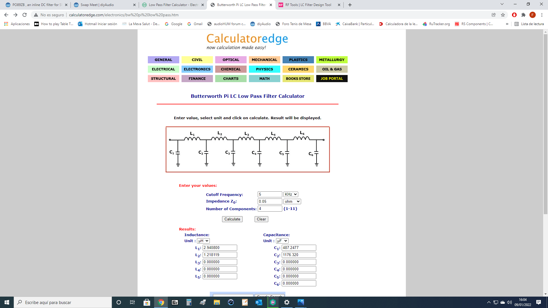

That one was intented for Mark, but TBH that shouldn't be too difficult to calculate ;-)
In case of, search function is your friend: I did a post on that (Fc, order, 2 filters cascaded), I believe that was in the VFET thread...

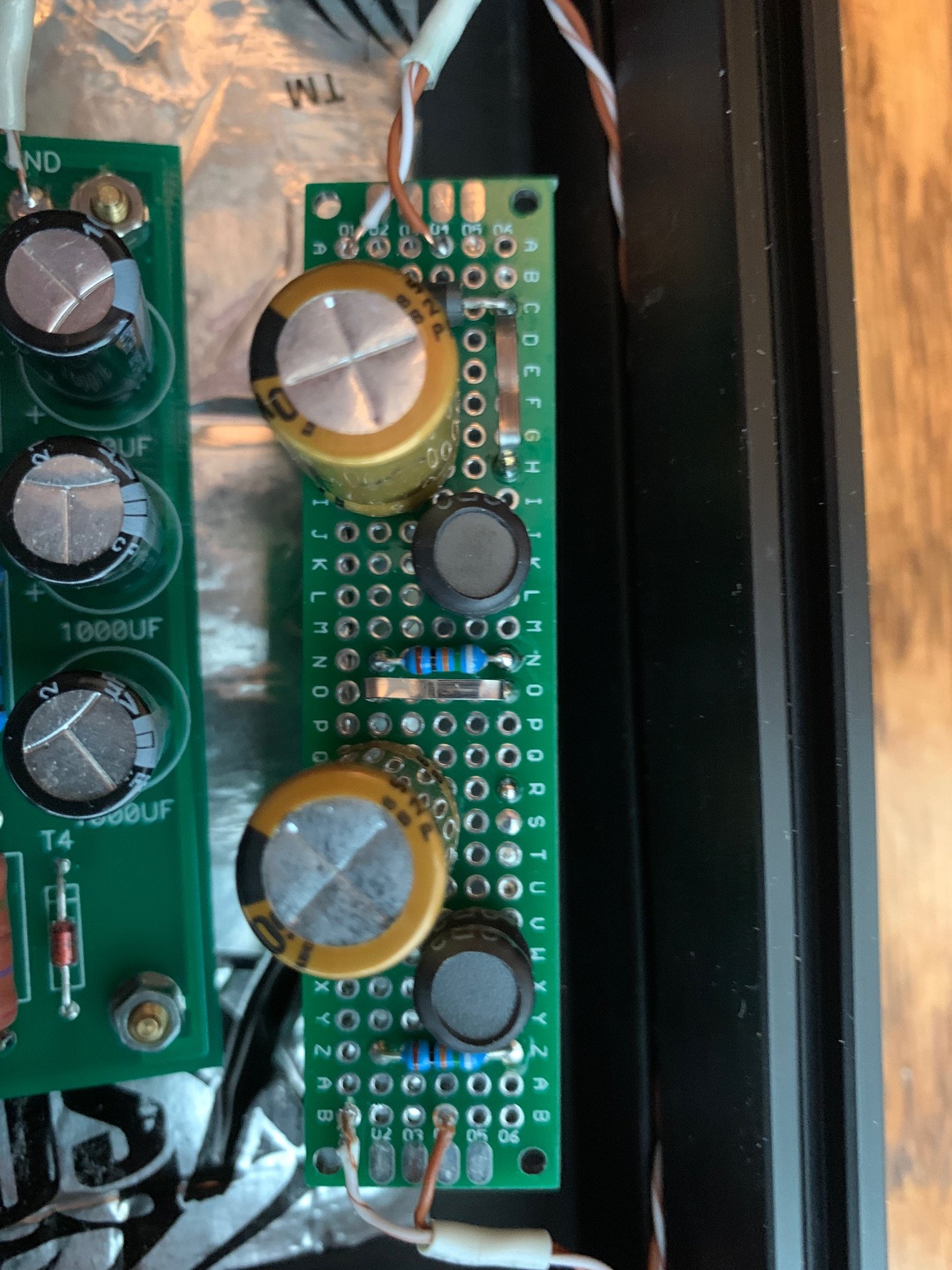

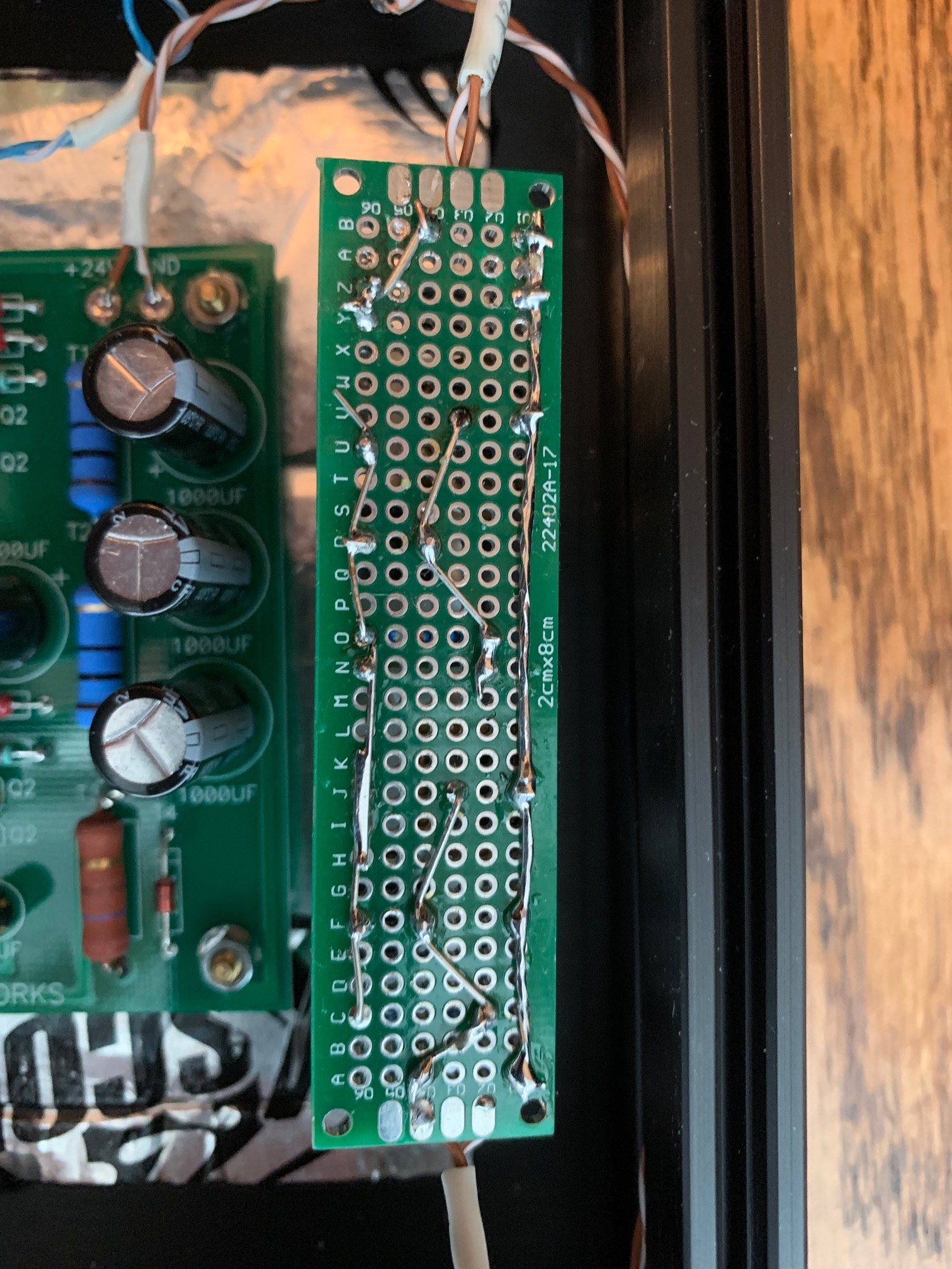

This is very easy to do point-to-point. P2P is lots of fun and if you have never done before this is a good start.So, you recommend scratch-building after all (I don't have the skills or the component parts) :-(
I was hoping to buy one of these PO89ZB -
Does anyone on the board have a spare you could sell me?
P.S. do you really think Altec Lansing would use a noisy power supply for their $300 speaker?
You can work it out on paper beforehand or I use a pcb layout program to work out which legs of components to connect, just layout everything and make the traces all on one layer (or you can even use jumpers to tie things over on the other side of the board) - I use the free version of Eagle. Here are some pics of my P2P PO89ZB. you can see it does not take up much room.
