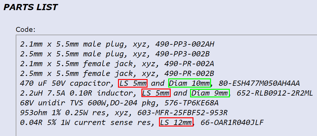

Quite a few recent line-level projects here on diyAudio are using Switch Mode Power Supply ("SMPS") wall warts to convert mains AC into the DC needed by audio circuitry. To name a few recent examples, the Starving Student II headphone amp, the First Watt H2 effects box, the B1 Korg NuTube preamp, and the Amp Camp Preamp+ (with headphone amp) are all powered by external SMPS warts. It's definitely a trend.
PARTS LIST
Code:2.1mm x 5.5mm male plug, xyz, 490-PP3-002AH 2.5mm x 5.5mm male plug, xyz, 490-PP3-002B 2.1mm x 5.5mm female jack, xyz, 490-PR-002A 2.5mm x 5.5mm female jack, xyz, 490-PR-002B 470 uF 50V capacitor, LS 5mm and Diam 10mm, 80-ESH477M050AH4AA 2.2uH 7.5A 0.10R inductor, LS 5mm and Diam 9mm, 652-RLB0912-2R2ML 68V unidir TVS 600W,DO-204 pkg, 576-TP6KE68A 953ohm 1% 0.25W res, xyz, 603-MFR-25FBF52-953R 0.04R 5% 1W current sense res, LS 12mm, 66-OAR1R040JLF

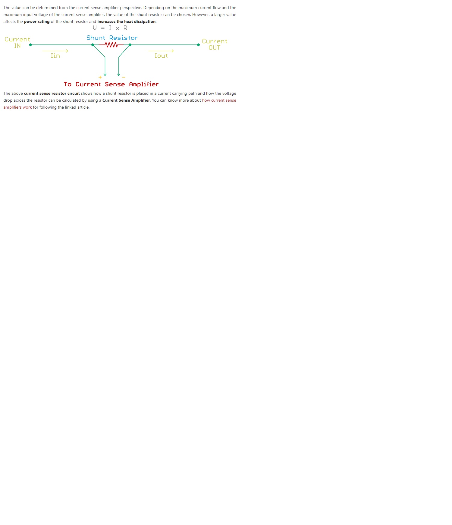

I recommend you exert yourself in sweaty labor, to discover the significance of the information in red boxes and green boxes
Thank you, Mark - I see it's the distance between the leads which is important.
According to the attached dwg, as the part is being used solely as a low-value resistor (there are no leads going off to a "current sense amplifier"), any low-value res should be usable.
So perhaps I can re-phrase my question:
* is the value of 40 milliohms critical ... or will 25 milliohms work just as well?
Thank you for finding them at DigiKey, @wapo54001 ... but I'm hoping Mark will confirm one of the resistors I found at RS Components is suitable, as it will be expensive (due to overseas shipping charges) if I have to place an order on Digikey just for the 66-OAR1R040JLFs.
Andy
