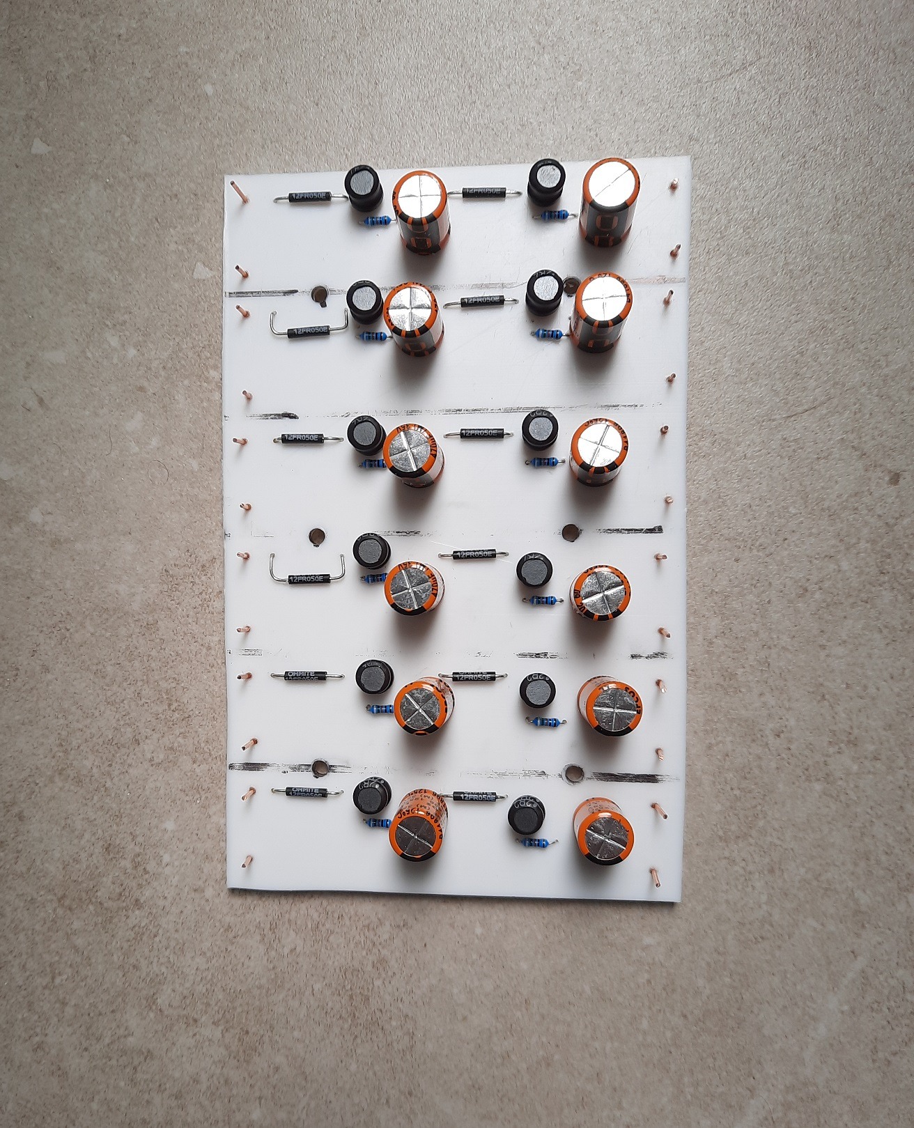

6-way filter board completed - see pic.
(For 3x 5v Meanwells and 3x 12v Meanwells.)
Now waiting for the case to arrive from Modushop. 🙂

If these work well, I will build 1 more - for the 48v Meanwell which powers my TT motor controller. 🙂
On another note, is it me or haven't you used the recommended parts?
Good pickup - yes, some parts are different:
1. the 470uF caps are Epcos (low ESR with a higher temperature rating)
2. I used 0.05 ohm Ohmite resistors instead of the ones Mark had specified.

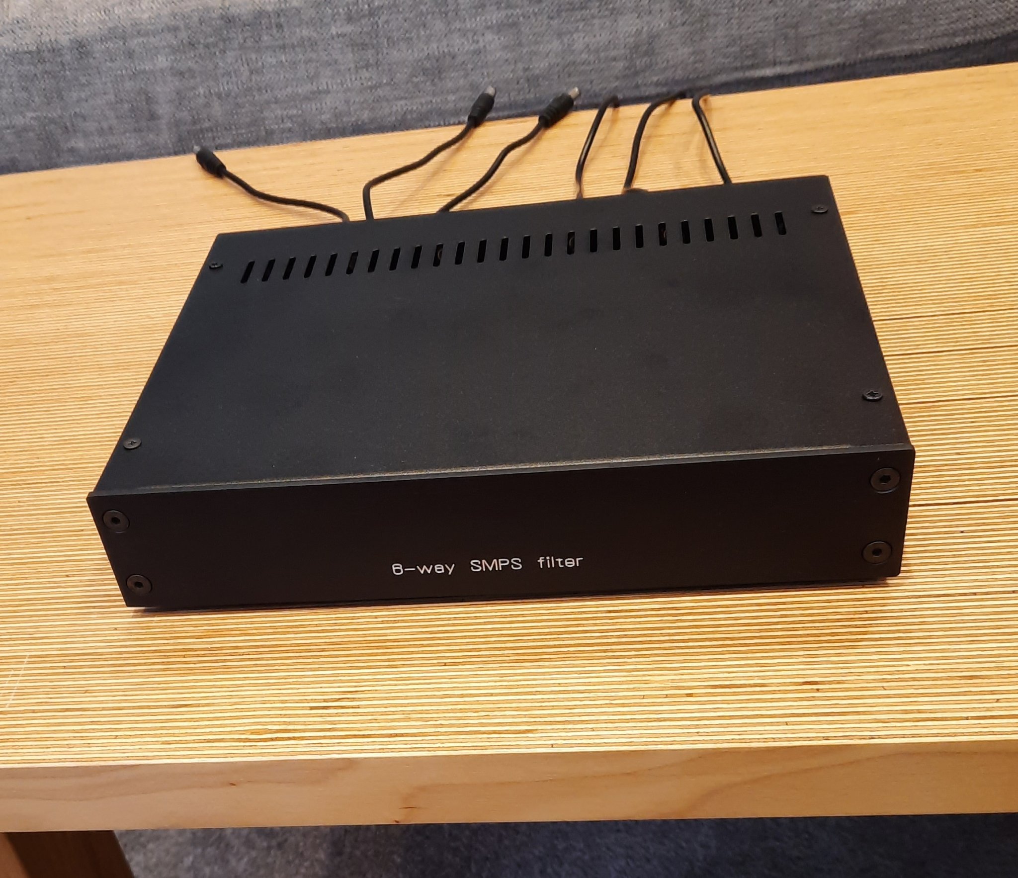

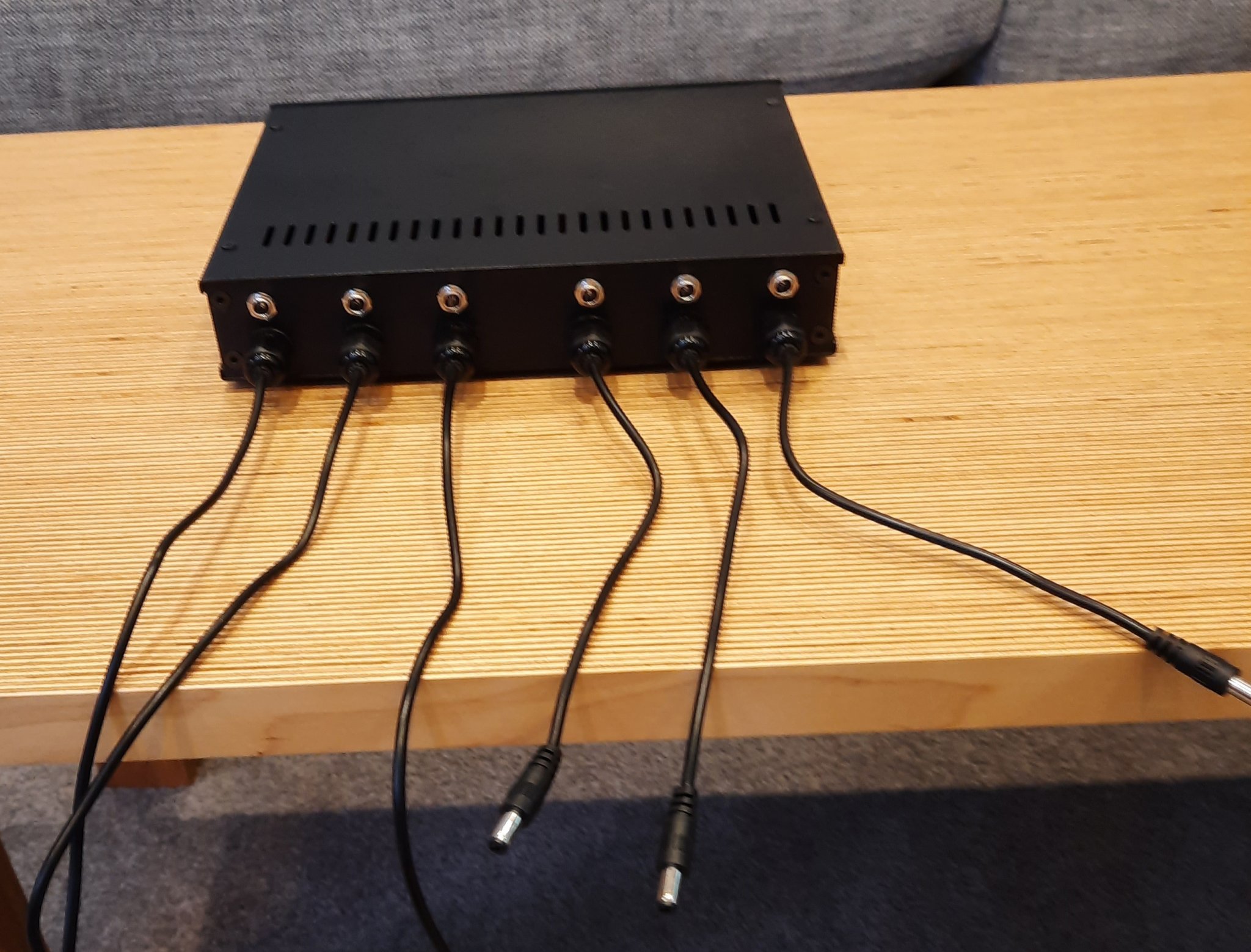

The Modushop case arrived for my 6-way LCLC filter - so it is now complete. 🙂

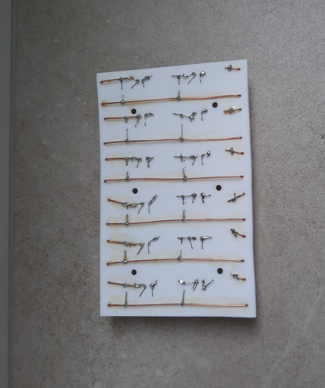

I have re-posted the pic of the top side of the cct board ... and have added pics of:
One thing I have discovered - that I feel obliged to have to put right by building my own output DC cables - is that the pre-made cables that I had bought (having 2.1mm barrel plugs already attached) ... use much too thin wire (26g?). 🙁 I will feel happier using 20g solid-core wire for the DC feed.
- the underside (showing the p-t-p wiring)
- the front
- and the back.

A very lovely enclosure! Congratulations.
One way to get barrel connectors with heavy gauge wires, is to buy them already pre-built into cables. For example, I bought the one below, specifically because its conductors are size 18-AWG. Cut to desired length, strip off the insulation, done.

True! 👍 Have not found any alternatives in Oz to the 18g extension cables that you posted a link to (that won't deliver to Oz) but I have found 5.5/2.1 barrel plugs which have a screw connection for the wires - see here:
https://www.led-shop.com.au/shop/dc-connector/
This enables me to use wire which I already have - which is 1mm^2 in area (so slightly thicker than 18g - which I believe is 0.8mm^2 in area?)! 🙂
So that's what I will do in the new year.
