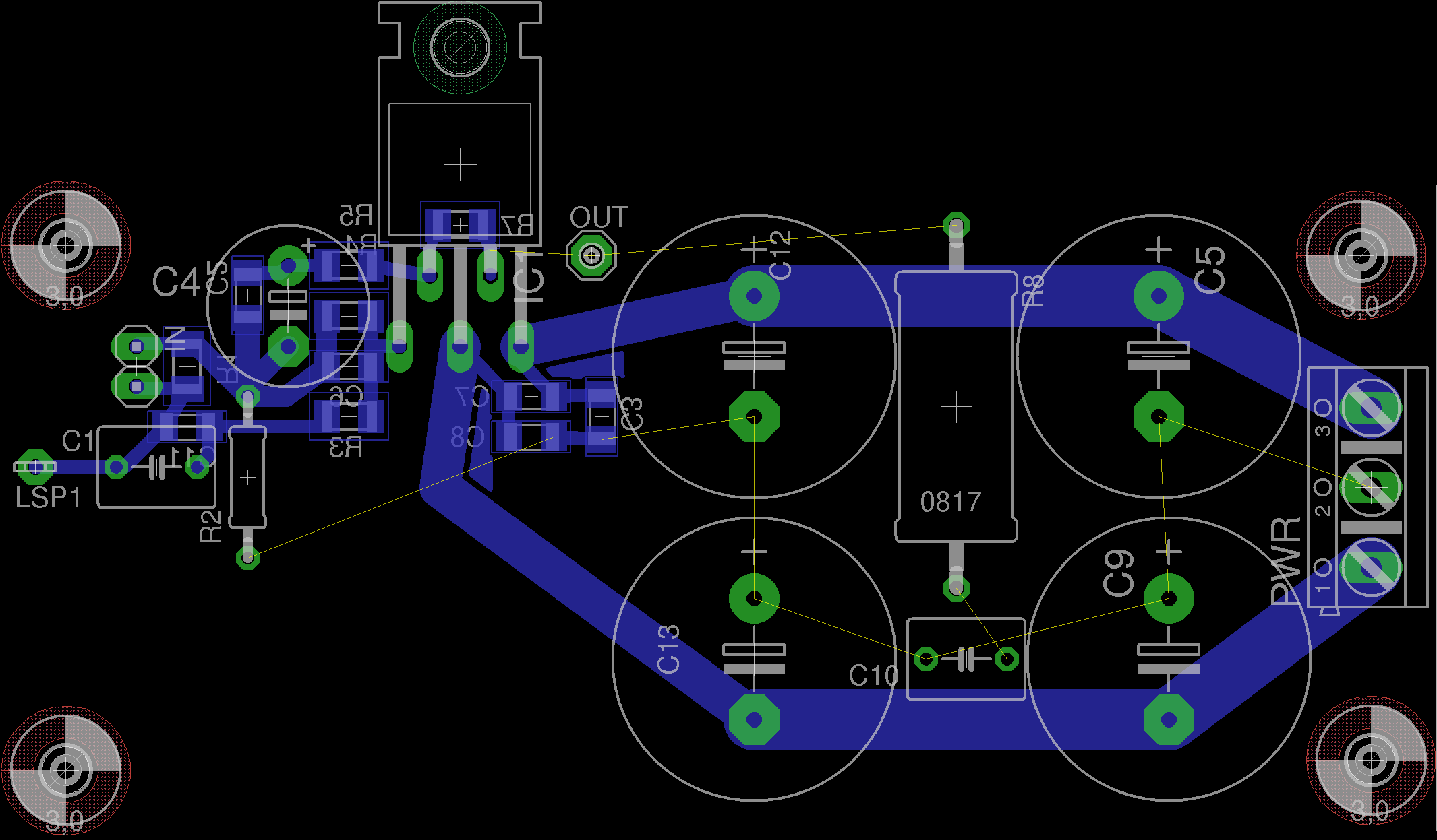

please review this pcb design
You dont need to worry too much about the connector side. You can have 150mil track width in there.
But you need to worry about the IC side.
I think your program allowes different track widths at different parts of it? Or you can use fills. Cant help you with eagle. I use different program.
But the area between C7/8 and the negative power track must be filled with copper.
Same thing with the area on top of the C3/7 and positive power track, fill it with copper - some how.
For example, use two narrower tracks from the IC to the capacitors and afterwards fill the empty area between those. One track from lets say the pin 3 to the C13, as you have it now. And then an other from the C8 to the C13. Then fill the area between... I do not know how your program works, so you need to experiment.
Anyhow, the ground tracks. Remowe them. You can leave the nest. But no ground tracks yet.
C10, move it down to the middle of the PCB, into the center of the cap bank.
R8, lay it down. Use a 2W type. C10 can be a 63v type, so you can get closer to it with the resistor. 63V 100nF MKT is 2.5mm thick.
Also, no need to find the specific blade terminal. Just put the pads there. Pad size 3.5mm, hole size 1.8mm and distance 200mils.
I had to move the power track a bit to fit in a orphan ground polygon.
Will change the output pads.
Have laid down r8, will reduce c10 if needed.

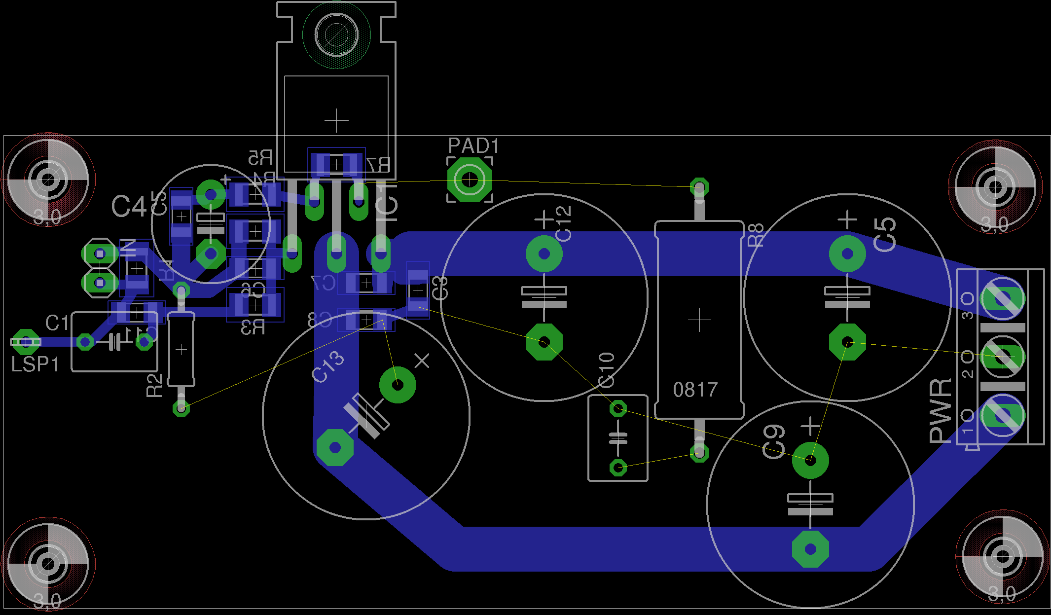

What I have in mind with the power tracks, is attached.
Lets try the following:
Move C13 to the left. We have a lot of unused space there. Move it about 200mils to begin with... and turn it to a 45degree angle.
Move C12 down as much as needed to get a straight track from it to the IC.
Now we have also made new space for C10. Turn it vertically between R8 and C13. Top pin is the GND.
You should now have more space also for the speaker connector.

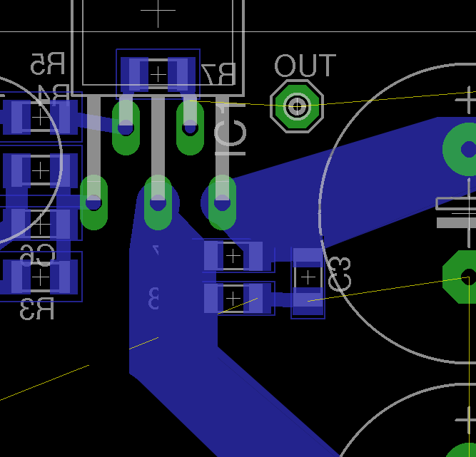

Could manage it without rotating the cap. Let me know if i still need to.
last mile to the chip is still 100 mils. rest of the power tracks are 150. If I make it all 150 mils, the c12 to pin5 tracks overshoots and touches pin3. If I dont take it all the way, it shows me pending nest.
C3,7,8 OK.
Turn C10 180degrees to have its GND upwards.
Turn C13 to the 45deg angle and move it to the left as much that you can have a straight connection from it to the IC pin 3. Iwant to see how it looks. However, try keep the negative rail looking like it is now and having it where it is now, with the similar 45deg angle you have on it now.
Move C10 upwards closer to the C12 (and 13)...
OK, we are getting there...
Move C13 upwards untill it almost hits the C12. Make its track to the IC about as long as the track from IC pin 5 to the C12.
Then from C13 leave the cap with 45degree track towards the C9 and then turn horizontally as you are in the right level.
Hopefully this made sense to you...???
You got it perfectly!
Now keep these 45degree angles on the bottom track what ever happens in the future...
Now we clean it up a bit.
Im still not quite happy with the Zobel, but maybe we just have to live with it.
However, move C5 closer to the board top edge, as close as you can get before it touches the mounting screw. Make the 45degree angles to the top track, first from the connector to the C5 and then down from C% in 45degrees untill you are in line with the C12...
Move C9 back in line with the C5 and upwards as close as possible. Remember to keep the 45deg angles on the bottom track.
