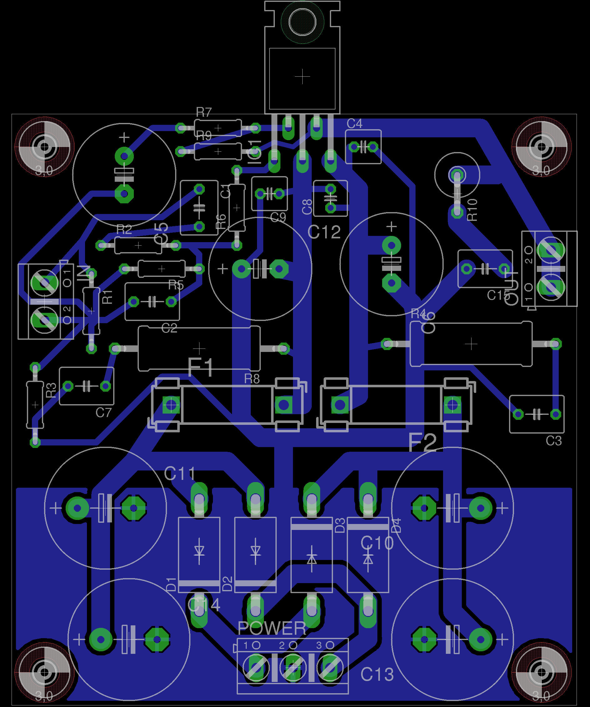

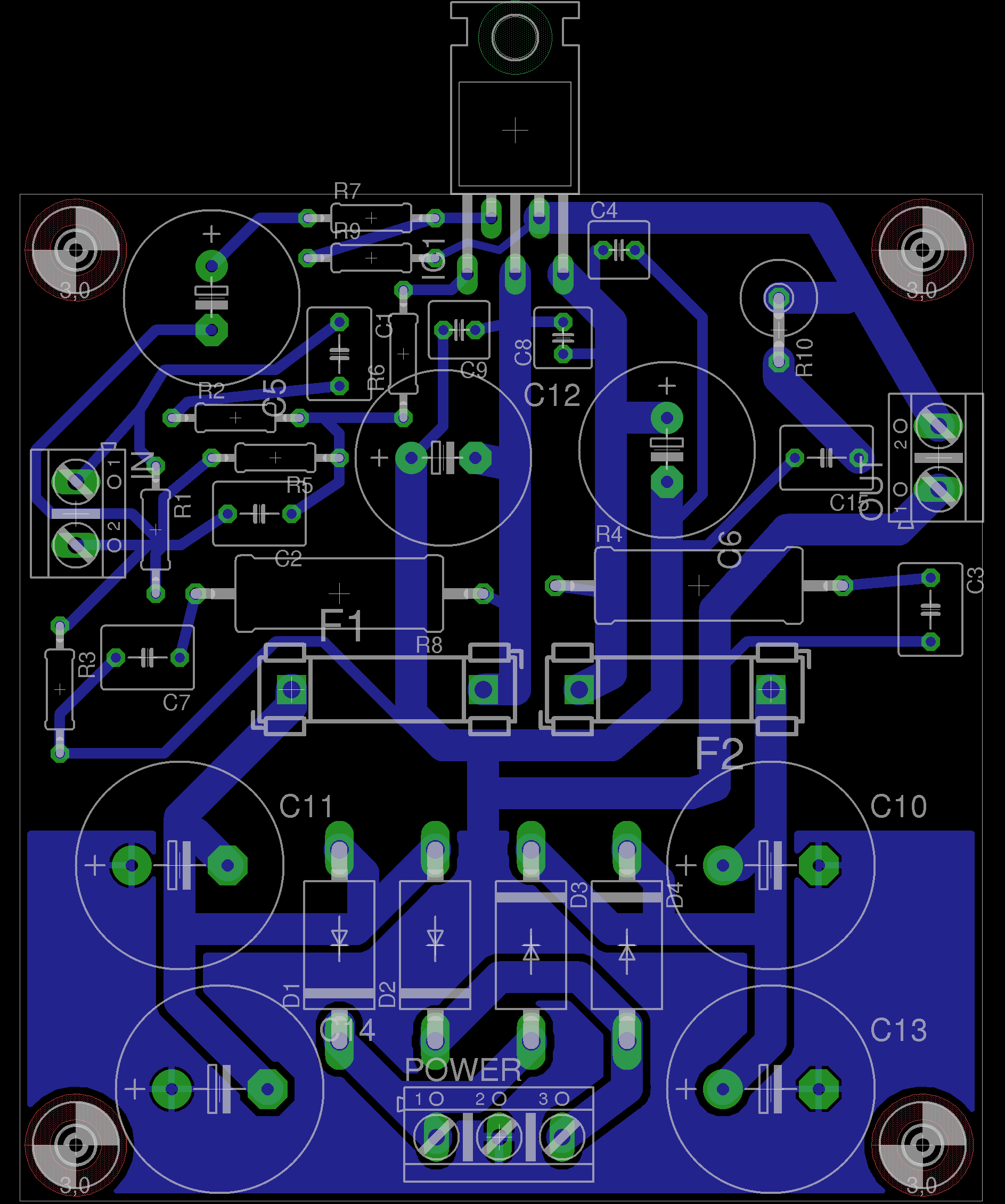

please review this pcb design
The input of the amplifier benefits from seeing the low impedance of the RF capacitor.
Locating the RF capacitor near the +IN input is good.
I add another RF filter at the input socket. This uses the output impedance of the Source and the impedance of the interconnect to create a 2pole passive filter. R+L C
Recently I tried a slightly different arrangement using an XLR socket for an unbalanced input.
Signal Hot to Signal Return - 47pF direct on the back of the terminals.
Signal Hot to Pin1 - 47pF direct on the back of the terminals.
Signal Return to Pin1 - 47pF direct on the back of the terminals.
All three ceramic caps have very short leads and form a triangle around the terminals.
Pin1 is connected to the XLR shell and the shell is electrically bolted into the chassis.
I cannot hear, nor measure, any adverse effects.

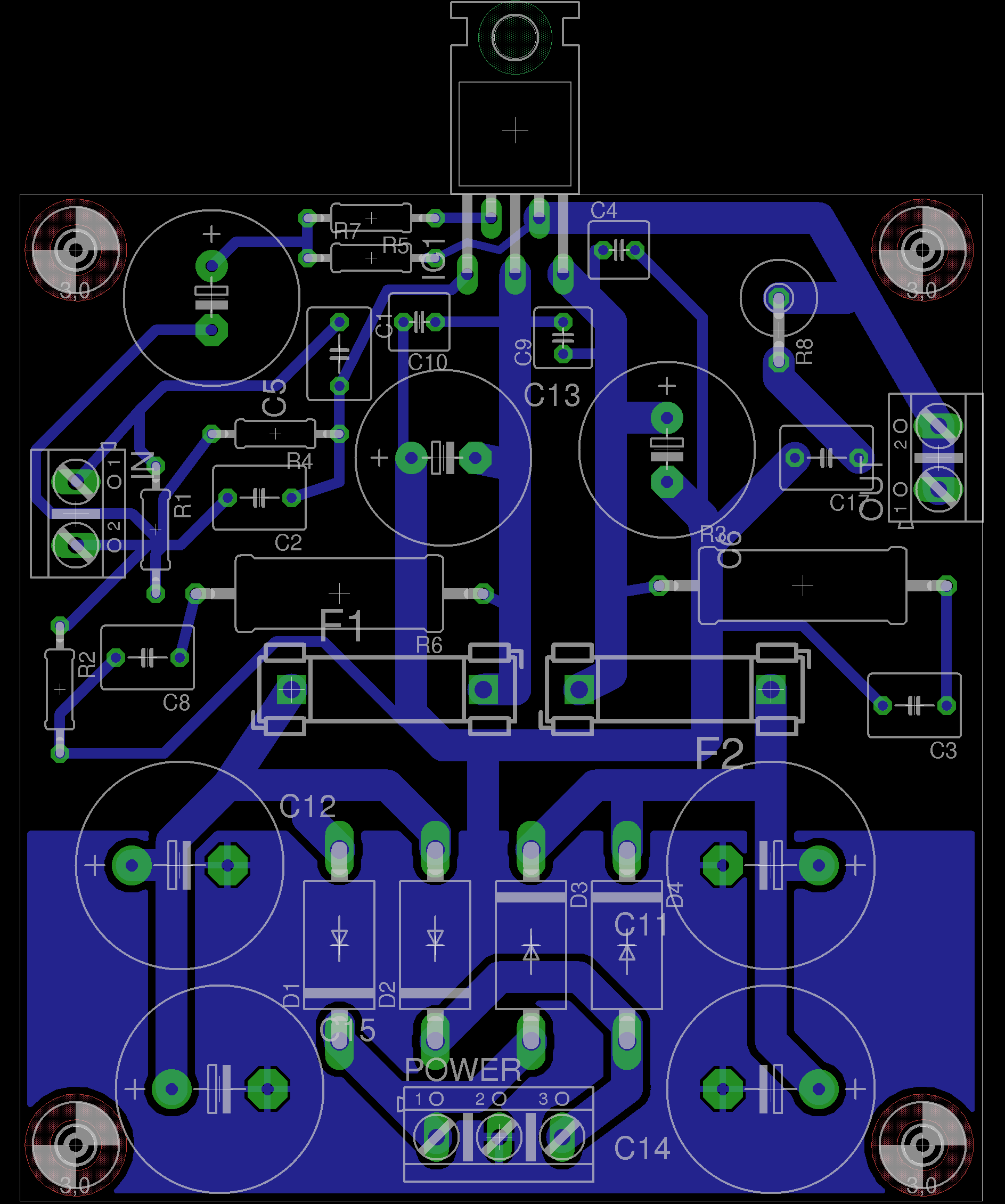

thannx, moved the rf filter. Also increased the input caps pitch, now it supports 5, 10 and 15mm pitch.

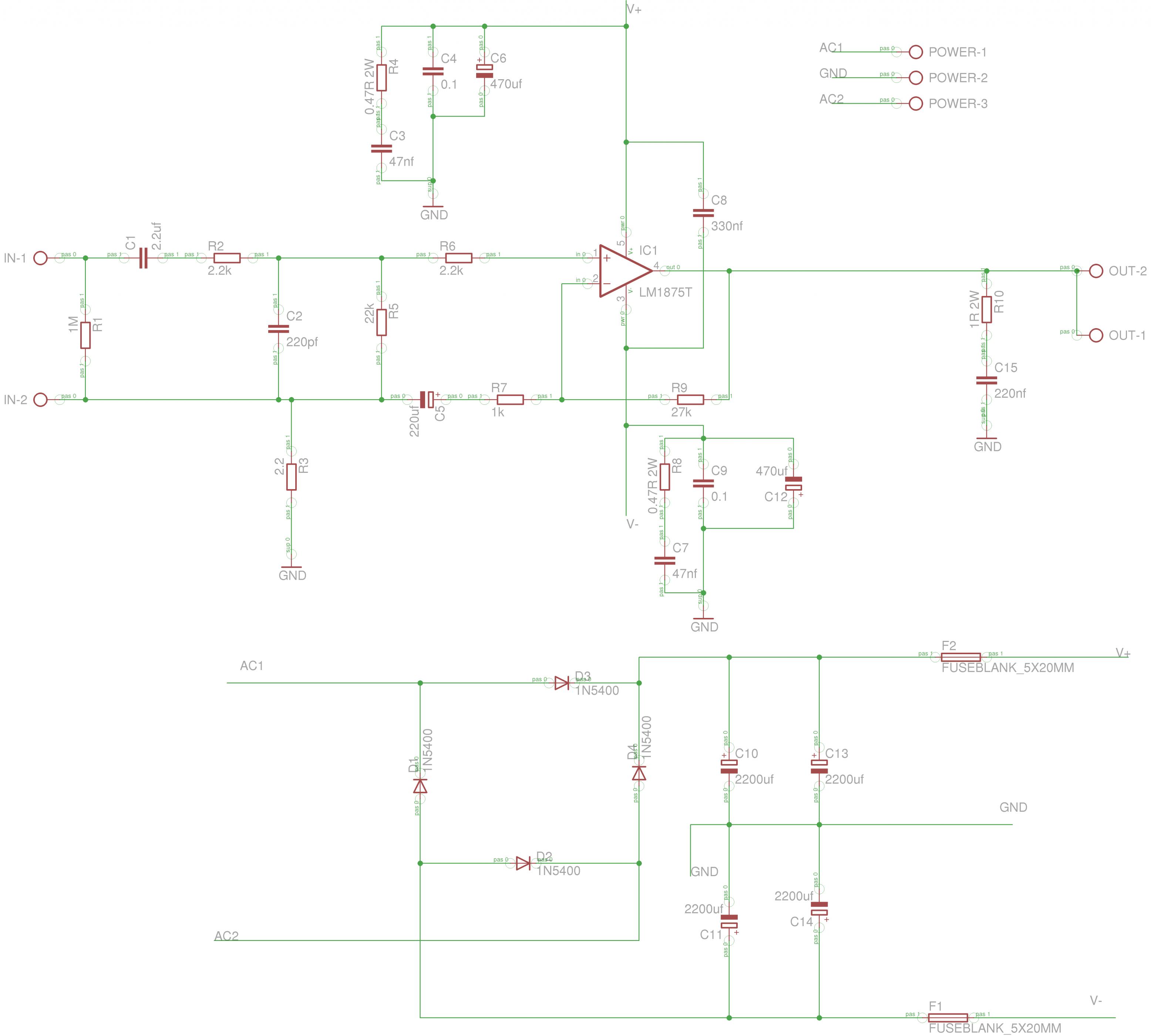

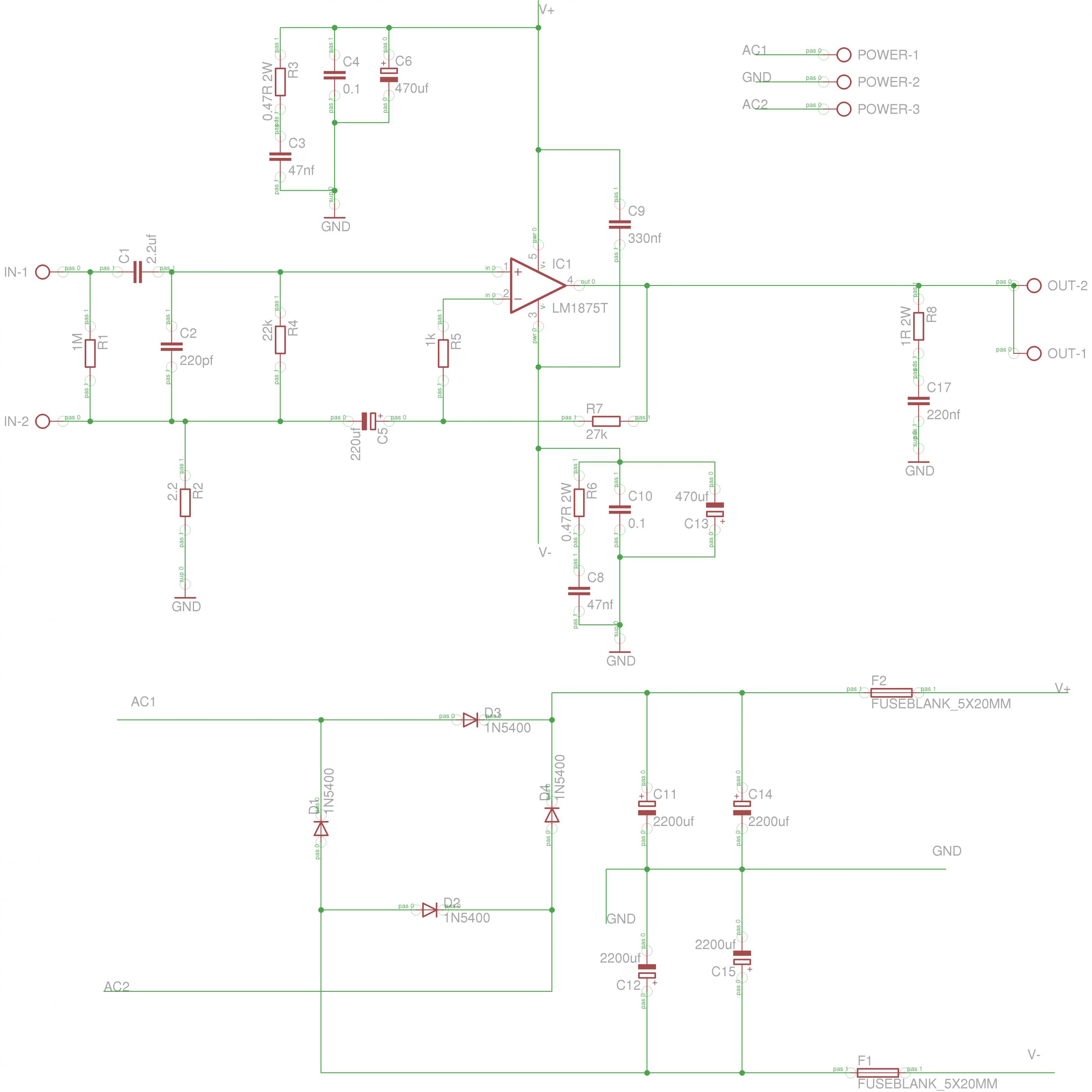

Increase R4 to 27k to match R7. This reduces output offset.
You can trim R4, to precisely set output offset to zero mVdc.
C1 < R5 * C4 / sqrt(2) / R4
Your value of 2u2F complies.
But you may be able to hear a slightly stronger very low frequency bass if you increase to 3u3F or 4u7F
1k*220u/1.4/27k = 5u7F
1uF, 1u5F, 2u2F, 3u3F and 4u7F all comply. Worth experimenting to find out if you hear any difference.
About the smd resistors, how much of a quality difference is there between thin film and thick film resistors. For which resistors do I need thin film resistors here. Between metal film resistors and thin film resistors, which ones are better, accounting for the fact that the smd can get real close to the pins while metal film ones cant, specially for the feedback path.
smd Thin film is metal film. Thick film is metal oxide.
Some Thin film are specified to very tight tolerances and tempco.
It would seem that the technology applied to the best of smd Thin film is generally at least as good as through hole and often better.
But that comes at a cost.
I would put price ratios as follows
smd Thick film @ 1unit, smd Thin film @ 3units, smd thin film superquality 30units
That puts super quality out of my price range.
the super quality ones are out of my price range also. Most of these are 0.1%, with 5ppm tc. the normal thin films are either 25ppm or 50ppmm with 0.5% tolerance, while most of the thick films are 100ppms. The 1206 in thin film are all very expensive while 0805 has cheap ones too. Some of the low tc advantage is lost because of lower power ratings of 0805 thin films. I think the tighter tolerance also wont make too much of a difference in sq.
I think in this design, R1 (1M) and R3 (2k2) can be easily changed to thru hole without compromising on sound quality. I need to basically take a call on the three feedback resistors (r4, r5, r7), (I prefer to use smd for these), whether to continue using 1206 thick film or use 0805 cheaper thin film ones. Any suggestions?
Im not quite sure if this was an improvement on the ground pour.
Now you inject all the PSU interference from the negative power rail to the input circuitry.
I myself like to "inject" the "ideal zero" everywhere around the sensitive parts of the circuit...
