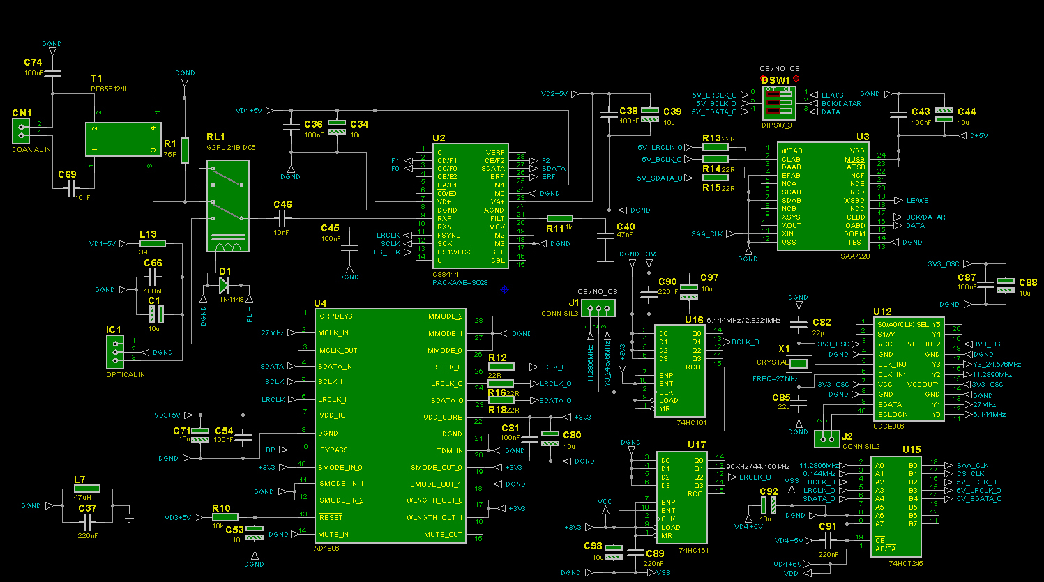

Modifications on the circuit
Hello Again, i have make some modifications on the ´´Cut and Shut Dac``
I changed the Slave CS8412 for one CS8414 (in Master Mode now) i add one ASRC AD1896 in slave mode, and i add the option with dip Switch/ Jumper for OS/No Os option, and i add one programable Masterclock CDCE906 IC.
With the Bypass Mode for the same input and output bitrate. (without upsampling)
This circuit are correct?
Thanks again!
I will give it a good study. Please bear in mind, being a novice when it comes to these IC's, it'll take me several days (providing Chrome doesn't implode on me again, discarding all my placeholders) to get up to speed on the new parts.
Still suspect that you might have better luck building a known-working design, with no *improvements*, rather than design-from-scratch.
But hey, we're learnin' stuff, eh? 😉
Cheers

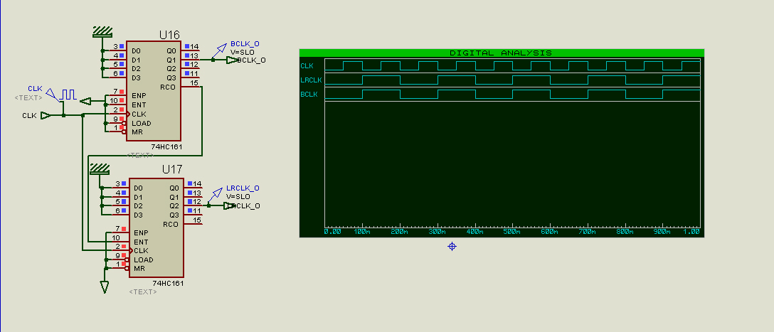

clock inputs for slave mode ASRC
I have simulate in the Labcenter Proteus on Simulator, and the clocks of the 74HC161, and the BCLK, and LRCLK send same clock values for the these outputs,I found it a lot strange.....

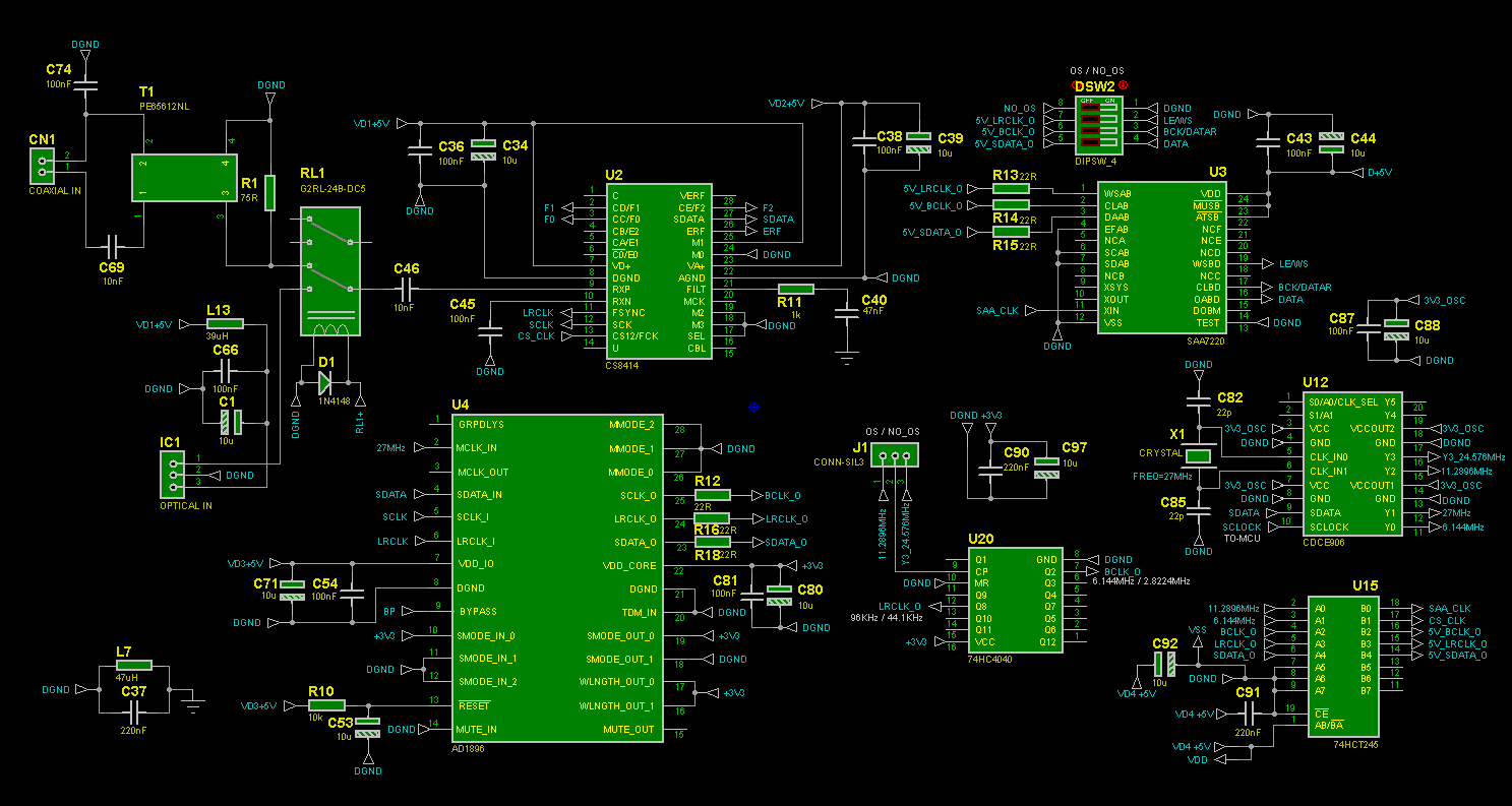

I use the old reclock mode of previous project idea for clock inputs(inputs in slave mode) of the AD1896, for make this clocks for BCLK / LRCLK (256fs):
(for compatibility of 32fs 16bit i2s output too)
For the divides the clock with the 11.2896 mhz, in OS Mode (with SAA7220 IC on Socket of the DAC):
Q1 - 5,6448 MHZ
Q2 - 2,8224 MHZ (BCLK_O)
Q3 - 1,4112 MHZ
Q4 - 0.7056 MHZ
Q5 - 3528 KHZ
Q6 - 1764 KHZ
Q7 - 88,2 KHZ
Q8 - 44,1 KHZ (LRCLK_O)
And for NO OS mode:
For the divides the clock with the 24.576mhz, (without SAA7220 IC on DAC Socket):
Q1 - 12.288 MHZ
Q2 - 6,144 MHZ (BCLK_O)
Q3 - 3,072 MHZ
Q4 - 1,536 MHZ
Q5 - 768 KHZ
Q6 - 384 KHZ
Q7 - 192 KHZ
Q8 - 96 KHZ (LRCLK_O)
This mode of clock are acceptable?
Thanks!!!

I have simulate in the Labcenter Proteus on Simulator, and the clocks of the 74HC161 ..
Yep, pretty sure that is not right. But I'm not familiar with that simulator; has it been trustworthy on other sims? A decade or two ago, I could've gone downstairs, put a 'scope probe on a couple of HC161's and say for sure; but today it would be a substantial undertaking.
I think you are getting close to something that will work, though I still wish I could talk you out of trying to design for every possible signal / sample rate / NOS/OS, etc.
The AD1896 looks like quite a problem-solver. If I ever buy one and get to watch it work, it'll surely amaze me -- even if it only sounds *OK* -- but especially for only around $5. But it is another substantial spec PDF, with lots of options. I almost mistakenly complained about your BCLK_O and LRCLK_O outputs conflict 'til noticing the _O's were 'slave', too!😱
Still have some doubts about the SAA7220 for this project, and haven't spent nearly enough time on its PDF yet. Will do now. :cheers:
