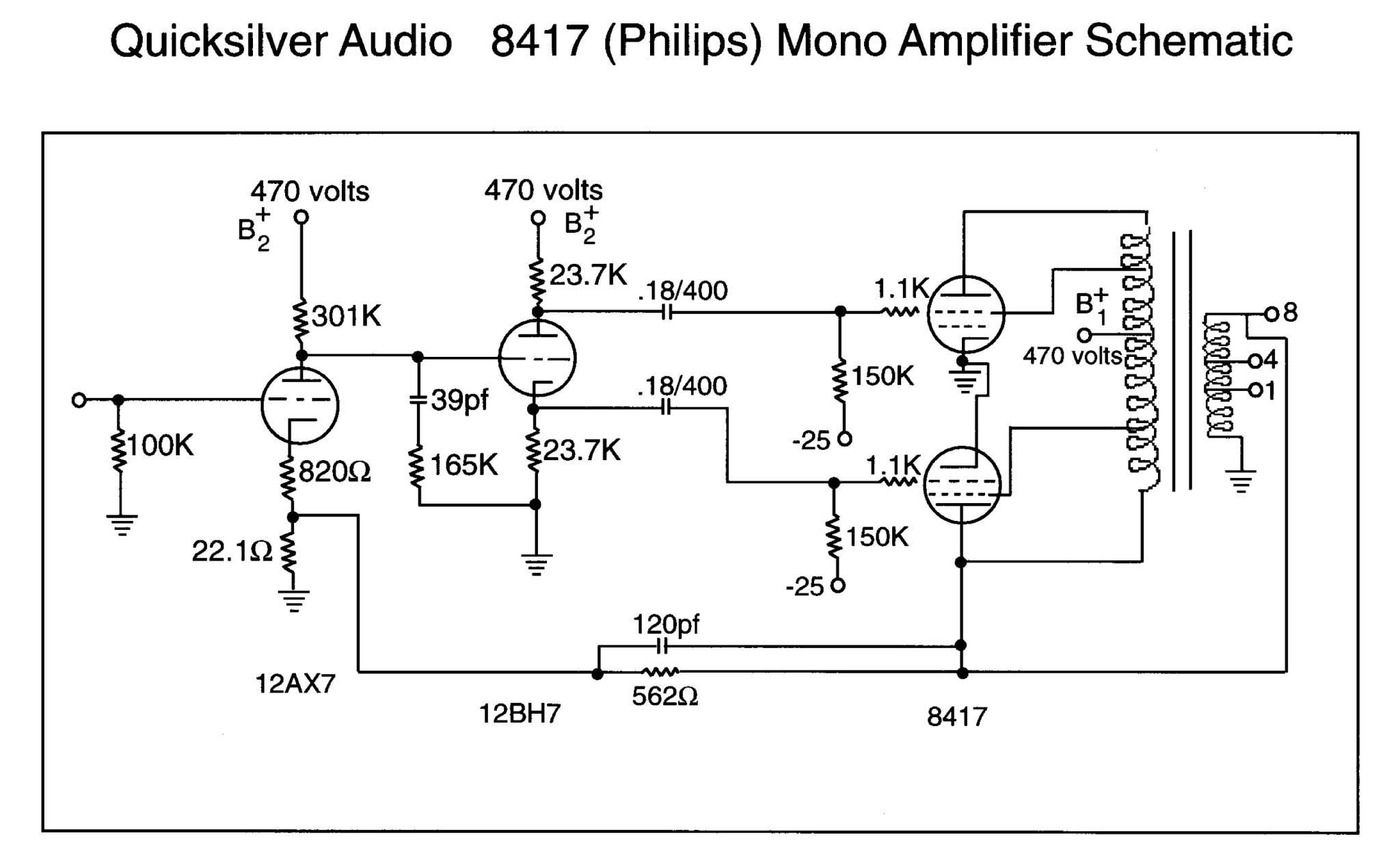

I can't answer that, but the Quicksilver audio looks like a relatively good, but simple, push-pull design. It has grid bias and ultra linear output transformer and some feedback. So some good design features for low distortion, but perhaps not the most refined design of this kind (Have a look at the famous Williamson amp from 1949 for comparison)What makes this amp sound like I want..
I am guessing a bit, but I think it would have a moderate (pleasing?) level of distortion - but not "gross level" like a Single ended triode amp (typically) has.
It has plate voltage on the 8 ohm tap? Something seems wrong here.ok, one of my all time favorite amps...
What makes this amp sound like I want... BTW, I would want to use this with EL34's as 8417's are hard to come by, now.
The 8417 is a Beam Power tube.
The KT77 is a Beam Power tube.
The EL34 is a Pentode tube.
The EL34 has the same specs as a KT77, but do they have the same sound?
Is there anybody that remembers the Quicksilver triode wired beam power tube push pull amplifier?
I think it had No global negative feedback.
Many schematics have errors. The connection from the lower output tube plate to the 8 Ohm tap is the error.
Some schematics have extra wires; some schematics have missing wires.

It’s straight from Quicksilver manual, so, I’m not sure. BTW, thanks for posting as I’m a huge fan of your YouTube channel! Your approach is as good as any I’ve seen…. Keep up the good work!!It has plate voltage on the 8 ohm tap? Something seems wrong here.
Interestingly, just about every 1930's radio with a field coil loudspeaker has a couple of exposed metal sockets for an external speaker with B+ on one of the plugs. I always disconnect them as the first thing I do. When I was a lad I was reaching around the back of a set to reconnect the mains input plug and had a nasty shock.Posting a schematic that has hundreds of volts on the speaker jack, people should be more careful. Although I suspect wired that way it would instantly blow the fuse.
Owners Manuals and Tech Manuals do have errors. Many are never corrected/updated.
The schematic in question connects the bottom output tube's plate to the output transformer primary, . . . and to the 8 Ohm tap which feeds the parallel RC feedback network.
. . . Nobody is going to be shocked.
The secondary common is returned to ground.
So the B+ circuit will pump lots of current to the center tap, then through the 1/2 DCR of the primary, and then through the large wire gauge of the secondary; notice the secondary common terminal is grounded.
That secondary wire is not going to open, the primary wire is a much much finer gauge, and so is the secondary wire gauge of the B+ transformer.
I am sure that any technician will be able to fix the amplifier if it is broken for any reason.
But a diy newbie could perhaps build an amplifier by folloing the schematic. Ouch!

Just an FYI, I posted the quicksilver schematic. Unfortunately, I’m not skilled to see potential problems. Perhaps, I shouldn’t post schematics; however, the point of this thread was to gain knowledge and by some of the back and fourth, I thought it was appropriate to post the schematic, of an amp that I enjoyed.

caryking,
1. I am glad you posted the Quicksilver schematic. It is a good example tube circuit. (***) see below
The schematic error of the extra wire can Not cause a shock.
Shocks do Not come from Shorted B+.
Instead, shocks come when you Touch working B+ (Working as in when B+ is Not shorted)
2. (***) That Quicksilver amplifier is simple. But also is a great discussion tool:
A.
It has the two most common types of compensation for global negative feedback (RC global negative feedback compensation, and the RC dominant pole compensation);
Ultra Linear mode (Which "sits" between Beam Power mode operation (0%), and Triode Wired Beam Power mode operation (100%).
Has one of the most often used output tube bias modes (Fixed Bias)
Uses one of the most popular phase splitters, the split load Concertina.
Uses the most popular biasing of the Concertina, by DC coupling the input stage plate to the Concertina grid.
The input tube cathode's two resistors in series, with global negative feedback to the junction is very often used.
B.
Simple. Effective. I bet it sounds good.
Remove the one wire that is in error, and you have a working amplifier.
Now, to give a comparison to the Quicksilver circuit . . .
Go and find an amplifier circuit that does Not have any of the circuit topology items that are between the letter A. and the letter B above.
Hint: there are hundreds that meet that criteria.

caryking,
grovergardner is right; but do not loose hope . . .
Remove the global negative feedback, and be sure to remove both compensation networks:
The parallel RC from the 8 Ohm tap . . . And the serial RC network (Dominant pole to ground).
Then you can disconnect the screens from the UL taps, and connect the screens through a 100 Ohm resistors to the Plates.
That is Triode Wired mode.
Hope Springs Eternal: . . . Triode Wired mode will . . .
Get back a decent damping factor, and decent output impedance
Get back a decent bandwidth
Get back a decent bass performance
Reduce some of the excess gain that came when you removed the global negative feedback.
The tradeoff: Lower power output . . . but try it, you will like it.
Easy to try, and easy to put back to original.
Have Fun!
