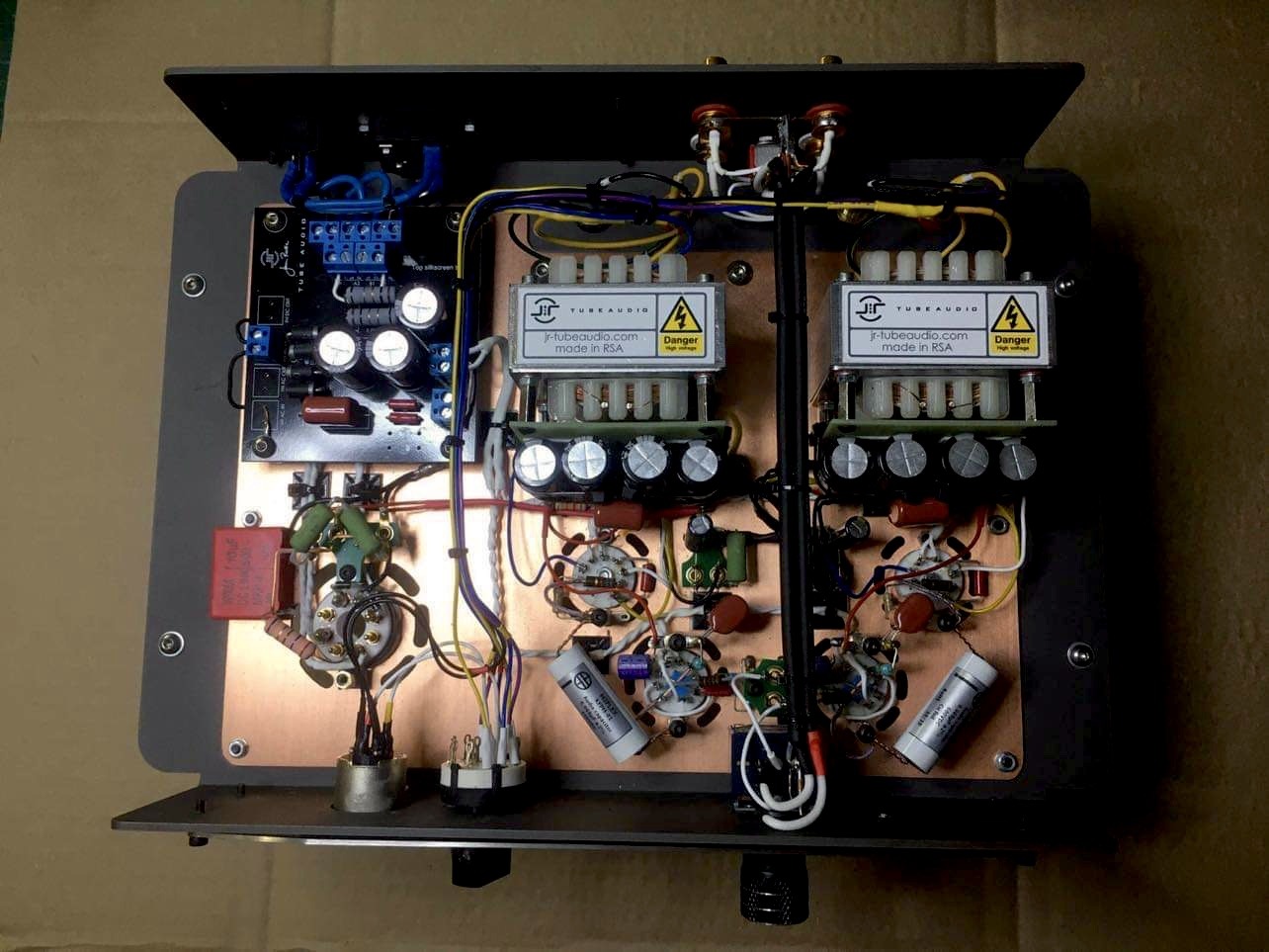

What is the amplifier? Or do you know the specs of the OPTs?I also have a SE amp that these go in; however, the sound is a little too light (not the warm and syrupy sound, I want).
Sounds like sharing the schematic and specs of that amplifier might be a good introduction into getting the sound you are looking for.
Unfortunately one thing you learn when building your own tube amplifiers is that there is no substitute for reasonable quality transformers, and they cost. Sometimes looking out for a second hand amplifier just for the components is as good a place to start as anywhere.
The other hassle is building an amplifier that is fit to be used on a daily basis, so it is safe and properly enclosed. There is a lot to be said for looking at the projects that @stephe has done, she has a presence on youtube, where she takes a cheap Chinese kit, and extracts the best sound from it.
It is a small boutique builder, in South Africa. JR Tube Audio. Again, some may absolutely love it; however, I want a more old school sound. Excellent build quality as well as he winds his own transformers.

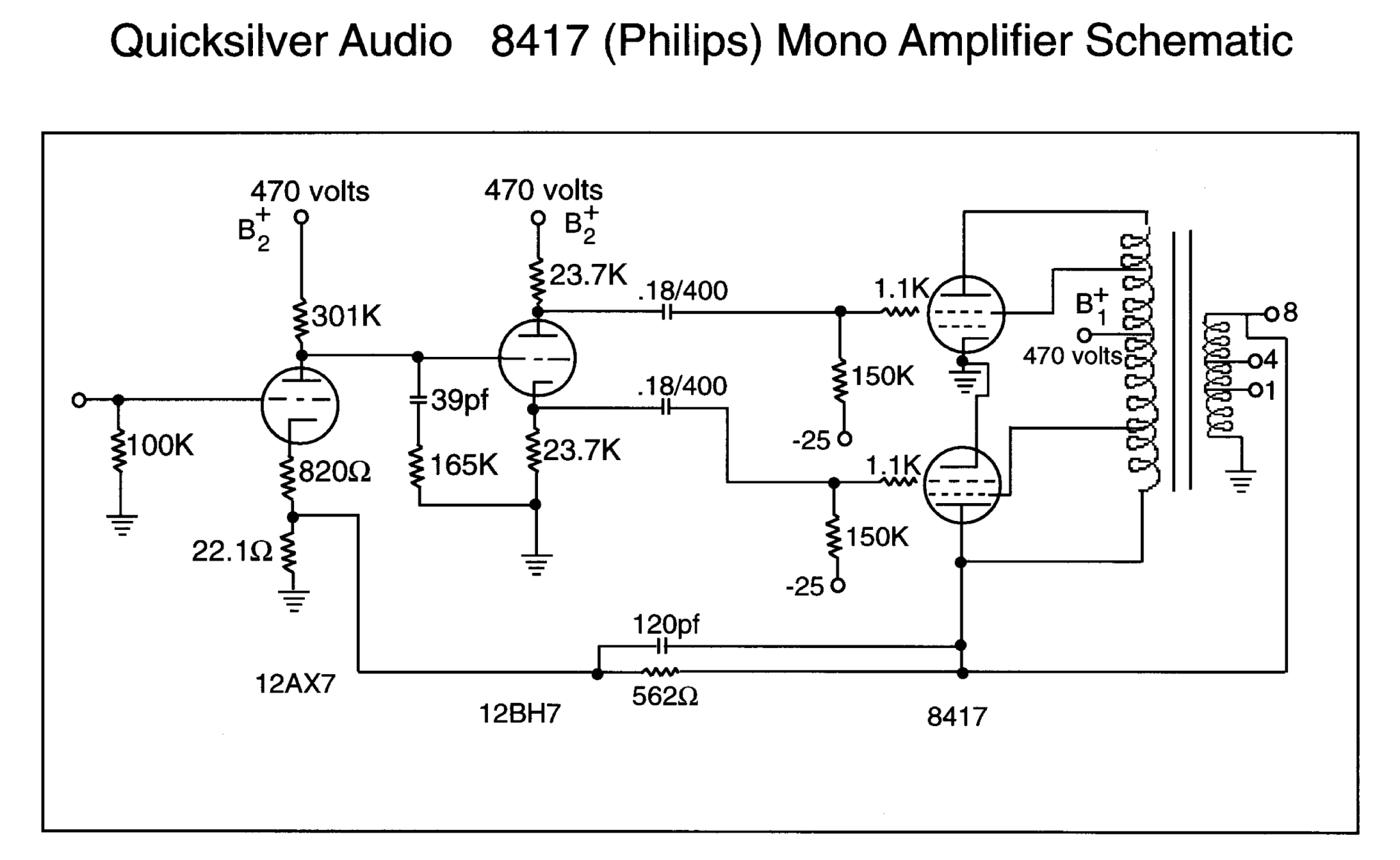

Regarding the rest of your post... I'm well aware of the synergy matching, etc, etc, etc... Not trying to be a punk; however, I've been doing this for a long time, as I'm sure you have. I'm fully adept at creating good sound from combinations of product, as I'm sure you are. The amp, in question, has been put into a number of systems, changing out interconnects, speaker wire, power conditioners, tweaks, and so much more...
As I've said, this amp may be for a lot of people; however, I'm wanting something a little different. The builder and I have talked about this numerous times. I'm not wanting to really change much, on this amp, if at all, as I will most likely be selling it. I'm trying to provide people with as much of a view into what my most recent amp is and see what changes could be made, to help with what I'm trying to get.
ok, one of my all time favorite amps...
What makes this amp sound like I want... BTW, I would want to use this with EL34's as 8417's are hard to come by, now.
Either build an amp or have someone build me one. Either way, I'm ok...and what are you trying to achieve?
You seem to have the skills to build your own. I do use simulation a lot to build amps. Its as accurate as the models you give it, but there are pit falls. It also won't tell you how its sounds but will show you the distortion sources. However for tweaking components and trying ideas out I find it essential.
Depending on the amount of NFB you want that amp may not have quite enough gain for EL34. LTP second stage may be better still using the 12BH7, but my designs tend to always end up analytical as you would say. Some of the colouration could come from the HT dropping on the peaks - like a compressor.
