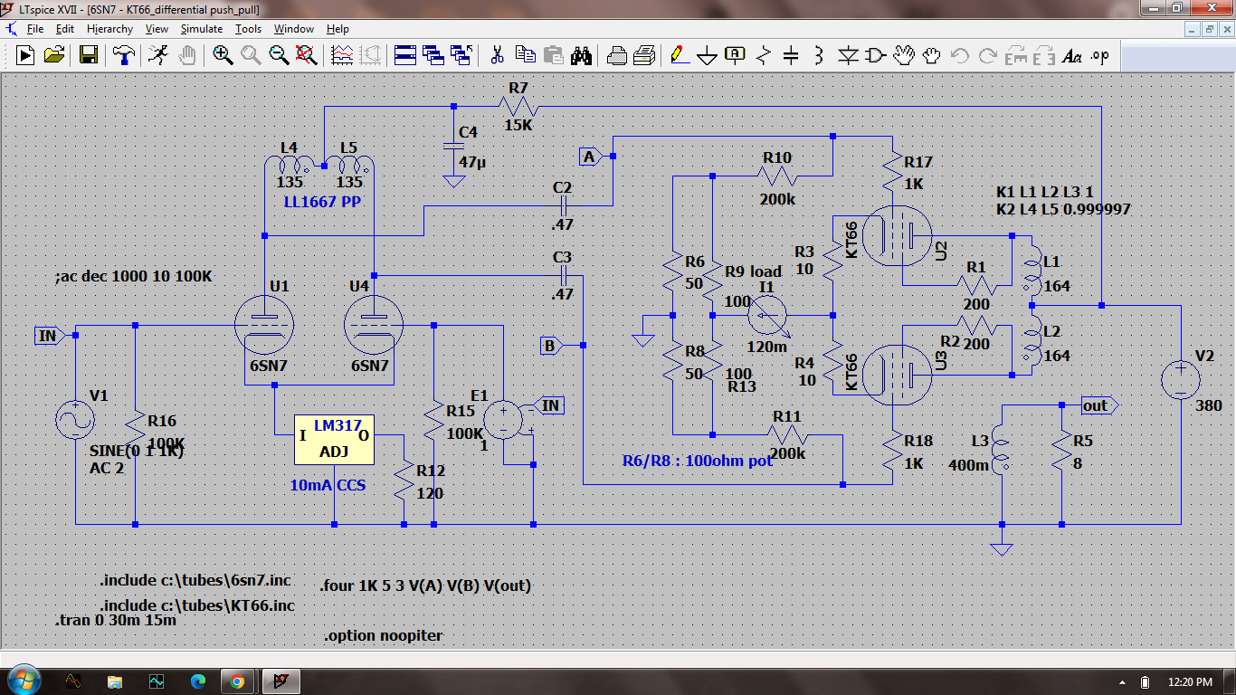

This is what I have been experimented for some time. First move was changing the driver circuit for the 300B SE amp. I got the Monolith PP interstage and drive it with 6DJ8. The PP drive surely provide very clean and low distortion signal for the 300B. The amp sound amazingly good indeed.
Second move was changing the differential balance 6SN7 RC drive to PP plate choke for the differential KT66 PP amp. The result is real good that makes it sound so natural and smooth like the 300B SE amp.
When you look at the distortion at each stage of the traditional tube amplifier, you would realize the driver stage in the power amp having large amount of distortion. For example, like the Sun Audio 300B, the 6SN7 output signal to the 300B would have about 5% distortion which drives the 300B for full output power. Such large distortion that mixed with the 300B stage may not show that much in the THD measurement. However, our ears are much more sensitive to determine the THD doesn't mean much.

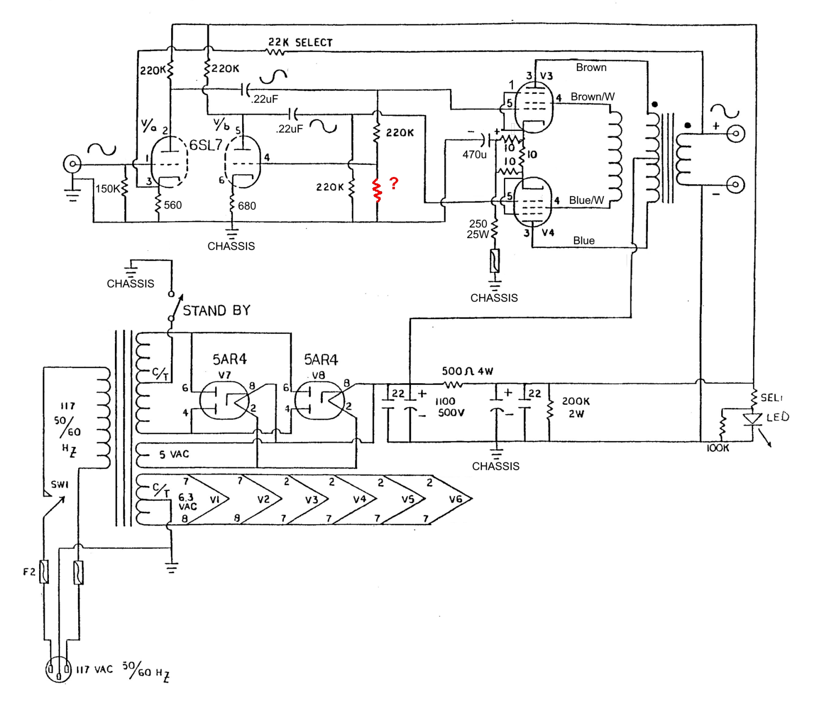

This is an amp (schematic)
that i remember being syrupy, exaggerated mid-range, and old tube sound…
The screens will be connected to HT through the windings. The 220k will form a summing junction of the 6sl7 grid so its gain is -1. Yes this amp will drive the output tubes with difficulty at 10KHz - so your going to get slew rate limiting and a fuzzy sound. Oddly this amp should not have a lot of 2nd harmonic being a PP if its phase invertor is working. Interesting to post.
This is an amp (schematic)View attachment 1278136 that i remember being syrupy, exaggerated mid-range, and old tube sound…

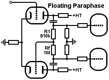

That's an old floating paraphase inverter and probably contributed to the "syrupy" sound.

Or is #30 correct and the red resistor set to cancel out the 2nd harmonic?
No, It's a floating paraphase. The voltage divider sends a portion of the AC signal to the second 6SL7 grid.
The Conrad-Johnson is a completely different circuit. It looks like a voltage gain stage direct-coupled to a cathode follower, which is in turn direct-coupled to a long-tail pair phase splitter/driver. It's going to have much better drive and bandwidth than the simple paraphase.

1. Your Post # 30 is an early Cary push pull 807 amplifier. Right out of the service manual . . . Right!
This amplifier has fairly direct signal path, and fairly direct negative feedback paths, 1 global, and Ultra Linear.
Simple.
2. Your Post # 35 is much more complex, has perhaps 10 transistors in the IC Regulator Op Amps.
Some might not consider that schematic to be a vacuum tube amplifier.
This amplifier does not have fairly direct signal paths, and has Ultra Linear, plus 2 direct negative feedback paths (like the Dyna Stereo 70).
