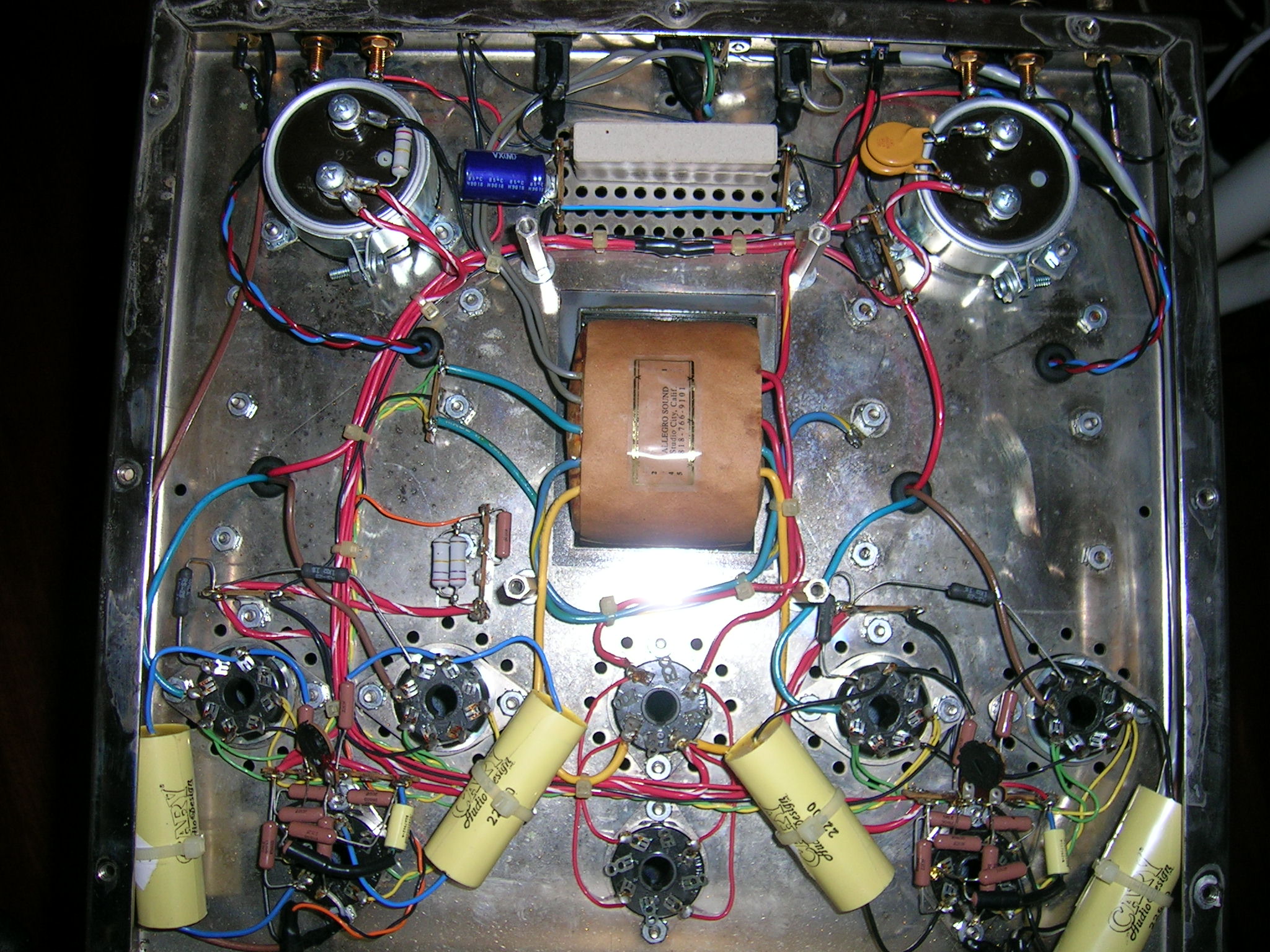

That red resistors is shown as a 50K pot - an open loop version of the paraphase. Could have no phase inversion all the way to rather to much. This will control the 2nd harmonic null or your syrupy pot.

Actually, it’s a push pull SLA-70. They used EL34’s, 6L6’s. Also, as I remember, there was a pot as baudouin0 says. The round black looking things are the trim pots over the driver/phase splitter tubes.caryking,

That is a floating paraphase (?) phase splitter, used quite a bit before the days of LTP's and Cathodyne converters. Incidentally, it is a similar circuit as used in the Leben CS 300 amp, which is renowned for its lush and rich sound. (Tells you sweet little lies as one reviewer put it) Without that red resistor, it won't work.The screens will be connected to HT through the windings. The 220k will form a summing junction of the 6sl7 grid so its gain is -1. Yes this amp will drive the output tubes with difficulty at 10KHz - so your going to get slew rate limiting and a fuzzy sound. Oddly this amp should not have a lot of 2nd harmonic being a PP if its phase invertor is working. Interesting to post.
I think its a pentode output from the layout, the data sheet says only a modest amount of NFB (4dB). The black pot is the phase amplitude balance (red resistor) I think. So its going to have poor slew rate, poor speaker damping and a variable amount of 2nd harmonic - all the right ingredients for a valve sound - lush, rich and syrupy. A long way from blameless/transparent/clinical/analytical.

OK, well your pic of the SLA-70 appears not to have any regulation circuits.
