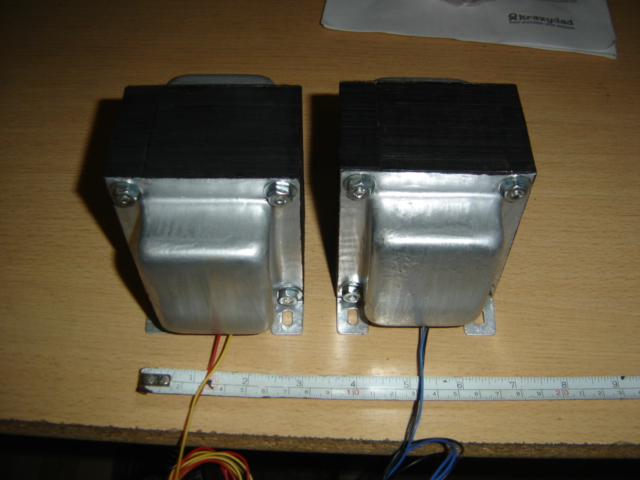

I made my own inductors from burned 110/220 trafos, recovering the core and bobbin, and winding in it the turns necessary. Then, reassembling the core E and I laminations together, and checking the gap for the lower ripple at output at nominal output current. A short reckoning with window area and wire size gives you how many turns you can place in the bobbin, measuring it with a rule or caliper. Then, with the meal turn length and wire resistance per unit length (available at manufacturer's data sheet or from approximate tables) you can estimate the DCR. If too high, redo from the start. When arrived at a reasonable resistance, the inductance can be estimated from a LCR meter if needed. This is how I make my own inductors. Final adjust would be done in circuit.

I made my own inductors from burned 110/220 trafos, recovering the core and bobbin, and winding in it the turns necessary. Then, reassembling the core E and I laminations together, and checking the gap...
I appreciate your comments and think it’s very cool that you’re winding your own chokes using salvaged iron. I have an old tube receiver set aside as it looked promising for parts harvesting. Unfortunately I think winding my own chokes is a bit too ambitious for me right now.
Perhaps in a short future. A little test will encourage you to make your own chokes, and why not transformers. You don't need too much tools, only a bit of job and idea.
I did purchase some magnet wire a few years back with the intention of winding my own loudspeaker crossover inductors. In fact, I still plan to do so and I appreciate the encouragement.
