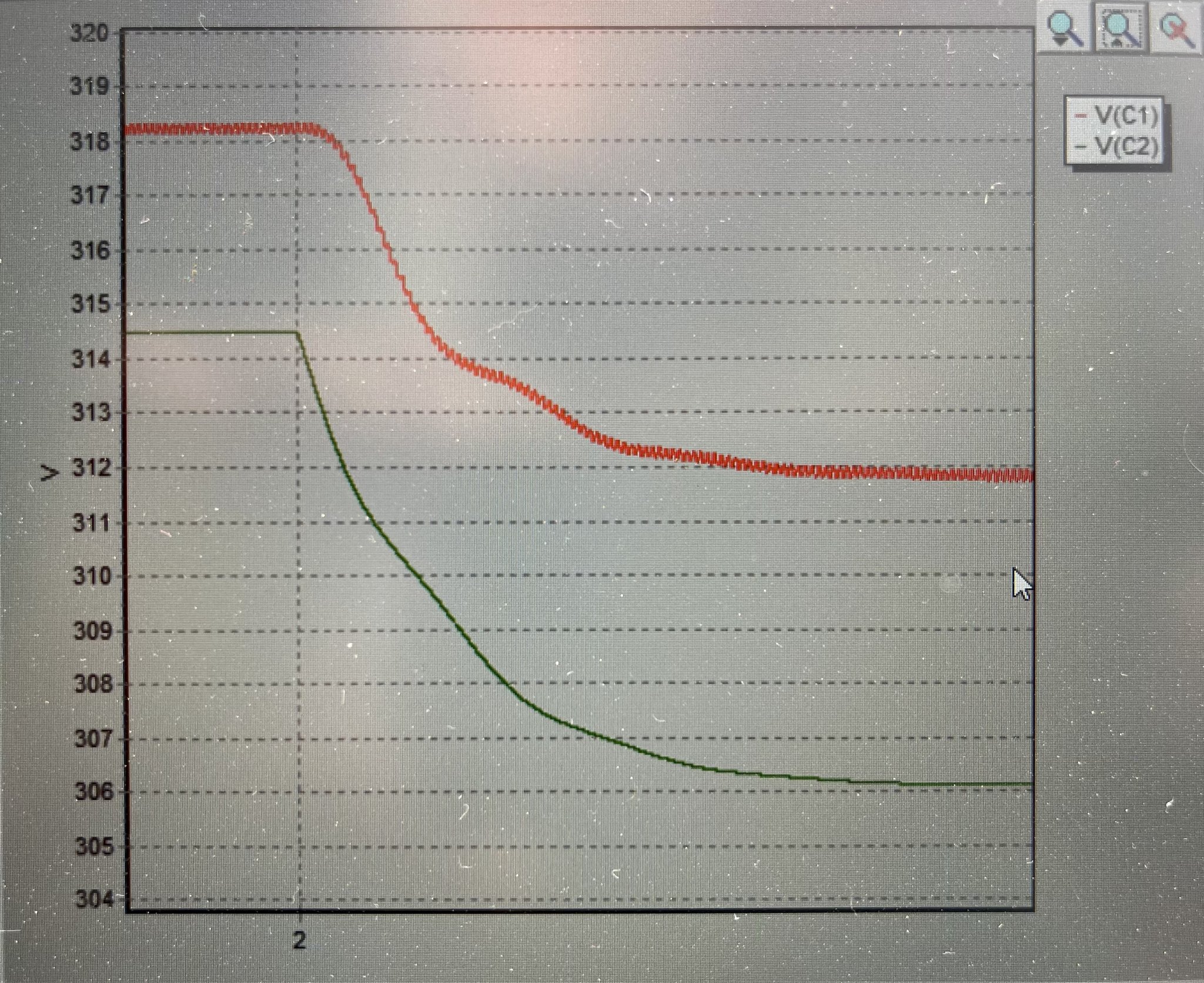

Please critique my TSE choke-input PS sim

Okay, update, three years later.
I feel like I’m getting the better hang of this. After some sims using PSUD I was able to find an off-the-shelf Edcor power transformer (XPWR035) and a couple of chokes, one Edcor (CXC100) and the other Hammond (193J).
To double-check my choices, I again simulated the power supply using the measured DCR values of the magnetics. This got me the target value, a B+ of roughly 300V on the output tubes anodes (after a 6V voltage drop across the output transformer primary) with a raw current supply of 100mA. This is shown in the first picture.
However, when I simulate the circuit as a step load (66mA to 100mA) to check for power supply stability, I get the second picture.
Is this something to be concerned about?
(the eagle eyed may notice my capacitors have rather low ESR. This is real as I am using poly film DC link capacitors)
