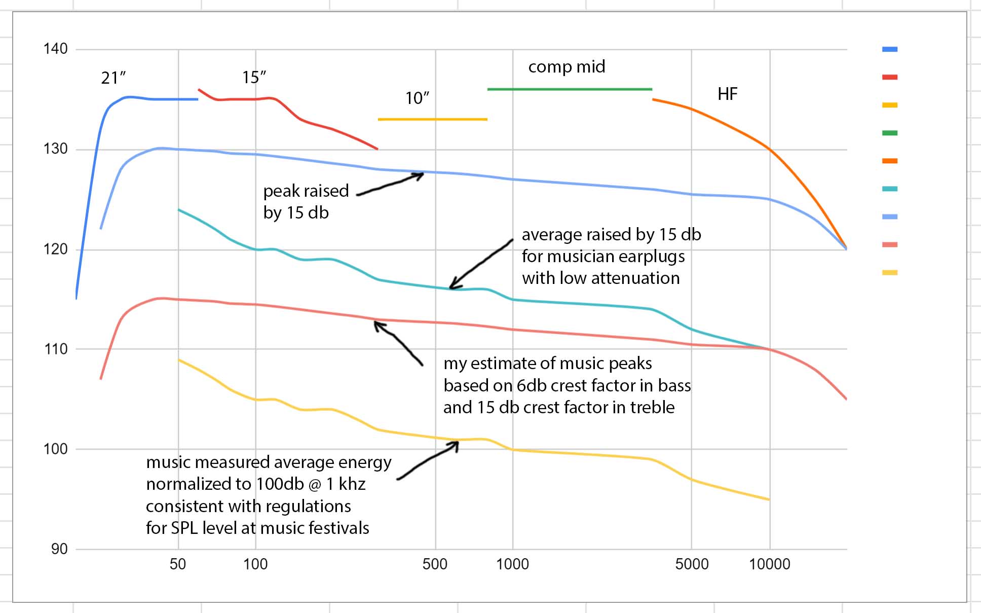

here is an update of just the effect of earplugs on the situation ( see attached graphic ).
in the previous version i was admittedly reaching to justify the SPL of the system. in my mind i knew i wanted a system that is as loud as i can build but i just couldn't get the math to work out - there was simply too much SPL. in previous version of the chart i started with 110 db because it was the highest number that could be passed off as relevant ( 1 minute NIOSH hearing damage level ) and then from there i first added crest factor and then 6db of bass boost. even after all that i couldn't quite get up to the SPL level the system was capable of.
then today in another thread when the topic of silk domes versus compression drivers came up somebody mentioned earplugs and i was like ... THATS IT ! this is the answer !
so i have re-done the chart and now instead of 110 db it starts with 100 db which is the level outdoor concerts are regulated at in some parts of the world ( A-weighted ). i calculate peak levels same as before. but i am not adding a 6db bass boost anymore, instead i now add 15 db for musicians earplugs attenuation, which is on the lower end of the scale of musicians earplugs which generally go from about 10 to 25 decibel attenuation. i show both average and peak curves both before and after being raised by that 15db.
the driver configuration has been reworked but the details are besides the point right now. the thing to note is there is more headroom at higher than lower frequencies and this is deliberate and due to several factors:
1 - higher frequencies are cheaper to reproduce than lower frequencies, and don't require gigantic enclosures.
2 - higher frequencies contain more information for the brain than lower frequencies.
3 - compression drivers have additional distortion mechanism and thus benefit from being oversized in order to lower distortion.
i should also note that Musician's earplugs do NOT provide even attenuation. they provide closer to 20 db of attenuation at around 5 khz and closer to about 10 db in the bass. the earplugs essentially provide the bass boost EQ that you would otherwise have to apply yourself, which is why i removed the 6db bass boost because with earplugs it is no longer needed. not to mention that we boost bass in music not only to hear but to feel it and obviously earplugs provide ZERO attenuation for the FEELING of bass, which is good.
in retrospect after bashing silk domes in other thread i now realize part of the reason for compression driver use in prosound is because to a certain extent prosound speakers are designed for an audience wearing musician's earplugs. even though only about 1/4 of the audience actually uses hearing protection arguably the other 3/4 are fools and do not matter. when you put the earplugs into the formula suddenly everything lines up perfectly where before nothing made sense in terms of SPLs at various frequencies.
i would have to conclude that perhaps silk domes are acceptable for home use if you don't need to feel the bass in your chest. and if you do then you should use not only compression drivers but earplugs too. because these are ultimately the two paradigms ... home / studio system without earplugs or prosound systems and earplugs.
without earplugs it is not possible to rationalize prosound system use. i was deluding myself but in the end i was right i just didn't know why. i said the answer was in my mind somewhere i just have to find it, and i did.
