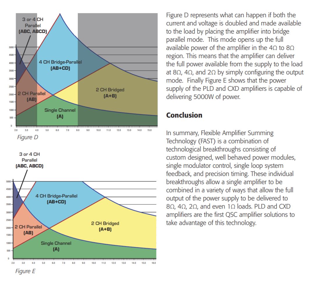

It's not supersition given a great majority of amps aren't designed to be able to drive 2 ohm loads
True. Here's a snip from a QSC whitepaper https://www.qsc.com/resource-files/whitepapers/q_wp_sys_amp_flexibleamplifiersummingtech.pdf.. there is no fundamental reason why you couldn't have even a 1/2 ohm load ... you would simply need to have more stuff in parallel inside the amp to account for it ...
Shows how paralleling channels in PLD or CXD amps can drive very low ohm loads.
there is every reason to assume that a more powerful amp expects more loads connected in parallel and is ready to handle it ...
Not necessarily. It all depends on what impedance range the powerful amp was designed for...
Note for instance, the different wattage peaks vs impedance in the above snip.

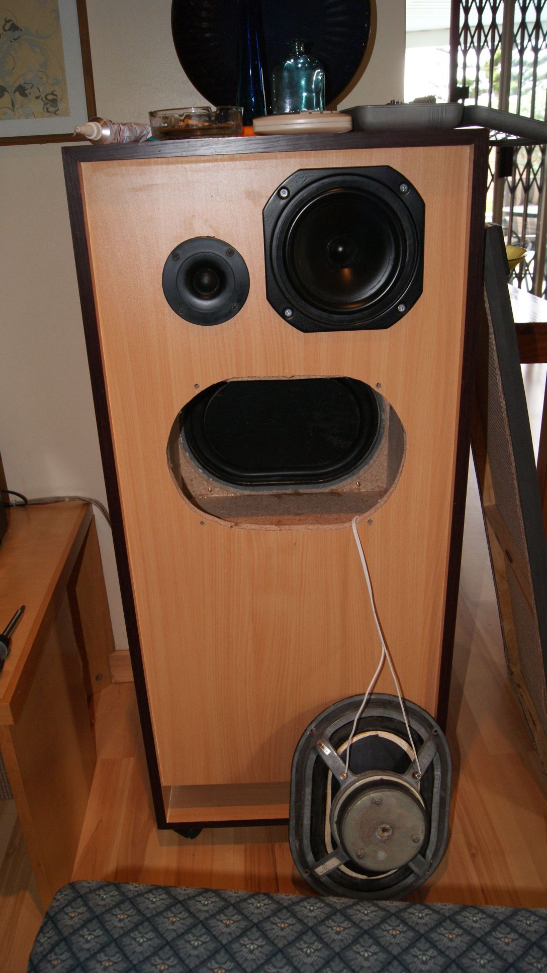

I am not a speaker guy, but have been messing with cabinet design and solving problems mathematically. Horn drives are pretty complex and an art to fold into a limited space, the example I give is probably the most complex I have ever seen and makes use of the whole cabinet in a remarkable way. I would never dream to fold it so cleverly.
My last design was an ISOBARIC transmission line, attach a photo just for interest, It went very low and was Fs moved lower than that of the drivers since the mass is acoustically coupled.
