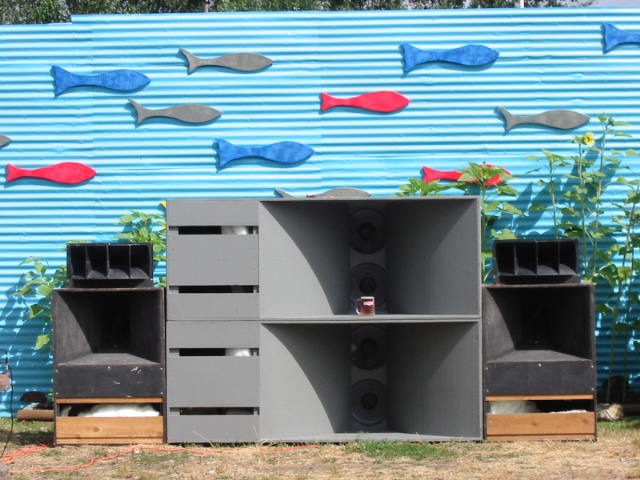

Check out the JBL HLA system as an example of a large multi horn system:
https://www.cieri.net/Documenti/JBL/Technical Notes/JBL Technical Note - Vol.1, No.23.pdfhttps://jblpro.com/en/products/hla-4895-hla-4895a#descriptionits only 4 way including subs. A local venue uses a modified version of this to which they added 'kick' cabs making it a 5 way system but this is a 3000 capacity venue you wouldn't need the complexity in such a small space.
this HLA seems ancient.
i feel bad about even being inspired by the Marquis system because it is discontinued. i am trying to cleanse my design of its influence.
my system is meant to be the absolute cutting edge and even be designed around DSP technology that doesn't exist yet ... NOT be a clone of something from the 80s.
also, even somebody as insane as me understands that i am not a burning man festival or woodstock festival but a guy with a living room. i am NOT trying to build an array - i am in fact keeping to a SINGLE compression midrange. only the frequency bands that need arrays to keep up with the midrange are getting arrayed.
it's basically supposed to be a point source in the critical range that slips into array territory below the horns and at the very top.
there is not much sense in arraying horns. arraying is in itself a form of horn loading. both techniques are used to increase airload mass. the point of horns is to avoid arrays but sometimes it is impossible and arrays must be used.
the system is getting redesigned with or without anybody's input. as i explained i keep redesigning it over and over in my mind. have zero intention of building what somebody tells me to build but every time somebody makes an argument i reflect on it and this reflecting ultimately influences the course of my thinking and how the system gets redesigned. so on one hand i will reject everything you guys say but on the other hand everything you say will on some level get imprinted in my mind somewhere and ultimately influence my thinking.I agree completely with Petter Persson but will also reiterate my earlier comment: "...simply build it as you see fit and I am certain that you will enjoy it...".
Expectation Bias is a very powerful thing and if you believe deep down that your design is best, and that the pitfalls and problems which many learned posts here have highlighted are unimportant, then I believe that you will be very happy with your system's performance and will have fulfilled your aims. It seems fairly clear now that you probably will not be swayed from your design, but before buying drivers and cutting wood, please do re-read this thread from start to finish and consider that comments made by me and others which have suggested that just 'more' is not necessarily better are based upon experience and physics, not personal whim or fashion. Original thinking is to be applauded in any field, however one has also to build on established and proven technology and not try to completely re-design the wheel...
Over and out, and the very best of luck in your acoustic endeavours. 🤘

Hi guy the previous writer is absolutely correct, your system is super complex and designing a crossover for that system and correcting it more or less for a flat frequency response, you need some serious technical know how and quite a bit of experience. There is a huge difference for car sound that theatre sound, if I take the volume of the listening space into consideration, it would probably require a few mini DSP's and some very good analysis or measurement equipment.first of all thank you for trying to help me keep my sanity by not forcing me to think about this on my own for months on end
that said ... i honestly do not understand the argument that more frequency bands equals more complexity
i used to have a 5-way DIY system in the car and it worked great except the car died before i had a chance to install the subwoofers
the Harman Kardon system in my car right now is a 4-way but the subwoofers are 8" ... whereas in my design 8" is the midbass ... so actually the Harman has 3 frequency bands above the 8" while i only have 2 ... the Harman has 1" tweeters, 3" midranges, 5" bass drivers and 8" subwoofers - it sounds great ... incidentally my 5-way DIY car audio system also had 8" drivers as the 4th frequency band from the top ... i just never installed the 15" RCF subwoofers which i still have in the basement ...
besides, i didn't start out with some number like 5 or 6 - i started out by reverse engineering JBL Cinema Screen Array which is a 3-way ... but i soon realized two things ...
1 - even though it has 15" woofers the JBL Cinema Screen Array still is designed to work in conjunction with 18" subwoofers ...
2 - it's a relatively budget speaker, and in the more premium speakers JBL has moved to coaxial HF drivers ...
so working from there i kept the four 8" midranges that JBL Cinema Screen Array has but decided to spread the 15" and 18" drivers apart in size by turning 15" into 12" and 18" into 21" ...
i then replaced the 4" HF driver with a coaxial BMS or B&C driver ...
then i split the coaxial into separately Midrange driver and Tweeter ...
then i replaced a 2" tweeter with four 1" tweeters for lower distortion and better dispersion as well as better HF extension ... this idea was taken from JBL Marquis dance club series which use dual supertweeters crossed to 3" compression driver at 10 khz ... that actually turned the system into 6 way but i then was able to consolidate the tweeters and supertweeters into a single array cutting it back down to 5-way ...
in other words the JBL Marquis is already a 5-way ( fully DSP active ) system even though it doesn't use a coaxial HF ... if the compresison in JBL Marquis system is replaced with Coaxial that turns it into a 6-way ... so i was actually able to streamline that design by turning it into "only" a 5-way ...
i also rearranged the woofers and midranges into a configuration similar to what is used in JBL VTX arrays for greater compactness of overall design ( the Cinema Screen Array is too tall for regular rooms )
