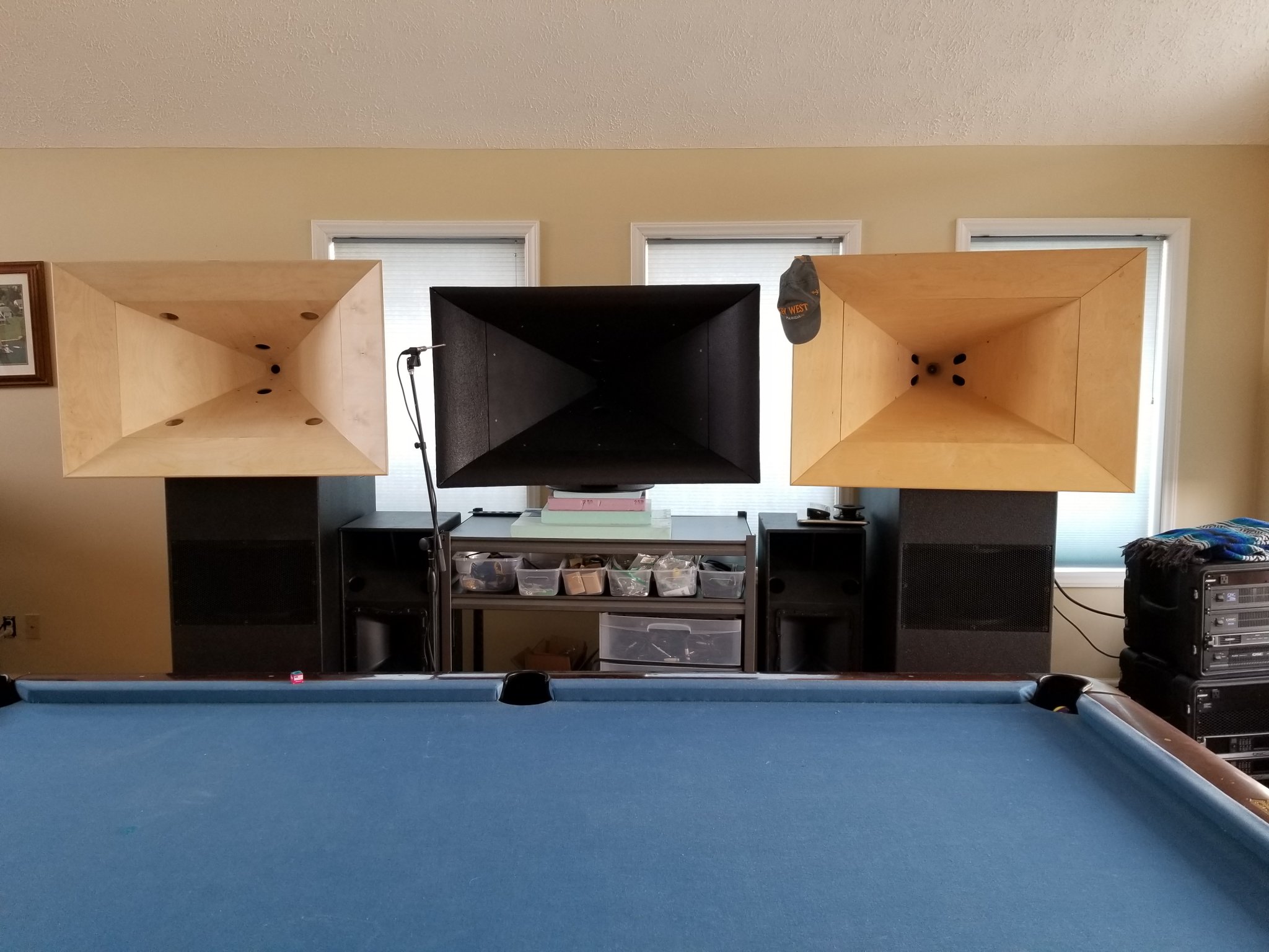

Here's some speaker build, on top of dual 18" subs.

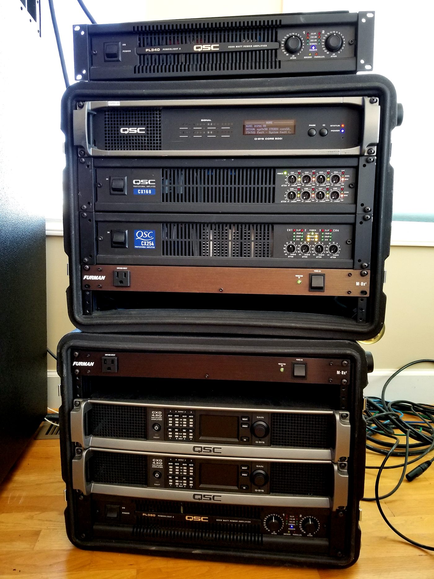

Then amp rack.

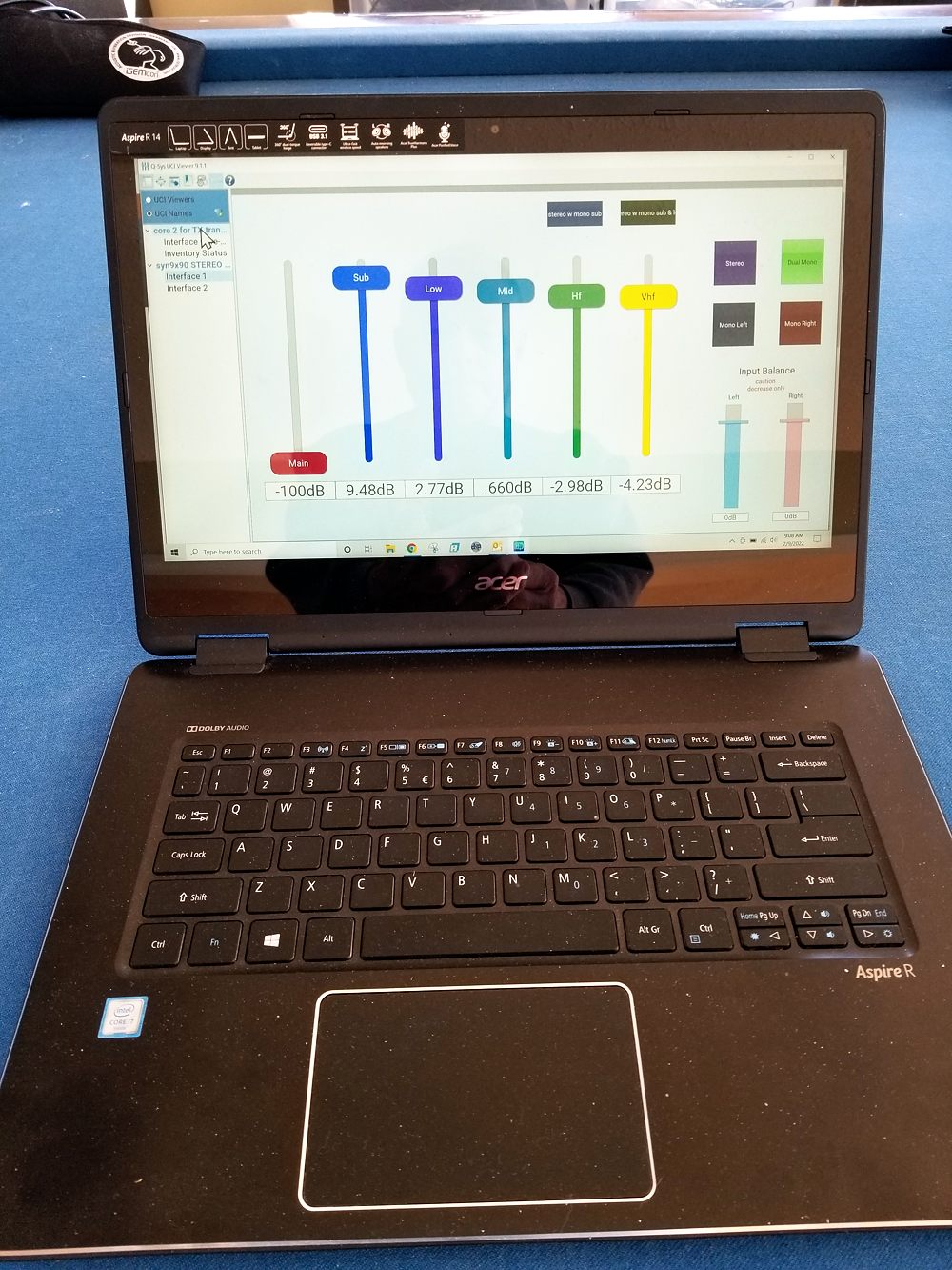

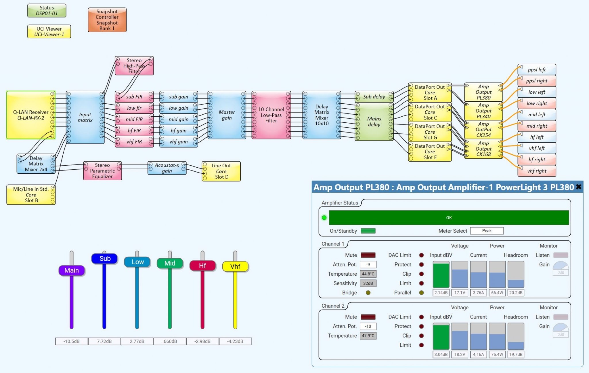

Then my "remote" which is a laptop that has chosen control elements from the processing schematic,
which is the last screen. Q-sys.
I keep volume controls on the remote for surfing Fletcher =Munson at different SPLs, for adjusting tonality on tracks when needed, and for adjusting indoor vs out. Along with stereo/mono switching etc.
Then amp rack.

that's a lot of amplifiers ...
i see you're running exclusively QSC and their Q-Sys whatever that is ... i have actually been wondering what Q-Sys is ...
i will say that i'm partial to Crown over QSC in fact i wanted to smash my QSC PLX with a hammer many times because of how loud the fan is ... i will mod the fan once the amp finds its place driving some easy load but i used to have this amp driving TC Sounds LMS subwoofer and couldn't mod the fan or the amp would have fried ...
so basically what i'm saying is i will definitely not be going your route of all-QSC on the other hand i don't see anything from Crown that would work as well for compression drivers as QSC CX line ...
my plan is to use QSC analog amps for all compression drivers and Crown Drivecore amps for all cone drivers ... but then apparently i won't be able to use that Q-Sys thing - what is it anyway ?

Q-Sys is the control software for QSC Core processors. Open architecture, design your own DSP with a PC, which complies it on the Core running Linux.
Robust install type stuff.
Online training is excellent, and you can learn how it works/ try designs on a PC without owning a Core.
Well worth the effort to check out the training .as it opens eyes and minds to where (i believe) even the advanced home audio routing/processing market is headed.
Open architecture processing has been in the proaudio install market for quite a while. Check out the array of processor brands/models that Fulcrum Acoustic supports for their install speakers...https://www.fulcrum-acoustic.com/support/processor-configurations/
Once a person goes open-architecture, they'll never look back imho, unless they have a simple two-way passive type or similar situation.

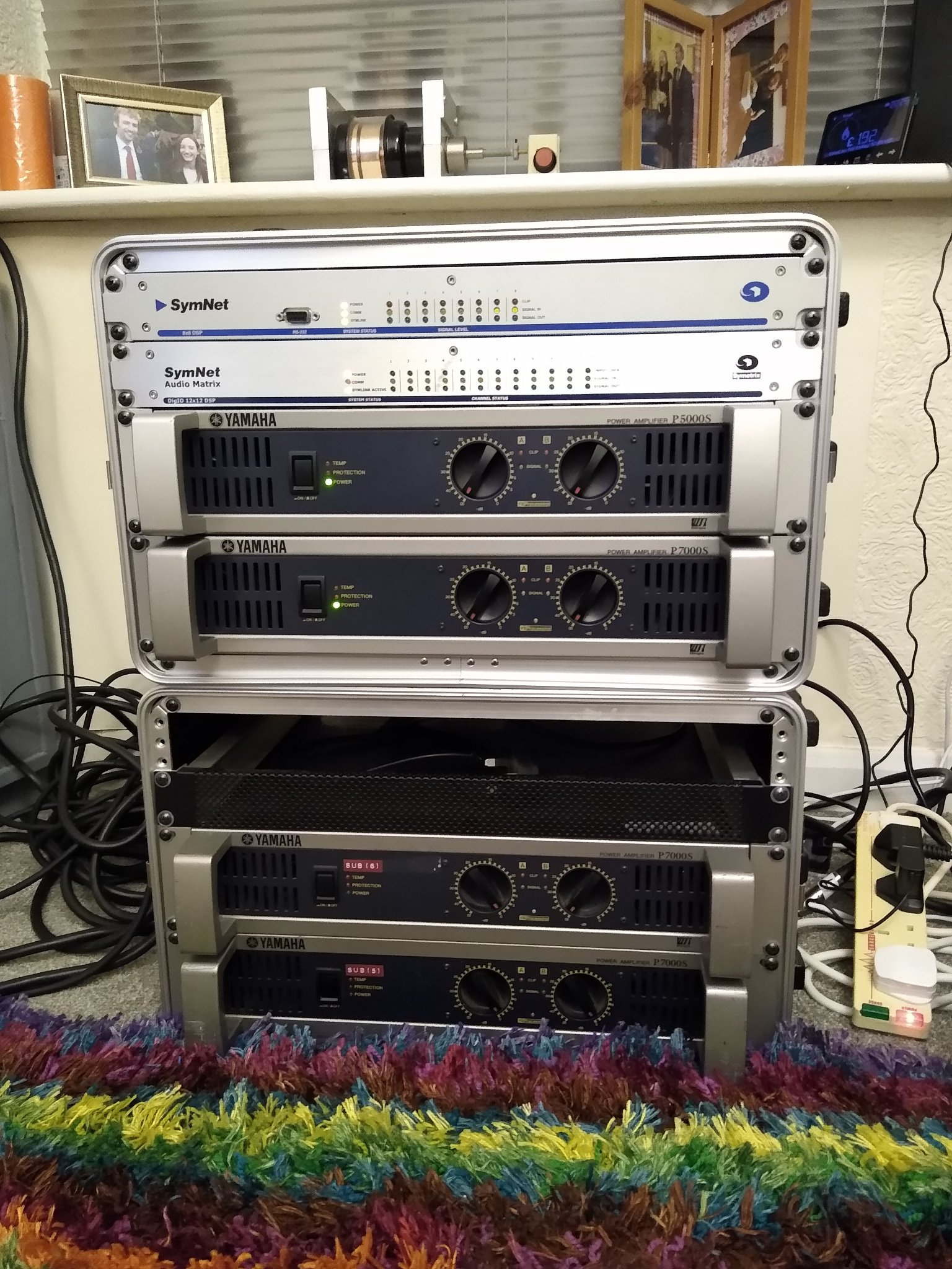

I use Symetrix and QSC in different systems but only the older stuff, new devices are expensive... There is no need to match the amps to the processing especially if they are 'dumb' amps with no inbuilt processing features.
