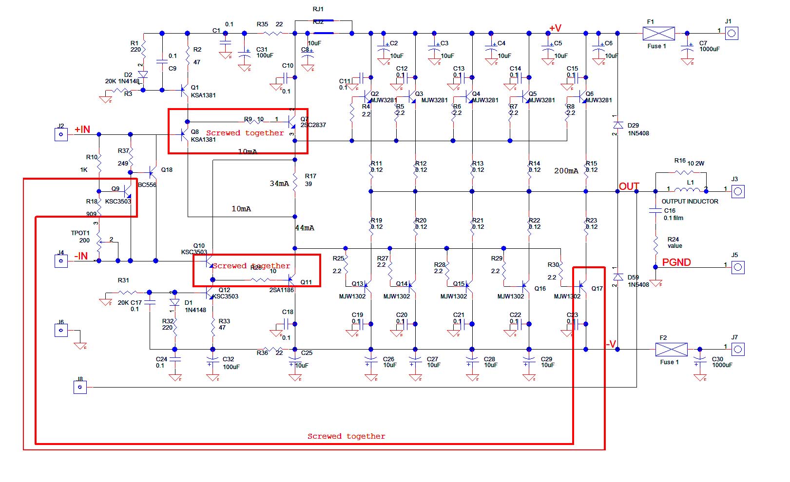

Q20 & Q21 should be high speed, high gain, low Vce small signal transistors, since they pass only the bias voltage. That is one of the great advantages of this topology.
Q1 & Q5 can be any old slow TO-126 that has adequate Vce. You don't need to use these precious CRT drivers here any old BD139/BD140 will suffice.
Your bias generator does not have enough gain for a symmetrical VAS, but I have told you this already.
Your output Re's are too small, but I have told you this already also.

I am using 3EF, the load on the bias generator is very light. You think it's necessary? I remove the CFP circuit because I don't want to deal with stability issue if I don't have to.
I have to look at the pin out and also thermal couple of the TO-92 transistors. I am designing so I have the TO-126 pre-driver screwed right onto the bigger driver transistor to track temperature. So the physical mating surface is much more important to me than the little beta and fT gain using a small transistor. With 3EF, I think it is a lot more forgiving on this.
From the simulation, these transistor is not the most important thing. I found the Oliver's optimization and using TMC makes the most difference. I lower the Re of the big transistor from 0.22 to 0.12 because it makes a difference in the distortion. Not that I trust D Self that much, but he is strong advocate for 0.1ohm. I think this affect only the quiescent bias current, when there is large signal, there will be so much current through the resistor that there will be a lot of voltage drop across even th 0.1ohm resistor.

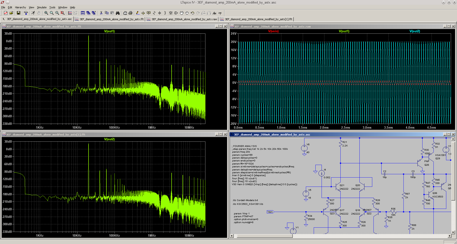

You are right, I simulated 20KHz 1.5Vin(30V output). The 3H is almost 8dB lower to slightly under -70dB. That is 98dB below the fundamental peak. This is 20KHz and high power.
My problem is how am I going to fit that in. It is very hard to do it as is already as I have to put the bias transistor on top of the big transistor to get thermal tracking. If I can do it, it will be good. I have the PNP predriver screw onto the NPN driver, the NPN pre-driver screw onto the PNP driver. AND I have the bias transistor screw onto one of the big power transistor. This is the best thermal coupling it can be bar none.
I am simulating 1KHz 1.5Vin 30V output. I'll update later as it takes about 2 hours to do one simulation. Keep the comments coming, it might take a while to get back to you, but I am reading.
I have to retract the last post. I spent the whole day running 1KHz at 1.5Vin and 0.35Vin. I ran 20KHz 0.35Vin. There is absolutely no difference between the CFP bias multiplier vs the simple one transistor bias multiplier. I started questioning what's going on. I redo the 20KHz 1.5Vin like the last post, I cannot get back the good result anymore. So I don't know what to think anymore. Basically there is NO difference between the two far as I can tell.
I'll investigate more tomorrow.

Do you mean bad things can happen if I forgot to connect the +IN and -IN from IPS/VAS? How about putting a1M resistor from the base of Q9( bias transistor) to ground. So even if it's open, it will pull the junction close to ground.
Here is the schematic of the latest version. I layout so I can screwed the pre-drivers and the drivers together so the NPN and PNP track the temperature quickly and closely. I also layout to screw the bias transistor Q9 to one of the power transistor Q17 so the bias transistor track the temperature of the power transistor.
I think this is as good as using the NJL type of transistor. Now the OPS achieves completely thermal tracking.
I don't know what transistor have the same tempco, If you have better suggestion of the TO-126 pre drivers that can track the power transistor and the driver transistor I use, let me know. But I really prefer it's in TO-126 as I want to screw onto the big transistors. I don't want TO-92.
