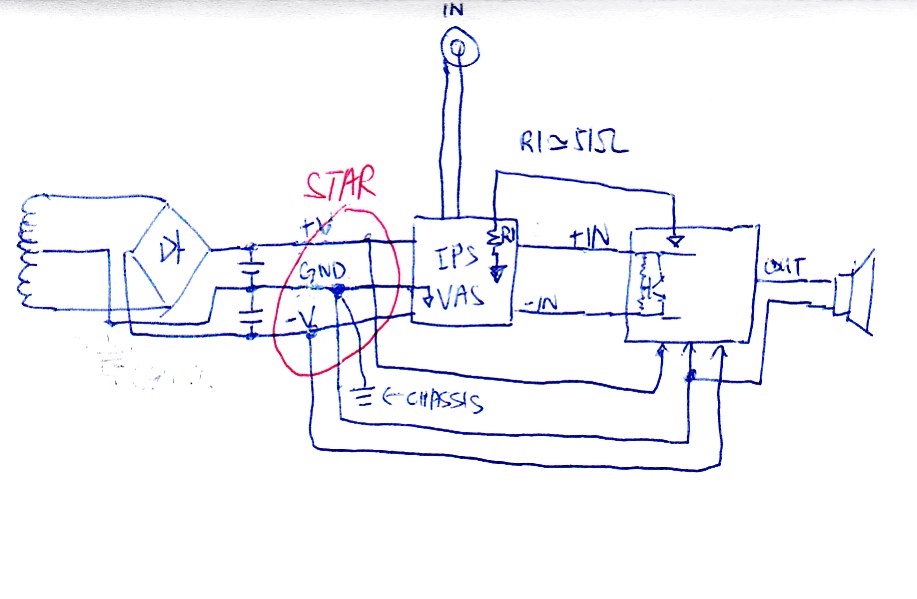

I never said star ground and looking at the high current part is not important. Remember this is only the OPS, The IPS/VAS is on a separate board. The two grounds are connect to the main resevoir cap on the chassis. It would be crazy to have one ground plane for the IPS/VAS and OPS together, as OPS have high current, you have to separate the two ground and connect to a star.
Now that I got rid of the error correction circuit, I have enough room to actually do ground cut to kind of separate the high current big transistors from the drivers and pre drivers. The OPS has a gain of less than 1, the power supply ripple is not as important as IPS and VAS. BUT the parasitic causing oscillation on the big transistor are a major problem for 3EF, having a ground plane make a day and night difference.
Attached is my preliminary grounding scheme. The start connection is on the main reservoir cap on the chassis. The ground of IPS/VAS and OPS only connect to the star ground outside. The ground from the OPS connect to the IPS/VAS board ONLY through a 51ohm resistor IF NEEDED.
And yes, I definitely use ground plane on the IPS/VAS board also.

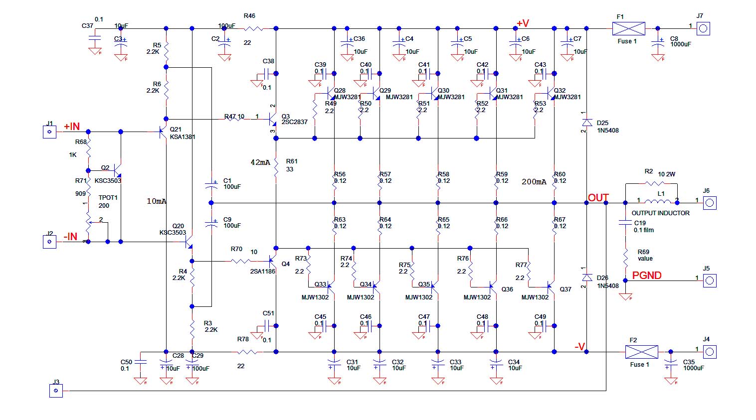

I have more questions. Now that I got rid of the error correction circuit, I have much more solid ground plane and I can afford to cut the ground to isolate the high current transistors from the pre drivers. This gives something of a star on star grounding where the ground plane for the power transistor is kind of stared.
My question is which side of the ground should I put the driver Q3 and Q4 on. In the schematic, I have the rail voltage through a 22ohm resistor before powering Q20, Q21, Q3 and Q4. Since Q3 and Q4 might have bigger current when driving all the big power transistor, would it be better to move Q3 and Q4 with the power transistors before the 22ohm resistor?
I change the driver transistor Q3 and Q4 to 2SC2837 and 2SA1186 resp. since I use 5 pairs of power transistors, seems like I can use 2SC2837 and 2SA1186 even for power transistors. They have higher fT and lower input capacitance. They are still 100W transistors. What do you think?

I consider the drivers as part of the output stage.
They will pass currents approaching 1Apk in medium size 8ohms amplifiers.
For lower impedance speakers and/or high power amplifiers, the driver currents will exceed 1Apk.
That puts them into the "high current" side of the amplifier.
Your 22r feeding the drivers is going to lose a lot of voltage when the amplifier is outputting high transient peak currents. The decoupling of ~110uF will satisfy some of this demand, but you are working them harder than I would.

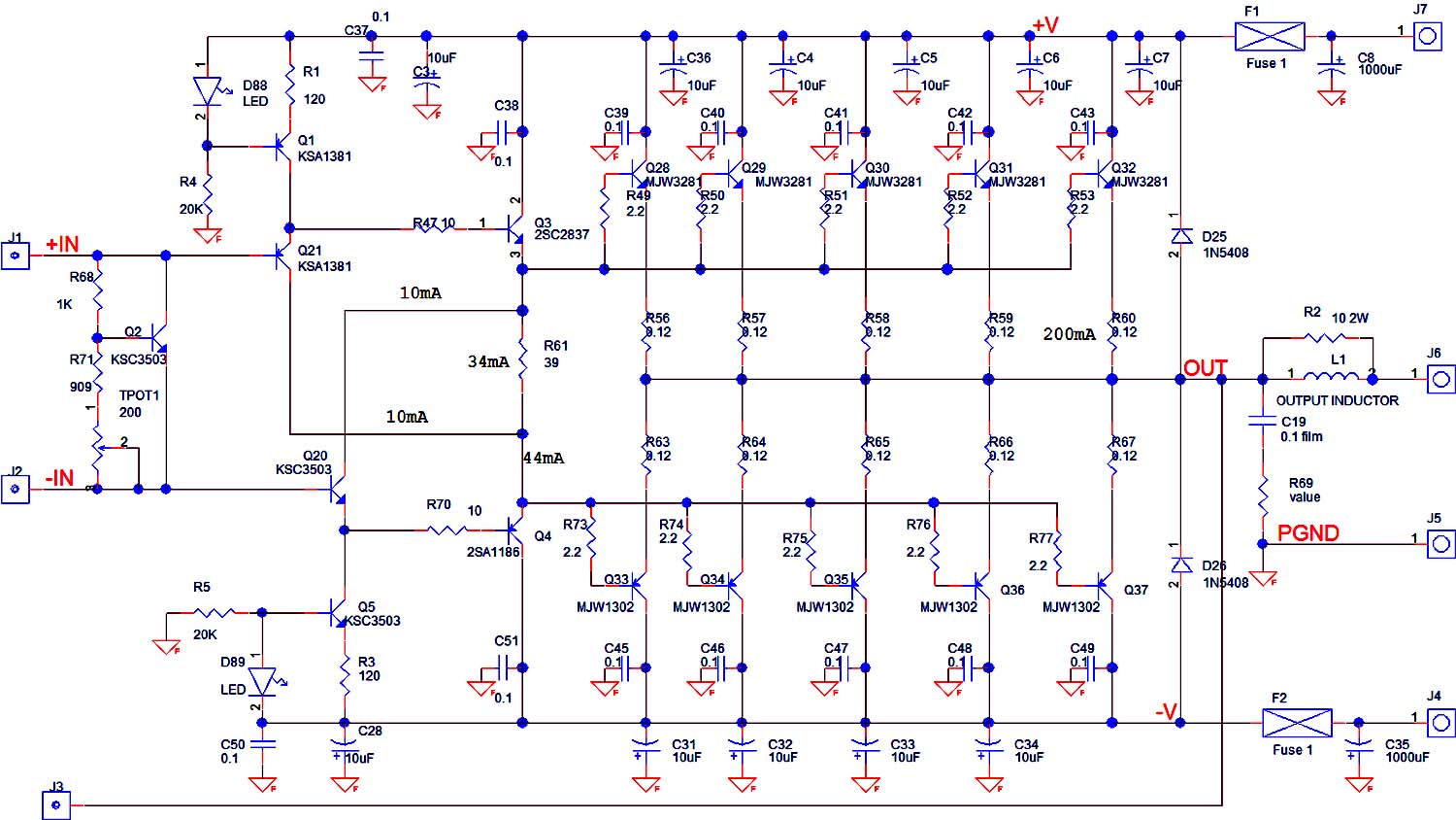

I kind of figure that much as I was waiting for opinions. I updated the schematic and the layout already. As you see, I moved the driver to the big transistors' side. You think this is good now? I even change to a TO-3P driver transistors that are 100W!!!

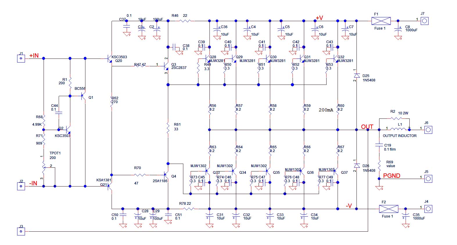

I am starting to change my mind on my version of 3EF OPS. I am tempting to do the 3EF that use one opposite transistor on each side. eg. instead of 3NPN as 3EF, I want to use PNP NPN NPN for the top half and NPN PNP PNP for the bottom half. I think there is advantage in thermal and stability of the bias multiplier circuit. Attached is the design of this. I copied from Christian ( Ranchu 32) on the the first stage. I did simulation and it did show 2dB lower 3H at 1KHz 30Vpeak output.
I feel a little uncomfortable of the two 100uF caps C1 and C9 used to keep the tail of Q21 and Q20 more of constant current. I just want comments on this circuit and what to look out for. Any down fall.
