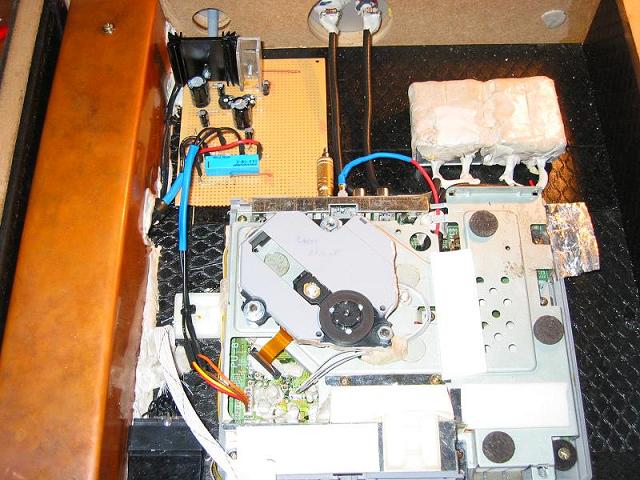

Hi Mick,
some guys from Russia and the Ukraine sell these caps on ebay.
Different varieties: paper in oil or teflon dielectric are available.
They are quite big though, the two I built into the Playstation are rated to 200V-DC. The sound quality is excellent!
I think, I will replace the transistor regulator with another LM317 board and place my DC-PSU close to the playstation, so that no heat is dissipated inside the playstation enclosure.
I will use a solar (battery) charge controller and simple transformer/bridge rectifier setup as battery charger....more pictures soon.
piero

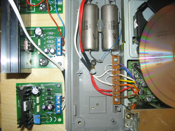

Hi Pieroh,
why you use the second LM 317 to regulate 8,5 V ? I also use a battery power supply with two LM 317 (like described in my posts). You can use one LM 317 to regulate the 7,6 V. From this regulated power you can go to the second LM 317 to regulate the 3,2 V. The maximum power you need for the PS is 1500 mA for a short time, than 900 to 1200 mA whan playing CD`s. This is no problem for the LM 317 with a small heatplate.

two separate supply lines
"speaking for myself" I have nothing to add ...
I think the two supply line solution is the better choice and more stable! The heat dissipated is distributed to three devices, this has the benefit of reducing the thermal stress for each single component.
Next thing will be to add a charge controller thas comes with a built-in LVD (low voltage disconnect) to prevent battery deep discharge. And I will use a bigger battery with 17Ah.
stay tuned
pieroh

I am now using three LM317 regulator boards:
One for the 7,6V rail, a second one is set to 7V as supply line for the 3,6V rail, works perfect.

Thanks Guys your recent posts on the linear PSU inspired me to instal the one I made for a previous playstation in my newly modded one.
The change is clearly audible, I popped in Norah Jones - come away with me and it was if she was standing right there in front of me, the faint cymbals in the back ground of one of the tracks finally became distguinishable from a faint hiss that they sounded like before.
I'll get a few more pics up once its finally installed (I don't like showing my work when its this messy!!)

PSU all leads connected
[ If other people than Dommy made this observation, I will make a corresponding note on my website. ]
because I had difficulties at startup sometimes , I connected all wires from the mainboard to the DC-PSU. Seems to work more stable now but could be coincidence...see picture.
