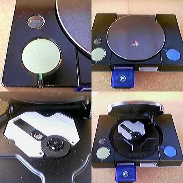

i am in the process of completely rehousing a ps1. im replacing the metal transport base (with the 3 spikes) with something made with molded heavy concrete! And re-orientate the transport. The flat cable for digital signal is very short. but i have discovered that the 7002 model (and probably other models) have the same transport but with longer cable, allowing more flexibility with mods. plus, they are newer and probably have less wear.
I will post all mods when i know it works. If anyone needs any details or positions for the 3 spikes, email me.
Im going to use the original power supply, separated, with extra capacitors on the output. With the belief this has the effect of being a pseudo battery supply.
The output from the dac seems to be 5Vdc offset + 1V ac signal, so blocking the dc is important if you want keep your speakers.

Heres a quick one of my PS with the Mundorfs installed:
And one of the inside
When I have sometime, I will put the IR receiver inside as per mick instructions + get the linear PSU into this one.
Dan
Dan

decided to have a break from trying to squeeze the last drop of hum from my system last night, so moved onto the playstation:
I added the remote into the case and also added some spikes.
The spikes are from oregondv.com and offer good value for money IMHO.
As a note, I would say putting the remote in the case is a bit more fiddly than the output mods but less chance of damaging something important with static.
Did anyone else who did this mod manage to keep the overall metal screen in place, I can't see it on Micks site and it really didnt seem like it wanted to go back on (kept all the other screens on though)
I reccomened this to everyone though, it makes the PS look a lot more 'finished' I'm really coming to like the Playstation case as well - I reccomend a quick buff using UniPol plastic polish to bring it back to a fresh grey finish.
Dan

Nice work, Dan. Afaik you are the first to follow the suggestion to include the RC receiver into the case. As you say, it makes quite a difference optically.
I have put all the shields back into place. The overall shield sits a little tight put it still fits in.
Now, next give your PS1 a low-frequency damping base. You can follow the instructions on my page. This makes quite a difference sonically.
For trying this out, you can already hear the effect when you put the PS1 on a soft pillow. Listen to complex passages of a well recorded CD with and without the pillow .... 😉
Mick

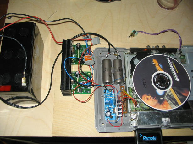

DC-powersupply
I made some experiments with a DC-powersupply today.
I use a 12V-battery and two LM317 voltage regulator boards to set the voltage to 7,6V and 8,5V.
Another transistor regulator (inspired by Mick!) with a TIP122 built into the PS, drops the voltage from 8,5V to 3,6V. The heatsick is far too small though, I will change this.
The audio signal is taken directly from the solder pads near the DAC and fed into two Russian military grade paper + oil caps (1µF) with 1M-Ohm to ground. A tube line preamp is used for further amplification.
Man, it is heard to believe, this sounds like beeing on a life concert, very dynamic, tight bass, very soft upper frequency range.
Try it!
Piero

Excellent work. If you turn the reg in the case by 180° you may be able to put a larger heat sink on it.
Where did you get those capacitors?
Mick
