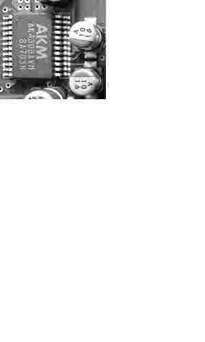

Thanks Mick_F for the output stage schematic. I'm new to surface mount and trying to figure out which is which. In my travesty of a crop of your original beautiful photo, I believe C423 & C424 are the 2 silver Cans to the right of the AKM DAC chip, they appear to have traces to pins 15 & 16. Is that correct ?

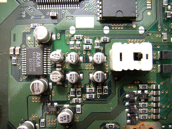

Well I stripped the PSone down, to clean it, check for hack-chips and genreally feel my way around. Mick_F's photos are fantastic BUT larger than life - those components are so small !. Removing the DC caps would definitely be a one-way street, I doub't I could get the caps back on having removed them.
Maybe I'll defer to the huge body of German knowledge on this subject, where they don't appear to modify the actual board
Unfortunately I only have the datasheet of the AK4309B, which has only 20 pins. But counting the pins, it seems that indeed 15 and 16 are connected to the two caps seen on your cropped image.
Does anyone of you have the 4309AVM datasheet?

back said:
jives 11 why don`t you just bypass them with a piece of cable
to test the sound?
Thanks Back,
yes - of course you are right, I could short out the caps.
The problem is the 2 caps are surface mounts and next to each other. The board is double sided with no ways to jumper underneath.
To short out the caps I would need :
1) A better fine point soldering iron
2) Beta blocker medication to stop my shaking hands.
I could desolder the out tags and bend the caps off the board, but I need a much finer iron and more skill. My current iron wouldn't fit in the gap between the caps.
I'm extermely grateful to Mick_F for providing all of the data, but I think, on balance that I'd better stick with an unmodded PSone that works.
However the PSU would be easy to work on .....
