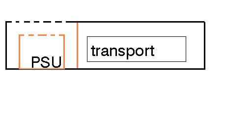

so the need to change the orientation or location of the the transport vs. the power supply, or remove the power supply completely from the same box , and shield it for rf?
My preferred option would always be to put the SMPS into a separate (metal) case, as this leads to optimum results in terms of RF and heat with not too much effort.

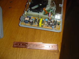

OK here aremy pics
Mick_F - you are a fantastic photographer, those pictures on your website are crystal clear and sharp.
Mine are not but this post and a follow up will hopefully clarify how to make a simple screen from two halves of an ASKA brand copper RAM cooler.
The first picture (hopefully) shows the two halvesfacing the same way overlapping. You can slide one across the other to select the appropriate width. The aska brand is a nice fit but another brand I have is not quite so good.

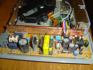

and here with the ram cooler 'screen' inserted behind the plastic screen and under the mains cable. Then extended to the full width of the depth of the chasis.
As has been stated be VERY CAREFUL that the screen does not contact the PSU board. A couple of grey plastic uprights from the base also help to keep it in position. It does not appear to move once the lid is on . (I shook one then reopened it) as I don't think there is any space left.
To clarify one last time. Looking down on the unit , from left to right we have :
1) PSU board 2) clear plastic shield 3) copper screen (RAM coolers) 4) laser transport.
The clear plastic screen helps hold the copper in place and insulates from the PSU. If it's damaged or absent do not attempt this
The copper screen is in contact with the transport metal casing underneath and on the side on the transport side. I measured 0Ohms using the multimeter

I think what you were doing will help indeed. That the shield is in contact with the metal frame is good as the latter is a ground plane.
Btw. you have the later version of PSU, the one which dissipates less heat.....

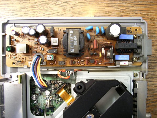

And the other's a Mitsumi SR670? (Mine is)
Mine has a grey transformer. I don't know if it's just because I have the 120v edition or something else, because the rest of the layout seems the same. It heats a lot tho.
